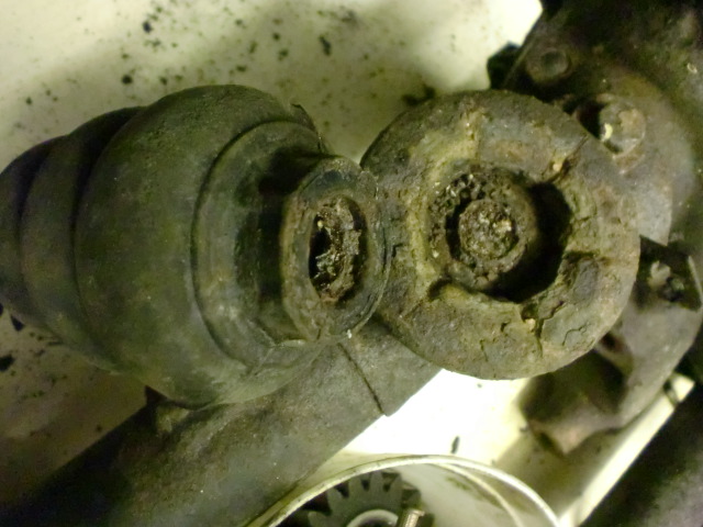

Hi,
you all know them, rotten buffer supports on late RGBs... Crying or Very sad
What now? Leave them away? For me no alternative
As i know there`s no source i started to refresh them my way:
Here`s my step by step tutorial Idea
Where we start: Confused

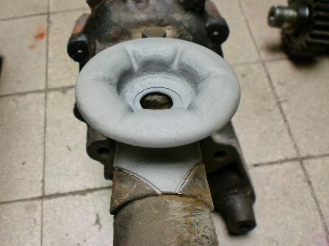

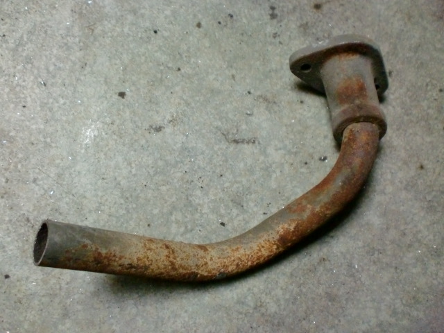

First we have to remove the support from the axle tube. I thought the fastest way is to cut twice with a dremel like a V to avoid the original spot weldings:
Be careful not to hurt the tube! Wink

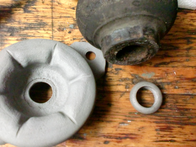

Now pull out the upper part of the support out of the rubber. It`s essential that the upper ring is salvable....

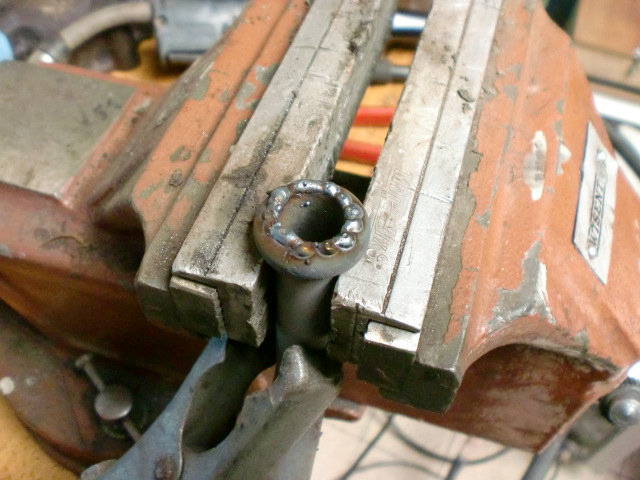

Now you have to find a tube with the correct diameter. Believe it or not, i used an old 36hp exhaust preheater tube, fits perfect Very Happy
Now i know again why i keep every vw scrap..... Wink

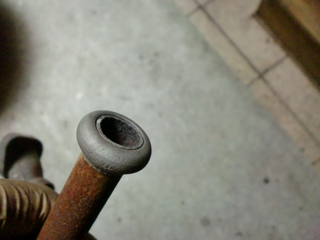

The upper "nipple" fits perfect over the tube:

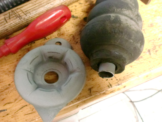

Take your mig and here we go:

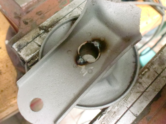

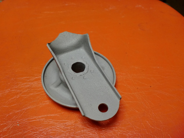

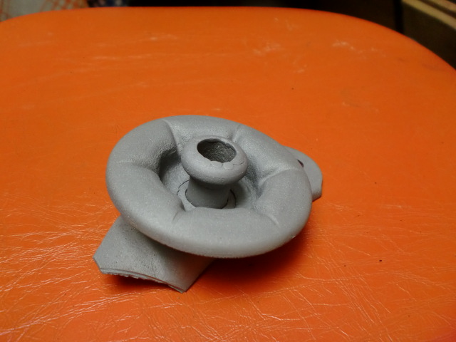

Now "clip it in" the rubber and drill a hole with the pre heater tube diameter in the support.
Put the tube with the rubber through the hole in the support you drilled earlier :
Fix it in the correct position with 2 spots, then remove the rubber and check angles etc. With only two spots you can correct it easily.
Now it`s time to weld:
Ready to reweld on the tube:
It`s essential to flaten the welding on the backside, otherwise it could collide with the cast iron of the RGB.
