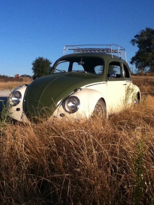

Hey all, just wondering whats a good distance to narrow a front beam on my 63 bug withought hitting the inner fender wells. Im running 135r15 tires in the front with stock smoothies. i like the look of a 7 inch narrowed beam but im worried it would rub. im not worried about having shock towers or any of that either. heres a pic of my bug just for reference.
