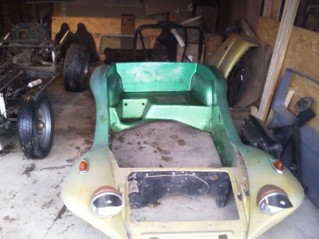

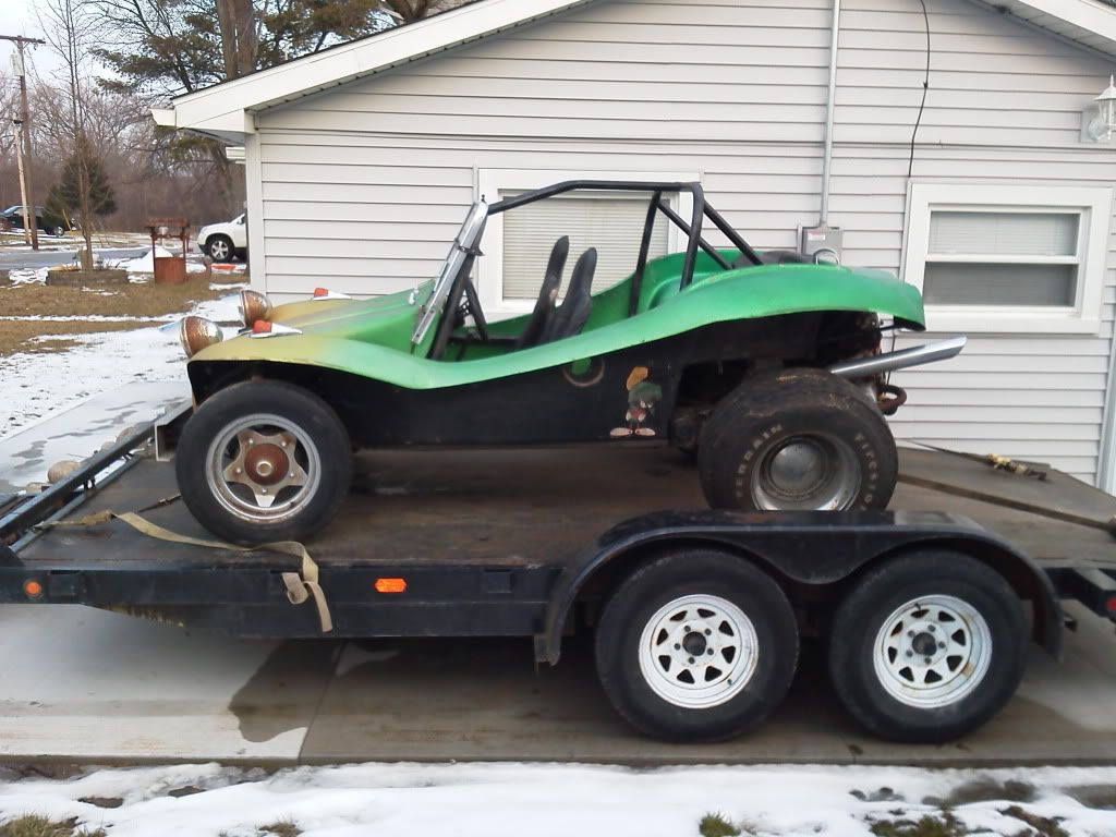

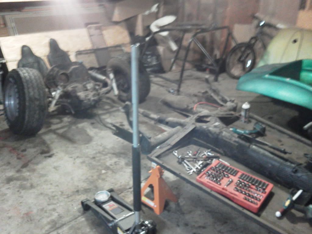

HI guys just jumped into my first VW!
I have been into jeeps for a long time and currently have a moded XJ. I was just browsing craigslist and ran across this and couple days later it was mine.. I want to get it up and running/ driving. Still not 100% sure on how in depth on restoring I want to go. I know I can spot all kinds of things just from pics of jeeps so here are some pics for the experts on VWs! The title says 78 but I don’t know for sure.
I need to get into some searching but would appreciate any and all comments!!
But it didnt take me long to get it running!
Ownner said it had sat for 7 or 8 years.

Nice project, looks something like an El Lobo body. Have fun with the build.

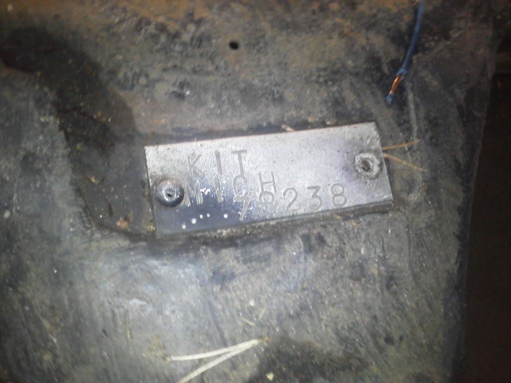

You might want to verify the Vin number on the pan to the title and/or registration before you go too far on that pan.
That rear is a swing axle and can be up to and include a 1968 bug but the front end is only through 1965.
If your title states a 1978 there is something fishy going on.
The back flat area around the rear inspection cover of the pan has the Vin number.
Post it.

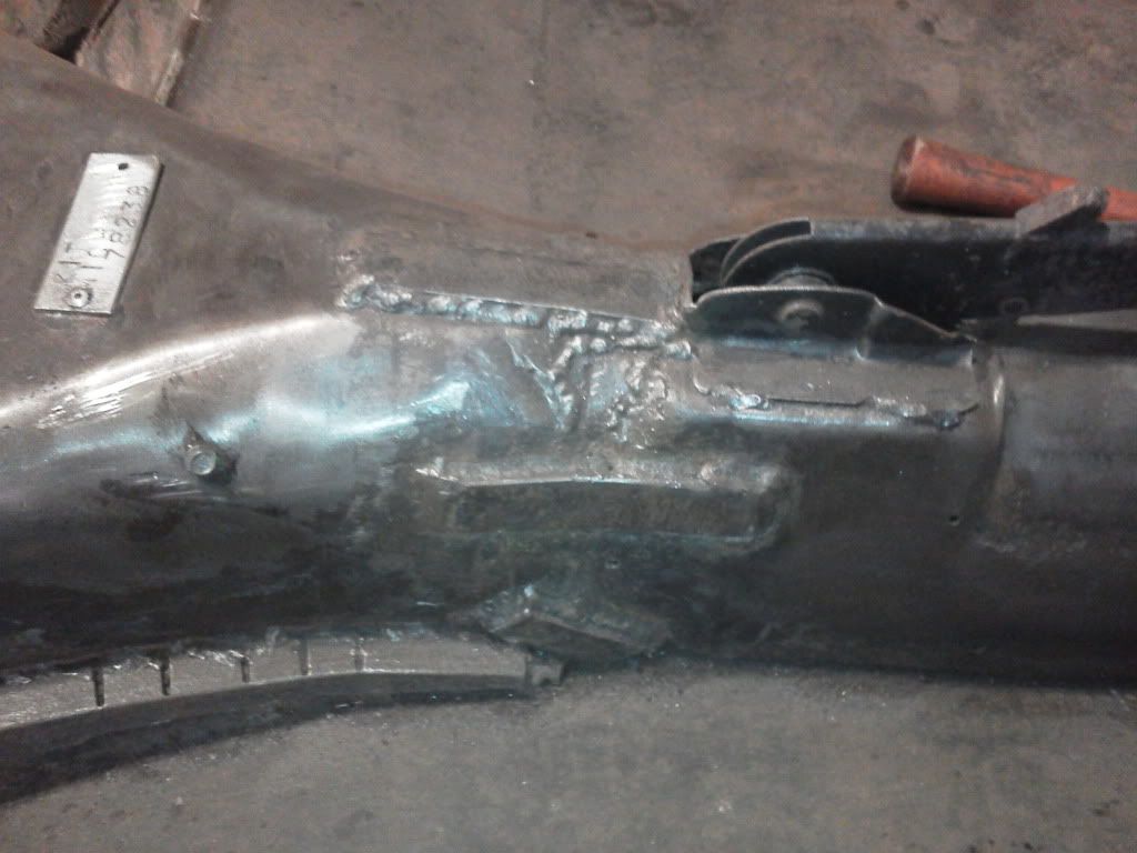

The title is a "kit car"... the only number plate I cab find is this, it matches the one on the tittle..

No worries. It looks to have an assigned title and VIN then.

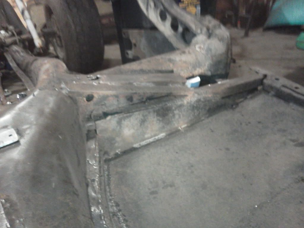

The pan/frame needs some repair but not much. I want to paint it all. What do you guys like to use? Whats the most durable do it your self stuff avaliable? For thr interior section I was thinking some bedliner/ herculiner stuff. It has held up well inside my jeep so I think It would be good here, but I dont want to do everything in it.

From what I can see of the body, it looks to be a El Lobo.
Nice project!

For pan cleanup and paint.... First I would media blast if option is available ( and the do any exposed repairs necessary) .... It's a real pain to try to clean it with wire brush and hand power tools.....
I usually primer mine as soon as possible (same or next day as media blast) with "Rust-O-Leum" primer (actually brushed on to get real sloppy wet in all nooks and carnies and actually seal things) ... Then "color coat" of Rust-O-Leum Satin Black... Real easy to touch up with brush or rattle can if need be...
Do not be to concerned about year model and VIN number when it come to year..... VIN stamped on pan (if its still there) near opening for access to shifter linkage will be year pan was actually assembled as a Beetle.... The date on title will probably be year the modified "buggy" was re-titled as a "custom build" car....
IF there is a "state" supplied VIN tab on car (appears to be) and and all paper work reflect correct numbers, registration should not be a problem....
And I will bet it is riveted on tunnel right over original VW VIN number.... DO NOT DISTURB IT IN ANY WAY.... State DMV people get all "pissy" about any VIN that appears molested....
Note circle in sketch, this is location of original VW VIN location...

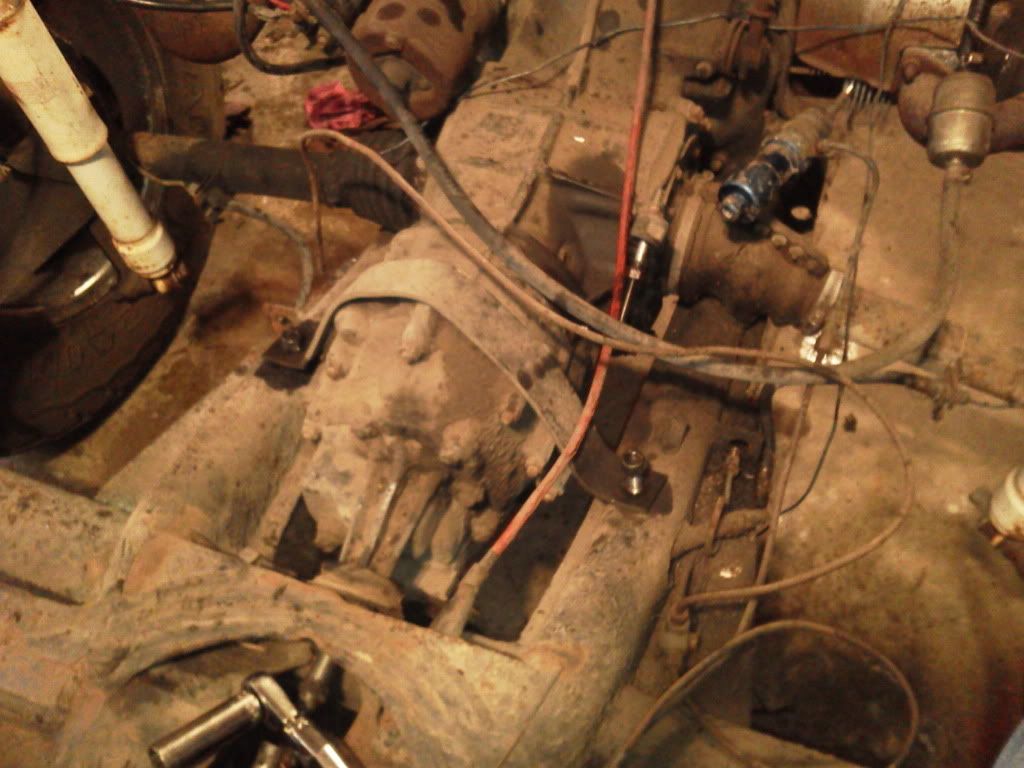

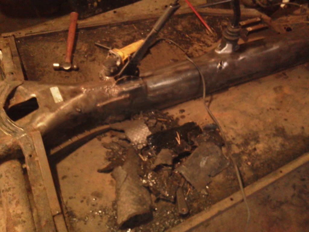

So I did some investigating and found I have a KO engine so type 3/66-72/54HP, well at least the block. It also has a weber 32/36 carb on it.
I teared into it a little more, Who ever did the conversion did a very sloppy job, I dont think they had a tape measure..... The splice looks decently sound. I think Im just going to true it up a bit and add in a few more supports in.
I dont know what this stuff was but it was nasty, it at least kept the metal from rusting though...
Any reason you can see why this strap was added in? It just goes over the trans, I dont see why it would be needed.

PostPosted: Fri Feb 17, 2012 8:36 am    Post subject: Reply with quote
It was added because the transmission mount at the nose of the transmission got old and allowed the front of the transmission to swing upward and make a loud and annoying thunk every time the previous owner let out the clutch. Instead of replacing the transmission mount with a new one, he drilled big holes in the frame horns and added that strap. Its the kind of work you'd expect from someone who just cut the front bulkhead of the body out to install new pedals instead of fixing the ones he had.
You can get a new transaxle mount or even upgrade it with a heavy duty one.
http://www.cbperformance.com/catalog.asp?ProductID=643
If you remove the strap, weld up the holes the PO drilled in the frame horns. They will crack and break.
While your at it junk those hydraulic pedals, glass up the hole in the body a reinstall a set of stock pedals with a dual circuit master cylinder and clutch cable.
I wouldn't leave my engine and trans hanging by the axles in the garage. I don't think its doing your side covers any good. Put some blocks of wood under it

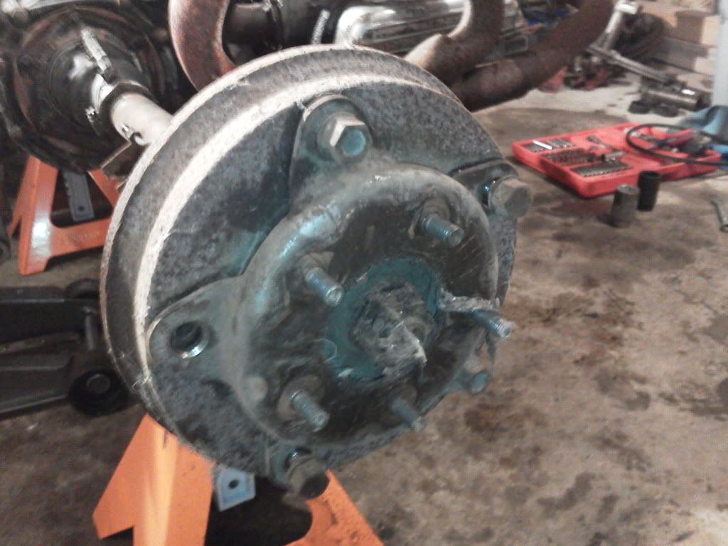

So whats your guys thoughts on tire and wheels?
It has the narrow on the front and wide in the rear... The tires are shot and the wheels are rusty. Im not against painting the wheels and new tires but not sure on the big wide tires on the back. It also has adapters on the rear... Measure 5x4.75
Im looking for the most cost effective approach, maybe new wheels and craigslist tires type of thing...

I'd look for 15x7 or 8 rear and 14x 5 or 6 front. 5x4.75 is the Chevy bolt pattern. There ought to be something reasonable there in Michigan off a Chevy second hand. Maybe even a set of old American or Ansen Mags.
