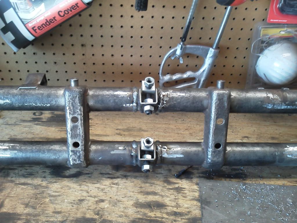

Got the adjusters installed...

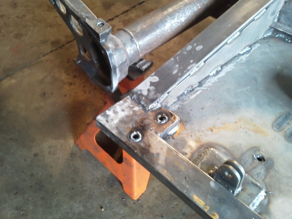

PostPosted: Sun Mar 18, 2012 7:36 pm    Post subject: Reply with quote
Some more bracing and they catch the seat bolts.. maybe a little over kill but Im ok with it!, I need to figure out a good way to mount the belt mounts. Just like the seats, I don't want to just weld them directly to the 14 gauge floor.

PostPosted: Mon Mar 19, 2012 6:02 pm    Post subject: Reply with quote
Got the seat belt mounts burned in.... Im just about ready to prep and paint...

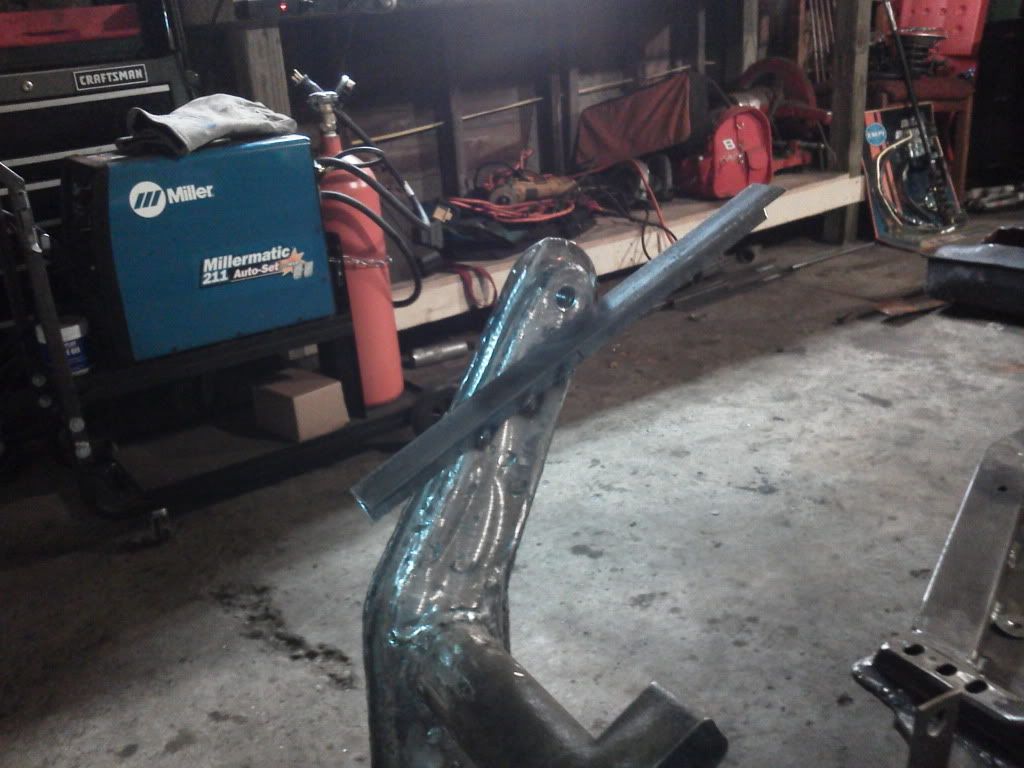

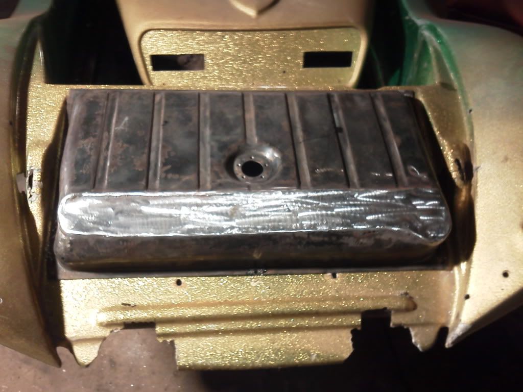

Gas tanks....
Mine needs clearenced and a new nipple installed because mine rusted out but I guess it needs one installed in a different place due to the angle its at now.
So i need to find a weld in nipple and attempt to patch up the tank....
Any body know of where to get somthing? been searching with out much luck.
Next to mount it I came up with this simple approach using angle iron, any reason not to do this??
No. Just make sure your body will fit and run two pieces to connect them to create a rectangle box so the tank will be supported on the full parameter.

PostPosted: Fri Mar 23, 2012 7:05 pm    Post subject: Reply with quote
Craigslist find!

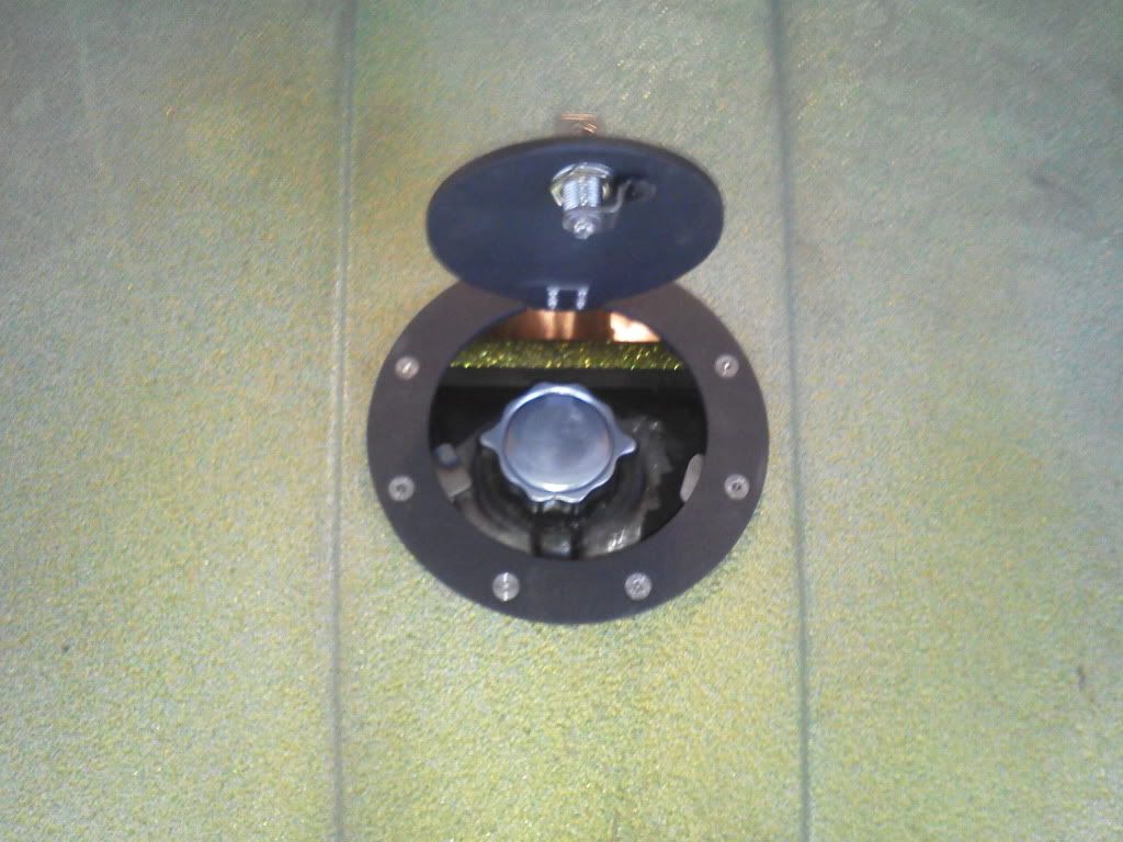

Made the tank mount, I didn't full box it because the top peice would of had to be coped around the bulkhead, I think this should suffice, the previous owner just had the tank floating in the fiberglass Shocked
Yes I know theres no filler, need to order one, 15 dollars insteadof trying to cut out the old one....

PostPosted: Fri Mar 30, 2012 3:18 am    Post subject: Reply with quote
Looks great. The only thing you'll have to watch out for is spilling gas. If you spill just a little taking the hose out you will definetly smell it in the cockpit Shocked

PostPosted: Fri Mar 30, 2012 5:31 am    Post subject: Reply with quote
I guess then I would just have to drive really fast to flush out the smell... Very Happy

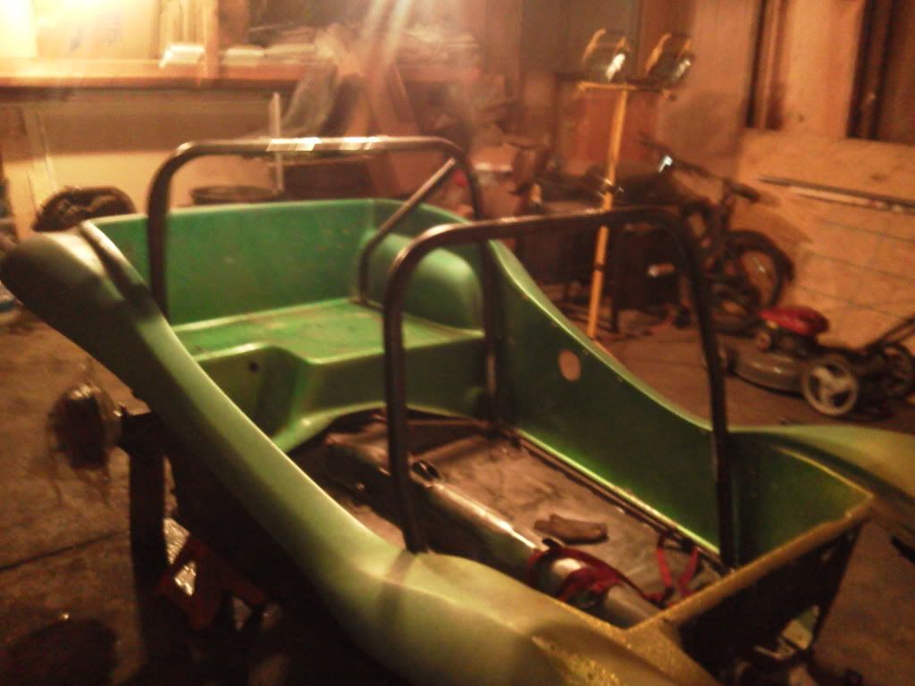

PostPosted: Sat Mar 31, 2012 7:34 pm    Post subject: Reply with quote
Rear support...
Top plates that the cage will be welded to..
had to cut up the entire cage to refit it to my new pans....

PostPosted: Sun Apr 01, 2012 8:12 am    Post subject: Reply with quote
Believe me when I say the smell follows you around once you've been sitting in it for a few miles Shocked

pallen
Joined: February 15, 2012
Posts: 390
Location: Michigan
pallen is offline
PostPosted: Sun Apr 01, 2012 5:52 pm    Post subject: Reply with quote
The "reassembled" cage... I plan on adding in a bar under the dash area and one in the back for the sholder harnesses to bolt to.
Crush sleeves at the cage mounts...

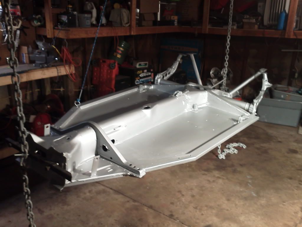

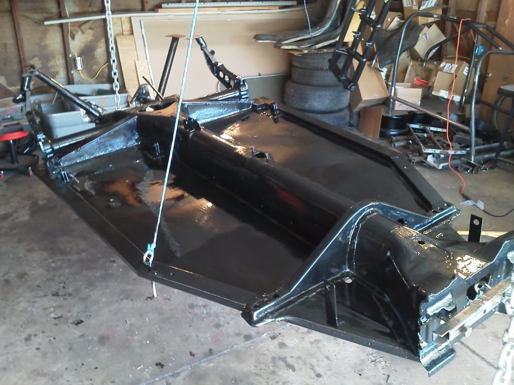

PostPosted: Wed Apr 04, 2012 6:11 pm    Post subject: Reply with quote
First coat of primer down....

pallen
Posts: 390
Location: Michigan
pallen is offline
PostPosted: Fri Apr 06, 2012 11:44 am    Post subject: Reply with quote
Painted!
Can't wait to start puttting it back together...

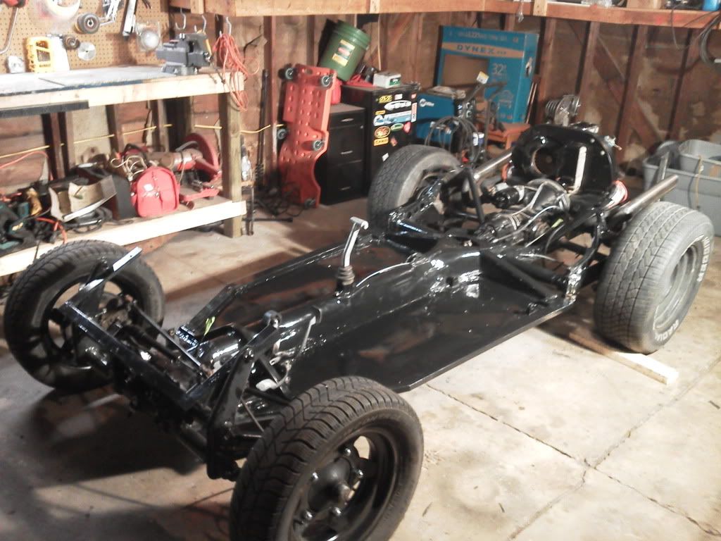

PostPosted: Sat Apr 07, 2012 8:13 pm    Post subject: Reply with quote
Roller!

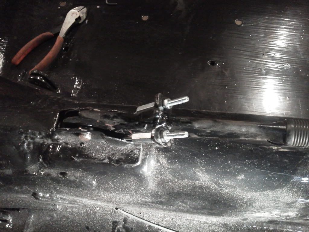

So I wont be resusing the front wheel cylinders....
Got the ebrakes shortend and hooked up, I didnt have the top peice so I made it... they will probably need shortened more but I will wait till I have them bleed and adjusted first.
