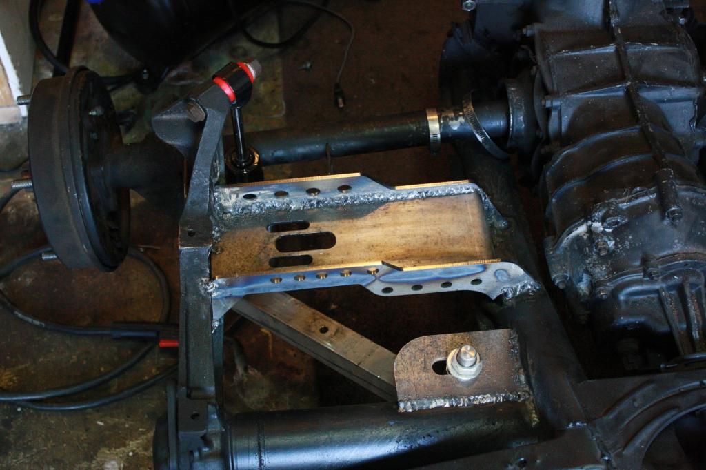

PostPosted: Sun Apr 21, 2013 7:15 pm    Post subject: Reply with quote
got my air ride stuff just waiting on my beam to arrive. here are some install pics! hopefully a video of the travel soon.
gettin better with the welder.
leveling the control arm mounts.
tacked them in
upper bag mounts pretty much tacked in place.
new lower control arm mount at the bottom of the rear shock
this is were you trim up the brace in the corner of the frame horn and the torsion tubes.
lower control arm mount from the front view
pretty much all welded in. excuse some of my messier welds,
