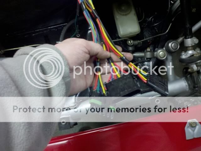

vincent9993
Joined: November 09, 2006
Posts: 1648
Location: Montreal
vincent9993 is offline
PostPosted: Mon Apr 09, 2012 8:42 am    Post subject: Reply with quote
EVfun wrote:
It depends a lot on how you plan to wire the car. I recommend you do not wire your car predominately behind the dash. It is real hard to work under there as you can't open the car door to easily lay on the floor and look up.
You mean like this?

PostPosted: Mon Apr 09, 2012 9:44 am    Post subject: Reply with quote
vincent9993 wrote:
You mean like this?
Jeez, my back is starting to spasm just looking at that picture.

Vincent - if you have to get under the dash, at least mount the seats so they come out easy so you can lie on the floor and have more room. That is almost as bad as a fuel pump that is hard to get at! LOL Tom
