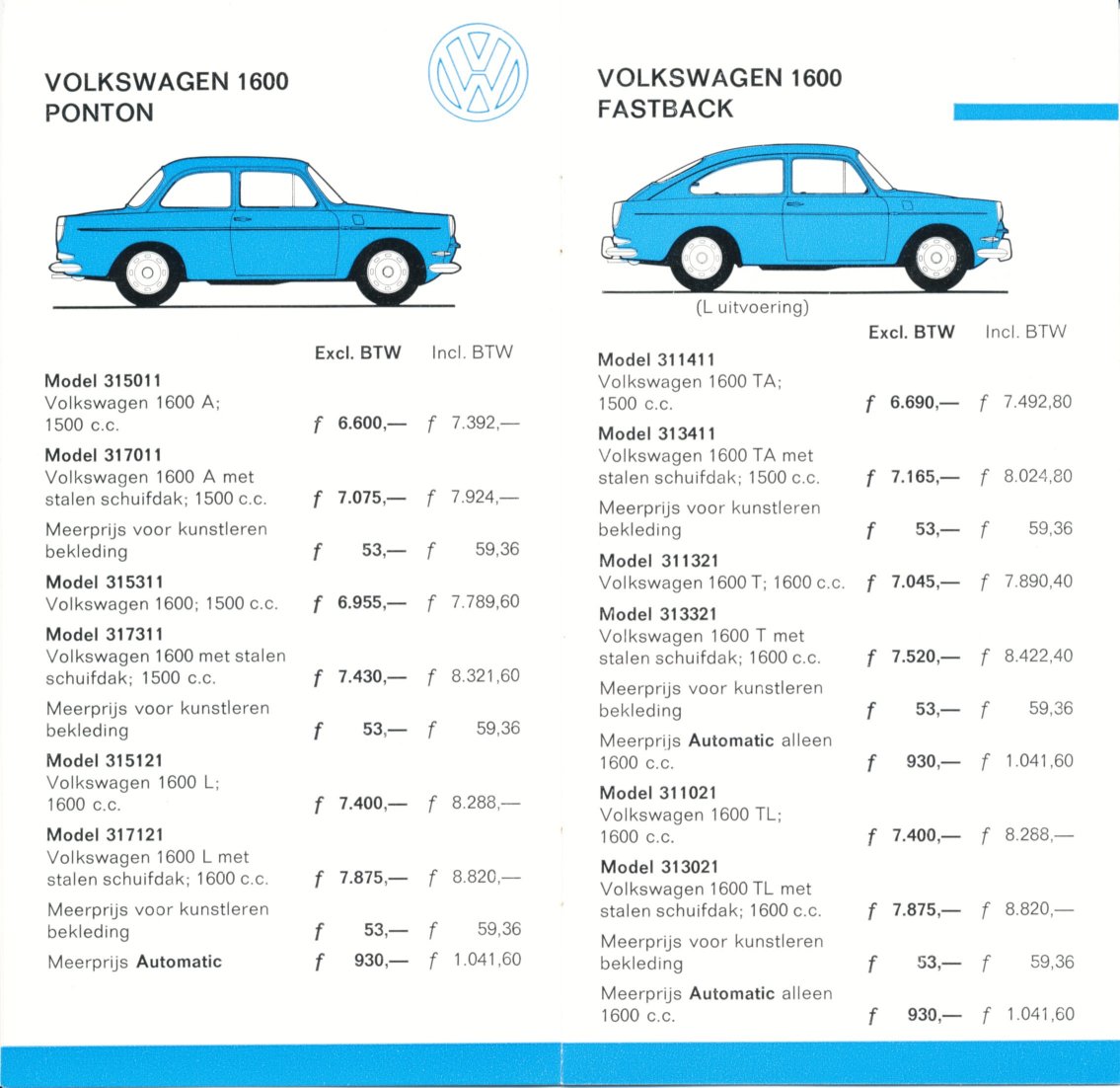

Slow 1200
Joined: July 02, 2004
Posts: 906
Slow 1200 is offline
PostPosted: Mon Apr 16, 2012 4:22 am    Post subject: Reply with quote
Rome wrote:
Actually, all Fastbacks since day 1 were 1600cc (OK, 1584cc).
unless you got a super-rare 1600TA, wich is a fastback with sparse interior and a sidedraft 1500cc engine, they do exist, very rare in Europe, probably non-existant in the US

Slow 1200 wrote:
The USA got the most expensive (fully loaded or top of the line) version of the t-3 line, with the sunroof being the only real "factory option". Yes, you could get a radio, radial tires (with or without a white stripe), floor mats and the like, but those were "dealer options", that were installed at the dealership.
