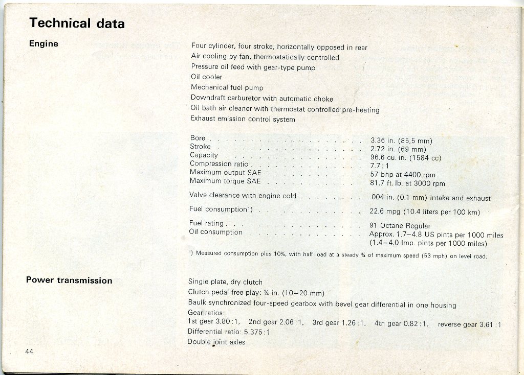

Did they teach you how to research things when you were in school? If not please tell me what changes we need to make in our education system so that people in this county are self-sufficient. It took less than two minutes in owner's manuals here to find and post these pages with gearing and rear axle ratios.
1964
1967
1968

1968 bus at 60 mph with stock 185 14 tires, 3,570 rpm. overall ratio 4.40
1967 bus at 60 ditto 3,750 rpm. overal ratio 4.6something
