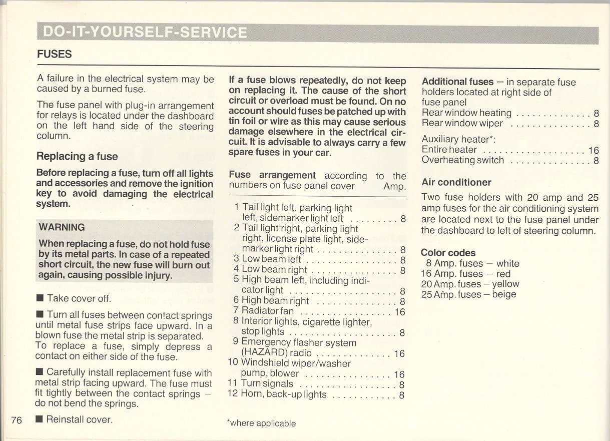

PostPosted: Thu Apr 26, 2012 12:15 am    Post subject: Reply with quote
85??
I'm sure this can help you.
From a 85 owner's manual

PostPosted: Thu May 03, 2012 10:25 am    Post subject: Reply with quote
Thanks for the replies.
The problem I had identifying the fuse or why I thought it was above 16 amp is because they are the old tin ones. The strip is a lot wider then the new brass strip.
The Van has suffered some serious re-wiring problems by the previous owner. I knew about some of it but it's all way over my head. This will be a different topic for help one of these days when I have time to tackle it.
Let's just say I traded 3 derelict vans for one but the new one has the same number of headlights that the 3 vans had combined.
