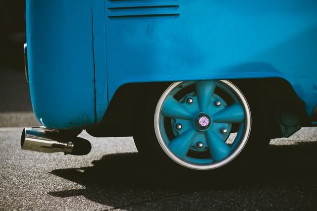

Hey guys I just purchased a 66' 21 window it's a running driving bus. I was looking up the vin and having kind of a hard time decoding it. This is my first VW purchase in along time so I am trying to re educate myself. The vin reads 256140035 on the tag on the inside upper roof console and back in the engine bay it reads the same. Here are some pix from the drive home!

What in the world happened to the corner? Looks like someone went crazy with a canopener!
Nice find, however. It is nice when you can drive them home.

Nice find, that bad boy is straight out of a early 90's VW Trends with that color blue and the color matched 5 spokes !

This photo actually looks like a HVW or VWT cover shot from about '92!
