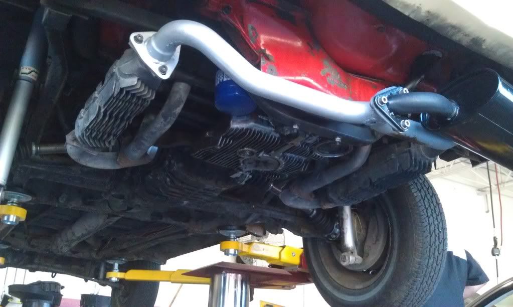

I did do the times as you described but set my carburetor by ear. Before setting my carburetor it ran like crap and would fall flat on its face when accelerating.
Here is a picture of the bottom are the cylinder vanes the fines that surround the cylinders?

PostPosted: Tue May 01, 2012 7:48 pm    Post subject: Reply with quote
Oh I thought you meant the tins next to the heat exchangers. Didn't realise you were missing the metal off them too!
Yea all the tin is gone from the bottom. I don’t have a heater or any hoses or tubing.

If you don't have the tins under the cylinder head, you shouldn't run a thermostat as the air passing under the bus may keep the thermostat from heating up fully. This may be more of a cold weather problem than a warm weather one though.
Do you have the boot that seals the oil pressure switch to the tin and the boot that supplies cooling air to the alternator?

Those tins you are missing are very important to cooling your engine. My guess is that you will have over heating issues.
Those bear heat exchange pipers are going to give off a lot of heat which is going to go right up into your cylinder heads.
Usually that heat is moved away from the engine by the fan. You might be okay as long as you are moving, but if you get stuck in traffic that engine is going to over heat.
I'm sure there are plenty of people that will chime in that will say they have run that type of setup for years, but my advice is to run the correct setup.
