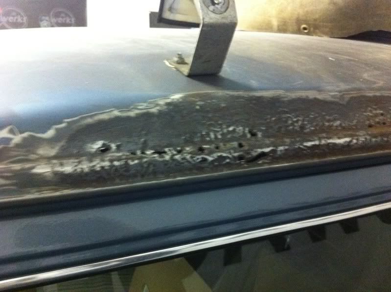

The nuts are welded to a L bracket inside the luggage rack that. They must be on there pretty good. Keep working on them. Watch out on the screws they r cheap and can strip. Make sure u use a big screw driver. If you have not removed it in a long time. I replaced mine with stainless steel bolts. You will be surprised what is under there. This is what I found.

Ohlott! That looks scary! I'm hoping for better!
Holy crap...I mean, that will buff out.
I thought mine was bad.
