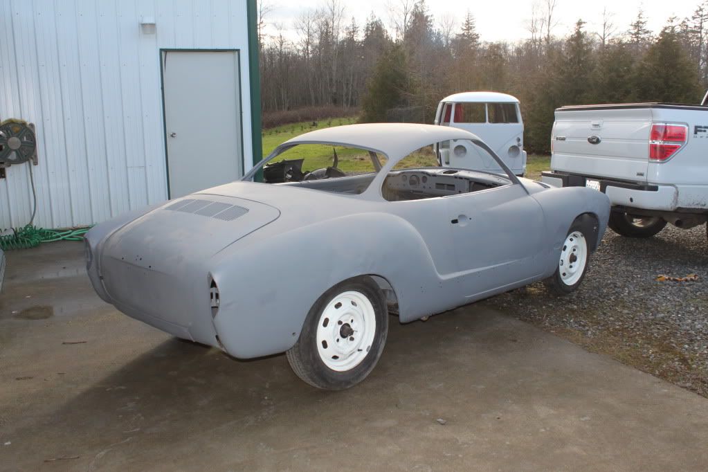

Well, my 69 in stripped and ready for body and paint work, and my 68 has the body off and I'm in the process of doing the pans. The only car I will be bringing is the green '71 I have in the classifieds right now....
http://www.thesamba.com/vw/classifieds/detail.php?id=1327183
Here's how the others sit....
1968 pan work:
1969 stripped/primered:
