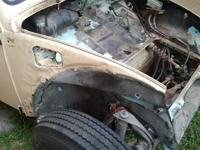

Finally got a beetle. Paid $1500 for it and parked it to plan my baja build.
Have been lurking the site and found alot of great info. It's rust free body with some small holes in the pan and a one piece front. I want to cut the front better,install a full cage and front tubes for the front clip to attach to and front tube stinger. Probably replace pans(still not sure) and any other suggestions. I took all the wiring out as it was hacked to pieces.

You say you want to cut the front of the body cleaner.
I suggest that until you get the full roll cage installed and braces from the cage A pillars to the door hinge mounts, that you leave as much of the front 1/4 panels as you can. At least cut no farther back than the fender bolt hole just ahead of the gas filler. You want some metal in there to support your doors so they don't sag. And you'll still need something to support the gas filler neck.
Yeah I agree and have been looking at cage options.
