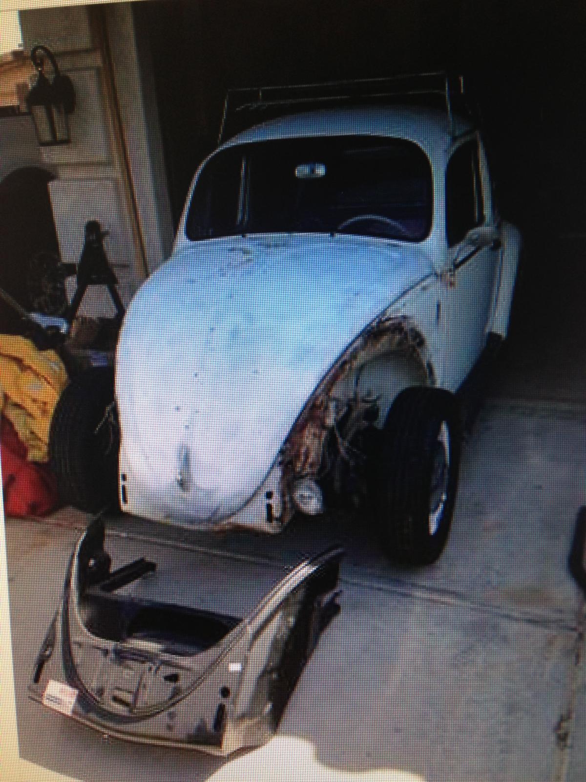

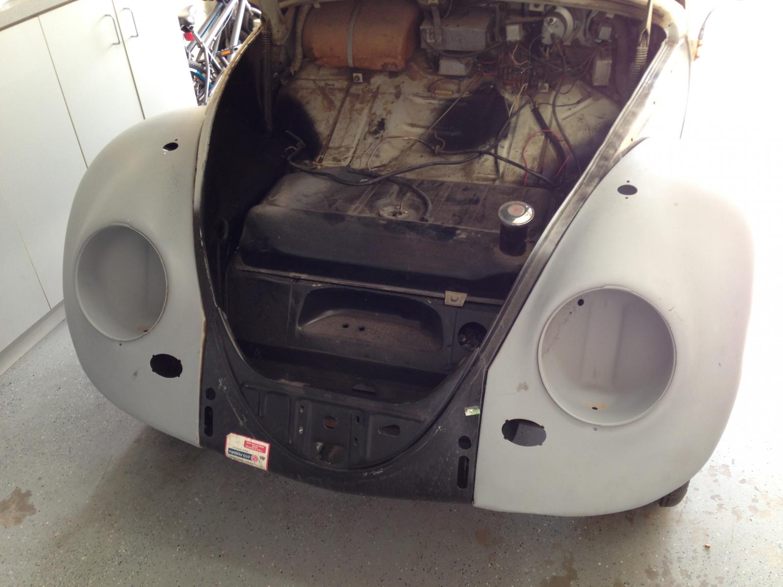

So after much back and forth and trying to decide where to start with the car we just starting pulling things off and cleaning up what we could.

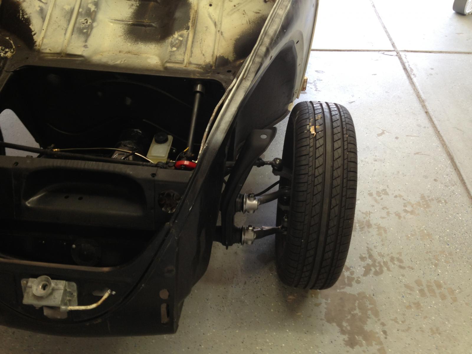

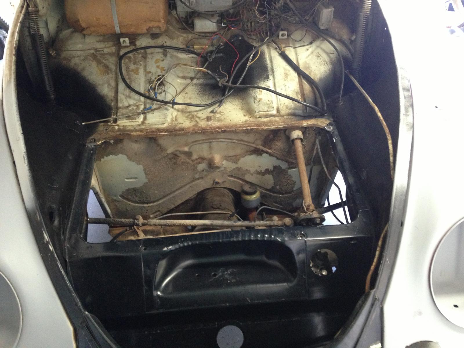

Since I didn't feel comfortable with my welding skills, I found a local shop to do the front clip repair. So that's what we started with. The car came with a new aftermarket Brazilian clip that I wasn't sure I wanted to use but after much debate we decided to use it.
Started gutting the front end so that the fabricator could focus on his job.

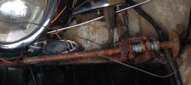

Hooking up this sketchy bar for the first time, Also came with the car
The end result
I don't like the fact that the access holes aren't like factory Sad

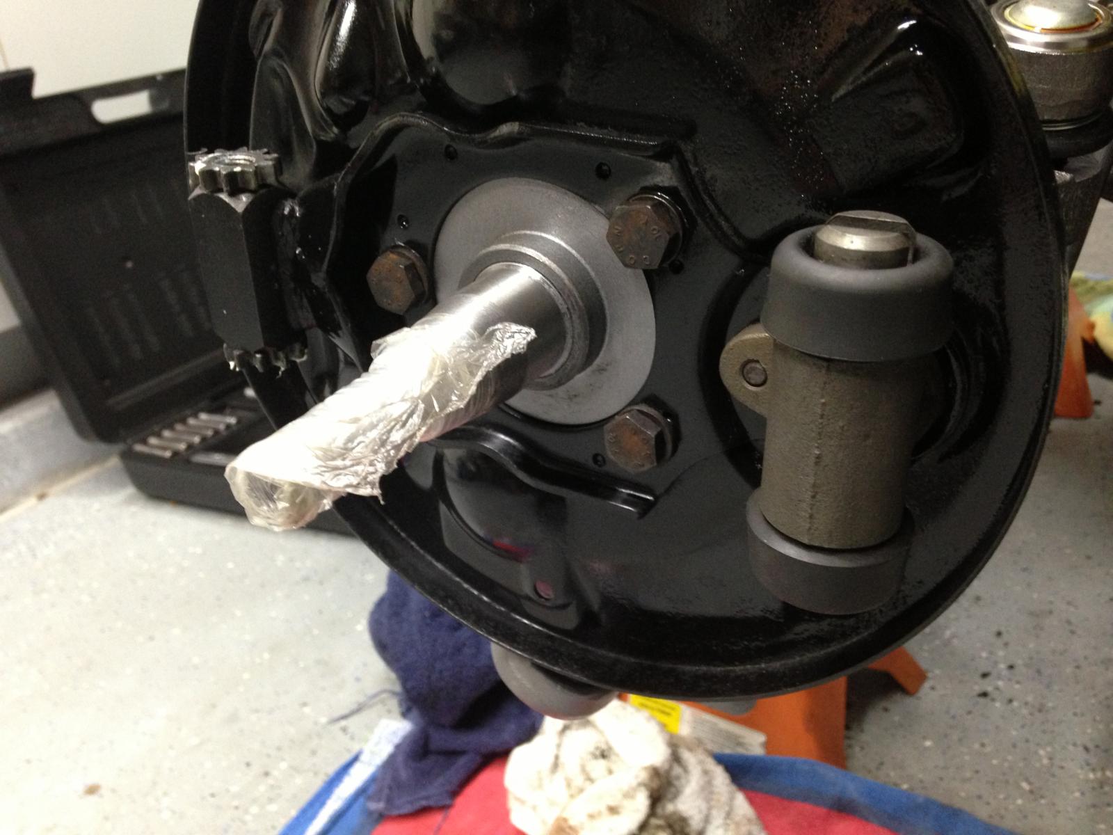

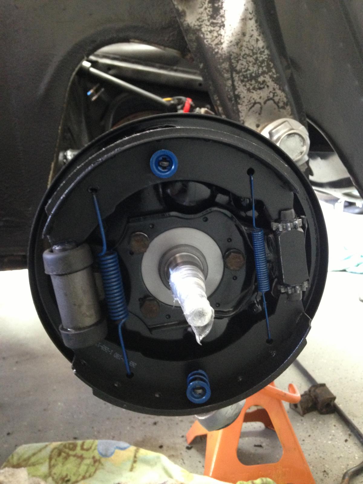

So once we got the front clip sorted out we figured we'd work on brakes and suspension. So we ordered some stuff from CIP and started with upgrading to a new dual circuit MC since we found the one in the car had a broken mounting tab.
Pretty Crusty
So I decided to try EvapoRust and soak all of the hardware and bolts etc.
This is how they came out after soaking overnight after these results I decided to lay the backing plates in a 5 gallon bucket and soaked those as well.
Front brakes all done and all OG hardware except for the shoes
New brake lines and Hoses and Dual Circuit MC
I think I'm pretty happy with the results, lots of patience.

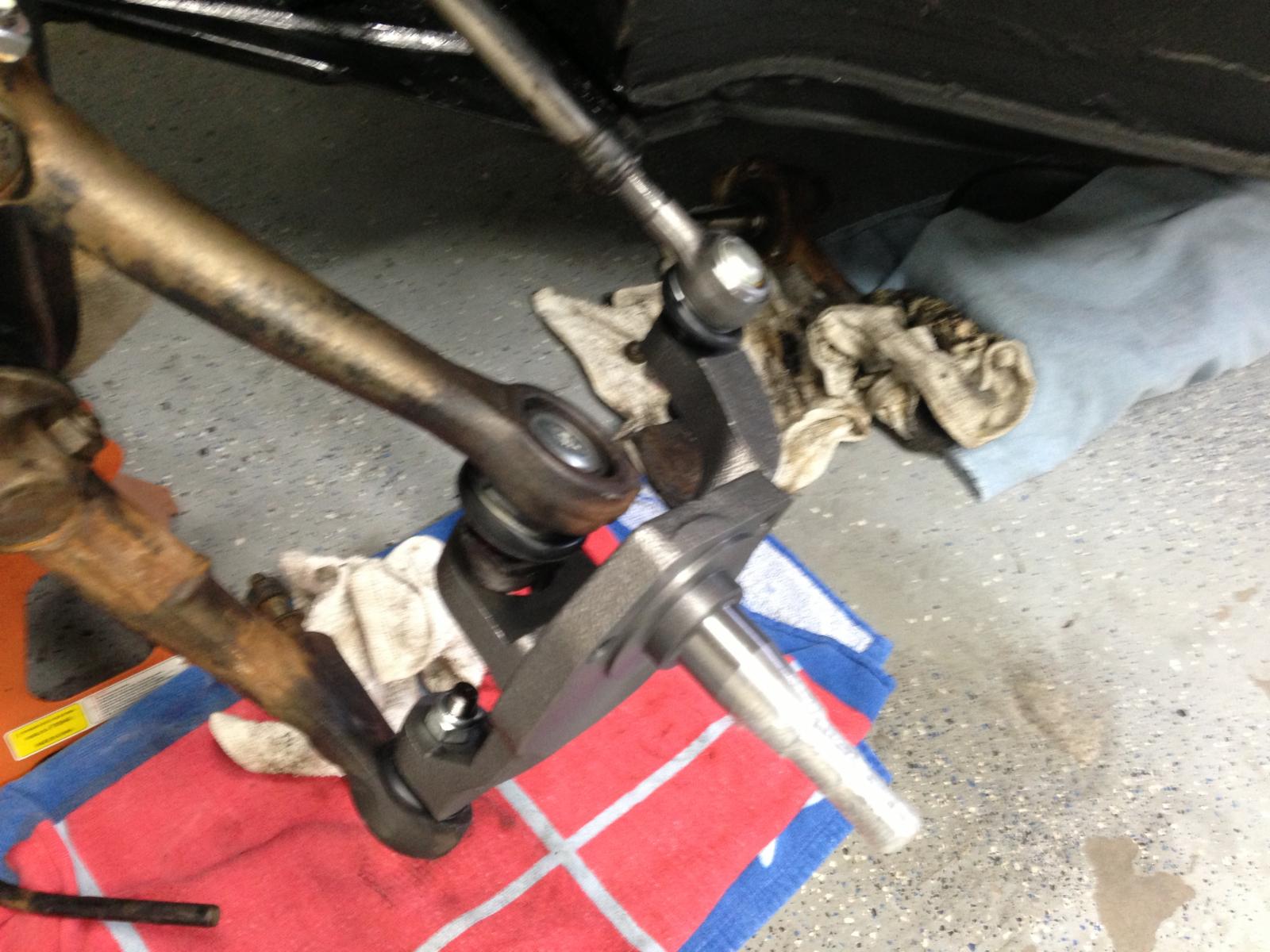

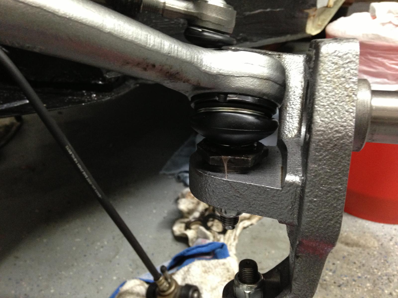

So while doing the brakes we also decided to take care of the front suspension as well. the Ball Joints were shot and apparently replaced at some point in time and not done right as we soon found out upon removal.
Rented the press from O'Reilly's worked very well. was nervous something was going to fly out and take off my leg. You do need the Ford Taurus adapter for the lower BJ.
Came with the car
Trashed, no wonder the suspension was banging and didn't move much.
So we also ended up going with some 2.5" drop spindles from Pete @ AirKewld while we were at it. I think it was a great deal considering his package includes the inner bearings and new outer tie rod ends. We will definitely be dealing with them more in the future, if we decide to do a beam or airbag suspension. They really know their stuff.

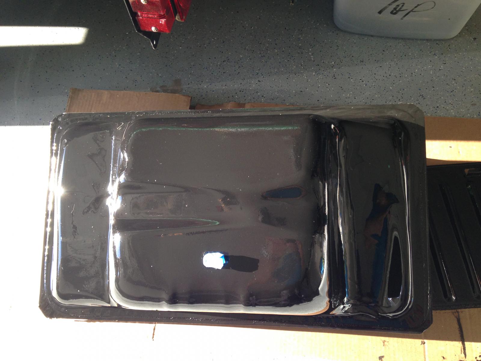

So while the tank was out we cleaned it up and got some POR-15 on it. the PO apparently replaced the OG one probably when the front was hit with this one. The inside was pretty clean and not rusted so just needed cleane dup on the outside and put a new fuel outlet on.

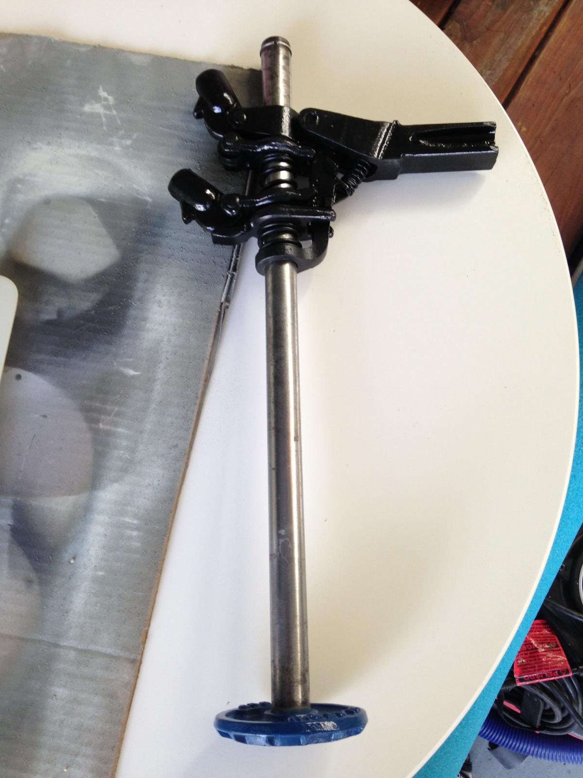

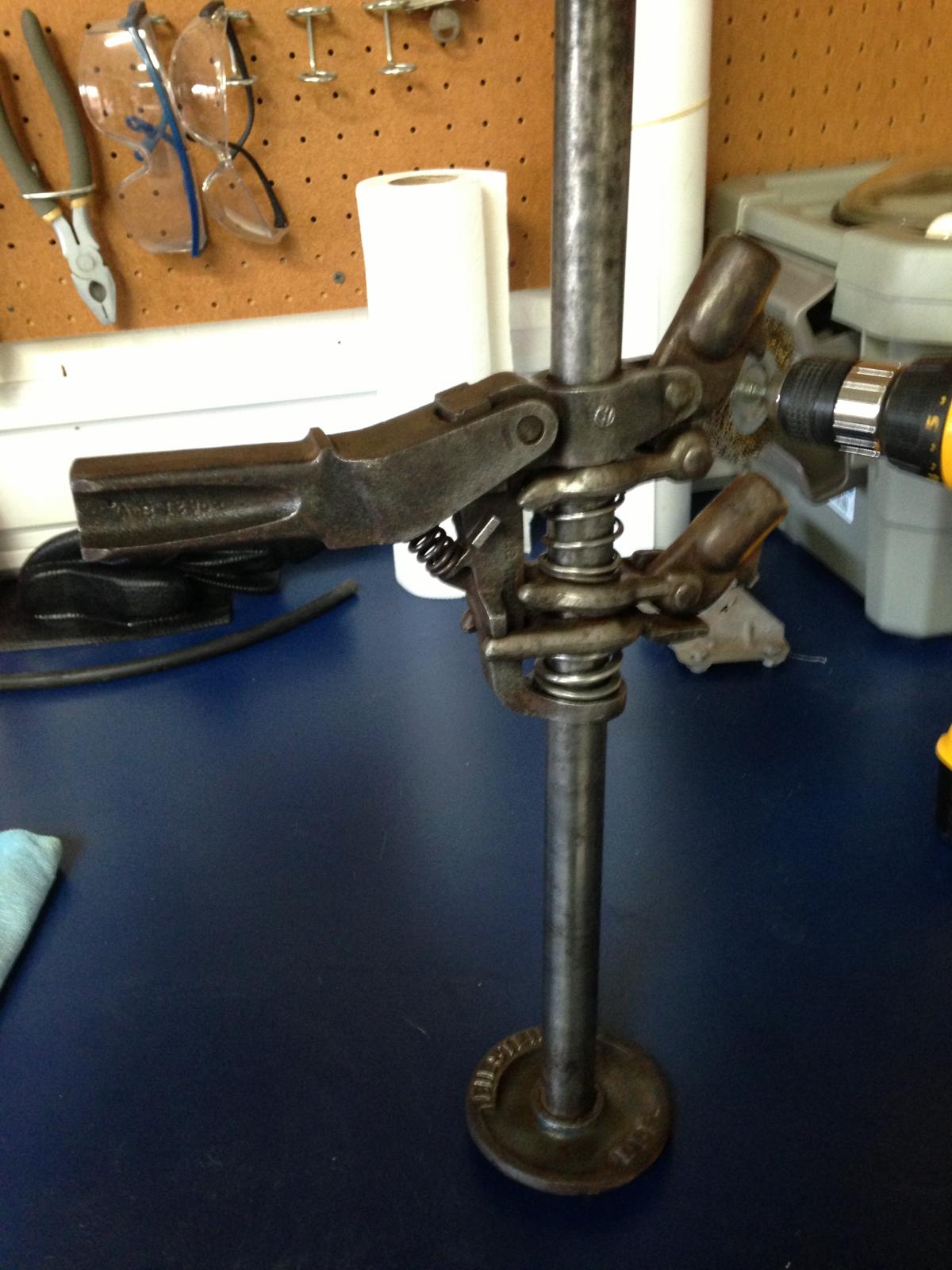

Next came the Jack Resto.
We are still in need of a jack handle if anyone happens to have an extra one lying around...
Wire brushed the heck out of it
I do believe it's the little details that count.
What do you guys think so far?

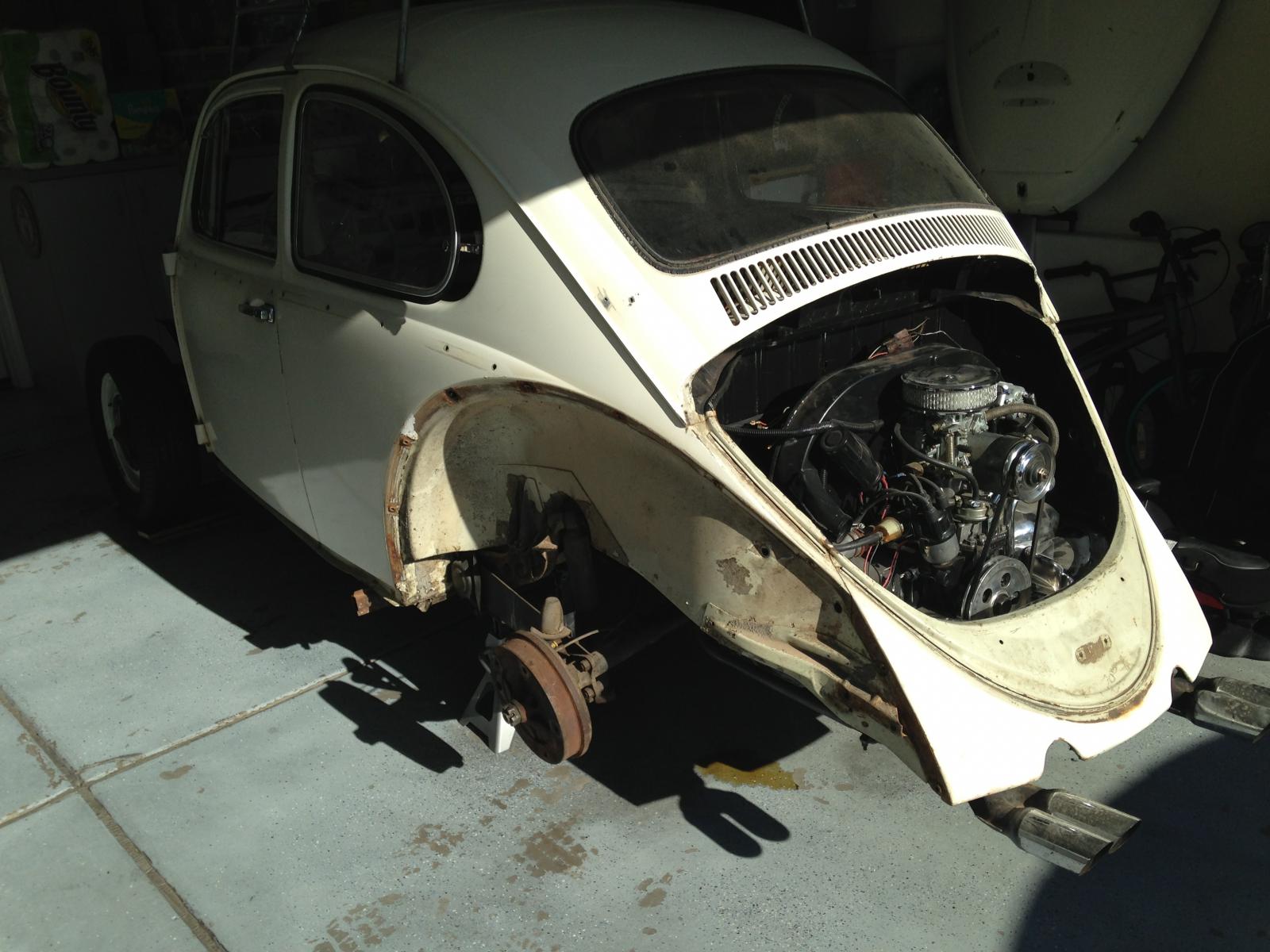

PostPosted: Wed Nov 12, 2014 12:06 pm    Post subject: Reply with quote
So once again we've come to a critical point and need to really decided what we are going to do about the paint. After much back and forth and trying to decide what color we wanted to get the car painted, my oldest son really likes the Blue colors, as do I, but I thought in this case we should try to keep the car as original as possible since it was in such good shape. The car had been re-sprayed once on the outside but the door jambs and dash hadn't been touched from what I could tell. I decided to make an executive decision as they say and take the 66 back to its original Pearl White even though the boys weren't so sure. I keep assuring them it will look awesome ( I hope I'm right).
So with that being said, even though I hadn't planned on it, we turned this project into a full body off restoration!
Interior gutted
Not too bad considering this was the worst off it all, I'll take it!
So after what seemed like a hundred bolts ( only snapped two off, one fender bolt and one rear bumper bolt) and with the help of a good friend the two of us were able to lift the body from the pan no problem.
One small problem, I miss calculated the size of the body and my trailer, due to the body flaring out, oh well we made it work. We will have to do something better to get it back home.

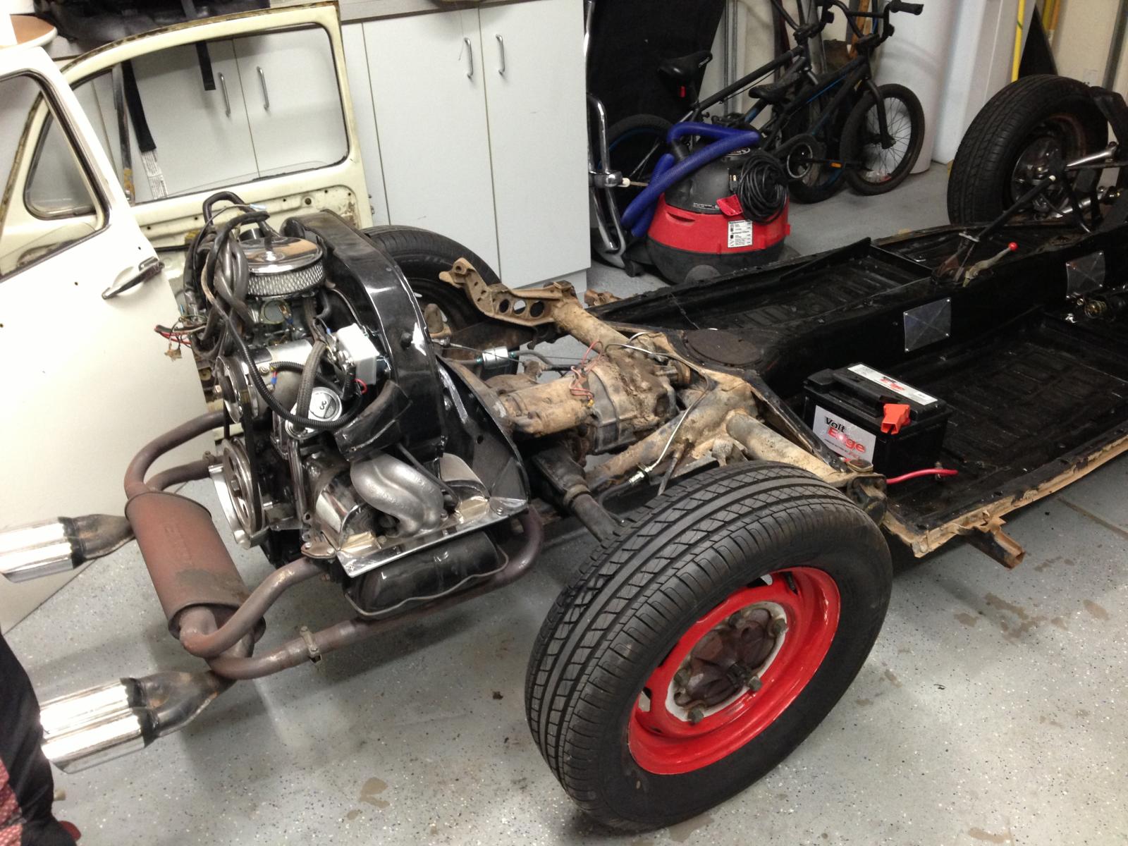

Now with the body off we have much more access to work on things and clean up the grimy tranny a little easier.
I also made some access hole covers to hide the ugly holes the po cut in the tunnel
I have to admit seeing the bug this way was really cool!
When disconnecting all of the wires, I felt better leaving everything hooked up to the engine ( not sure why, just made sense) and just pulled the harness through to the rear of the car.
We are going to get a Wiring Works harness to replace the old stuff, you can probably see the hard start relay in the picture, not sure if we need to keep this after we re-wire.

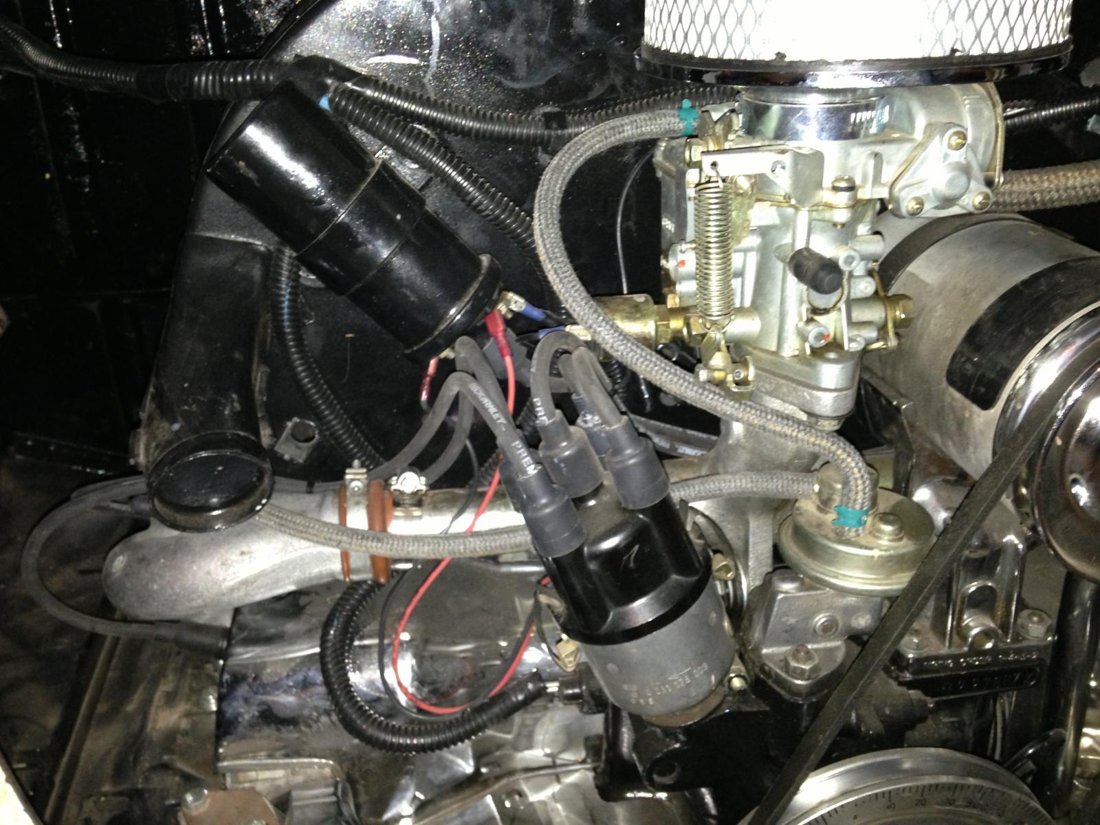

PostPosted: Thu Nov 13, 2014 2:42 pm    Post subject: Engine out! Reply with quote

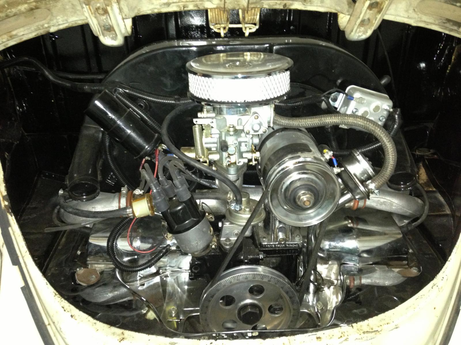

Engine 1600dp
anyone see anything I should really attend to?
I think I'm leaving it as is, the clutch and throw out bearing were recently replaced.
