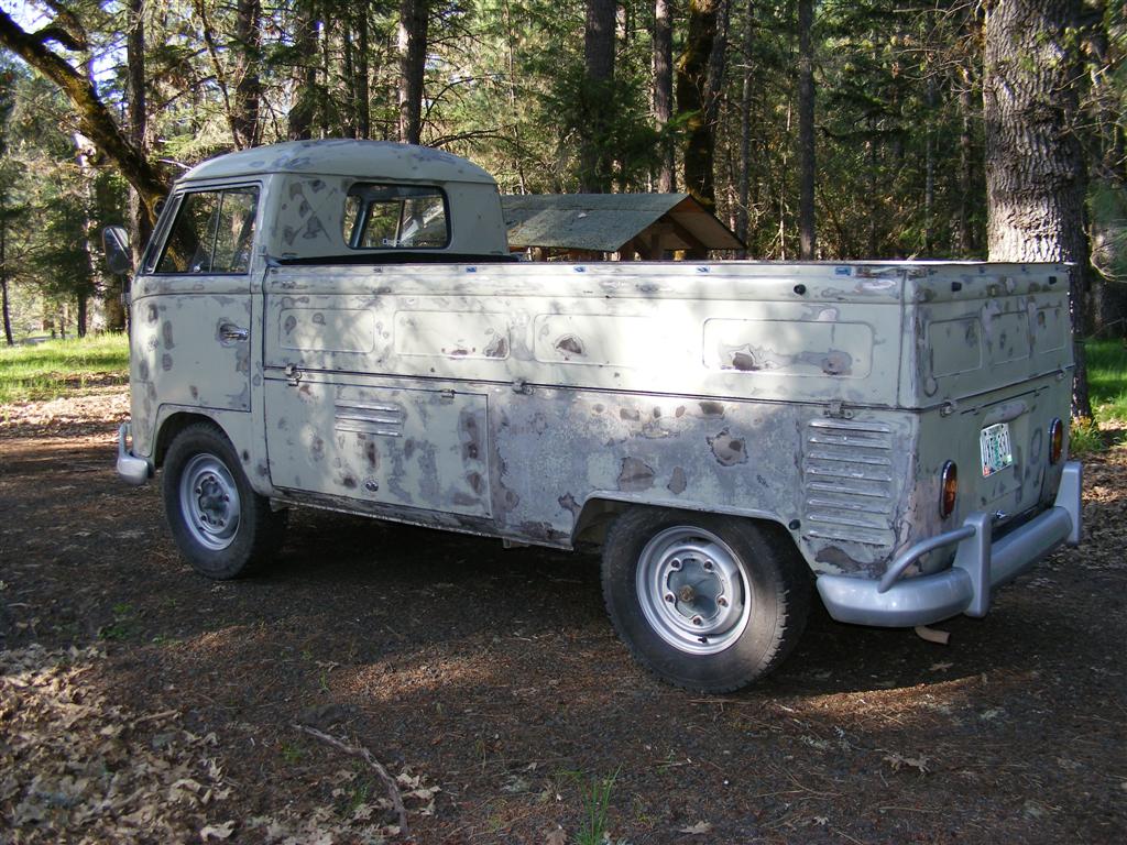

Nearly finished stripping the bus back to original L345 paint now. It's taken almost 9 months and hundreds of hours work but I've got 65 - 70% original paint and all original panels so I'm more than happy with the result. Just got the door tops to do and a couple of small patches to blend in.
Image may have been reduced in size. Click image to view fullscreen.[/img]
How it looked when I first got it.

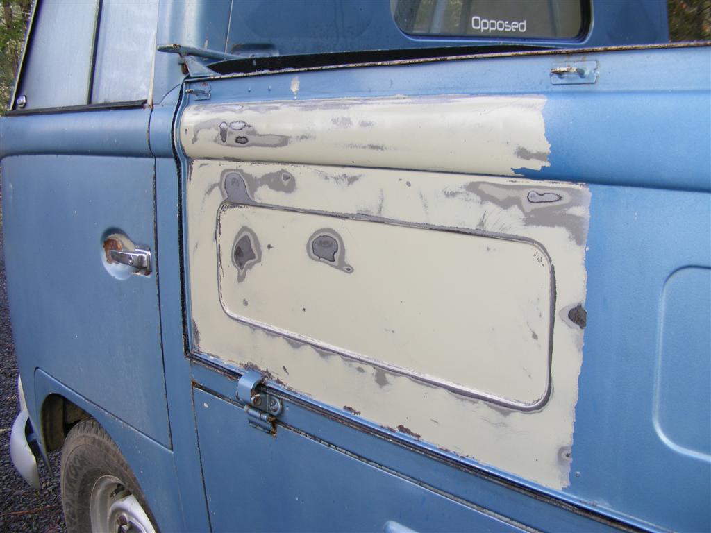

PostPosted: Fri Apr 20, 2012 9:38 am    Post subject: Reply with quote

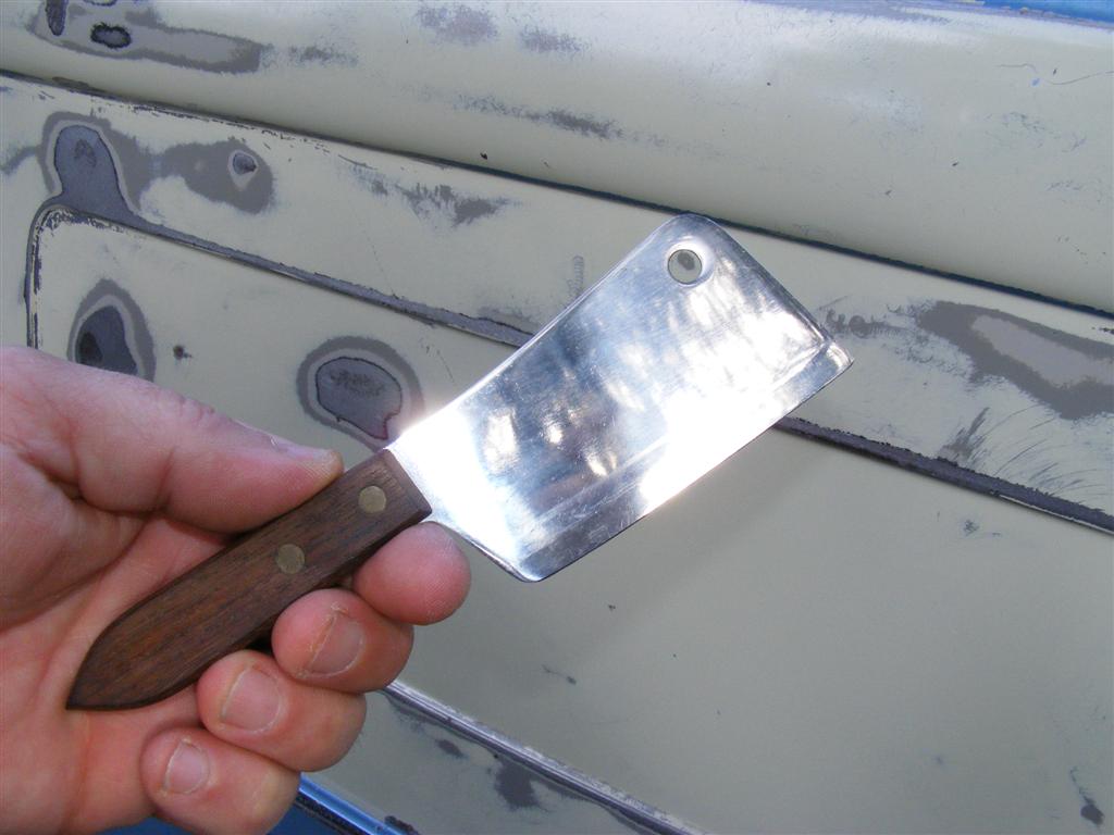

Image may have been reduced in size. Click image to view fullscreen. a little disheartening,but its too late to stop now...
Defying conventional wisdom since 1970
Thomas Pedigo
Joined: July 03, 2010
Posts: 770
Thomas Pedigo is offline
PostPosted: Fri Apr 20, 2012 9:51 am    Post subject: Reply with quote
Image may have been reduced in size. Click image to view fullscreen. I used this little gem. The original paint was protected from any potential scratches from my mini-clever,by the primer between coats and i only used the top/squared edge to pop the blue paint right- off.I then sprayed the primered surface with oven cleaner and scrubbed with a firm bristled nylon brush. The top curve of the clever is good for the recesses

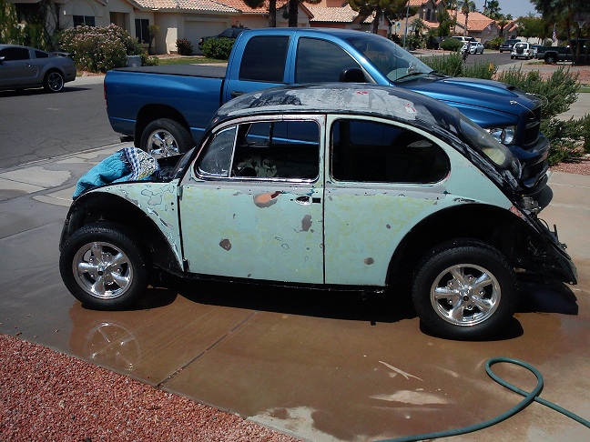

PostPosted: Sat Jun 02, 2012 12:05 pm    Post subject: Reply with quote
slowly mine is coming along. 8-10 hours into it, i'd say i'm a little more than half done. the roof will be the death of me...
