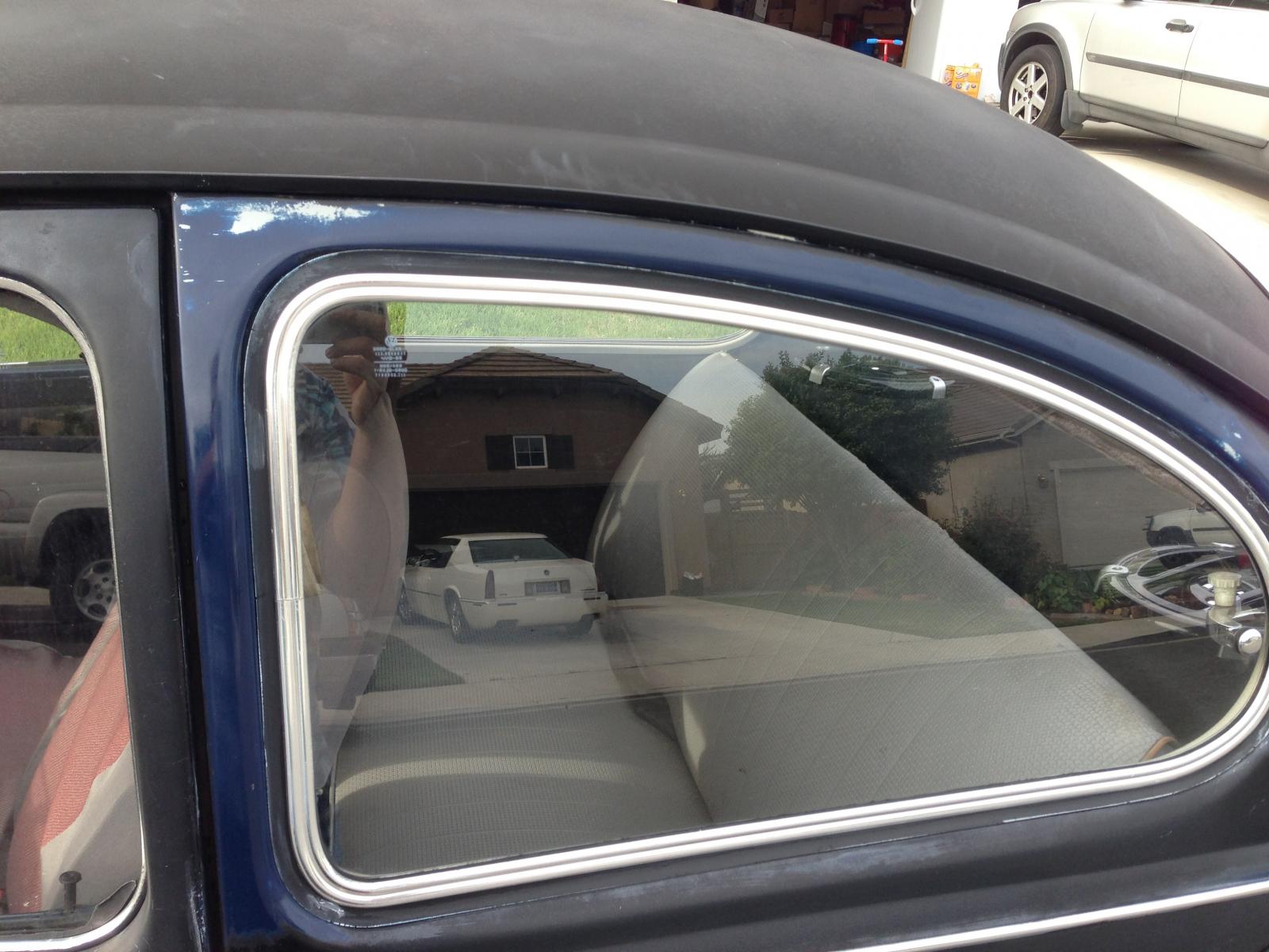

PostPosted: Sat May 25, 2013 9:24 pm    Post subject: Reply with quote
After spot checking a couple different places. I began stripping away the flat black and bringing back the original cobalt blue. I used Graffiti Remover and #000 steel wool. In certain places I used a razor blade to begin the stripping. Then I spayed the steel wool with the graffiti remover and applied it to the aftermarket paint. After a few minutes of rubbing I sprayed it down with a hose. It is incredibly tedious.
1969 VW Bug - 1600 on a 5" narrowed beam

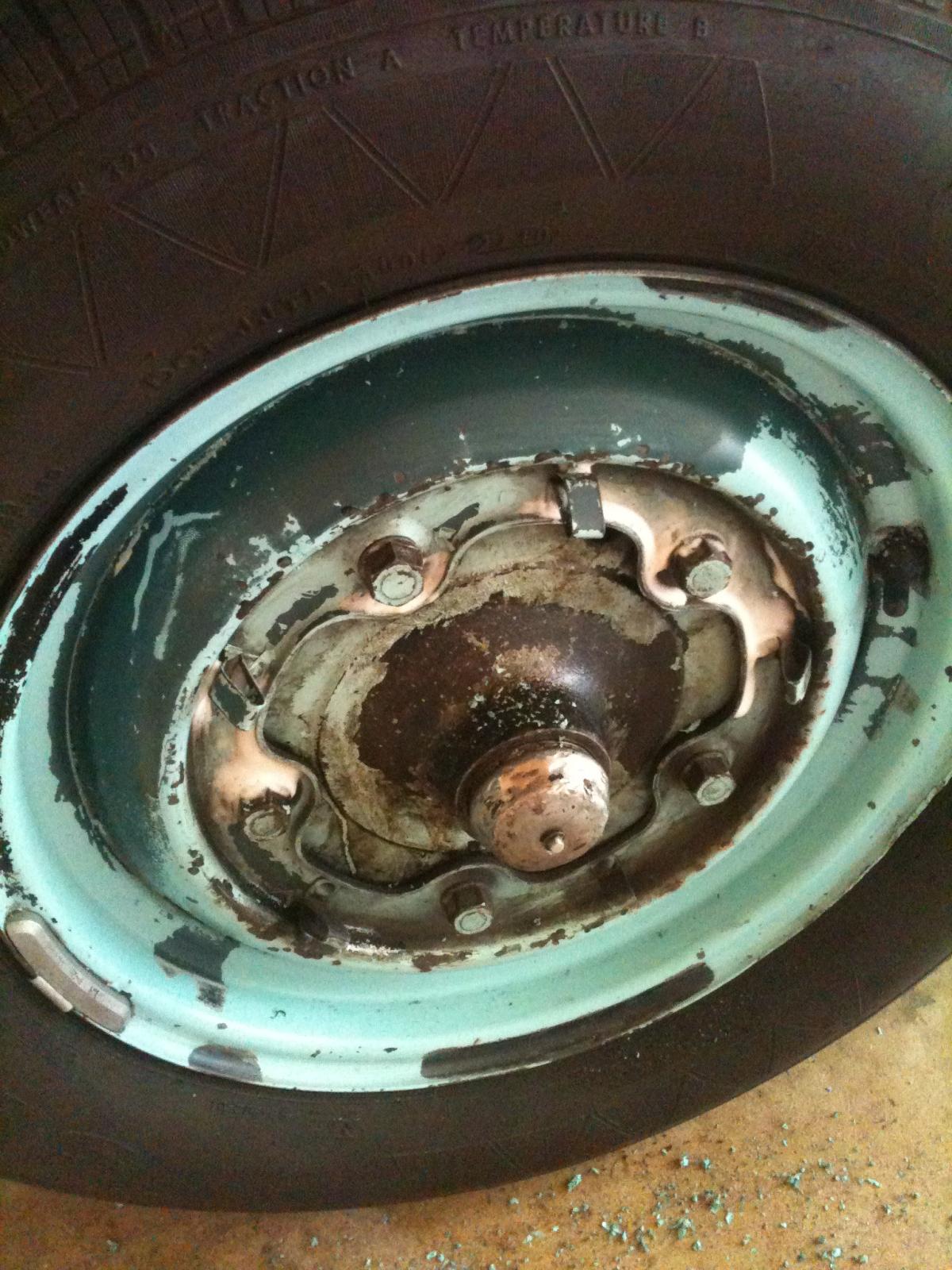

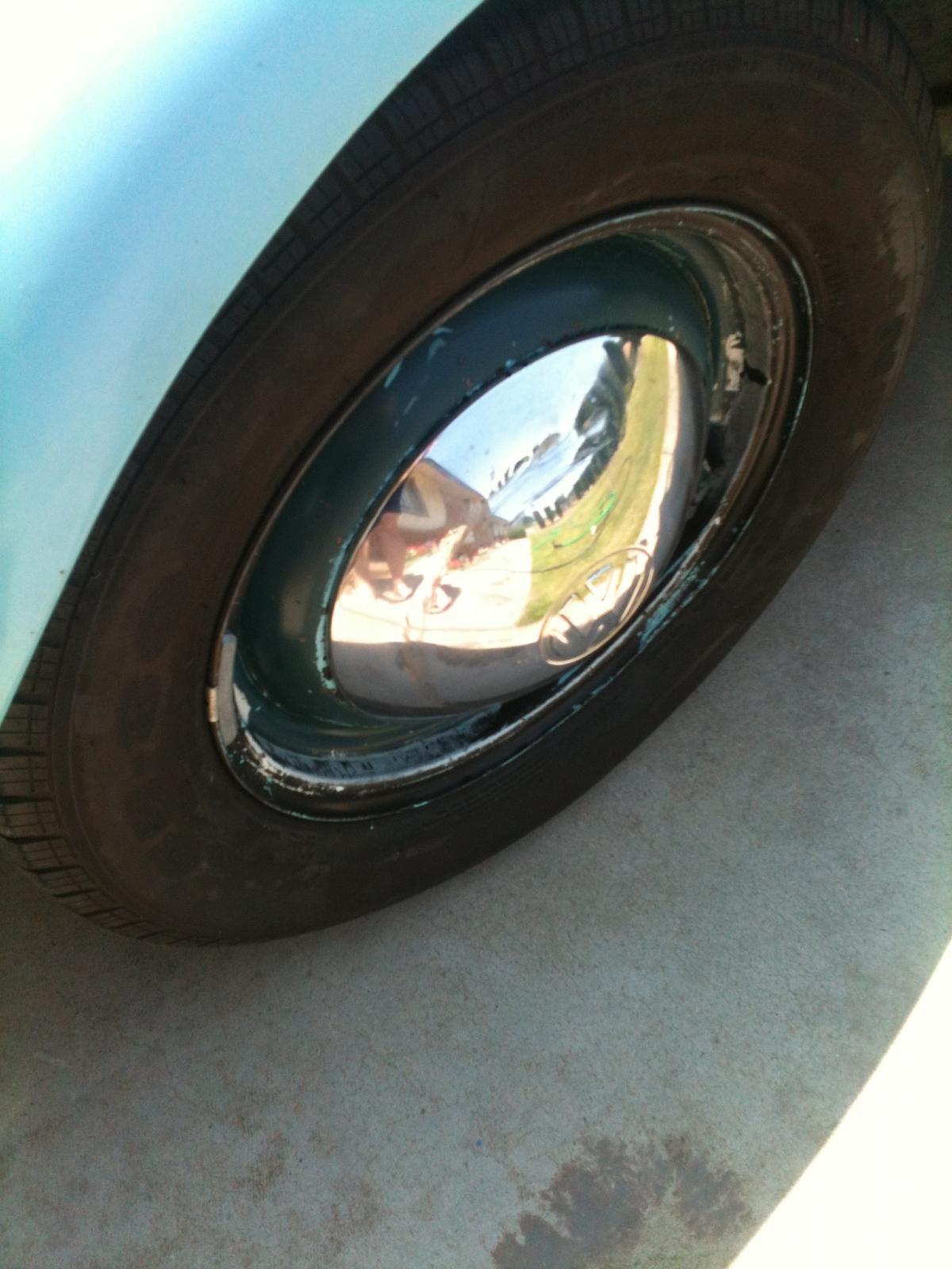

PostPosted: Tue Jun 04, 2013 2:02 pm    Post subject: Reply with quote
Thought I'd start this project with the rims. Sprayed with a light blue in the 80's and love to see what's underneath. Looks like L381 Sea Green, but is/was it with the L286 Turquoise White or a black? I can see where it used to have rings on it - by the scrapes.
Thought a 63 Vert with L398 Pacific Blue was to have only the L289 Blue-White color. Thoughts
Started this with only oven cleaner and a shop rag.
I need to pick up some wool to clean up.

PostPosted: Thu Jun 06, 2013 8:24 am    Post subject: Reply with quote
In answer to my own question, according to WW website, the L398 came with a Night Blue Disc L394 with the black rim L41, until July 1962. Starting August 1962, they switched to the L289 Blue White wheel disc. Being that mine was built July 1962, it has the former.
It also looks as though the L394 Night Blue is a discontinued color, according to http://www.thesamba.com/vw/archives/info/paintcodestype1.php.
Anyone have a paint code for this one?

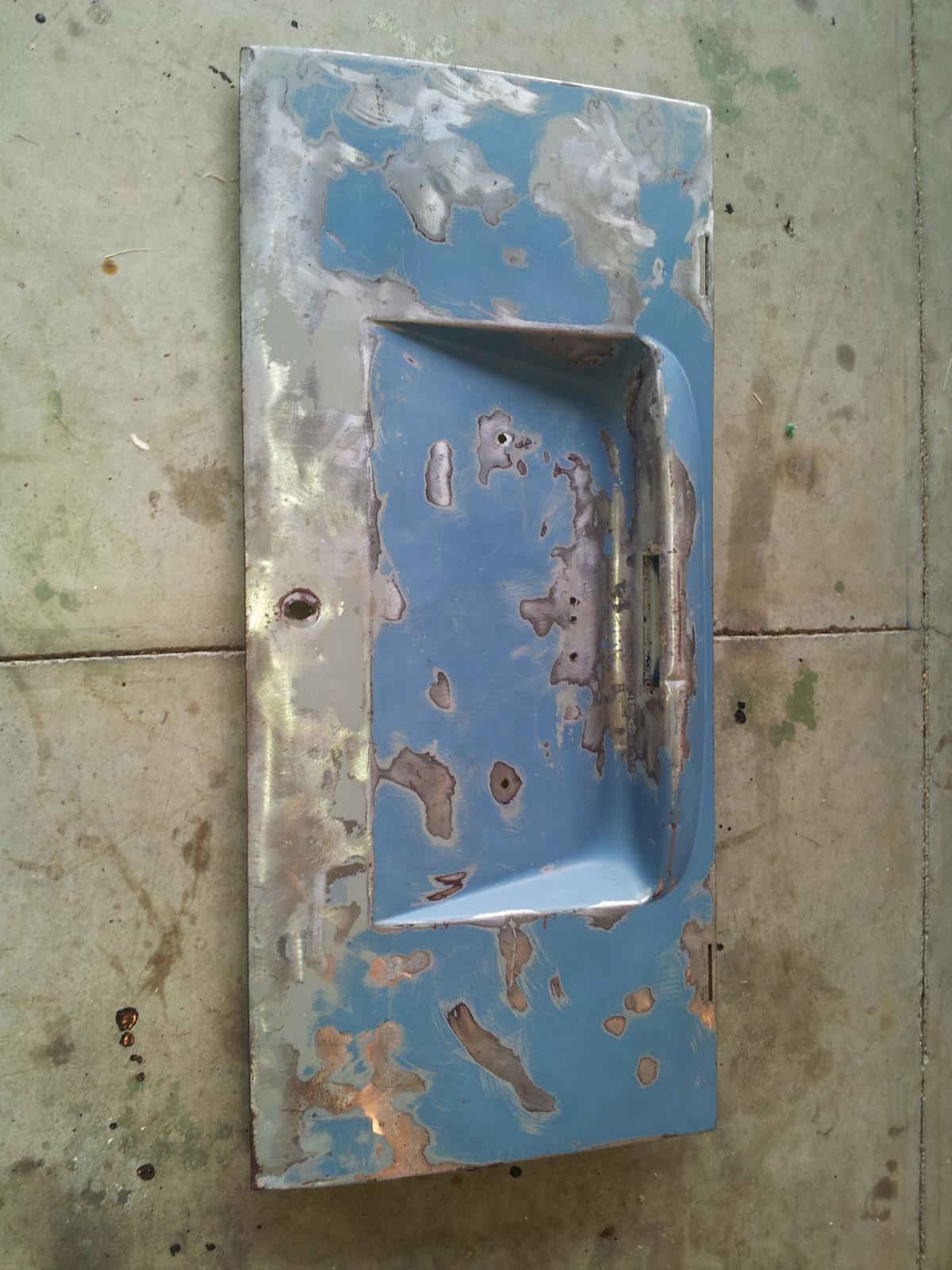

PostPosted: Wed Jul 17, 2013 8:56 am    Post subject: Reply with quote

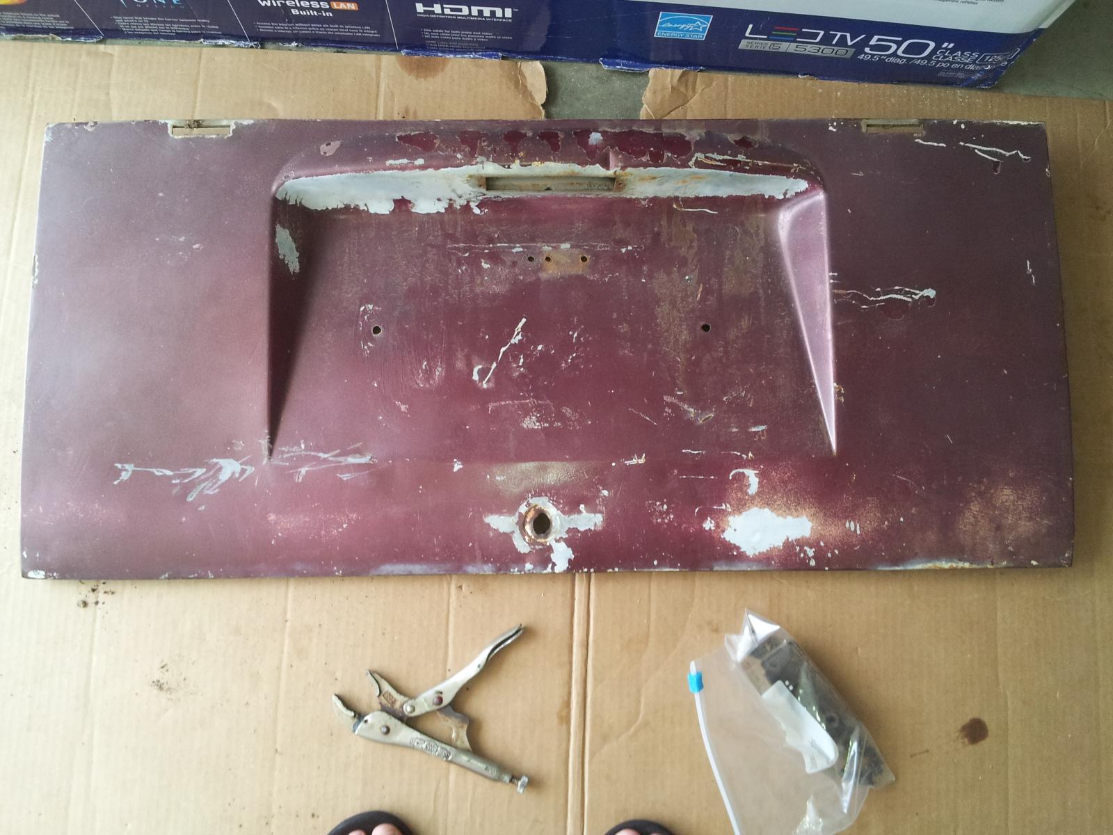

So I just removed some old re-spray using paint remover and now here is what I have:
Before:
After:
Any suggestions on my next step? I have a can of dove blue coming from paintscratch that I was going to try and blend in along the bottom but what about the the other bare metal spots?
Maybe just clear coat over it all to prevent rusting?
1967250s
Joined: May 02, 2007
Posts: 2137
1967250s is offline
PostPosted: Wed Jul 24, 2013 3:01 pm    Post subject: Reply with quote
High build self etching primer. Are you going to repaint everything? That hatch could really stand a complete repaint. Primer, block sand, prime again, new paint. More work to touch up, spot by spot.

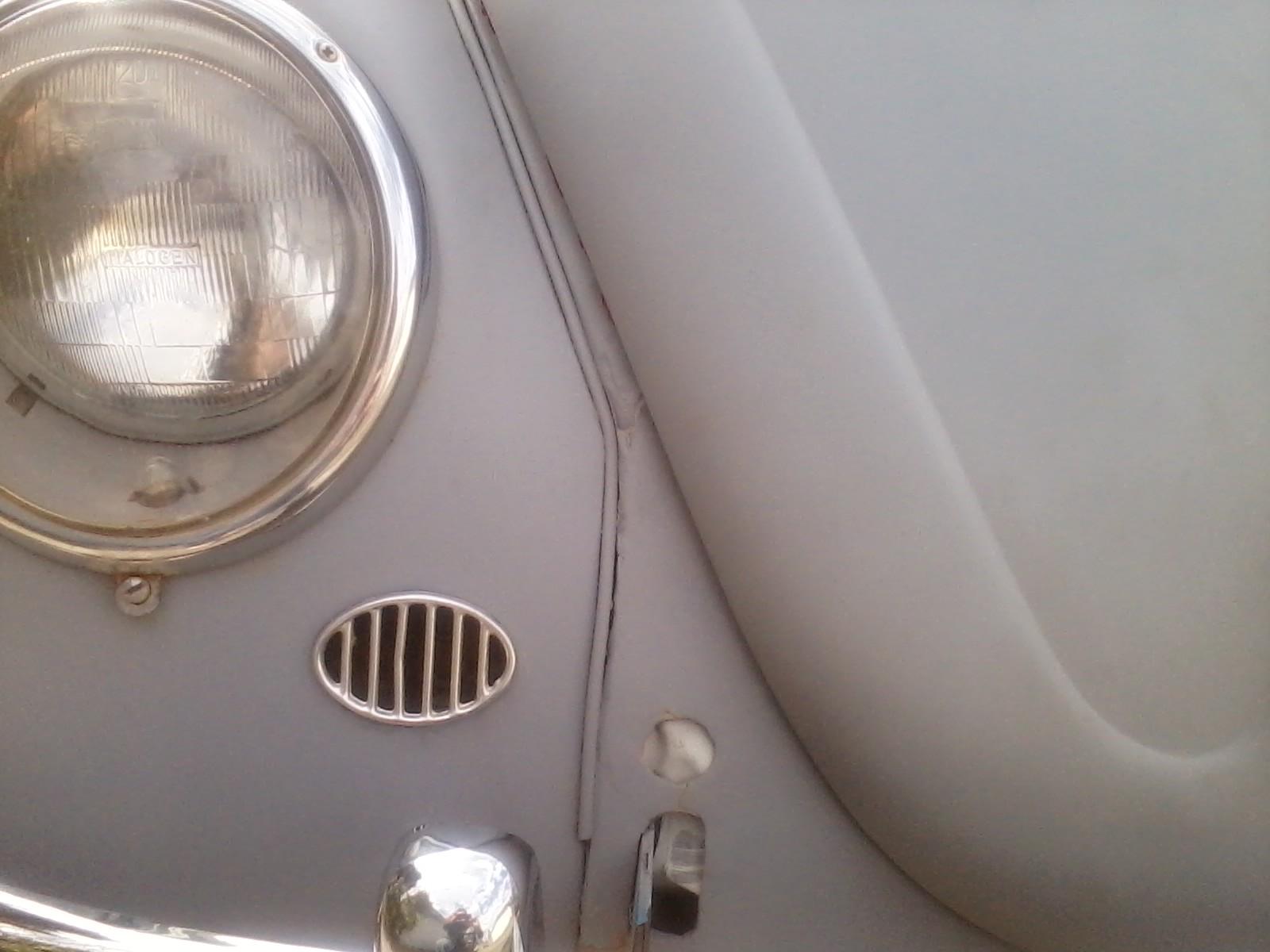

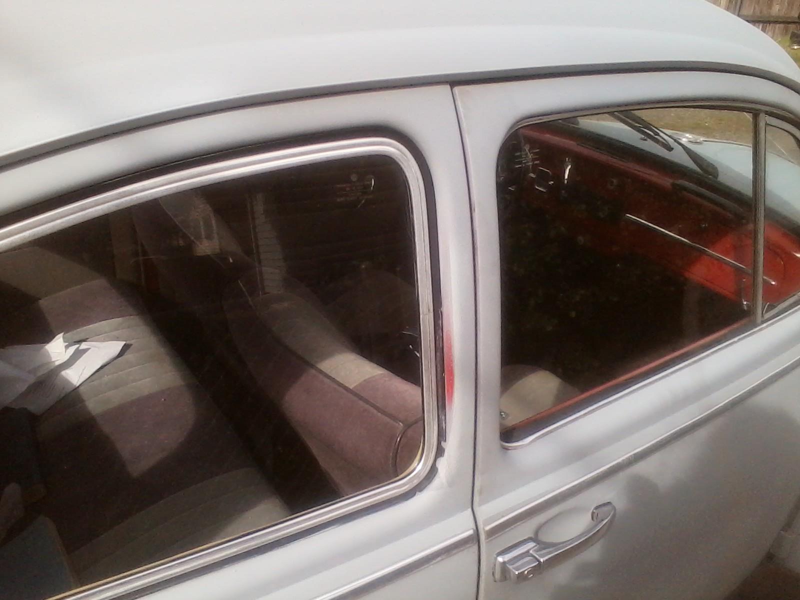

PostPosted: Sat Aug 17, 2013 10:42 pm    Post subject: Reply with quote

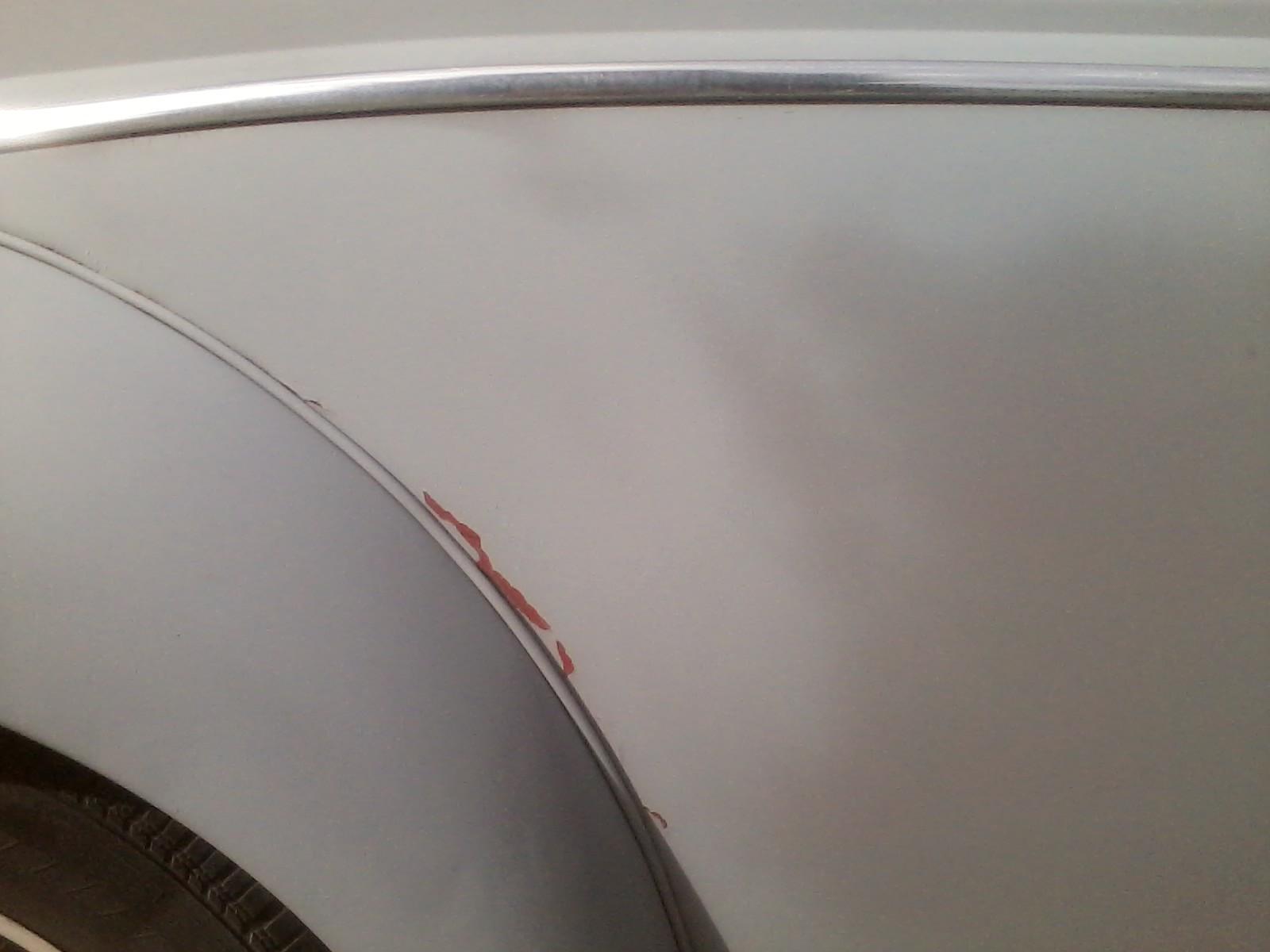

Well, just like everyone here, I read all pages, and decided to try this and ended up trying many attempts. Tried oven cleaner, and then grafitti remover and the most I got was a yellowish ring wherever I attempted but never seemed to penetrate the crap paint.
The pic above is where I'm at using aircraft paint remover in a different area, and I can't tell if:
1. That's a replacement panel that's grey or maroon
2. I went through both og and crap paint
3. The grey is bond because it's magnetic everywhere...although it seems to be more magnetic in certain areas
If anyone has experience with this, I'd love to get some clarity or advice.
1. Thats just a
1967250s
Posts: 2137
1967250s is offline
PostPosted: Sun Aug 18, 2013 9:44 am    Post subject: Reply with quote
Looks like apretty good repaint many years ago. Probably more layers to go. Try another spot.
