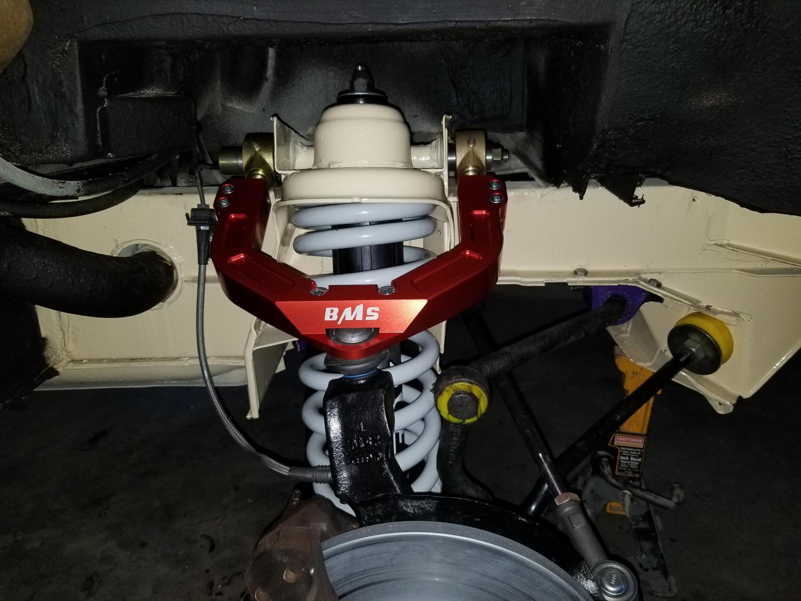

2wd Suspension Overhaul Fox, GW 1.5" Lift, Burley UCA, Powerflex

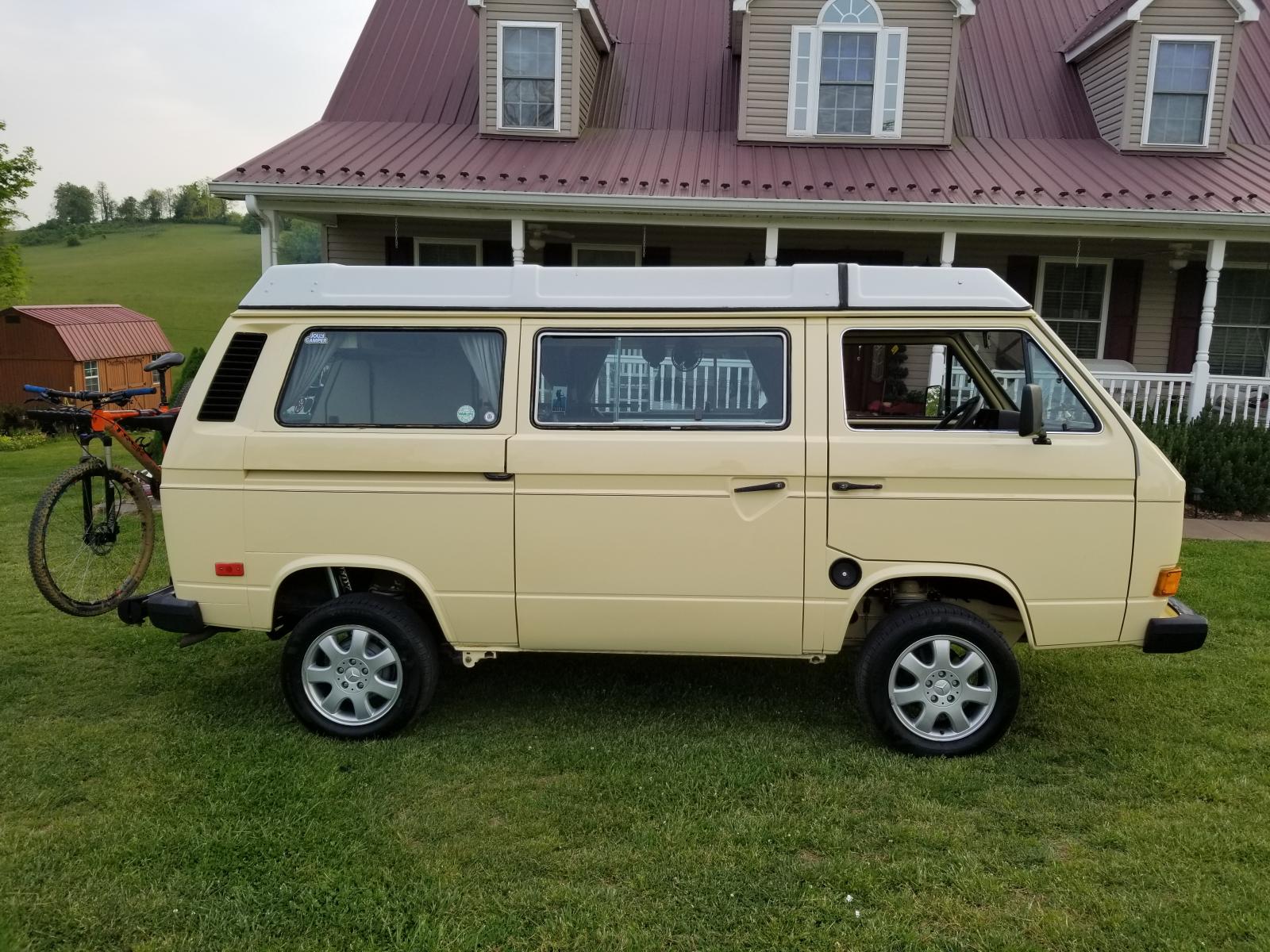

After:

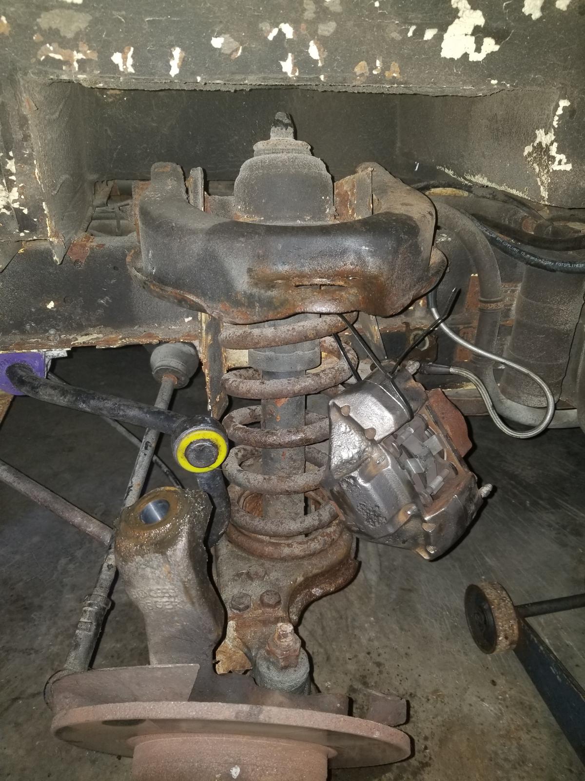

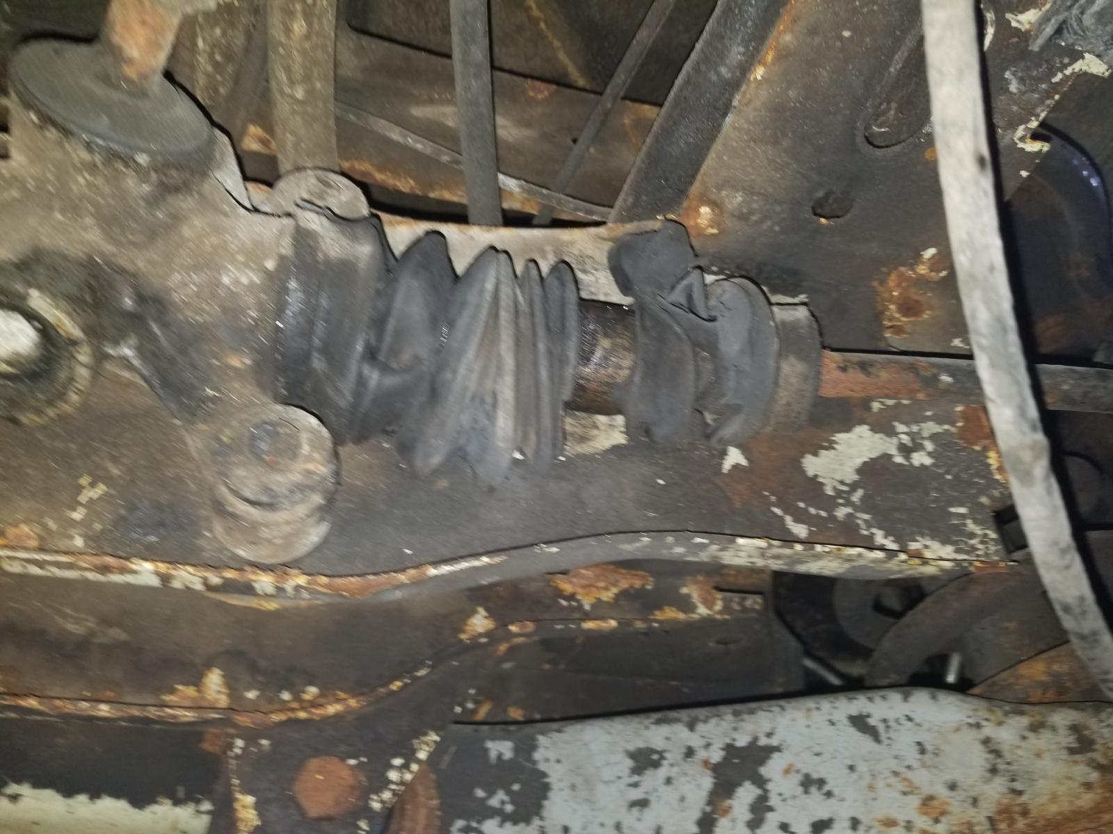

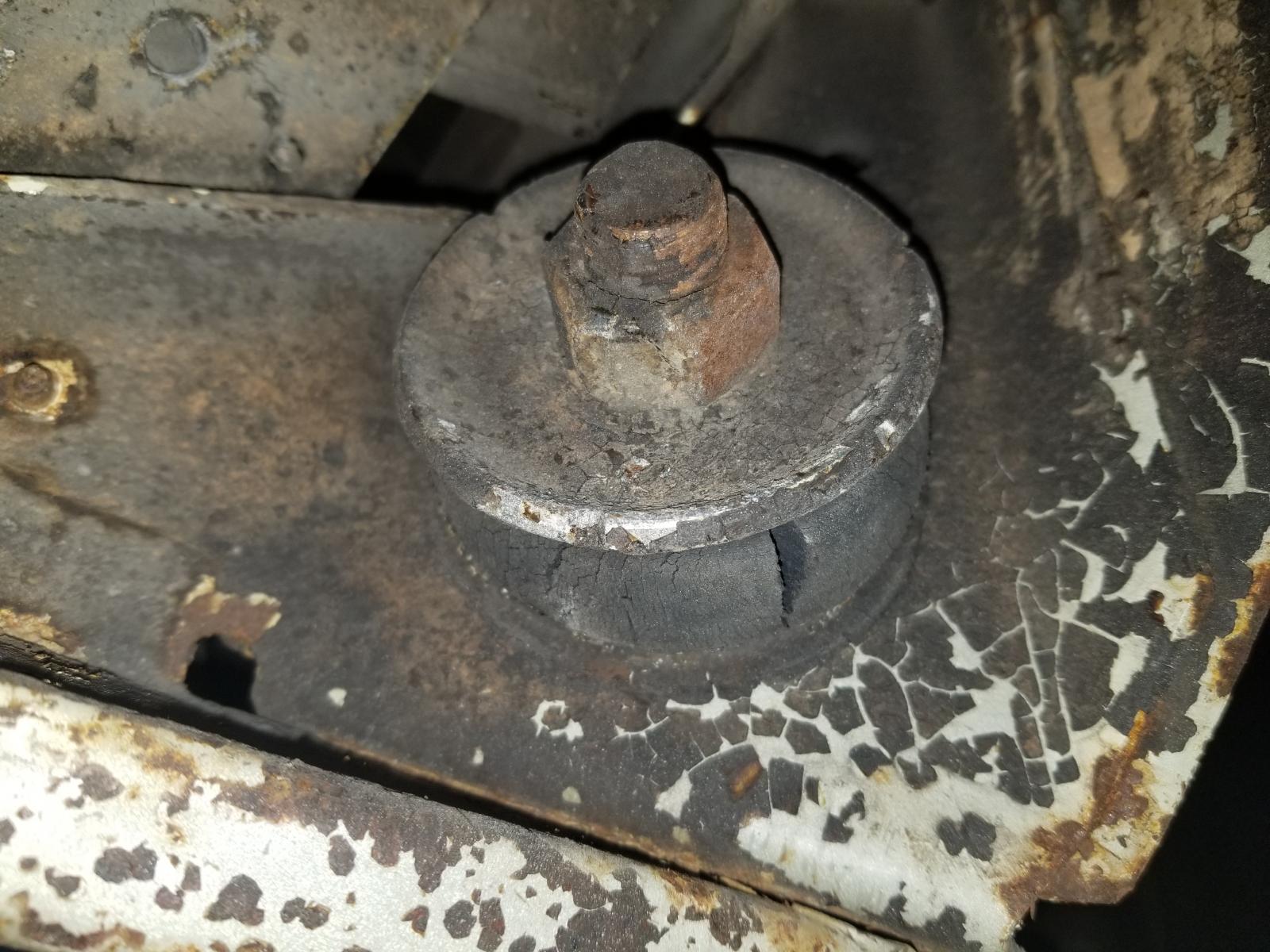

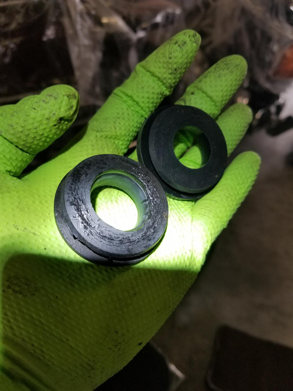

What I was working with: cracked bushings, split boots. It rode awesome - the joints were in decent shape minus the boots.
I try to do a job once so I will not have to revisit it in future. So I may have went overboard on this experience.

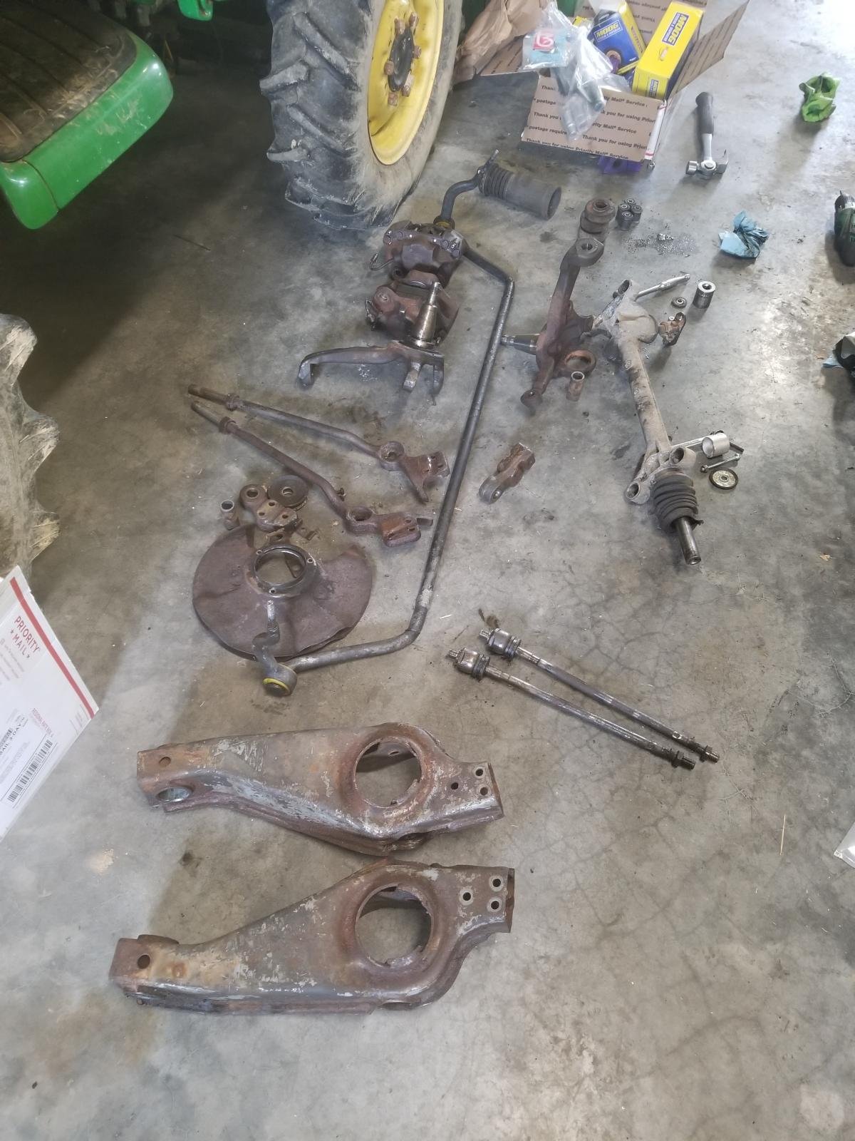

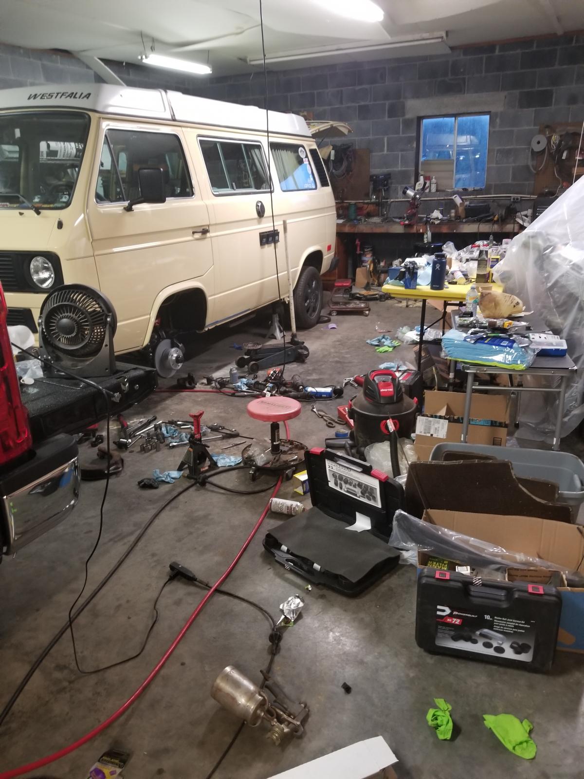

Yanked everything out: 15 hours
Each lower control arm to ball joint adapter (early style) had one seized bolt. One front shock bolt was seized.

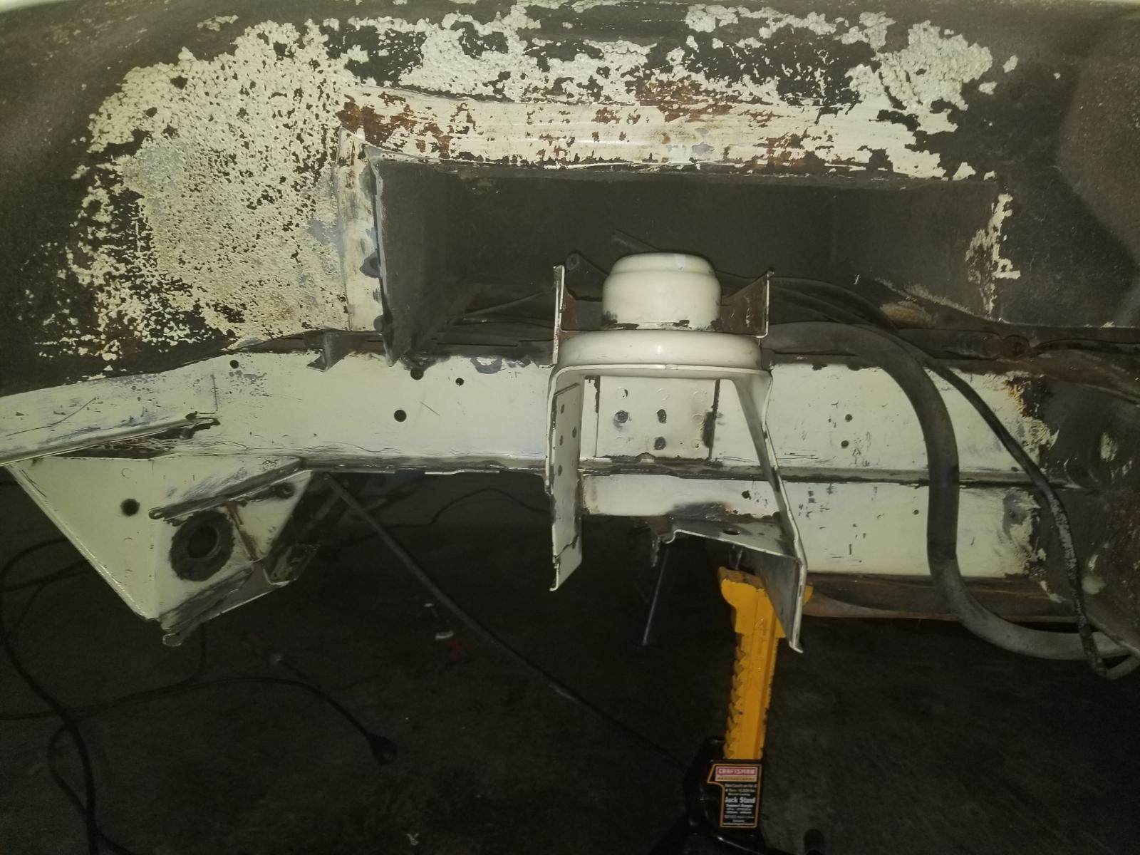

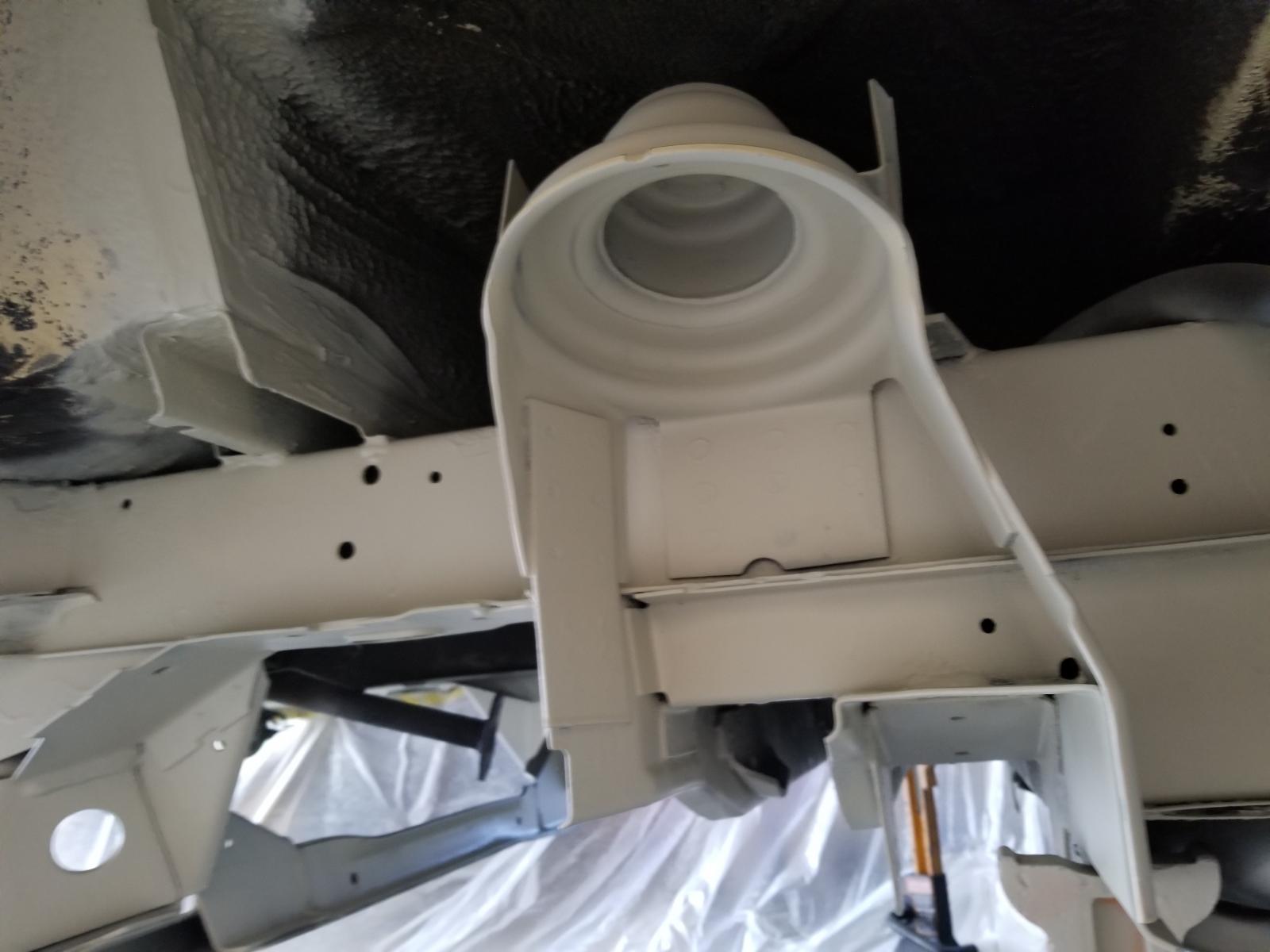

I had a lot of surface rust. I couldn't just POR15 and expect good results. Seemed too easy to me. So - I started cleaning up the undercarriage. This was a miserable process. Sitting and rolling in dirt with the van on jackstand. It killed my back. I bought an extension on my dremel and used small little wire brushes. I bought cheap ones on amazon. Probably went through 40 of them to reach hard to get places. That with a degreaser and an angle grinder with wire brush.
Cleaning front undercarriage: 40 hours
Paint: 5 hours. My favorite part. After spending 40 hours of grinding and scrubbing it was nice to get the ball moving. At this point I had all my parts on hand ready to be put back together. I used SprayMax 2K Epoxy Rust Cure for primer (3680032). 2 coats of primer. I was amazed how precise that rattle can was. It was my first 2 part rattle can - pure amazing. Had a flat matte ivory look to it (color of my van).
I had a 24 hour window to put on my paint so I sprayed like 4 hours after primer. I bought color-matched car grade automotive paint from Sherman Williams. It was $150 for a quart! After all the work I spent on scrubbing - no way I was about to back down for some cheaper paint.
I mixed it together and ...well it didn't look anywhere like my color. I gave them the color code at Sherman. Maybe it goes on dark and dries. NOPE
Next morning I check and its same color. I call Sherman up and say, what up bro!? They said they messed up and will give me right color for free. That's more like it. Luckily I was able to meet the window and did not have to sand any. 2 coats of top coat. I sprayed 3M rattle can undercoating in the fender wells after the top coats.

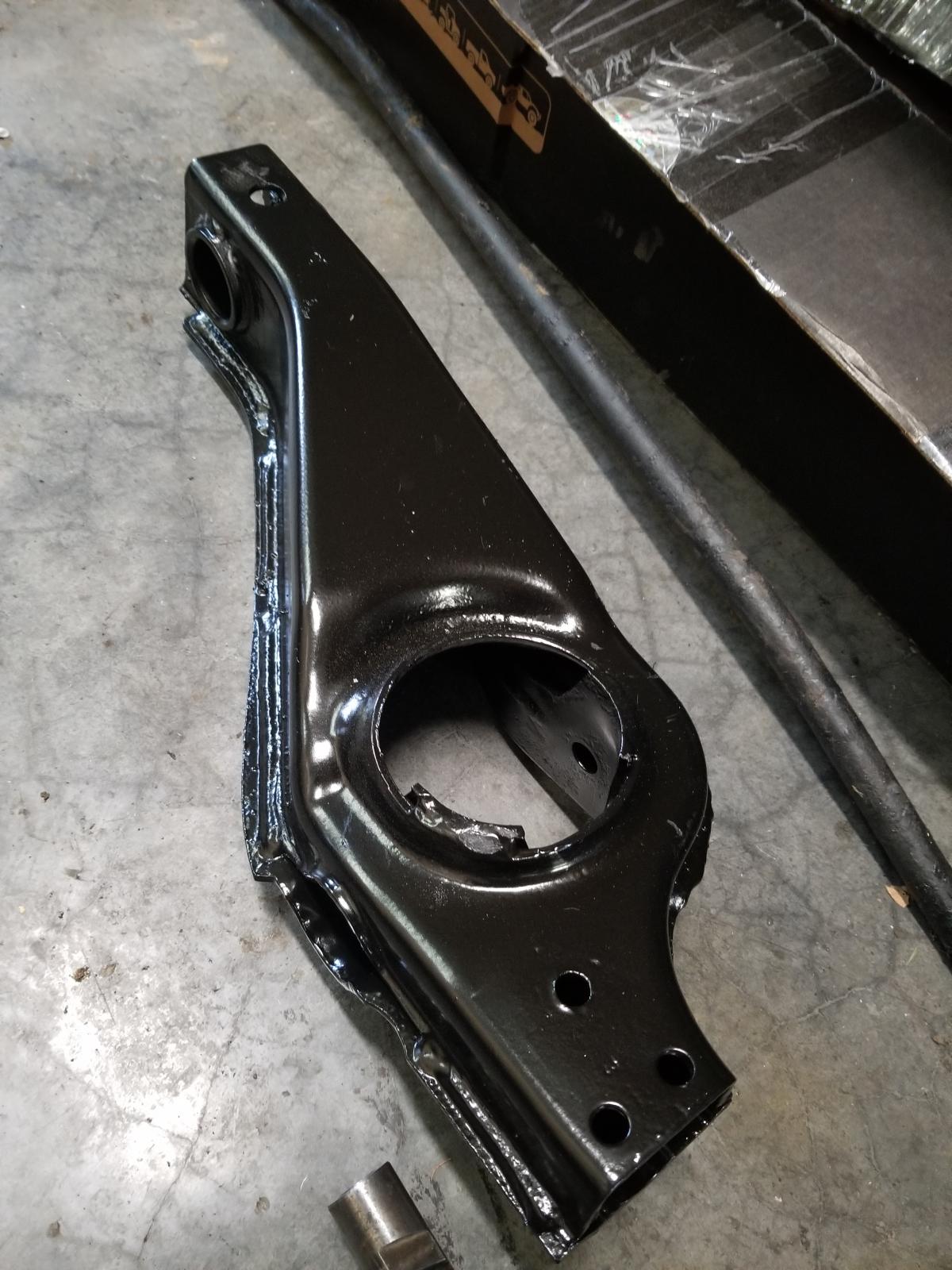

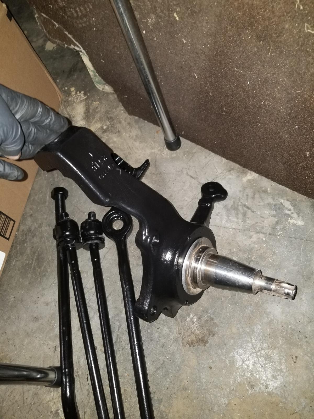

Old parts were sent off to be blasted and painted.

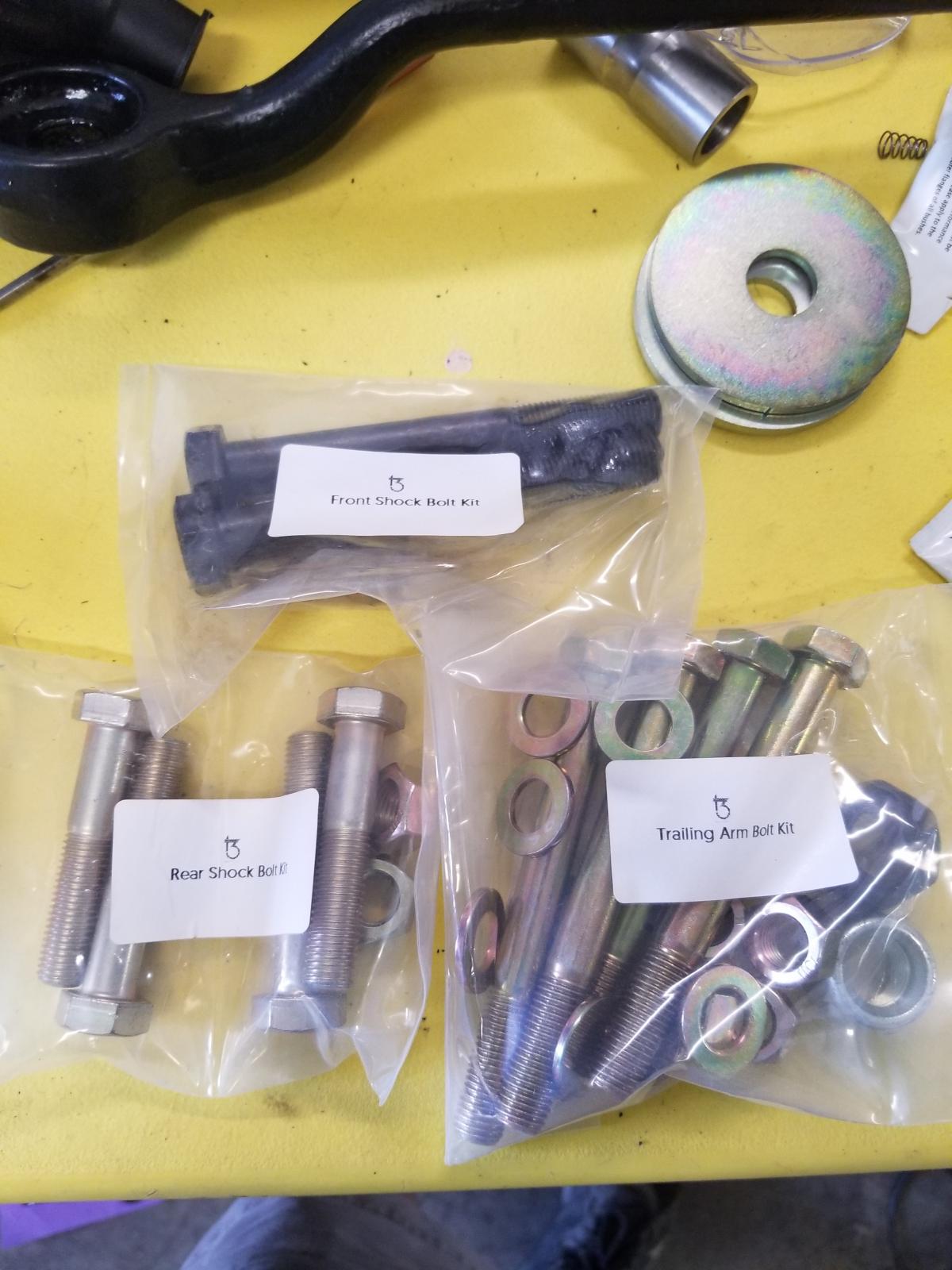

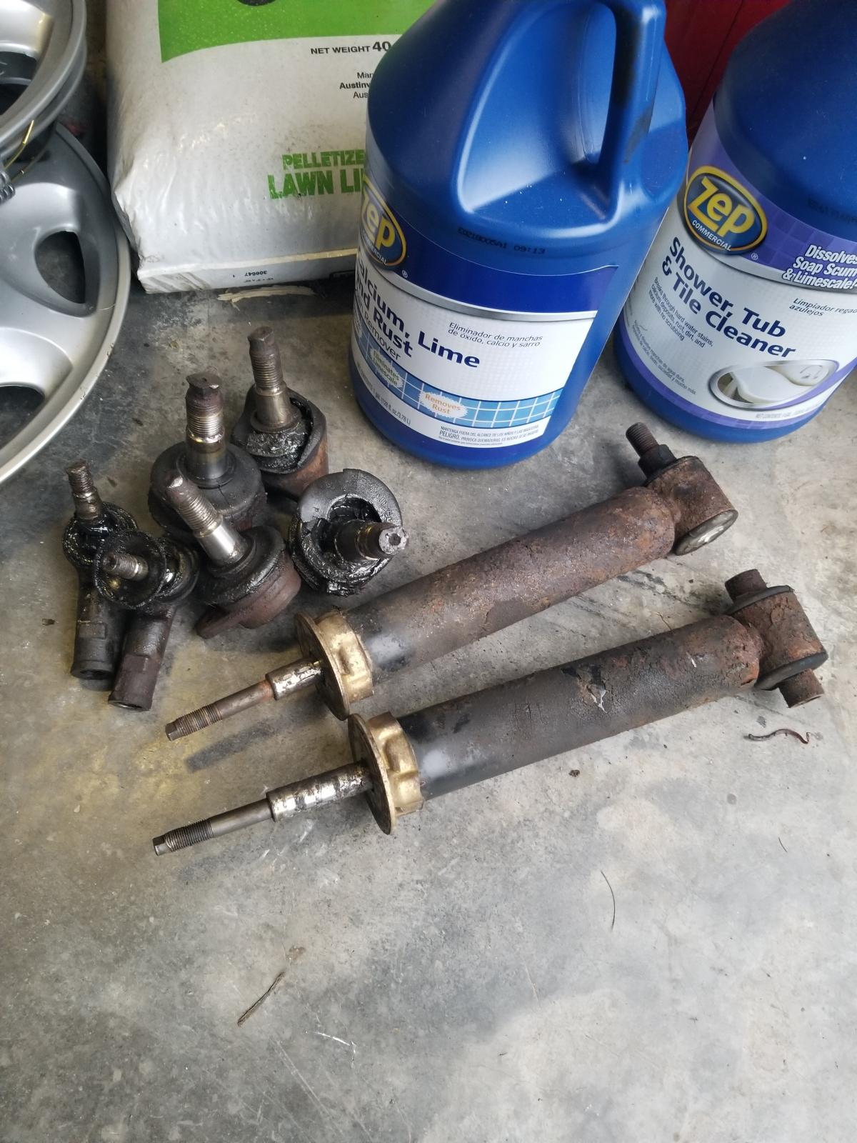

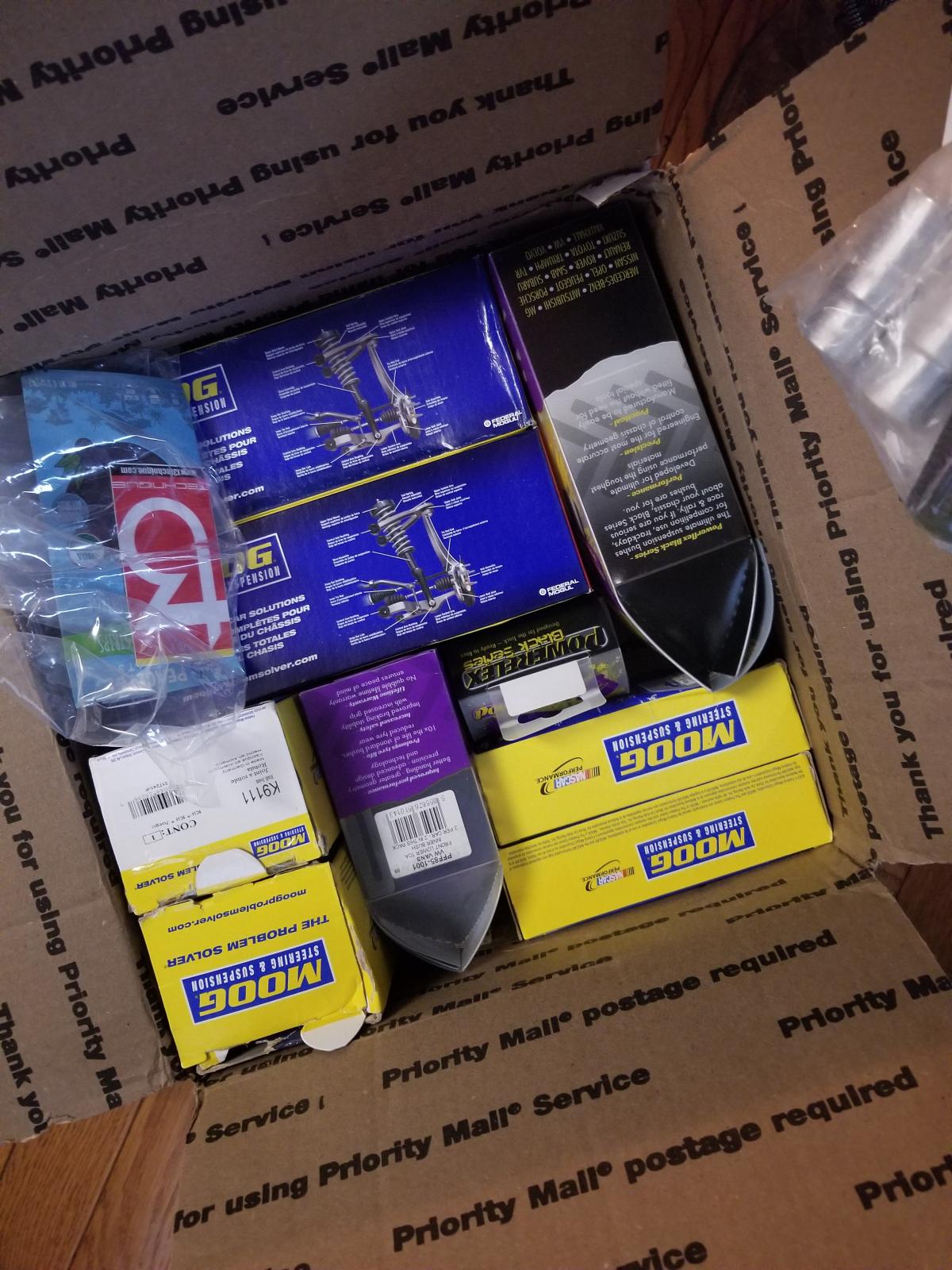

I had a table full of parts. Fox Shocks, powerflex bushings, Moog lower joints, Lemforder Upper joints (bad move - these were made in china, but easily replaced), VW steering grease, Moog tie rod ends, Zimmerman front rotors, Van Cafe front bearing kit. Oh and T3 was extremely helpful. I bought all new replacement bolts for front suspension. His website made it so easy for my suspension rebuild. Even the bolts were labeled in bags!

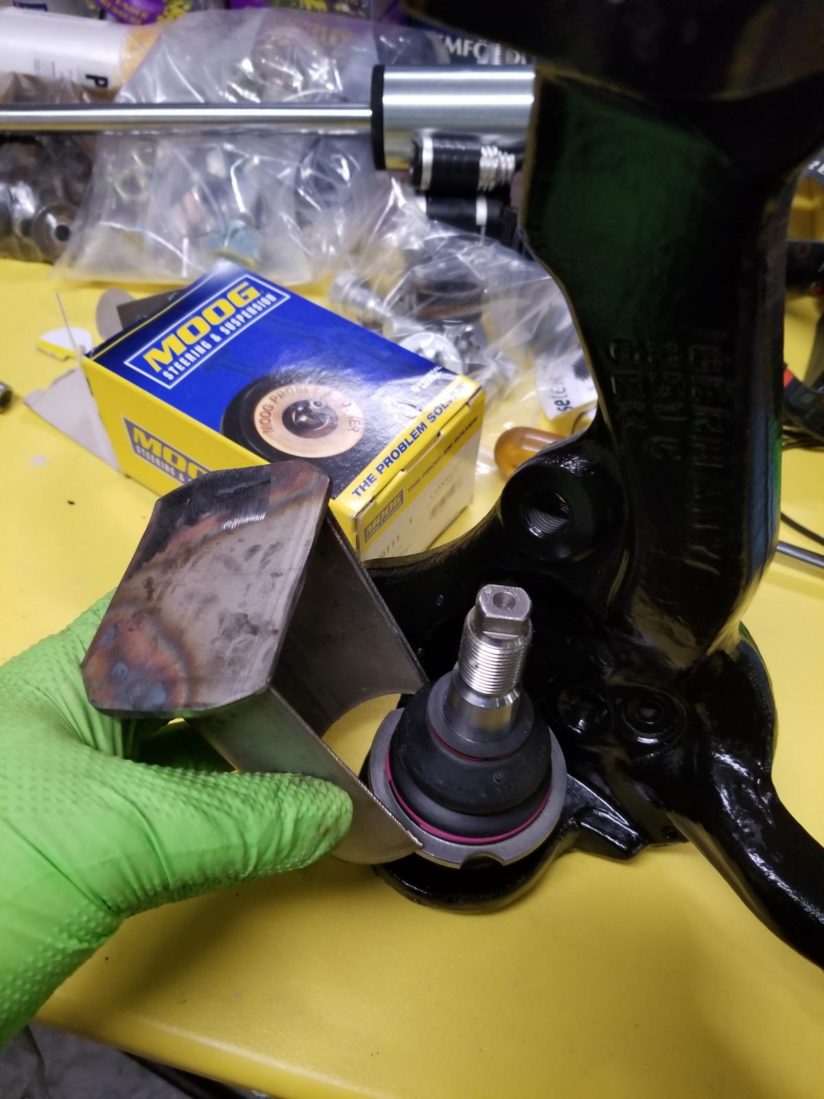

Lower ball joint 'jig' made

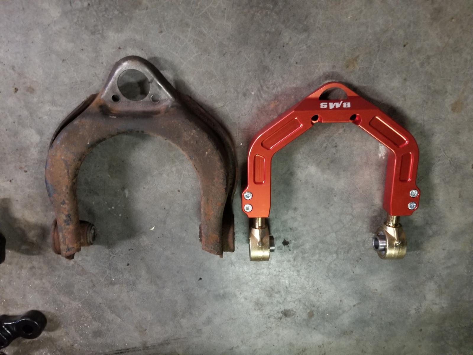

Upper control arm comparison.

I plan to add a 'wax' undercoating in the front. I did not 'clean up' the rear because I did not want to drop CV and rear trailing arms. I will save that job for another time - It takes awhile for that undercarriage restoration.

A great artist (Robert Irwin) once said that a great craftsman cares how thing are finished even where you can't see them (I think he said this referring to painting the back side of the dashboard in an old hot rod). The finish of your suspension, especially the Burley UCAs is bling only a vanagon fanatic can appreciate.
A couple of questions- what are you ride heights now? What were they before? Your van is an 85?
Did you need spring compressors to get the old springs out? The new ones in?
Is your van manual or automatic? How are the CV joints after the lift?

Thanks! It drives really well! I no longer get thrown around by semi's flying by. I love it. I think that's mainly the 16" rims but even still with the Fox - its still a smooth ride. I have not had chance to go offroading to really test them out.

I have an 83.5. I did not take any measurements before. I was running the stock 14" rims also.
Oh I forgot to mention I did add a GW .5" spring spacer to the driver side rear on account of the westy lean. I am sitting 19" in front from center of rim to top of fender and 18.5" in the rear. Nose up attitude.

Nice! The new 2wd billet arms look awesome. Even people not in the know would see all that color going on and realize something is up.
Any reason you didn't use larger wire brushes on a hex shank and then use the Dremel for the harder to reach areas?
I did use my dad's cordless drill with that attachment also - forgot to mention. I really didn't want to take it all the way to bare metal. I was wanting to just remove the factory undercoating/dirt/grime/rust. I could have taken my angle grinder with brush attachment and did the job in probably 10 hours if I did that.

Came back to answer this. It's incredible. I took trips with 3x 200+lb people in it, van loaded down - and was amazed how it handled. It was honestly like there wasn't a load on the van (minus going up hills).
But yeah - I love it. Stability with 16" rims is crazy game changer too. I look forward to having T3's upgraded sway bar one day.
