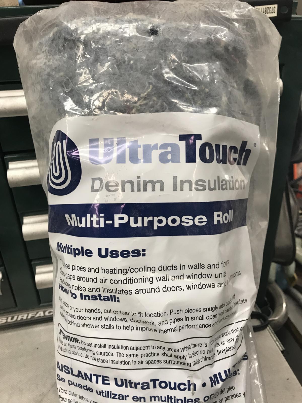

Hope this isn't too stupid of a question, but if I knew what the material was I would search the archives. I've seen it discussed previously regarding those chunks of woven(?) material or sound absorption stuffing placed around the rear inner wheel wells and the engine compartment, or under the top of the front wheel wells, just in that empty spot above the door hinge pillar covers. The stuff that I think most have referred to as just water absorption and rust growing material. Questions:
1. What do you call that stuff-if I've described it clearly enough?
2. Is there some type of newer or equivalent material available?
3. Should I consider stuffing anything back in those spots as I rebuild?
I'm not as concerned about the rear area below the back window, but I have noticed there is quite an empty spot at the top of the inner front wheel well around the base of the windshield pillar, and would like to fill that some way to prevent water getting into that area and having to de-rust that part of the car over the coming years.

I used denim insulation.
It seemed to be about the same density of the original stuff.

Thanks Guys. Redlabel6 thanks for the pics of the denim insulation, I think that would work perfectly.

I used it as a wrap around the perforated heater pipes under the rear seat too. That's what the piece is a picture of.

Yeah those look good, I figured that's what they were for looking at the shape with the cutouts. I wish I had thought of that. I could always go back and redo mine once I get through the thousand other priorities of the rebuild.
