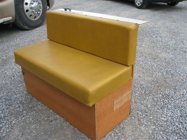

Posted: Tue May 05, 2009 10:55 am Post subject: |
Thanks for the detailed pictures Matt.
Dimensions to follow... _________________ "If you don't do it this year, you'll be one year older when you do." -Warren Miller |

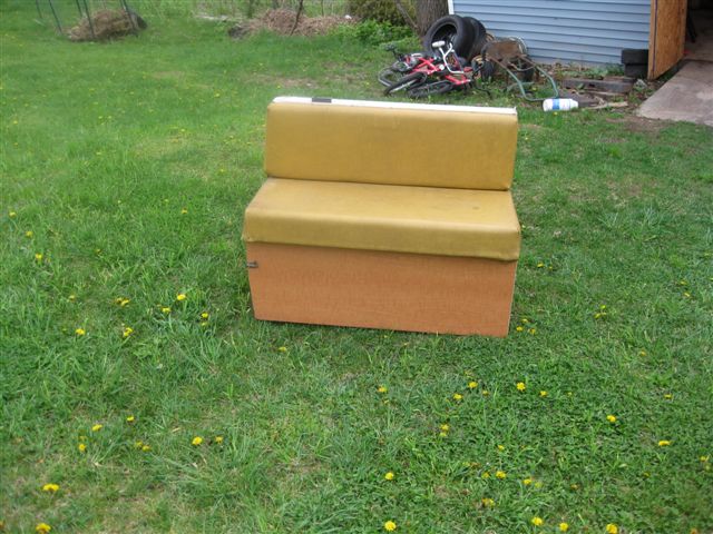

jeremy57ride Samba Member
Joined: May 23, 2005 Posts: 1340
Posted: Tue May 05, 2009 10:58 am Post subject: |
two more:

Posted: Mon May 11, 2009 7:59 am Post subject: |
Ok, here are the dimensions I received. Thanks again Matt.
Sorry for the lame paint skills!
A 38 1/4 bottom and 39 3/8 on the top for the curve on the side
B 13 3/4
C 16 1/2
D 29 3/8 to the bottom of the top ply
E 6 wide and 8 3/4 with the pad 6 is the ply though
F 18 base
Map Pocket 15 across and 13 deep
I hope to find this seat as an original, but this may be a way to build your own. Feel free to add any build pictures or advice along the way.  _________________ "If you don't do it this year, you'll be one year older when you do." -Warren Miller |

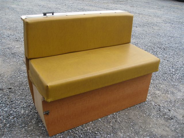

nimbus Samba Member
Joined: April 15, 2004 Posts: 1302 Location: Jacksonville, N. FL
Posted: Tue Nov 03, 2009 2:43 pm Post subject: |
Ok, I finally got my hands on one. It had the back piece with cushion and shelf, and the seat bottom cushion. I had to make cut and attach the 3 wood pieces that the seat bottom rests on. Good for now..after seeing some originals, the front piece goes infront of the left side and is curved.
Posted: Mon Mar 14, 2011 10:10 am Post subject: |
Just thought I'd update, thanks to Nate, (Jung Restoration) I now have an original seat! It is in remarkable shape!
