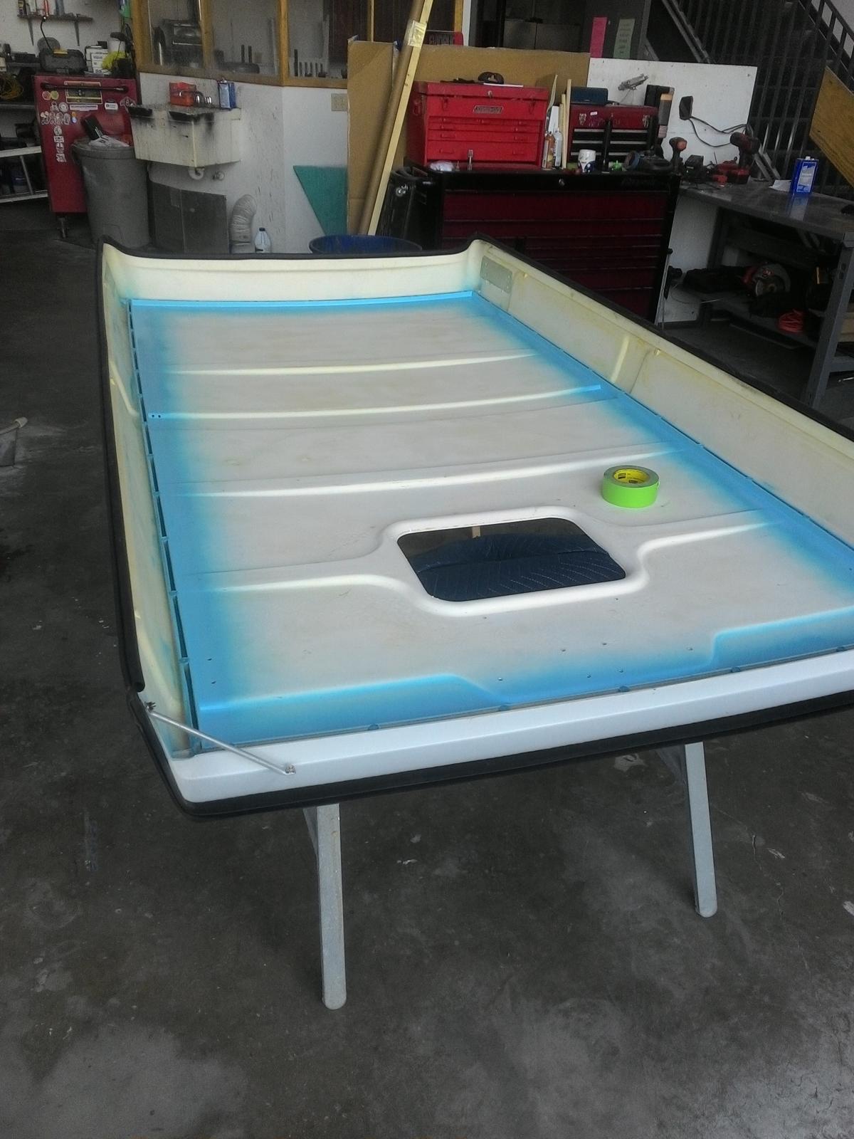

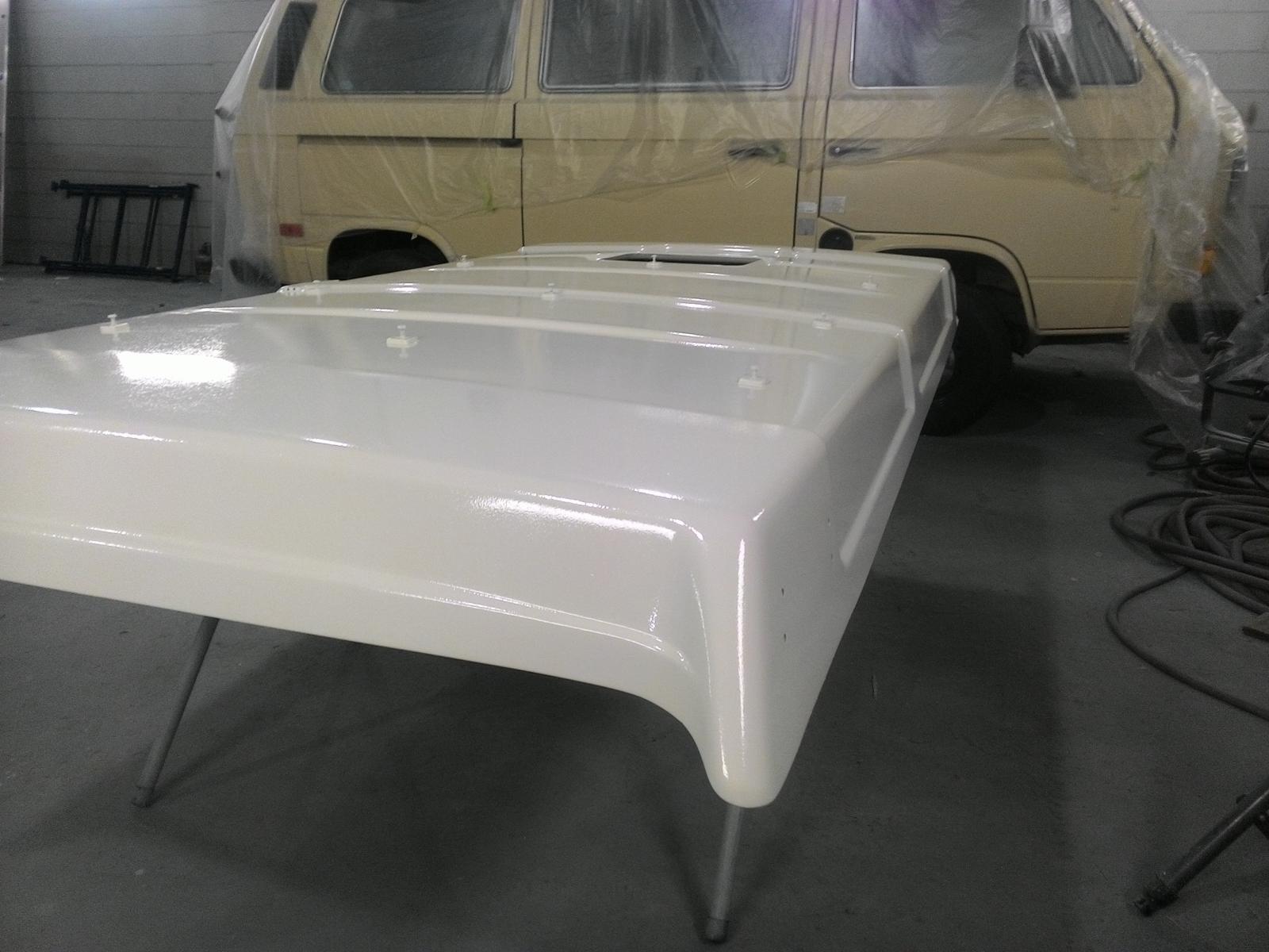

So again, no pictures of Painting
Awlgrip "oyster white" with G3013 flattening agent to dull it down a bit.
Used a 4" foam roller, 3 coats, I decided to roll it to replicate
the original GELCOAT texture, if you even seen a roof that is super shiny
and no texture , it shows every bump,warp, and defect.

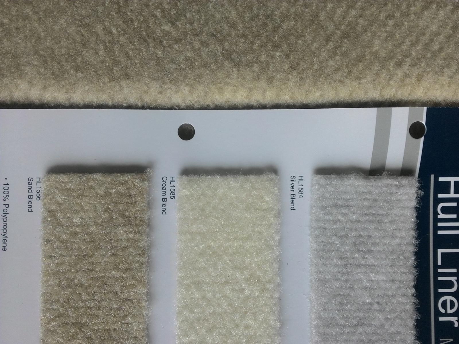

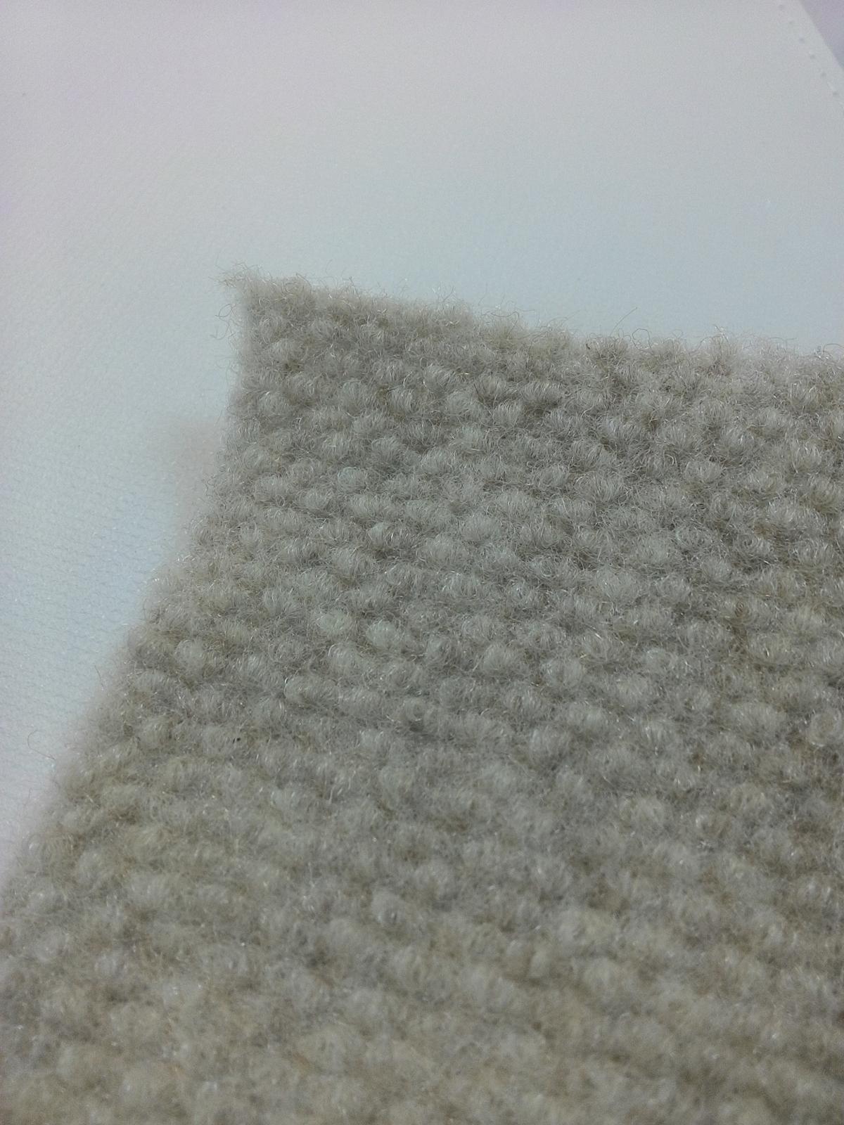

this is called "hull Liner" and it is PERFECT for this application,
100% Polypropylene very stretchy, even has better insulation factor
you can also Google "hull Liner" for other vendors

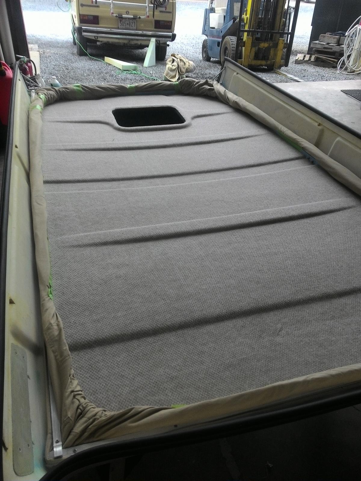

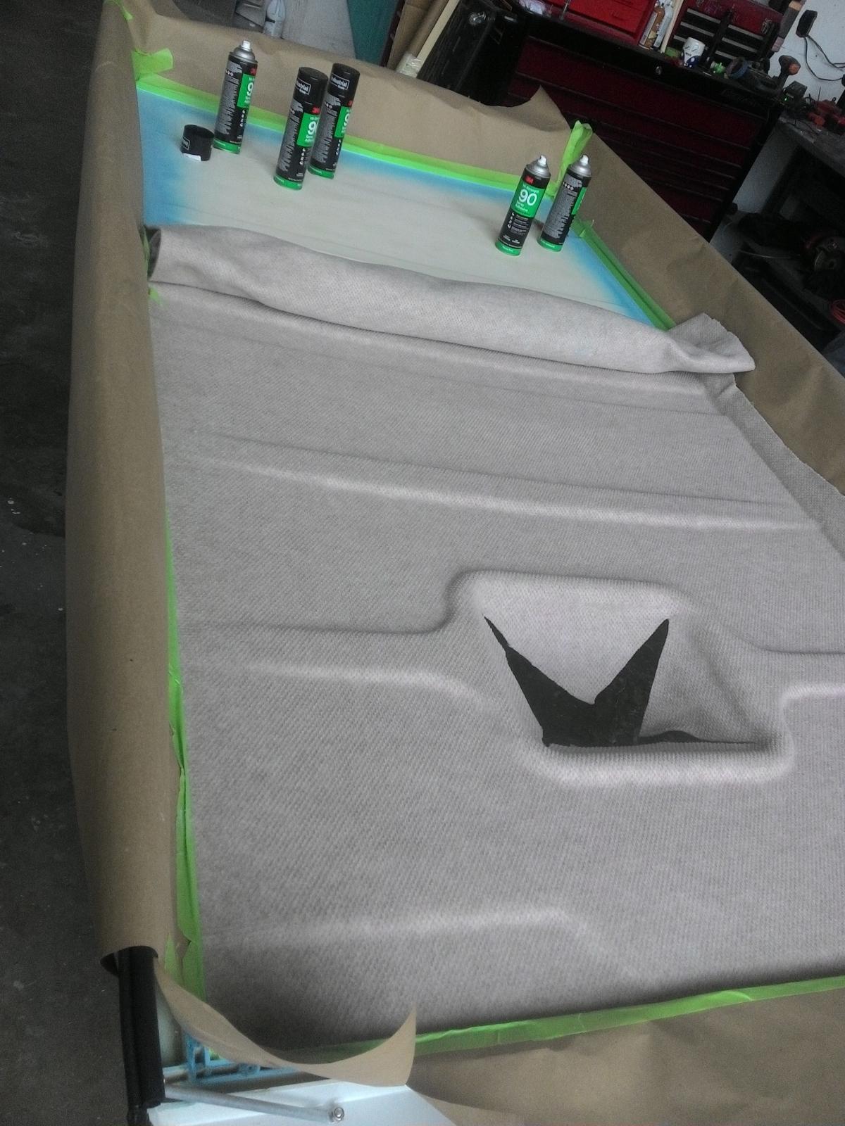

At this time I installed the top seals, and taped up my new blue edge to prevent overspray from glue
Before covering the top, I temporarily installed the skylight seal, ran a pencil around it and then taped the edge so I knew where to cut the carpet after its installed.

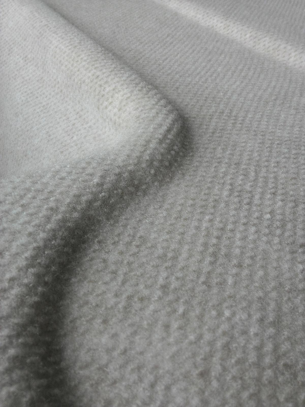

I used 2 full cans 3M #90 adhesive. this is a 2 person job,
do not cut to fit as the material is very stretchy,
mark off like 2ft lengths with pencil, only attach 2 feet of length at a time
start in the corner and work back and across to your 2 foot mark
your helper will hold the material away from the surface as you rub and contour to fit

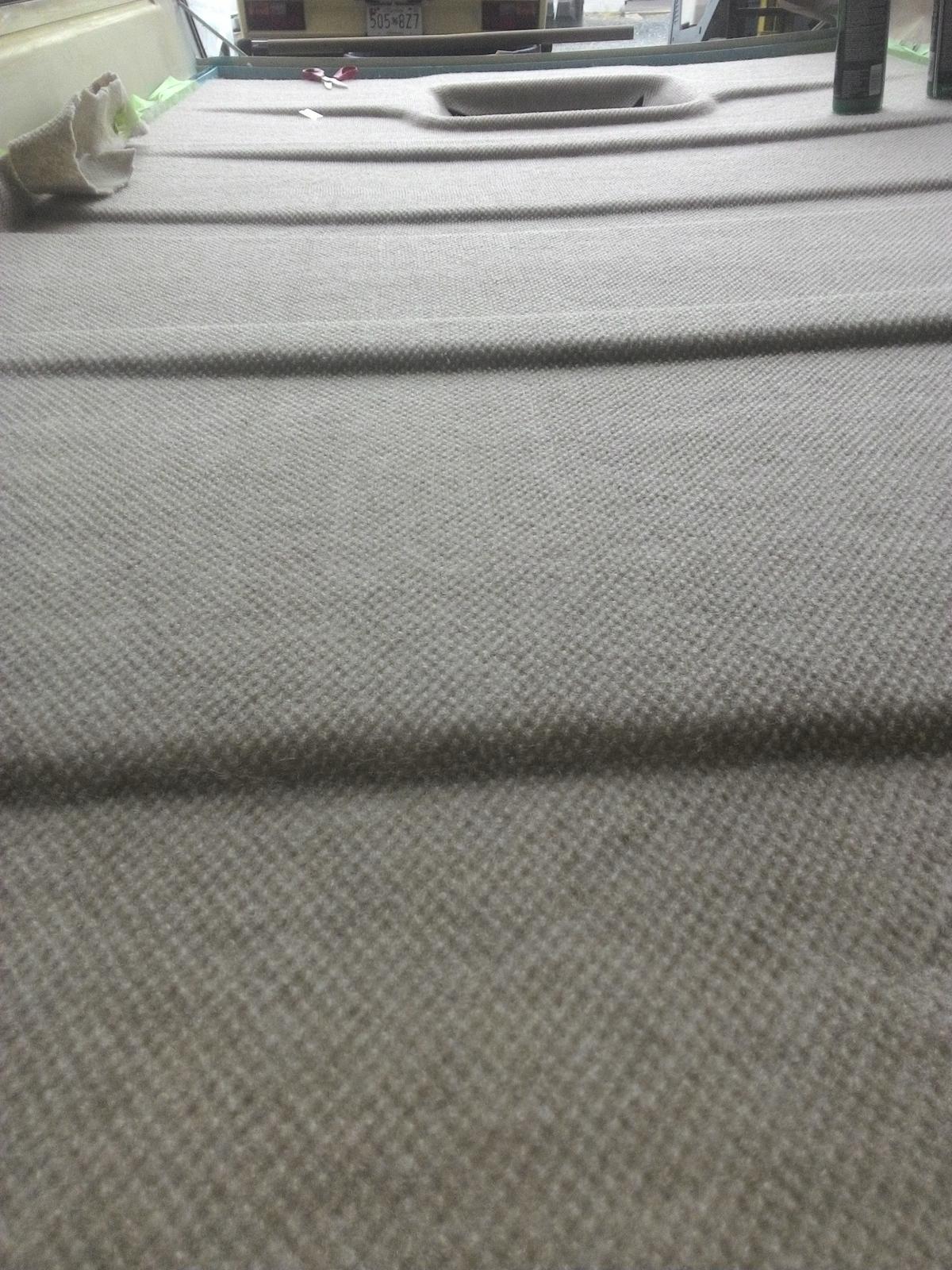

PostPosted: Mon Feb 10, 2020 6:34 pm    Post subject: Re: Vanagon T3 Westfalia roof renovation w/ solar Reply with quote

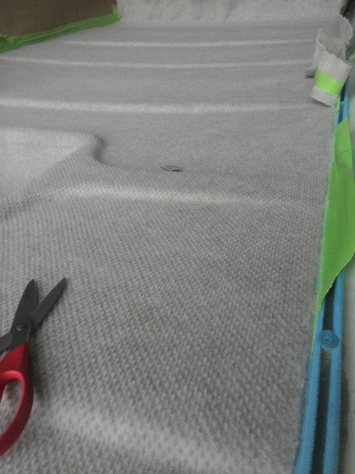

Please note I used one edge back as the guide and the other side was trimmed after
tools I used were putty knife, ball end of screwdriver, and tools to rub down the corners, carpet knife and scissors.

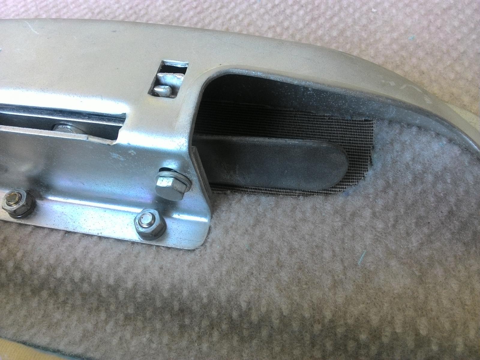

I did pause half way to trim the other edge,
Fit the latch, the paddles will rub on the material,
I marked an area, cut it out with a knife and glued in a flat fabric
this is important as the latch must operate smoothly

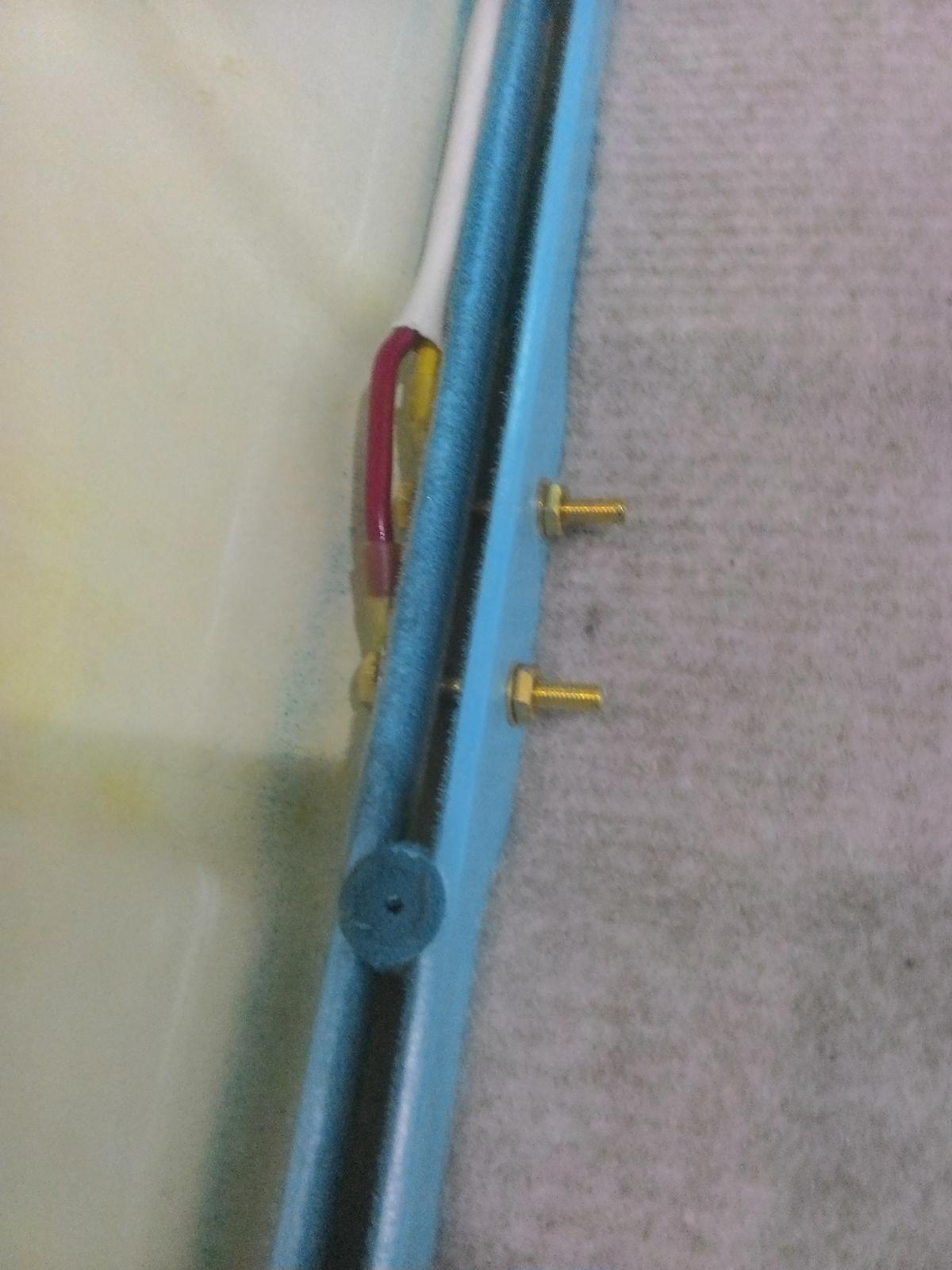

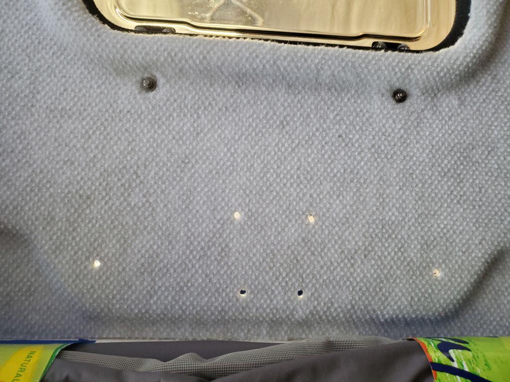

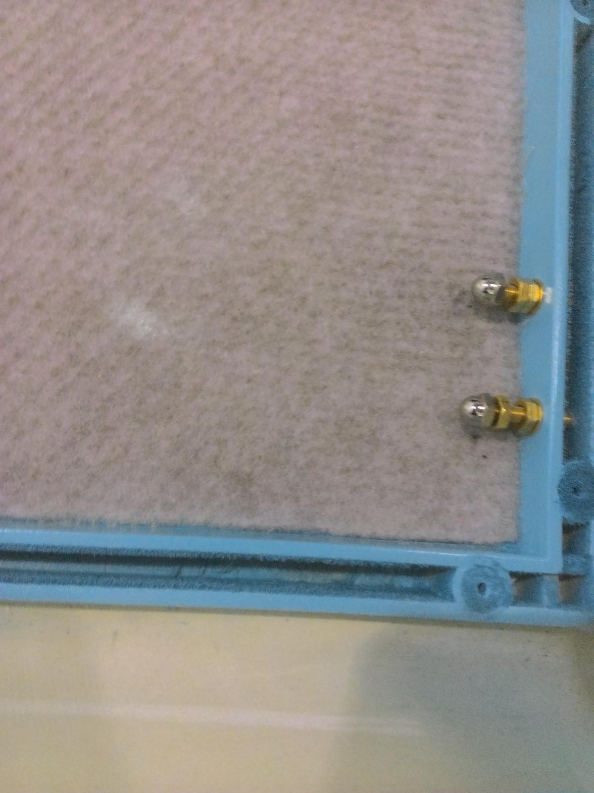

Back to my Solar install, I drilled holes thru the edge and inserted brass
all-thread, wires are outside the tent, I chose to re-enter the tent in the back
I will drill hole in the plywood in the back and keep the cables inside the vehicle

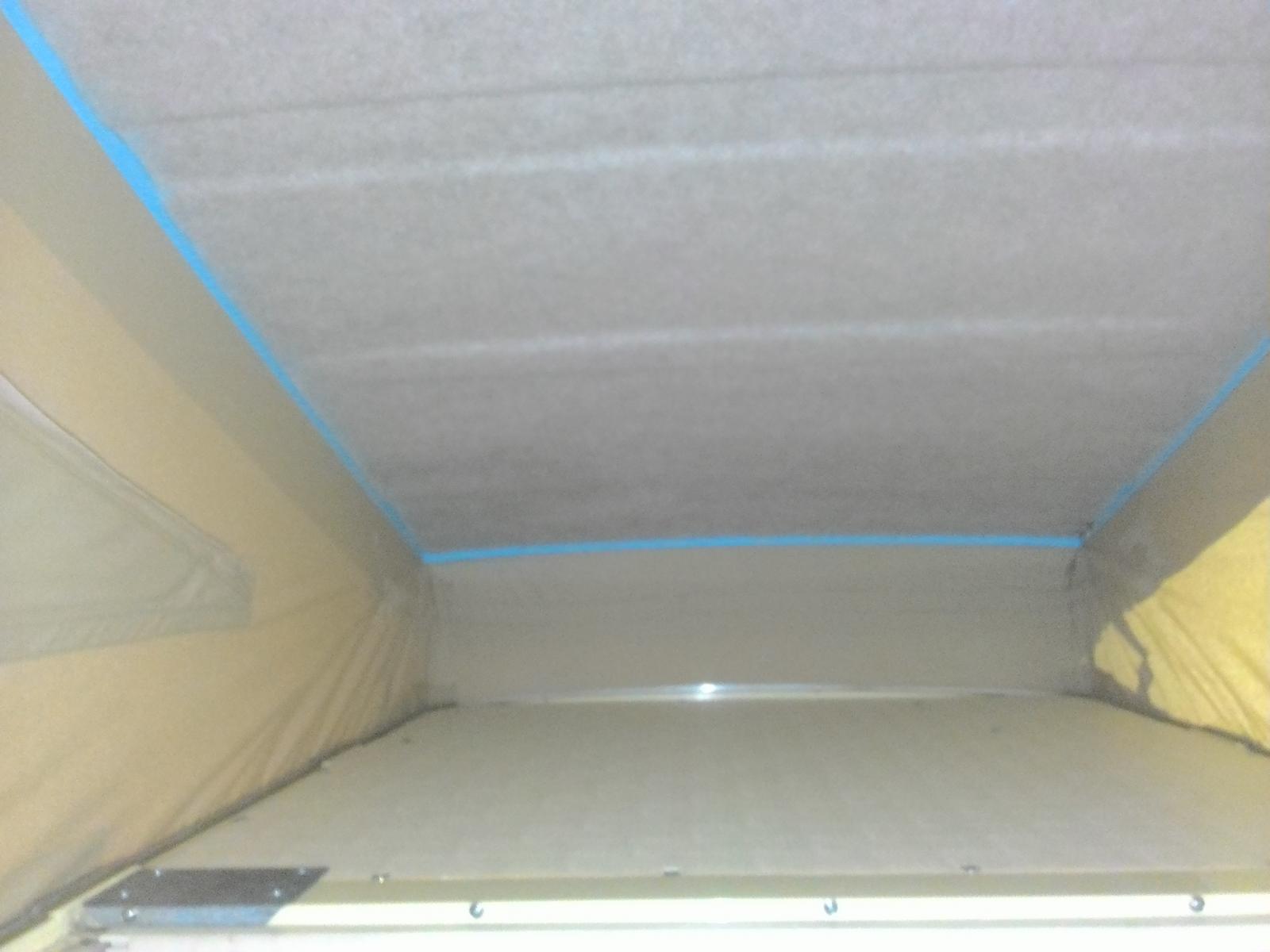

I installed my GW tent as per instructions, only note I will say is mark the top and bottom middles of the fabric before mounting
Ready for my friends to help it back up
A view from Inside

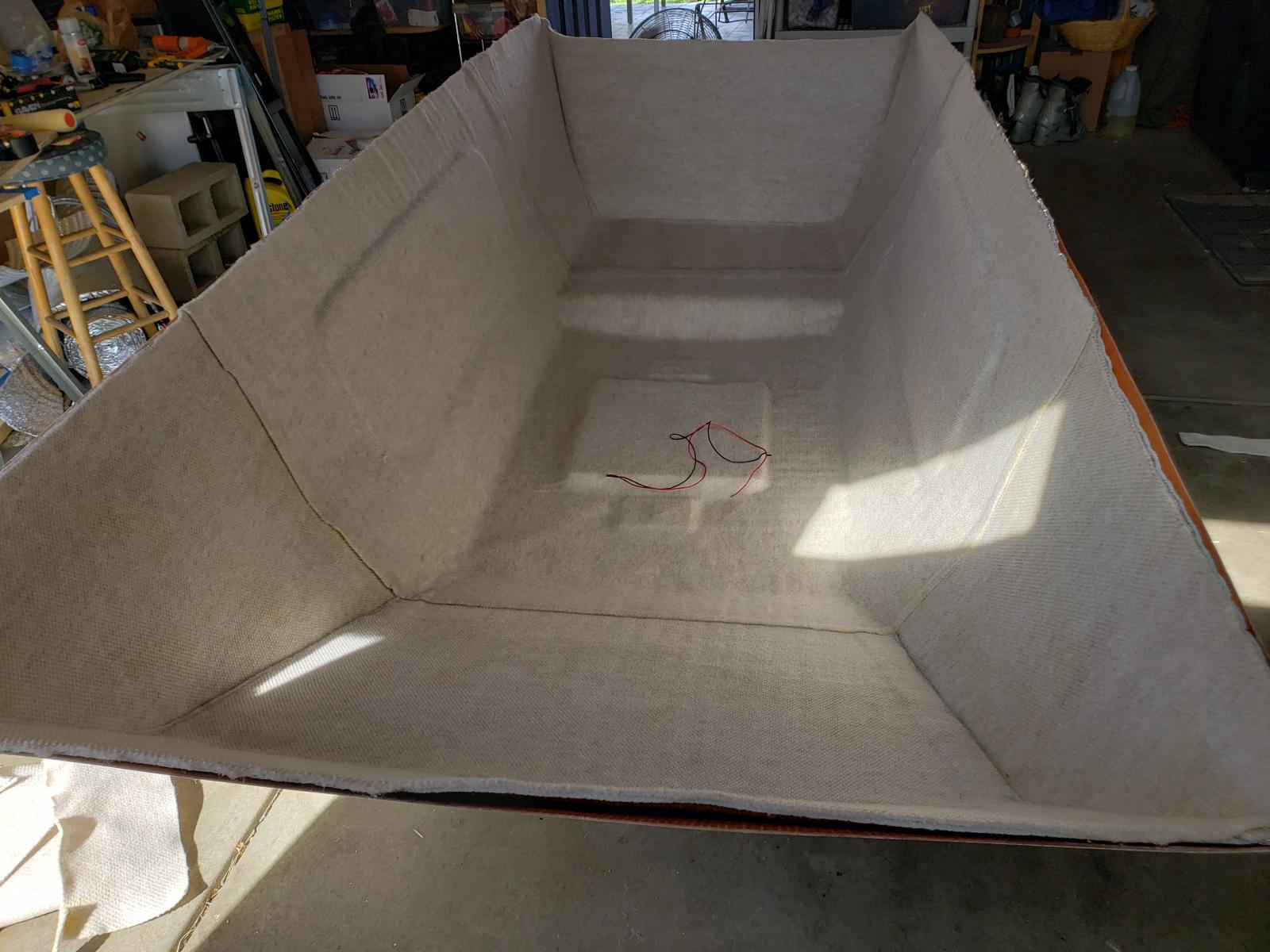

Very nice work, thanks for sharing it. How did you remove the old flocking? Or did you just glue over it?

looks like he used acetone and a scraper.
Man, I have to agree that hull liner material is aesthetically pleasing.
Acetone (laid on heavy) and a paint scraper. We talked through his process over the weekend. I used the same removal technique on mine and it worked really well.

We’re doing a re-paint of our westy and I’d like to install low profile solar while I have the roof off - your technique looks great.
I didn’t understand just how you routed the wires as I’m not sure just where this picture is. Along the outside of the tent to the rear?
puchfinnland wrote:
You’ll attach wires to the brass all thread on the inside and continue on to the controller?

answering questions-
[quote="Alaskaberrys"]Great write up and pictures, thanks!
[quote="puchfinnland"]
the solar wires connected INSIDE to the brass screws, and then continued outside, in the rear, they jumped back in as I prefer to make a hole thru the plywood, rather then drill holes in the metal outside where a leak is more of a possibility.
