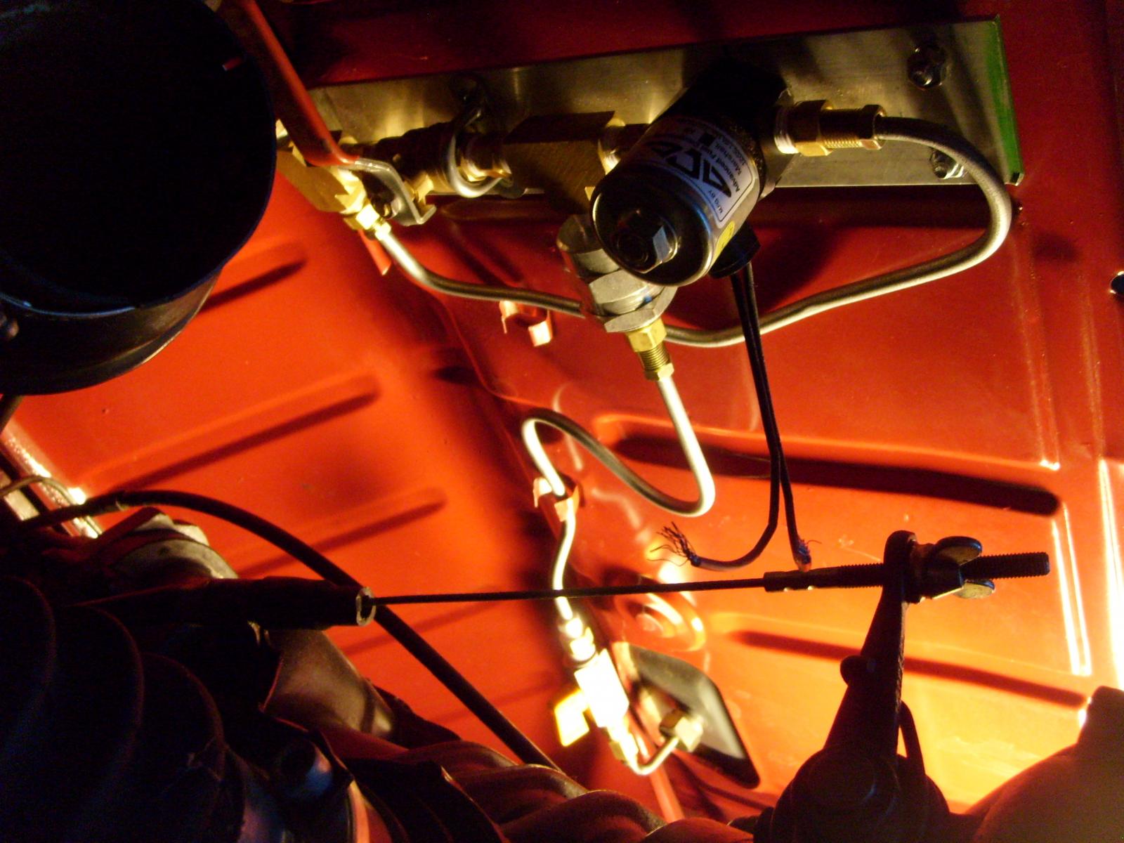

PostPosted: Wed May 21, 2014 4:29 pm    Post subject: Reply with quote
Here is the solenoid valve install that I had ended up with.
There were a lot of otter issues I wanted to deal with at the time so that's why my install is more complex. http://www.thesamba.com/vw/forum/viewtopic.php?t=578216&highlight=shutoff+valve
And then there are various ways to wire it up and control it.

PostPosted: Thu May 22, 2014 12:54 pm    Post subject: Reply with quote
Desertbusman wrote:
THAT is a high and tight install. Very nice.

Desertbusman
Joined: June 03, 2005
Posts: 14654
Location: Arizona
Desertbusman is offline
PostPosted: Thu May 22, 2014 3:32 pm    Post subject: Reply with quote
Thanks M.
I'm not thrilled with the filter. I miss the $3 plastic throwaways. You can replace them once in a while whether they need it or not.
