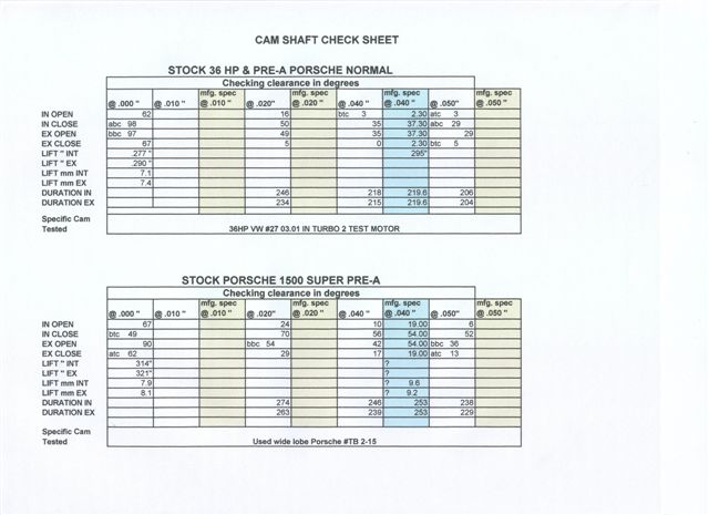

This is all I could find on the Aircooledresearch cams. I have one packed away, will have to see if it was sent with a cam card.
gimmesomeshelter wrote:
This is the information I've seen:
"The camshaft is from Mr. Motorhead and is his #2 which I degreed at 0”, .010”, .020”, .040” and .050” to get figures to compare to any other 36 cam. This cam is closest to the early Porsche Super cam. (Intake Opening) 17 degree, (Intake Closing) 45 degree, (Exhaust Opening) 49 degree, (Exhaust Closing) 7 degree = 242 degree duration intake. 236 degree duration exhaust and all at .040” or 1 mm. Valve lift is 325 intake valve and 302”exhaust."
https://www.thesamba.com/vw/forum/viewtopic.php?p=6131340&highlight=duration#6131340
