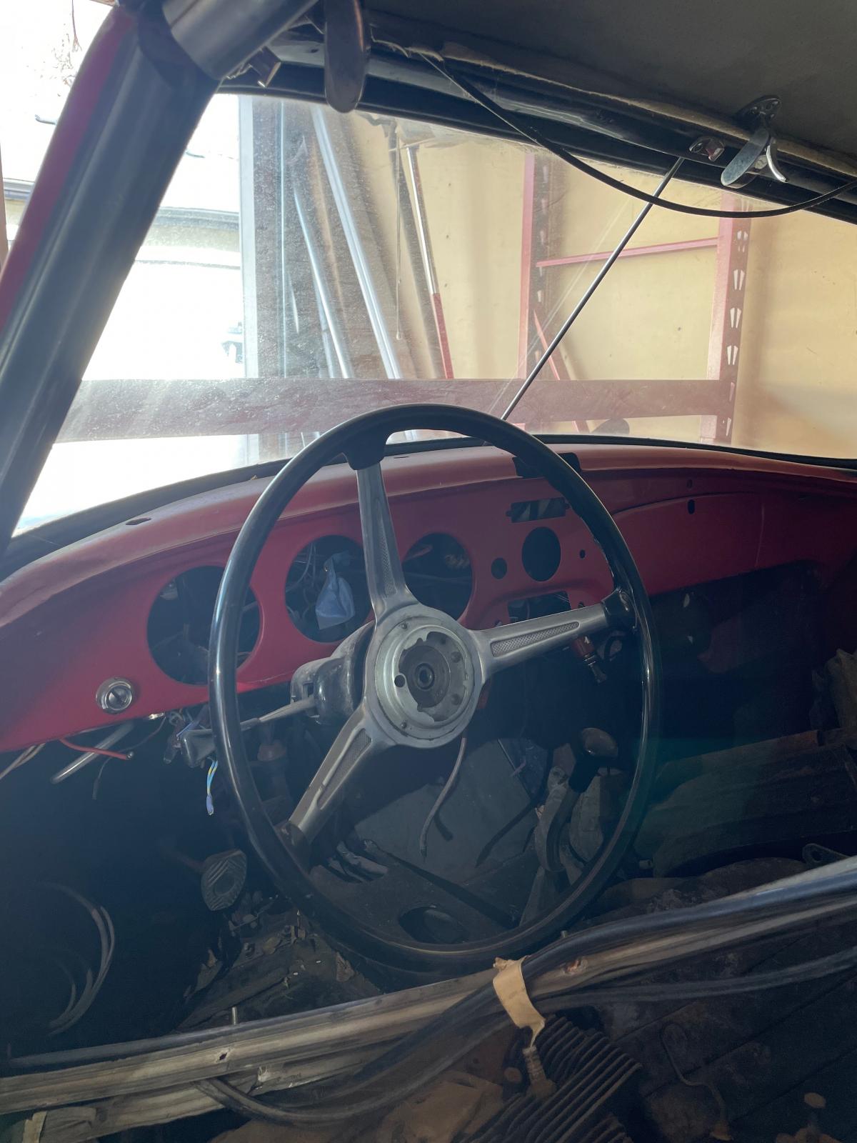

Also, regarding the steering wheel, it is unlikely there was a transition period where they used older model parts on new models for a couple of reasons. It may have applied in the very early days but by the 60s Porsche was a real company and any older model parts were put into “Service Parts” stock for mechanical and bodywork repairs. On top of that the T6 B debuted in ‘62 so your car was at least a year into production.
As for the Nardi wheel, if it is a Period Nardi from the 60s and is n nice condition, it could bankroll a good amount of the restoration. These have changed hands for upwards of $5,000. If it is the generic fat rimmed wheel from the 70s - 90s with the generic “Nardi” horn button then it’s worth about $300 and it’s probably better to use the stock wheel.

Interesting about the Nardi wheel. I don't know much about them but don't think it's from the 60's. It did have the Porsche logo horn button and one of the spokes was engraved with "Nardi".

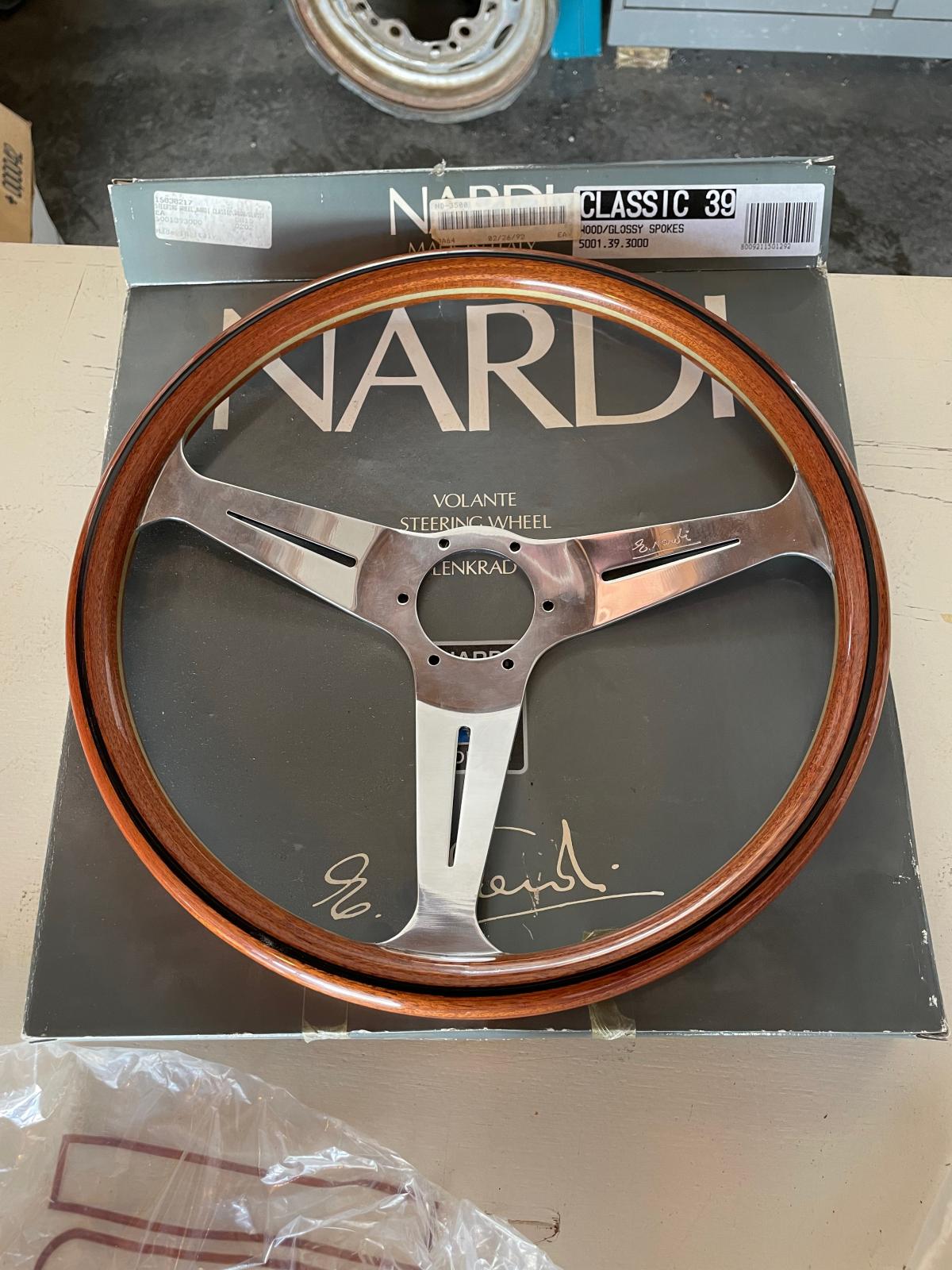

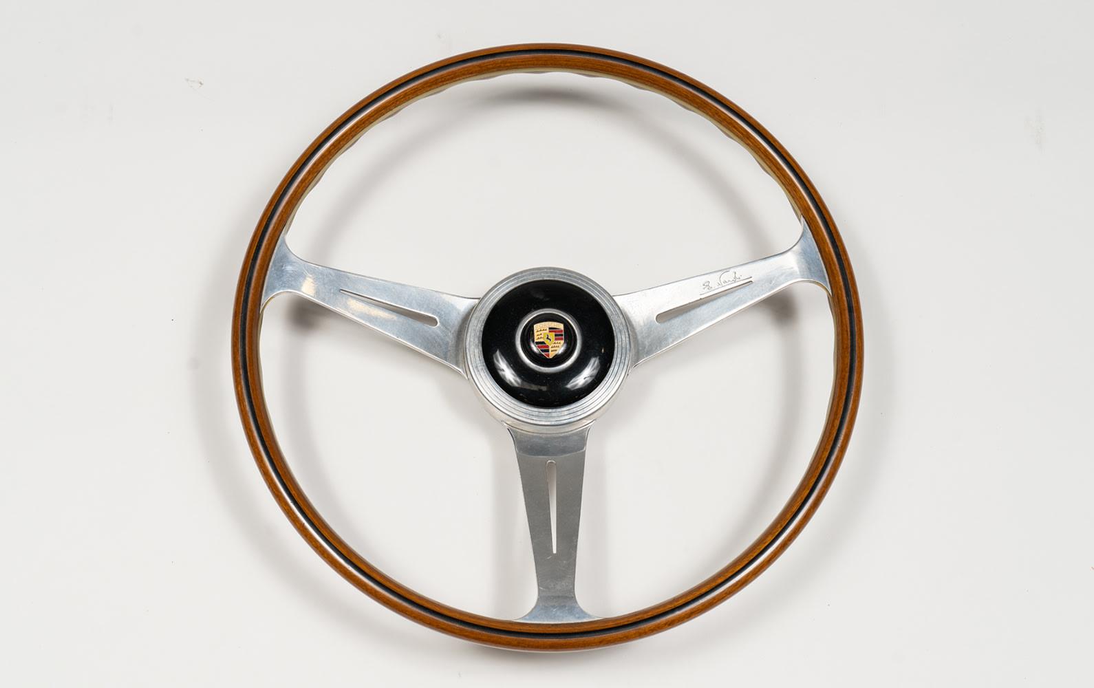

Here is a larger diameter period Nardi wheel:
And here is a later, smaller diameter wheel with a fatter rim. This was sold for decades from the 70s on as a generic wheel that fit many different sports cars:

Interesting. I'm pretty sure it's the later one, but I'll have to take a closer look.
What are the differences between the T5 and T6 steering wheels?

The T5 steering wheel has flat, sharp edged spokes while the T6 wheel has rounder spokes with a softer edge, otherwise the wheels are identical save for the number of finger grooves on the back of the rim.. Why the change was made has never been determined.
Here is a closeup of T6 wheel spokes, compare it to the spokes in your picture.

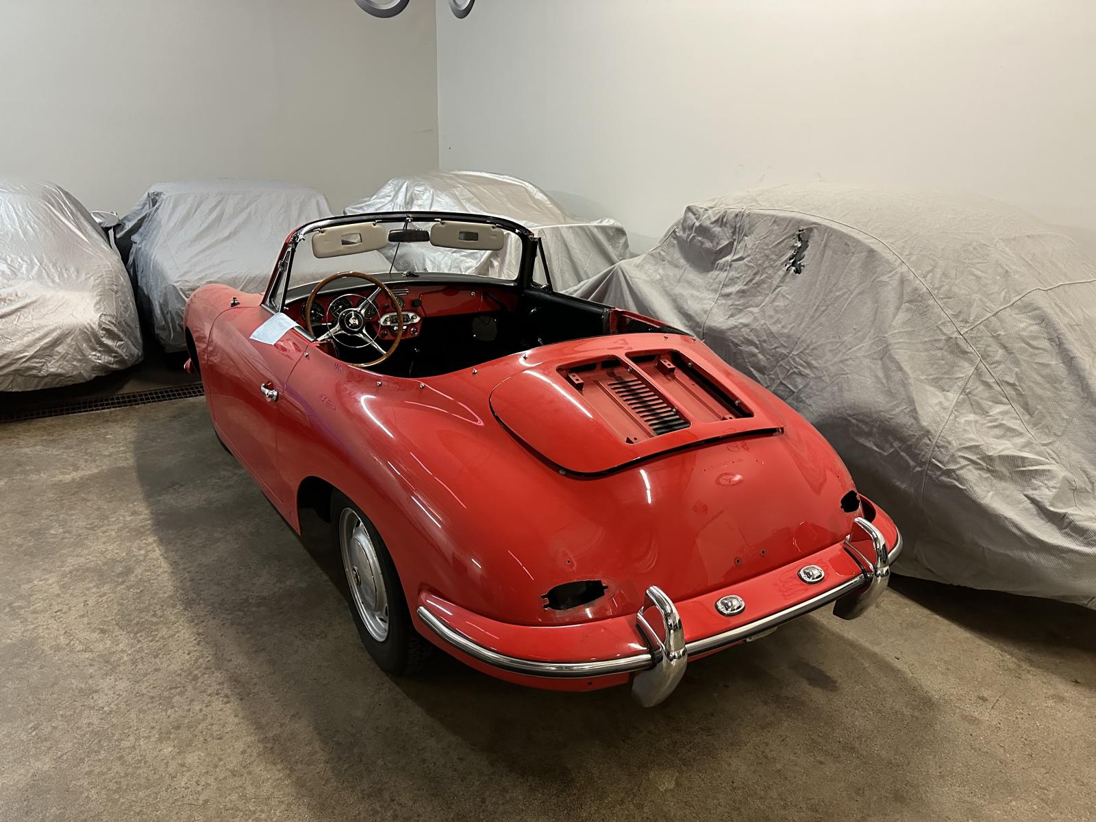

Ok, I was able to spend some more time going through the whole car and the boxes of parts. Unfortunately, it's not as complete as I was hoping and there seem to be a lot of little bits and pieces missing. I guess over the years, he's misplaced some things. The interior also looks like it had been in a flood. He said he recalls having the interior stored in his basement and the basement may have flooded. The good news is, we were able to pop both hoods, although there was nothing really to see. All looks pretty solid except for some surface rust where the battery sits. I was also able to verify that the engine and gearbox are original and match the numbers on the original dealer invoice. Here are some more pics:
Should this condition and this kind of repair work scare me?

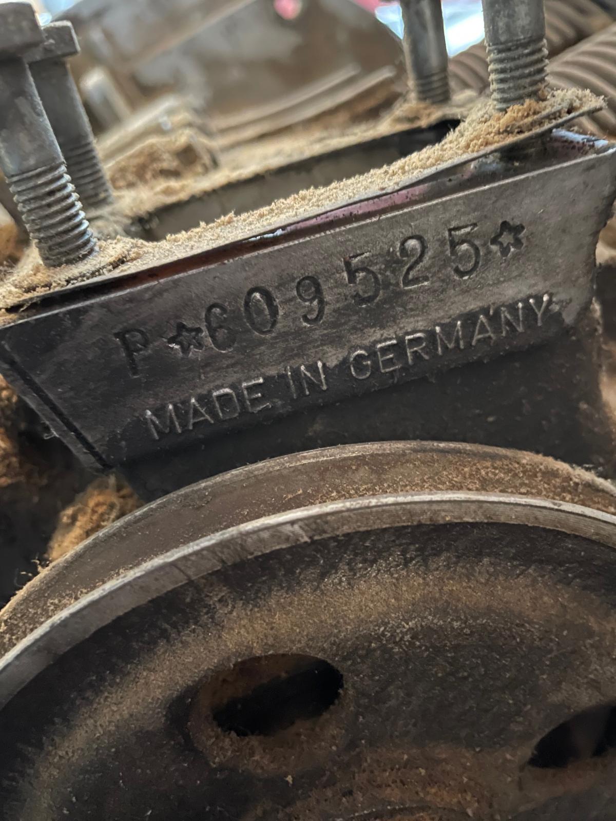

Engine number matches.

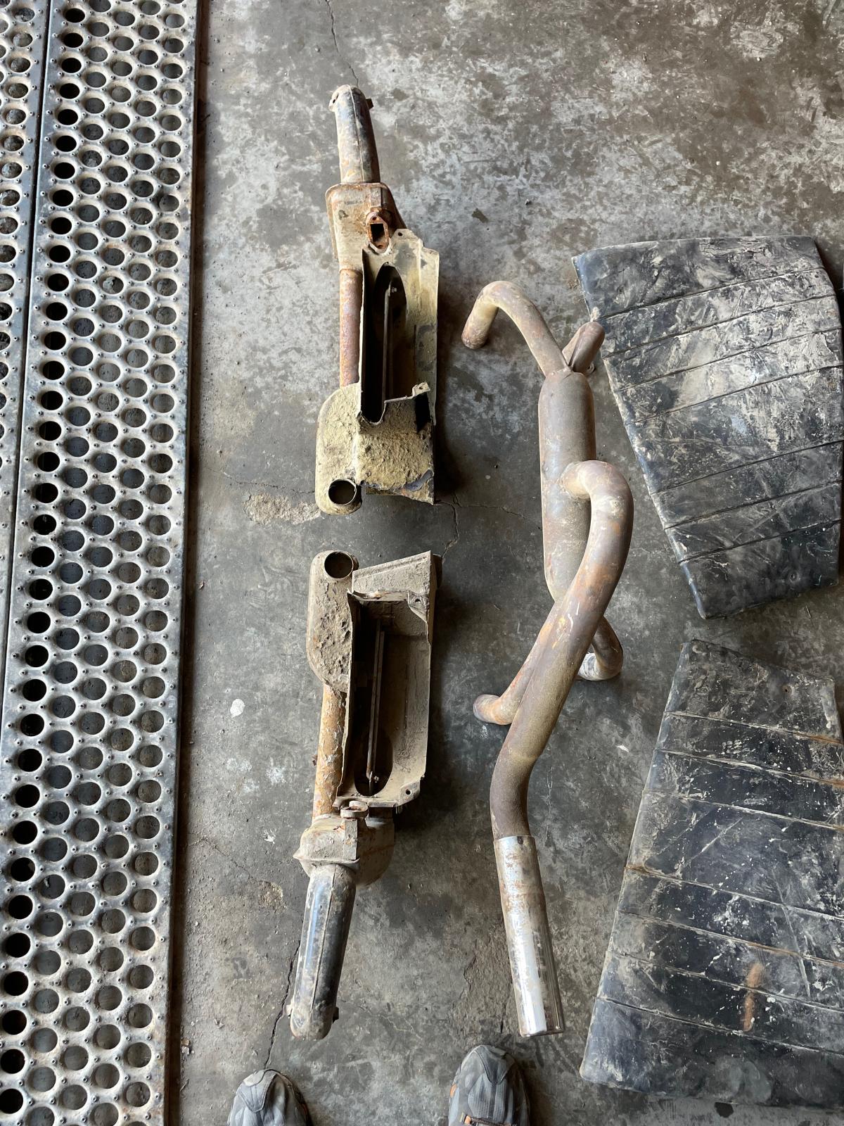

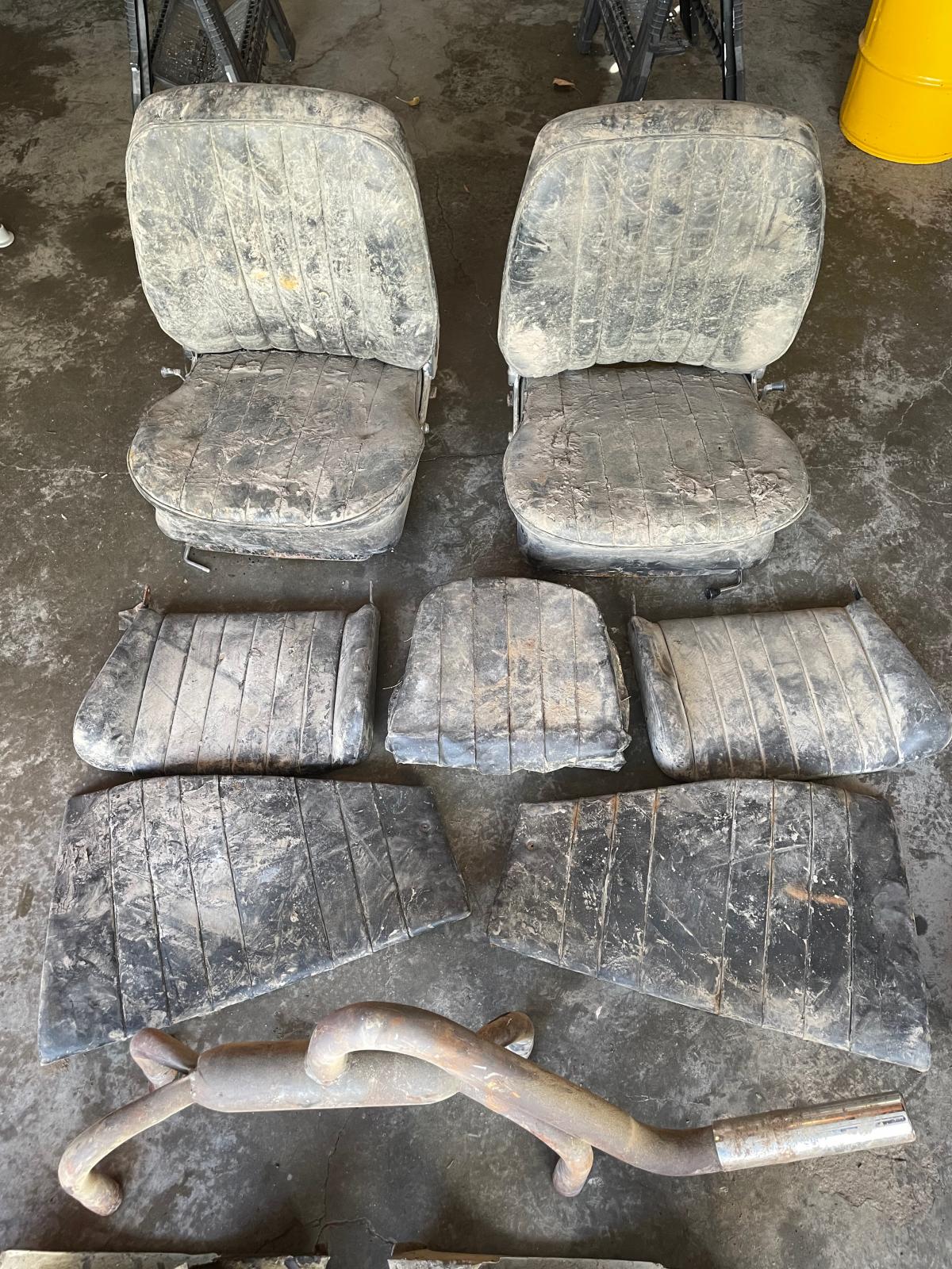

Any idea what kind of exhaust this is?

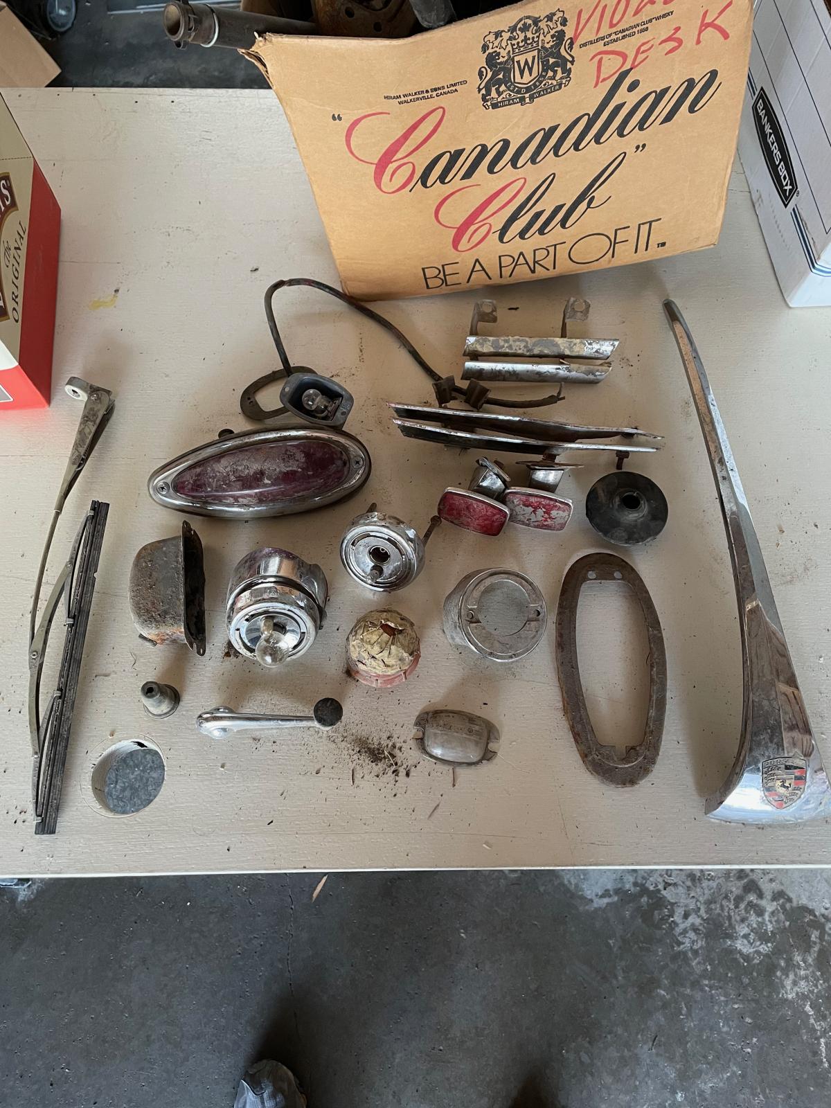

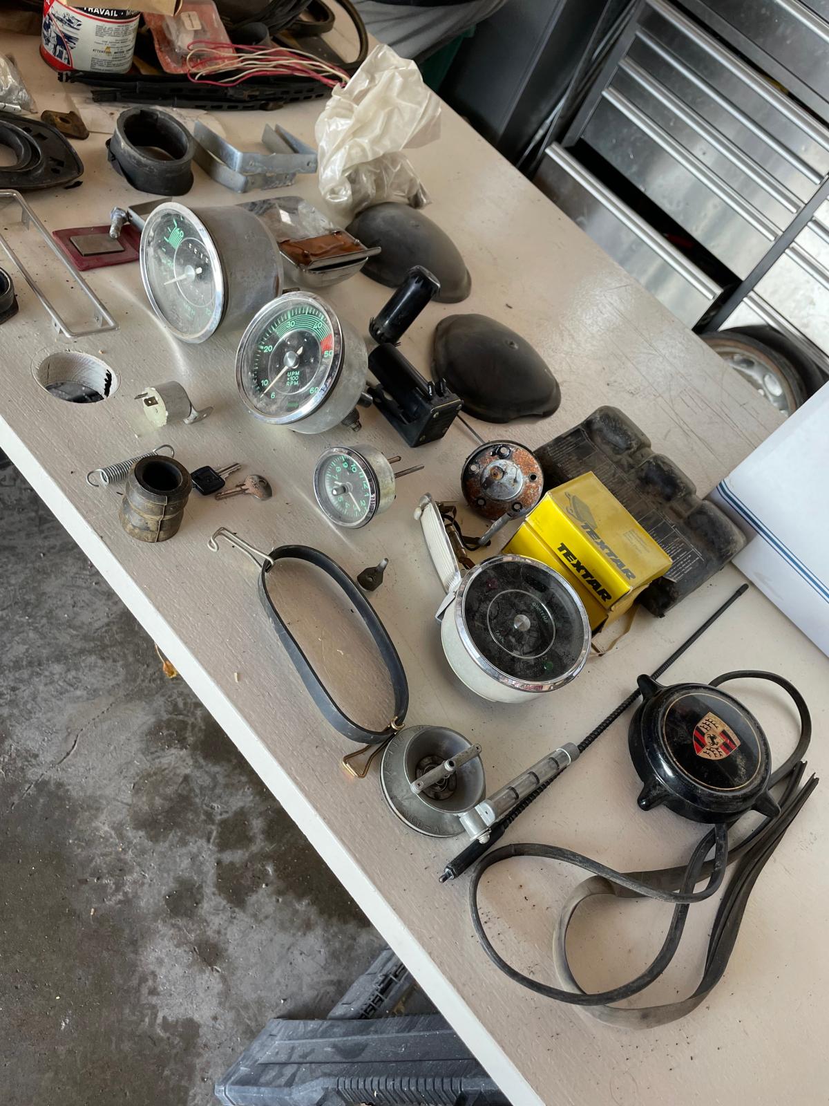

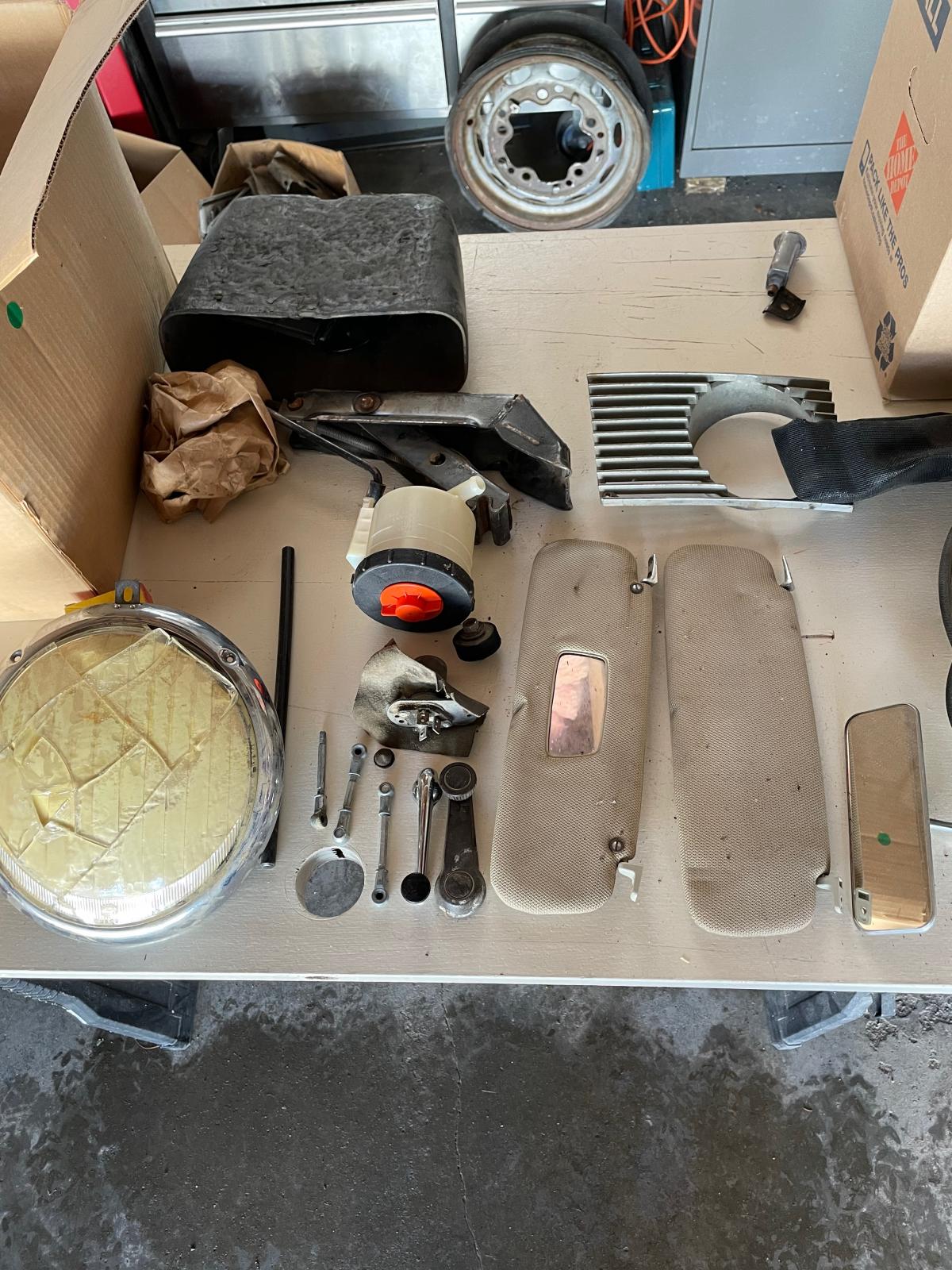

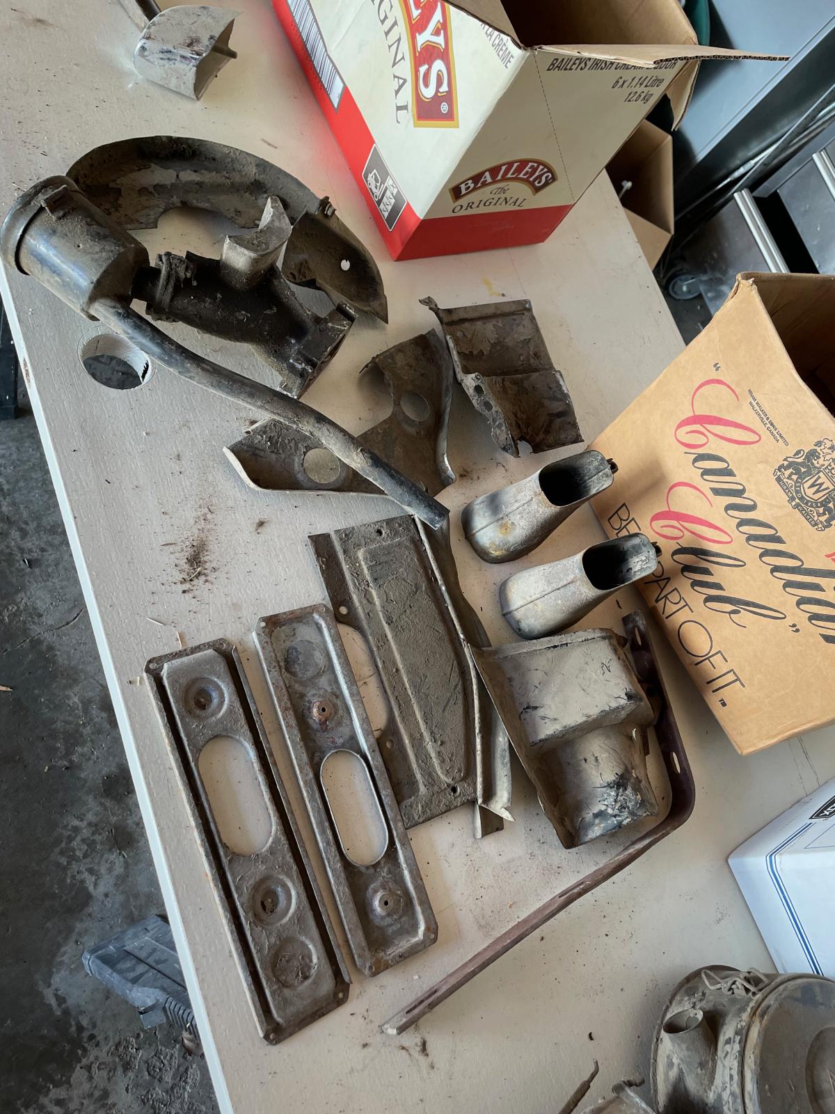

Some random pics of all the parts that were in boxes. Some may not even be Porsche...

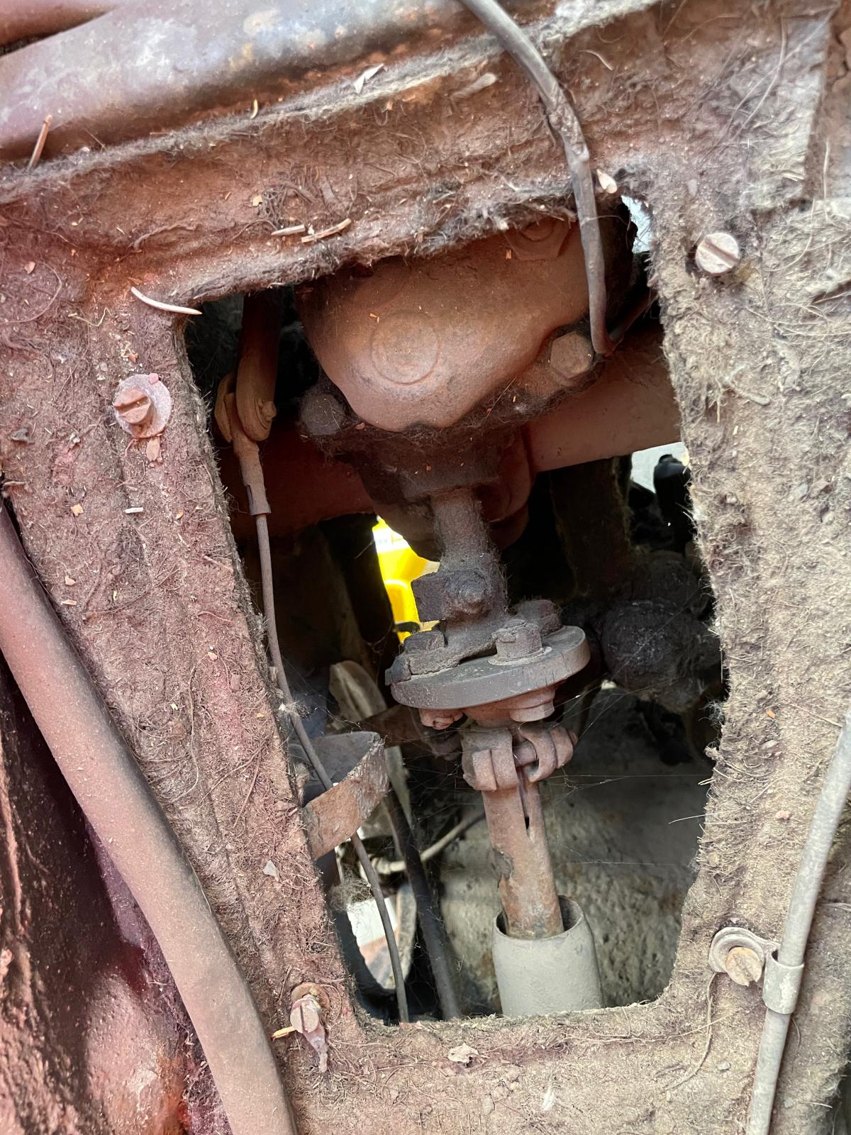

Cover for steering coupler

Some exterior trim, lights, etc.

Given all of this, I'm looking for advice on what to offer, whether this would make a good restoration candidate, and how available parts are. Also, do things like the missing serial number tag on the hinge cover, and other important missing pieces detract from the current and ultimate value of the car? Anything else I should be really wary of?

OK, things are looking good and I would not worry too much about what is still missing, they are not nearly what would be a reasonable deal breaker.
I will give some opinions on each picture if I may:

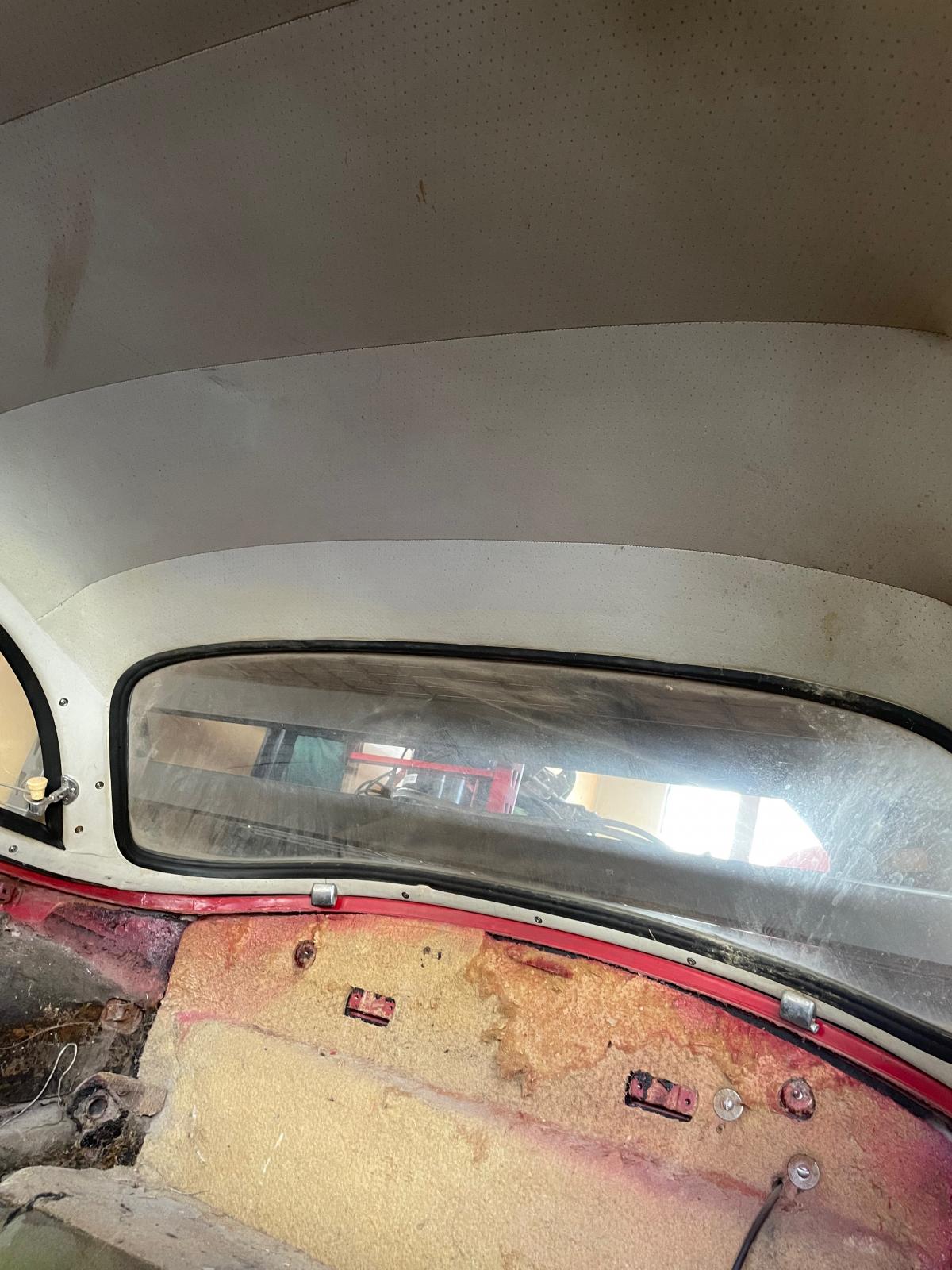

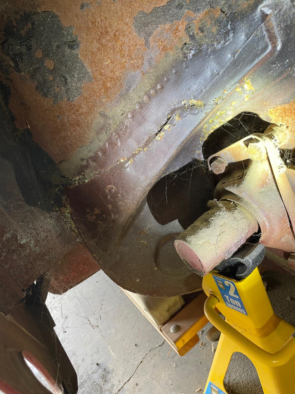

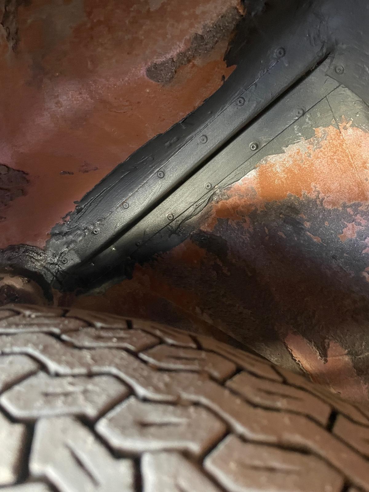

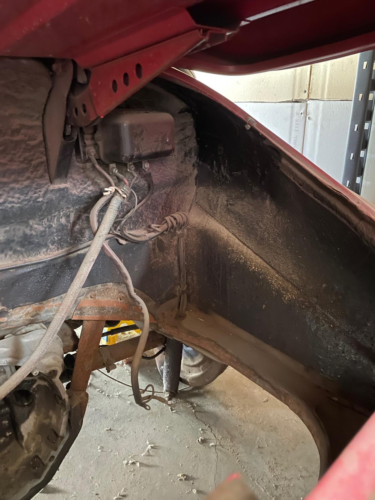

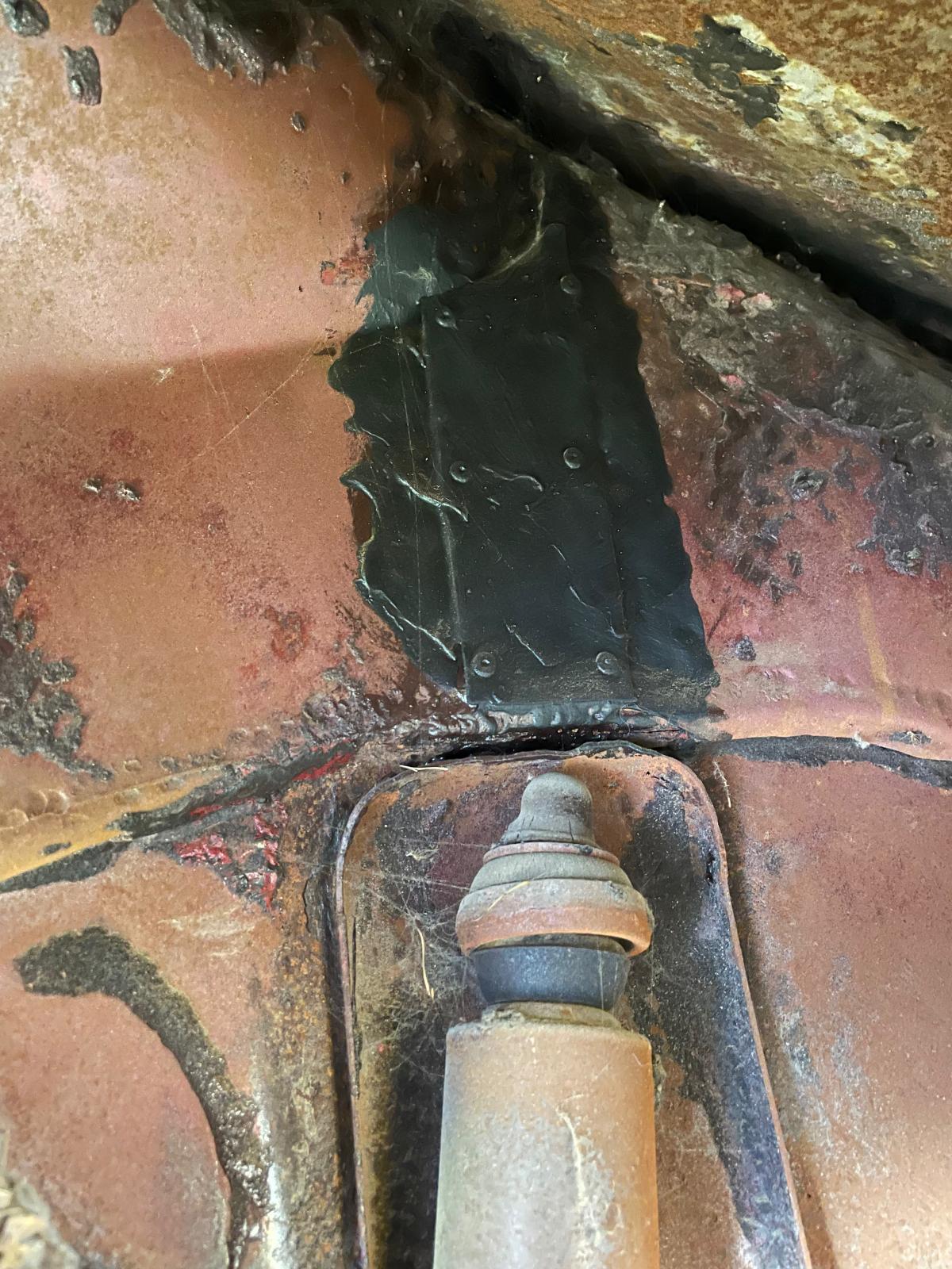

Left front wheel well looks great. That's not necessarily surface rust because Porsche sheet metal was primered in a light red.
Folding top looks very restorable, it even has the "chicken wings" at the ends of the lower bow, they are HTF and expensive.

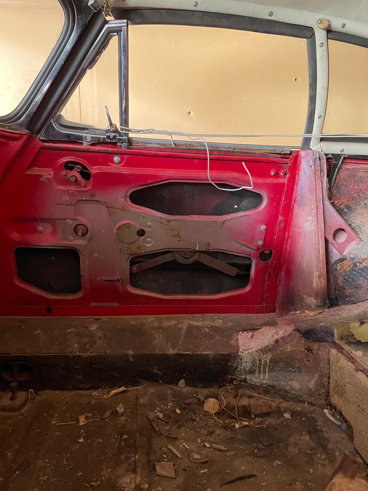

Inside structure of passenger side looks good.
Headliner on the hardtop looks great, there are a couple of turnbuckles that hold the top down from the inside at the rear, they are available but the little chrome covers you have are not and they are nearly impossible to find.

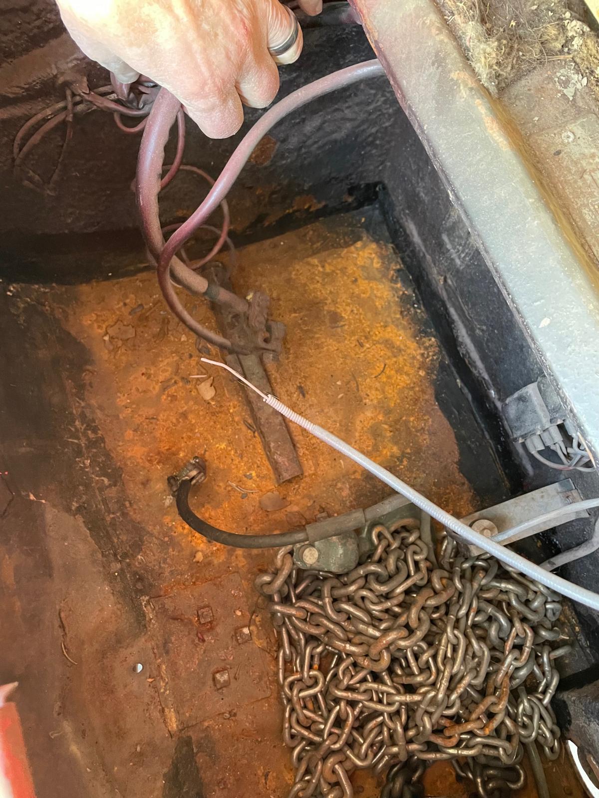

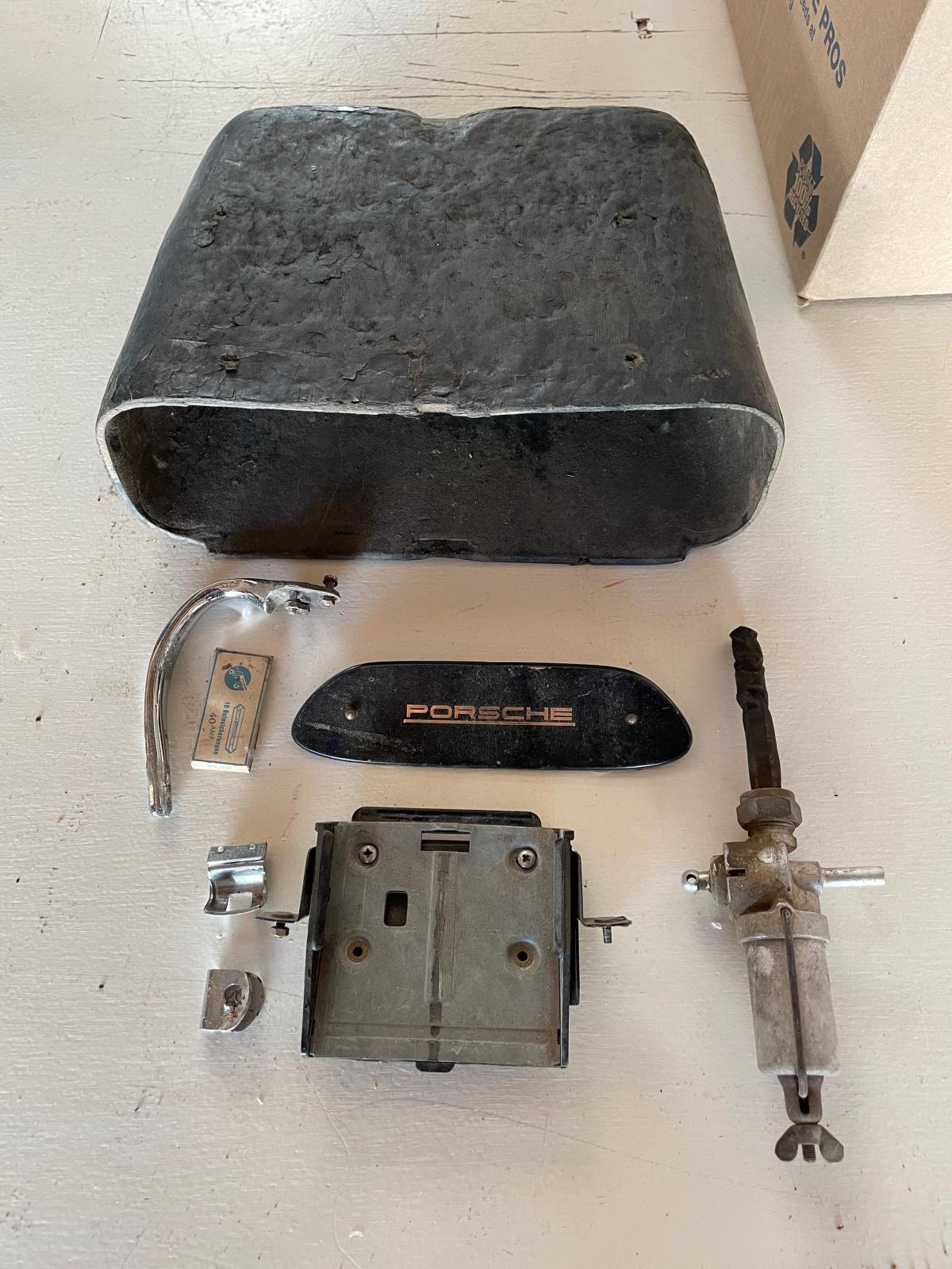

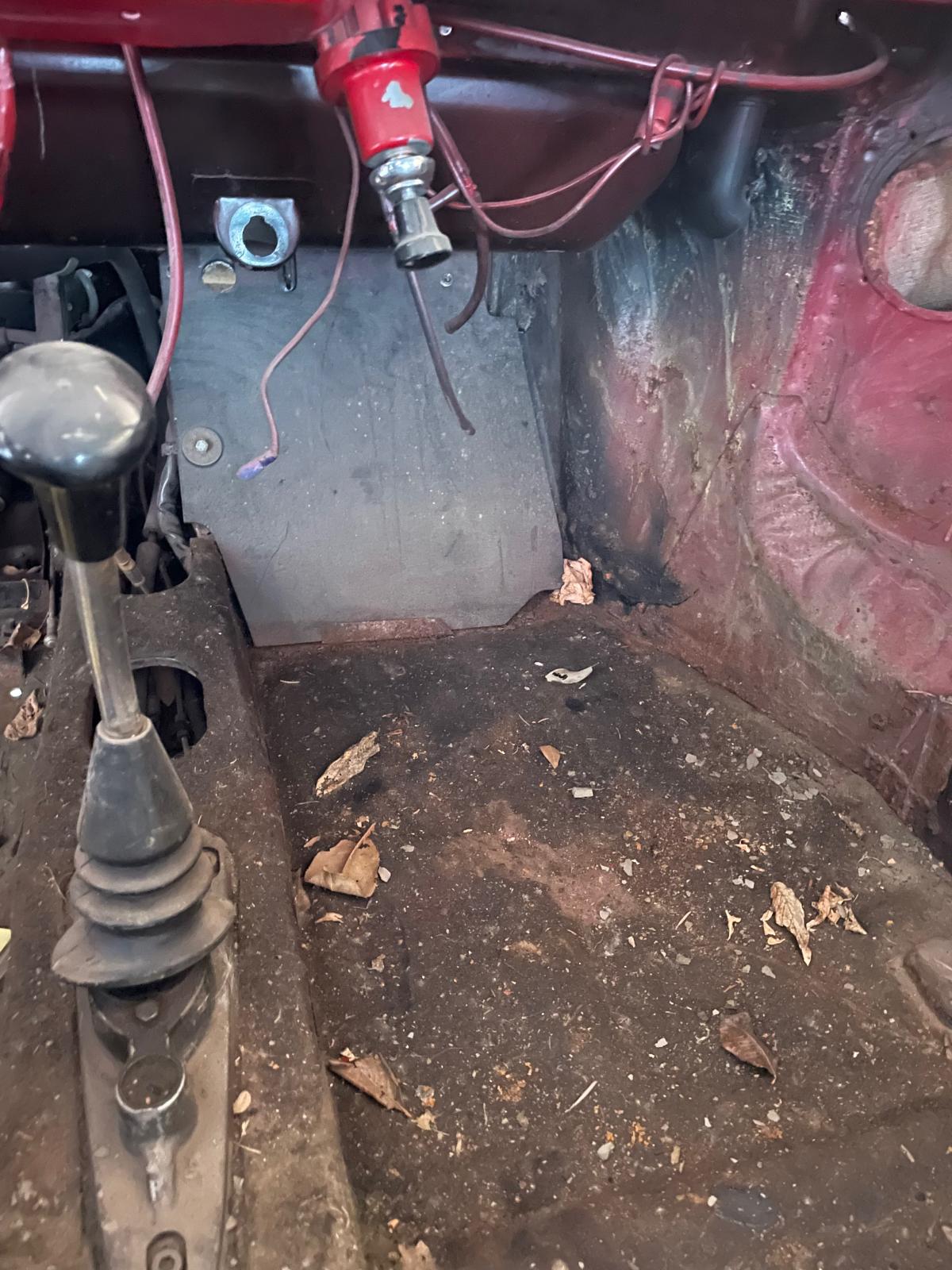

Passenger footwell looks fine save for the overspray, there is a fuel tap rod that is is missing in the picture but easy to get. The shift knob is original, the repros do not have the mfrs dimple at the top. Hopefully he has the key for the shift lock. It's good you have the headlight switch, overspray should be removable.

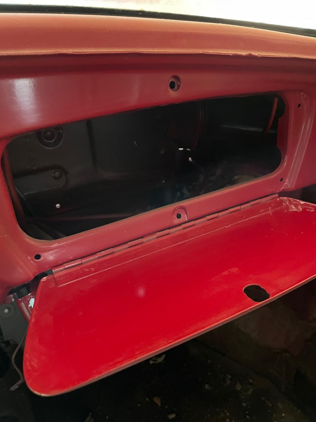

I saw the actual glovebox in another image, make sure the securing strap is behind the dash.

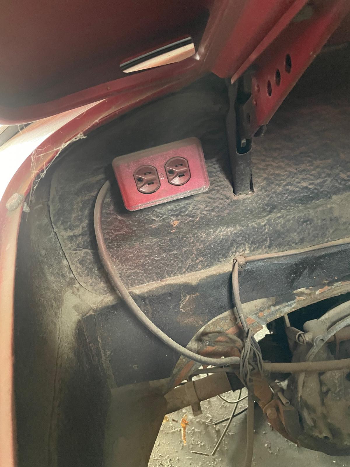

rear seat area is fine, I would love to know what he used the wall outlet plug for, if only these cars could talk!
Drivers footwall looks fine, I would love to know what those things are dangling from the wires, they are not factory. The long tab for the wooden floorboard looks great, those are usually all bent up.

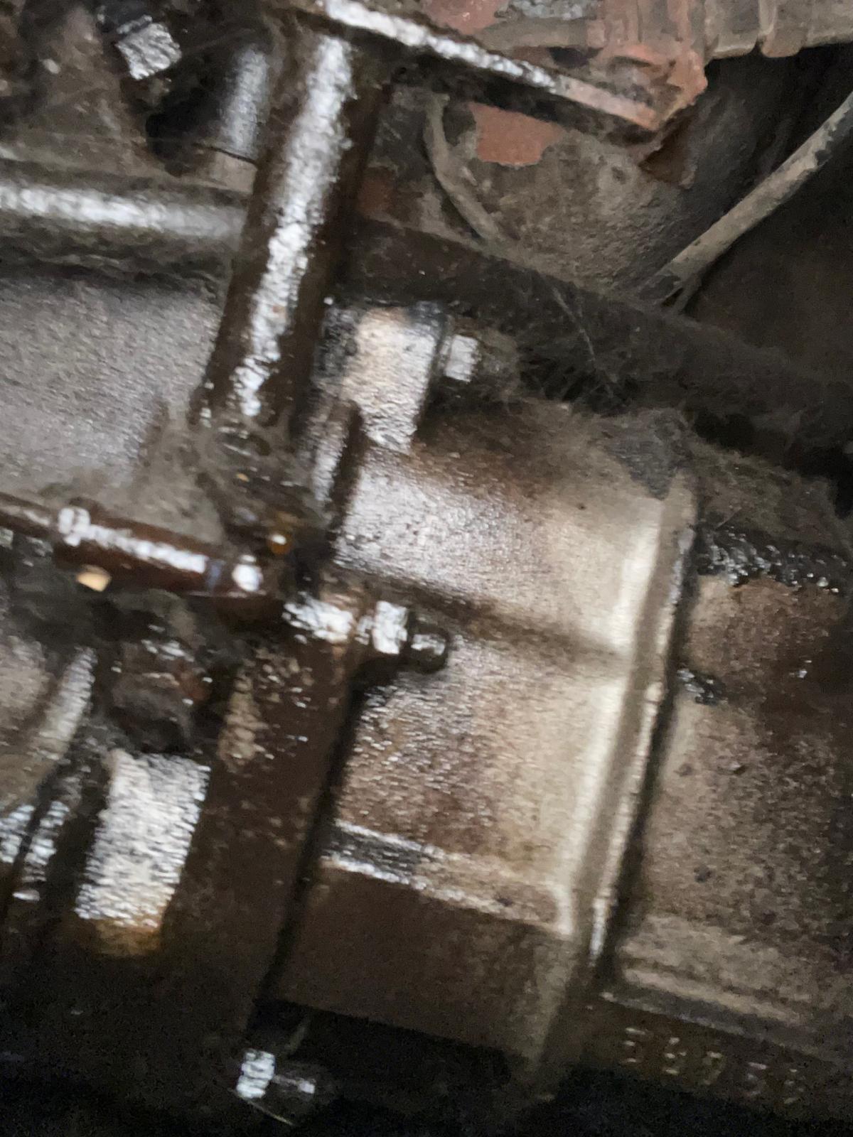

Trans number image: lots of 90 weight, could be coming from a lot of places, all fixable. Engine number image: congrats on matching numbers!

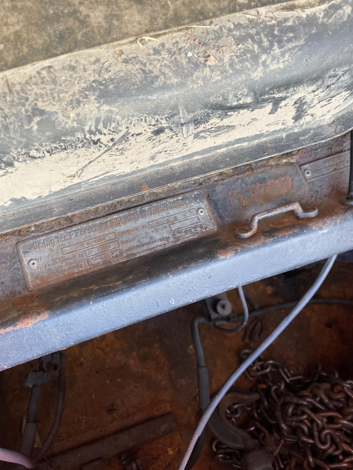

Data tag matches engraved number, always a good sign.

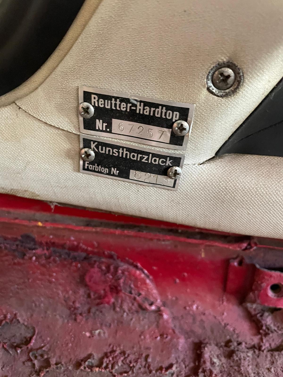

All hardtops came with Reutter data tags but no one has ever been able to figure out the sequence. Color tag below is for black paint on the hardtop. Mine is Ivory and they were almost always a contrasting color to the body.

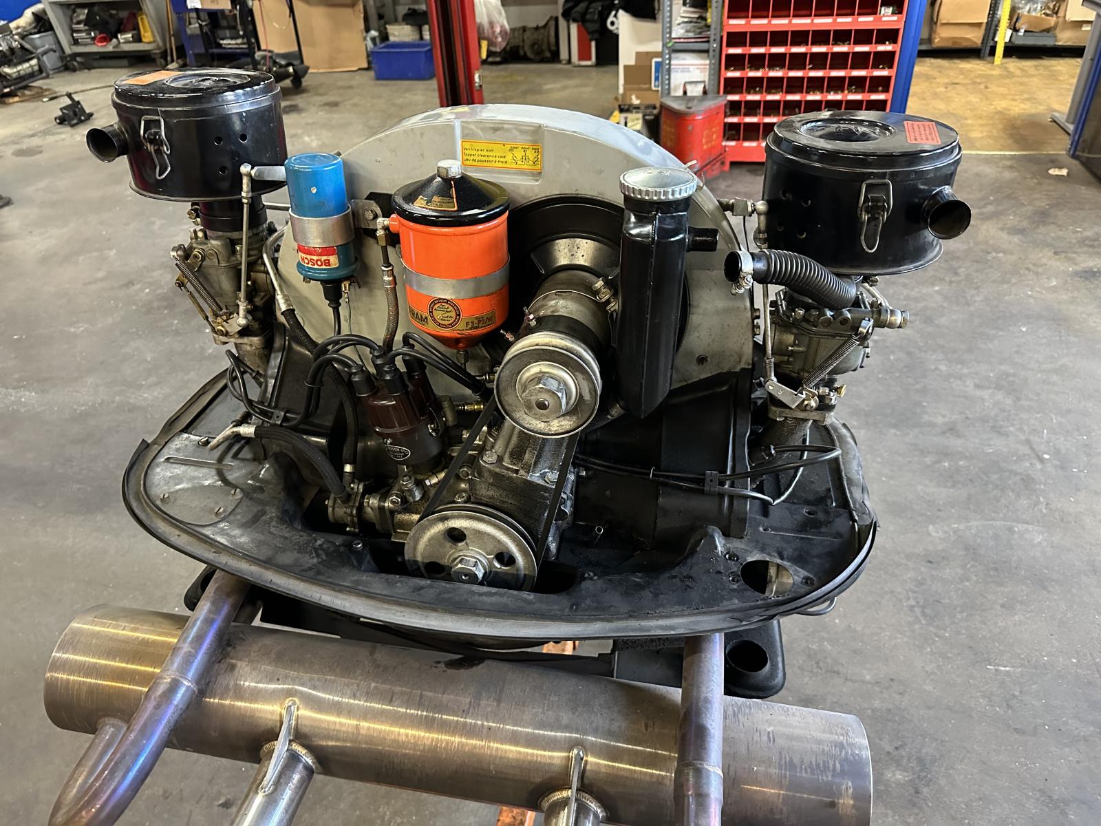

Engine compartment looks fine.
There's that wall plug!

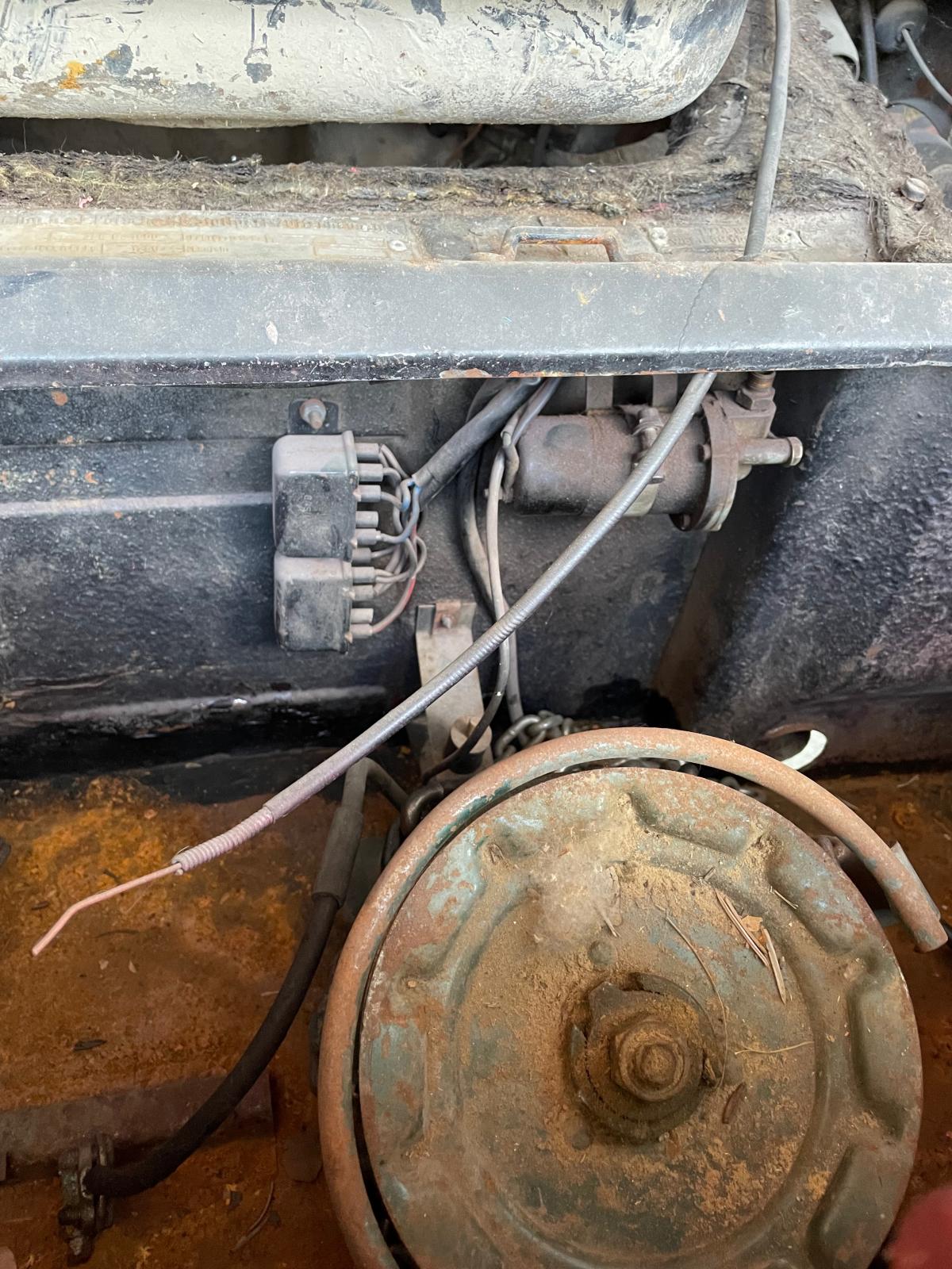

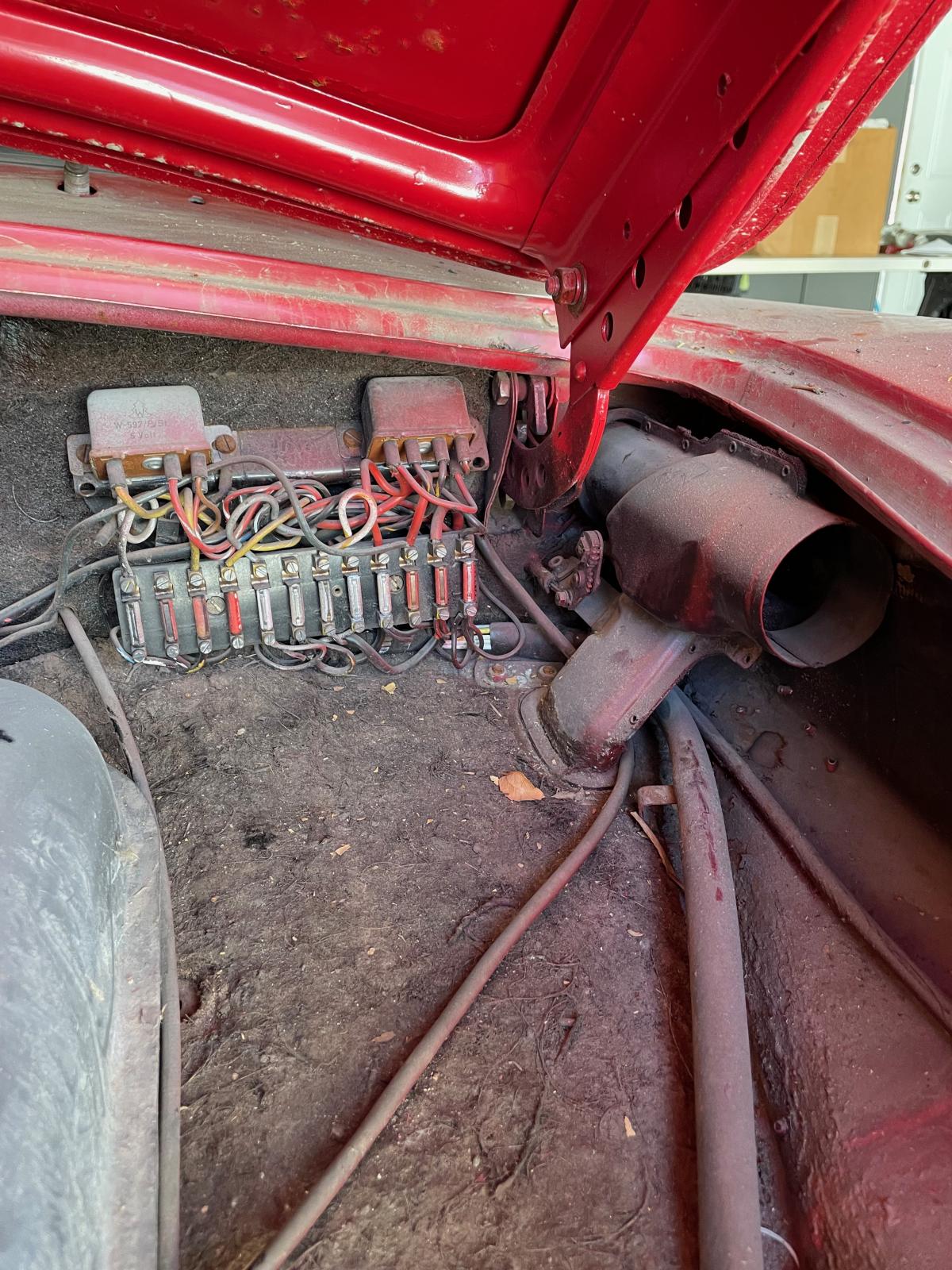

Big black regulator is correct, the wire wrapped around the harness below is for Carrera 4 cam additional distributor, lots of people use it if they decide to install an electric tach.

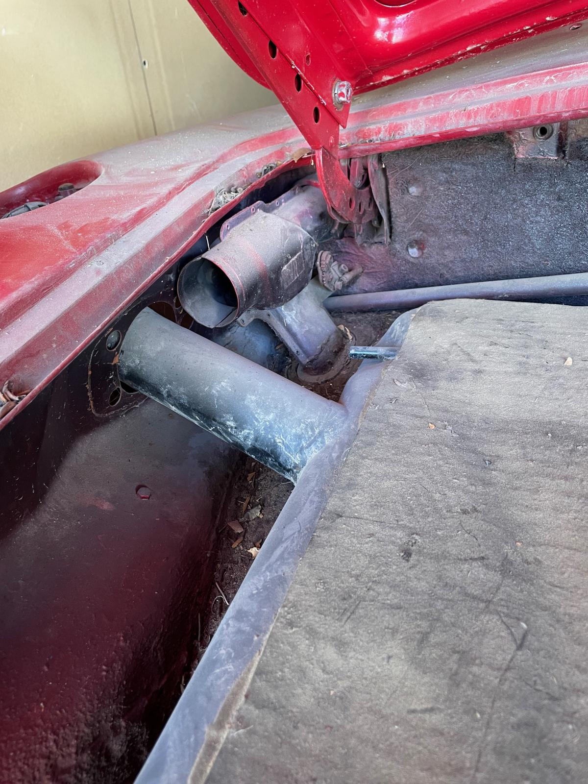

Great that the heat flapper boxes are there. The side covers in this picture are for use with the soft top in place, the side covers with the rest of the interior are for use when the hardtop is in place and are HTF.

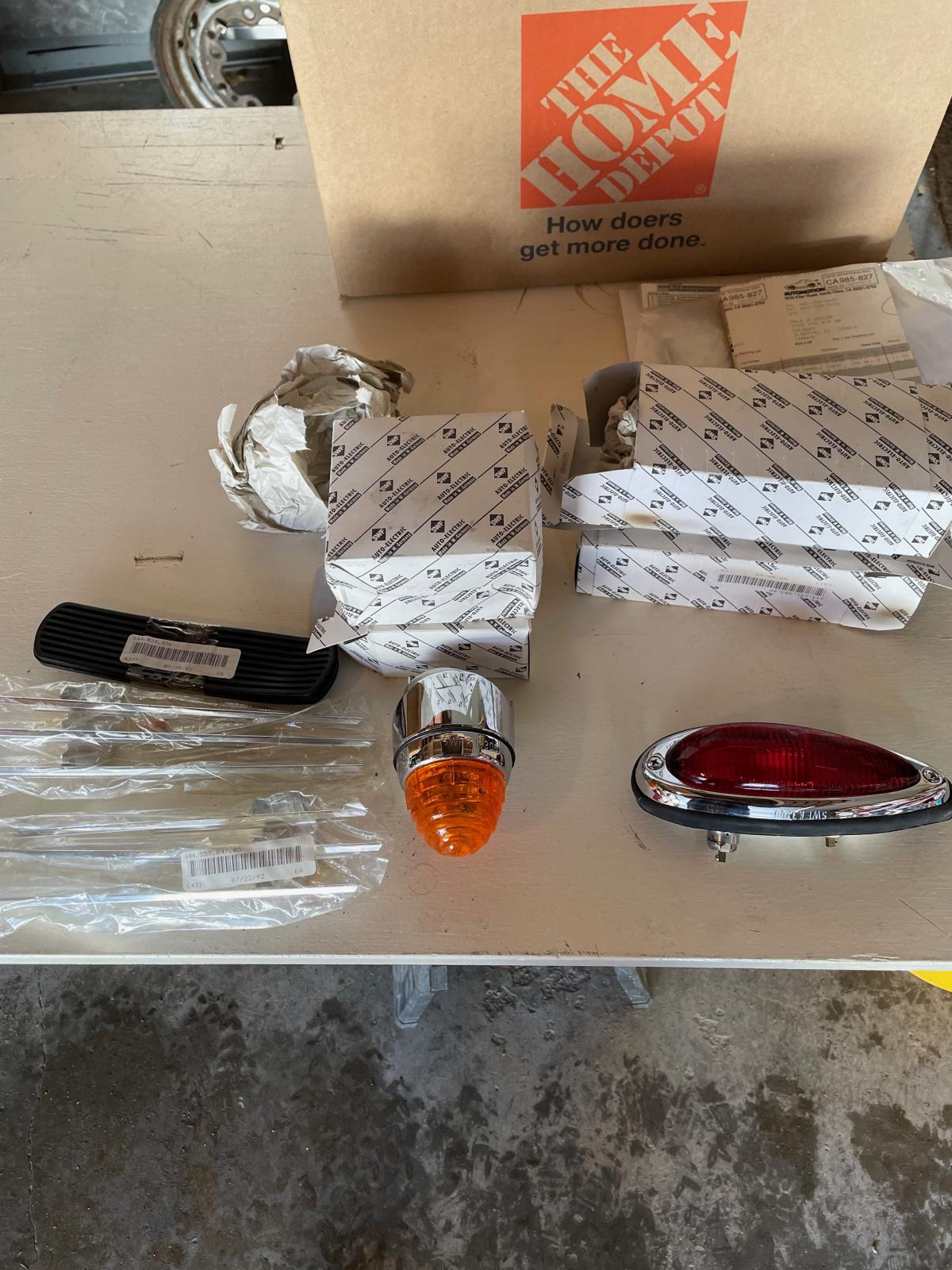

Always great to have new stuff come with an old car needing restoration.

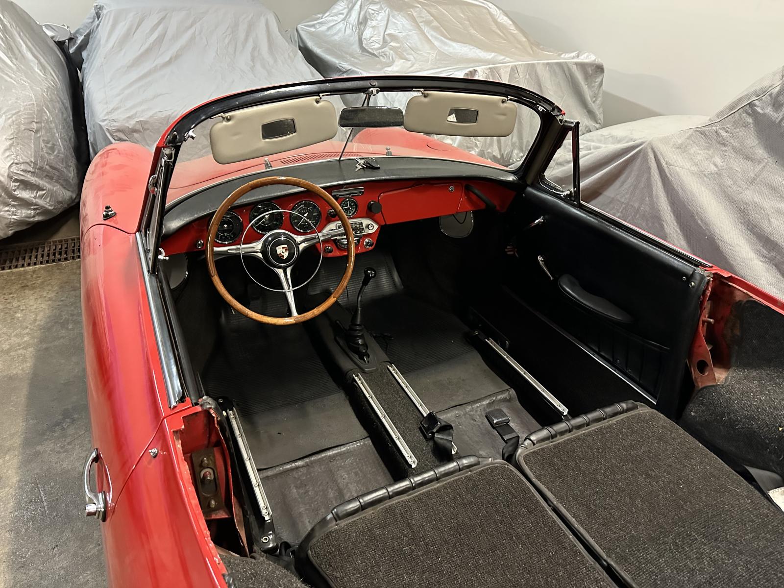

Yup, that's the later Nardi wheel. Use the factory wheel, sell the Nardi and use the funds towards the restoration IMO.

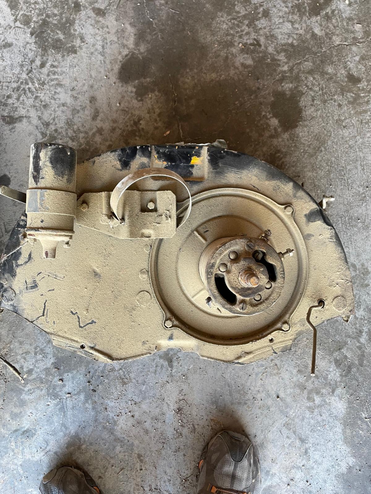

Under the dust the fan shroud looks to be good.

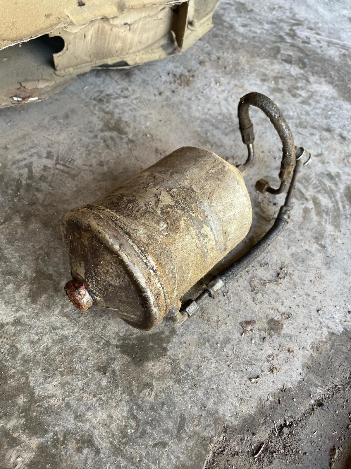

Oil filter canister with original hardware, you might not even have to replace the oil lines, just clean them up.
The ashtray housing is early 911, the little chrome pieces next to it are for the hardtop. Grab handle, glove box and fuse container are original as is the radio block off plate.
There are the hardtop turnbuckles, the reservoir and fog light surround are early 911 as is the all black window winder.
Lots of good stuff, a couple of pieces are early 911.

More good original stuff, the correct hood handle crest looks great.

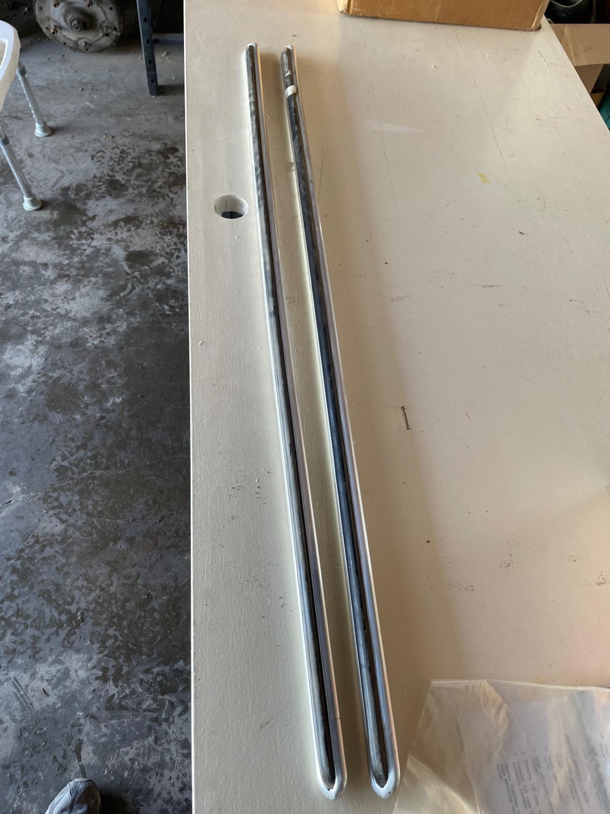

Excellent original side deco trim, note the closed ends. The Reproductions have open ends and look terrible.

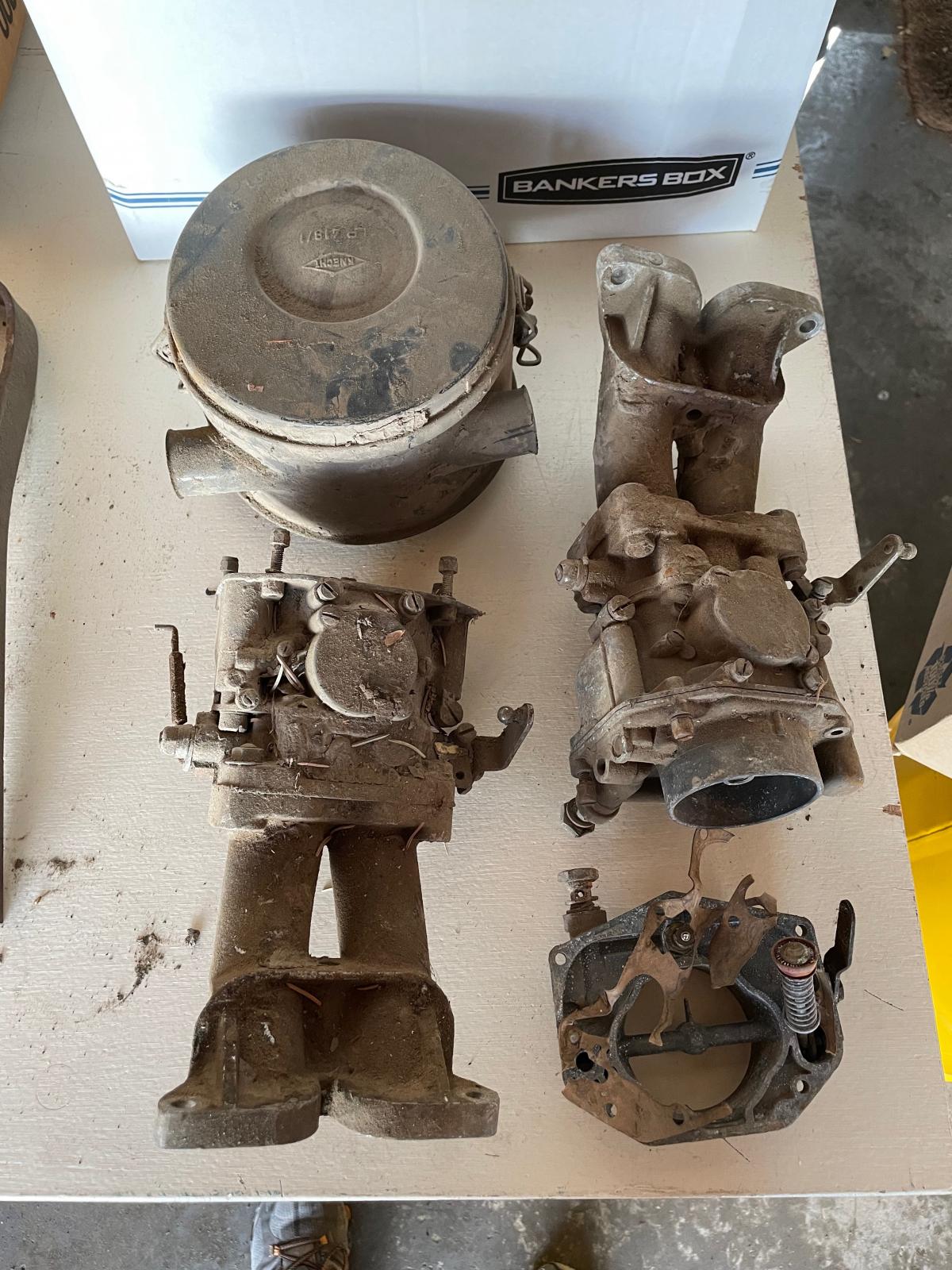

Zenith carbs and intakes are rebuildable, you will have not much difficulty finding a second air cleaner.

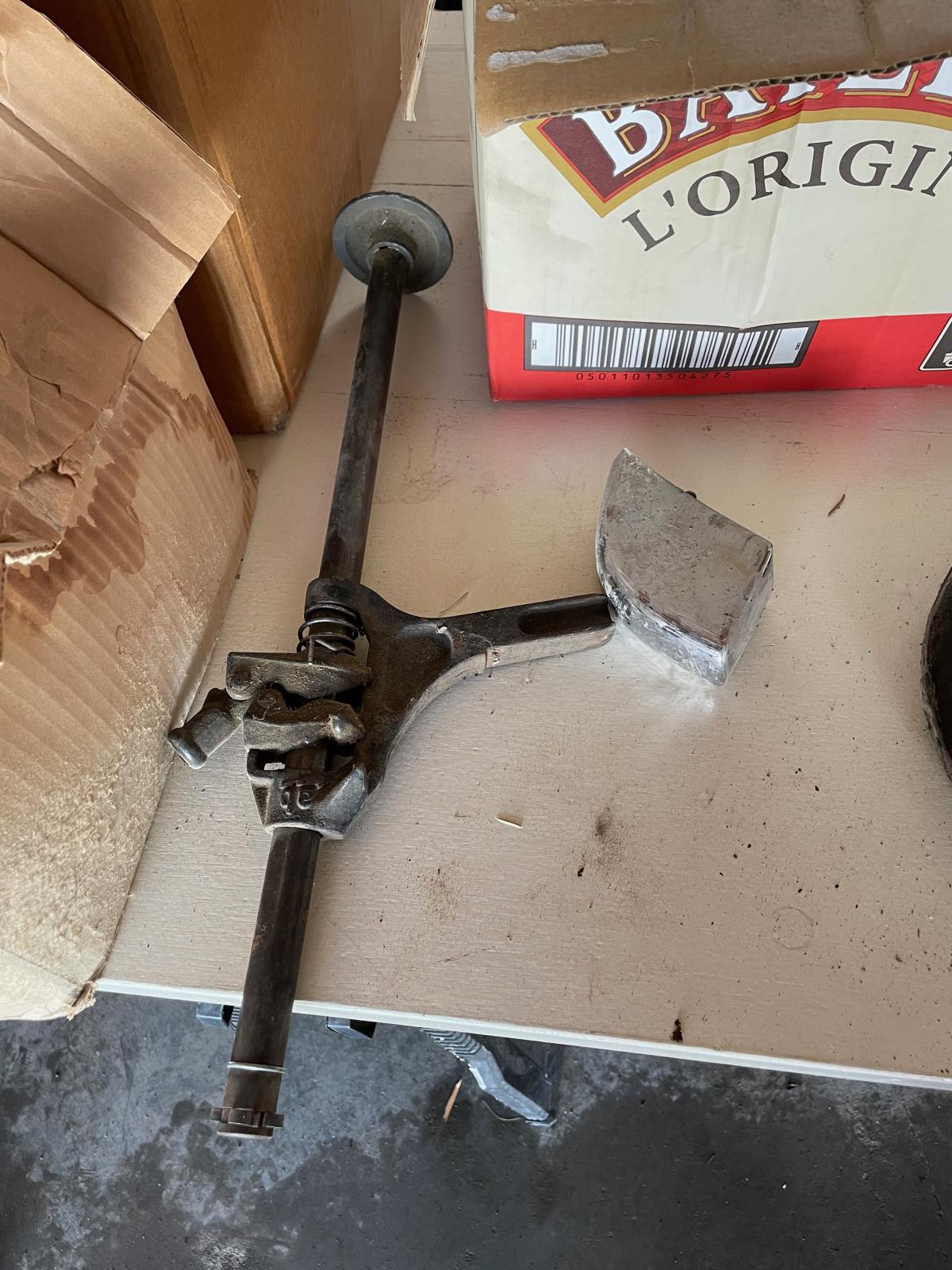

Jack is correct for 356, the rubber top is available.
Seats are all there, you would recover them anyway, note the previously mentioned rear side panels for use with the hardtop.

Typical under hood look, steering box covers are easy to find.
Just surface rust, probably not anything to worry about.
Replace the coupler asap!
Fuse box looks great.

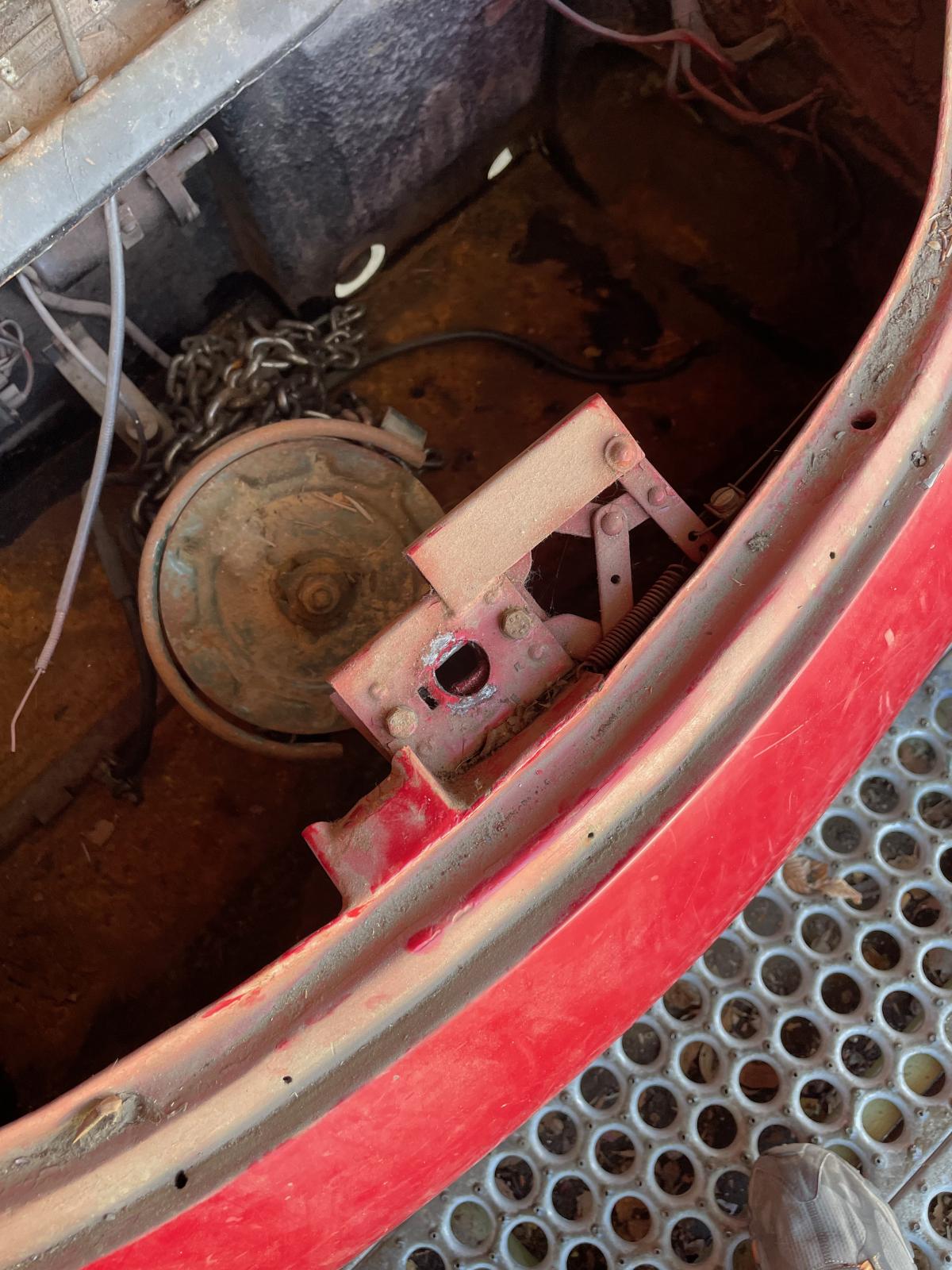

That's the correct T6 B latch.
I hope you can find the upper latch, they are expensive.

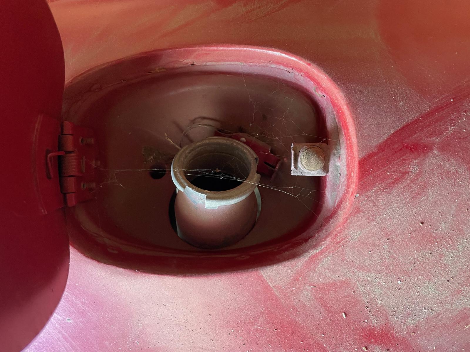

There is a rubber collar in a previous image that goes around the fuel filler neck here.

There is nothing here that would scare me at all and there are enough parts here that finding what is missing will not be daunting. Can you post a good picture of the underside? If that is good I say do it!!

In the left front wheel well it looks like a bracket has been riveted on, and there are a number of patches that look riveted on in other places. I'm guessing that didn't come from the factory?

I think the wall outlet had something to do with an interior heater. Wires hanging from the dash were probably for the same thing.
The upper hood latch is there. We removed it so the hood doesn't latch and lock again.

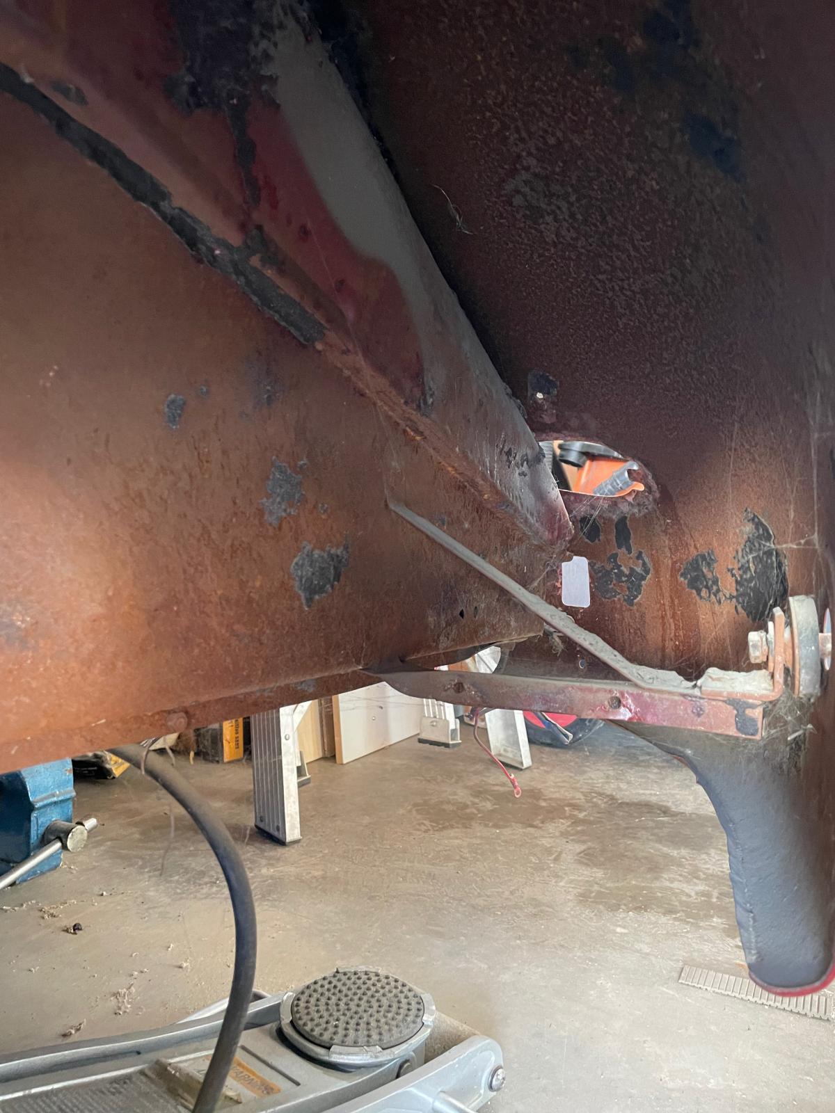

I have a couple of pics here of the underside. Looks like section of the floor pan was cut out and riveted in. I would plan on redoing this kind of stuff properly.

Thanks Sebastian for the thorough response! A few things:
In the left front wheel well it looks like a bracket has been riveted on, and there are a number of patches that look riveted on in other places. I'm guessing that didn't come from the factory? Correct, they did not come that way but that is nothing that cannot be easily overcome. The biggest worry would be perforated rust which after all these years you don't have.
I did find the original ignition key. Does that operate the shift lock? It does not. The shift lock key has a large keyhead that is a rounded triangular or diamond shape.
How about the missing hinge covers, especially the driver's side one with the data tags? How much does that detract from the value/originality? Can they be found/reproduced? The hinge covers are available as well as the data tags, don't worry about those at all because they are not an official tag for registration or titling.
I have a couple of pics here of the underside. Looks like section of the floor pan was cut out and riveted in. I would plan on redoing this kind of stuff properly. Again, since there is no perforation after all these years, the surprises under all of that are likely minimal, of course you never know but this is a good sign.

@AB westy nut
Here are some photos of my car for motivation, this is what you will have when done. I just took it apart this weekend to do a deep clean, detail and paint correction. I finished the restoration 16 years and 60,000 miles ago so it's time. I will have it back together by May 1st for the driving season, you are more than welcome to come to my shop in Ann Arbor and take it for a drive.

Thanks for sharing! What a beauty and definitely an inspiration to work towards. I noticed yours doesn't have the side mirrors either. Were they optional? That, and the little red reflectors above the tail lights. I've seen some T6's with them and some without. What's the rationale there?
I'm going to start the negotiations to see if I can pick it up. Stay tuned...

I believe US cars had the little red reflectors above the taillights. Others like Germany delivered cars had them below the bumpers. I’ve seen both and the restored one shown has them above.

My car does have a driver's side mirror, if you zoom in on the image from last summer you can see it, but it does not have a passenger side mirror. Those were not required until later.
As already stated, US delivery cars had the reflectors above the bumper and ROW (Rest Of the World) cars had them below the bumper.
