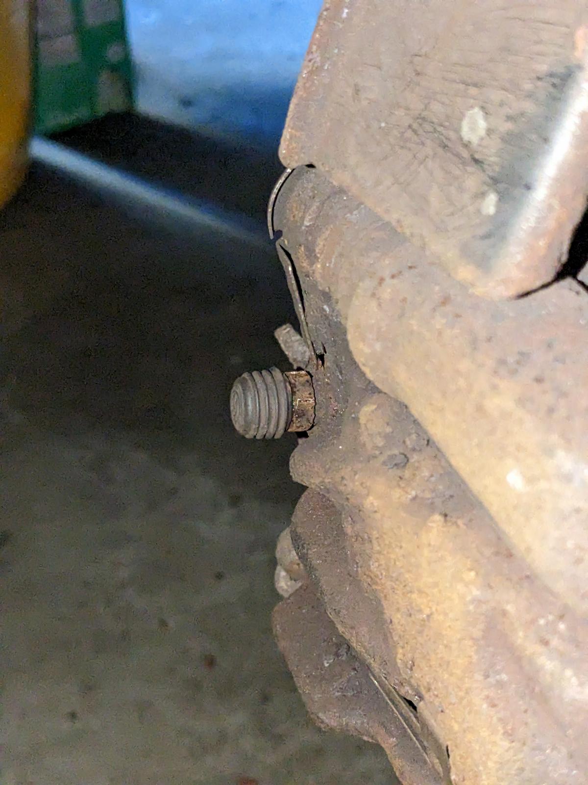

Based on the service records and appearance of the fluid, the Eurovan I purchased is at least a few years overdue for a fluid change.
Using a power bleeder (they work really well!) and the bleeders were very crusty and stuck. I successfully broke-loose three of them with some penetrating oil and hammer taps on the screw and caliper. However, the left-rear is really stuck.
I'm using an 11mm flare wrench and have unfortunately already somewhat rounded the nut with it. Trying to be patient with more time for the penetrating oil and some add'l taps. Will hopefully loosen this bleeder as well, but the bleeder screw nut will be in bad shape.
In searching for new bleeder screw replacements, I see several auto parts sites showing different manufacturer part numbers and sizes. Mine all have an 11mm nut. Can someone confirm the correct size and/or (even better) replacement part numbers?
Also -- any advice for how I can more effectively loosen my 4th bleeder screw without breaking it is appreciated...
Have you tried using a socket instead of a wrench/flaired wrench on the bleeder to try and loosen it? Using a socket set up can make it easier to tap on the handle to see if repeated shocks will get the bleeder turning. Make sure the socket is on there square and not angled as that can easily shear off a stubborn bleeder, the same with using excessive (gorilla-like) force on it. Also, have you applied any heat to the bleeder thread area?
Another approach you might want to try is using an 7/16 socket as those are pretty much the same width as an 11mm.

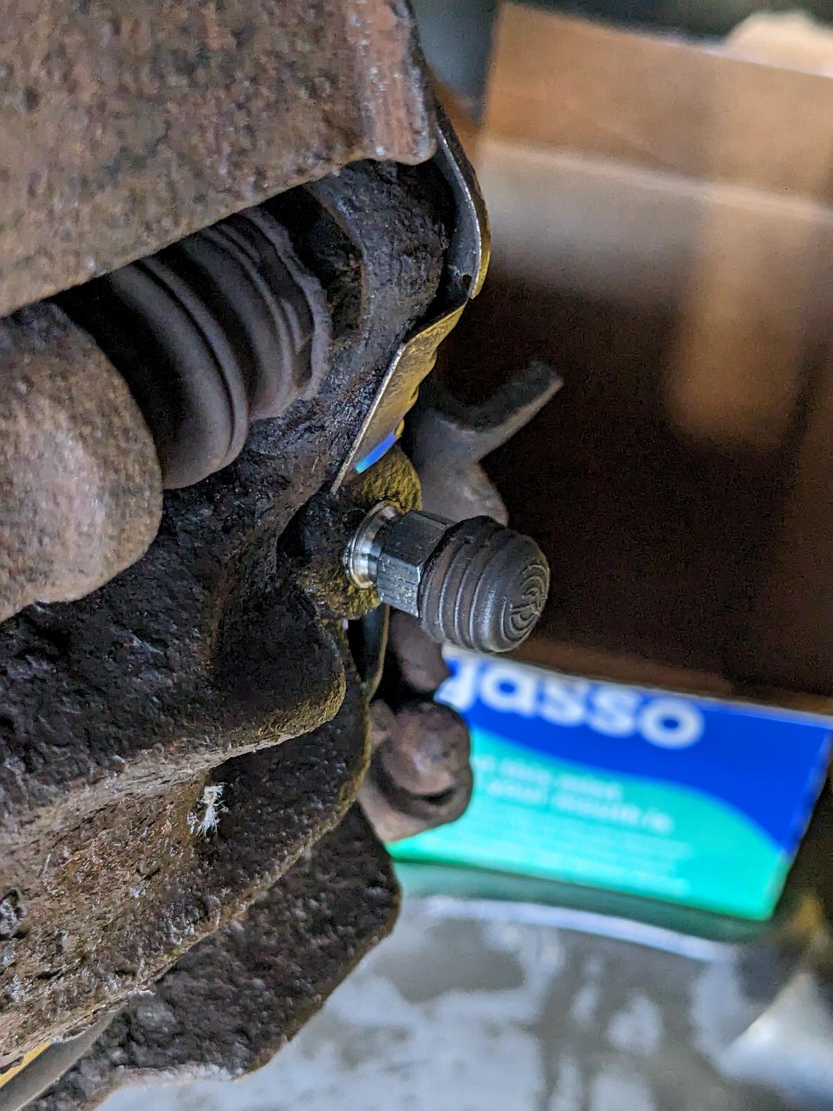

This is not the bleeder screw you're looking for.
Even though it shows up on rockauto, O'Reilly's, amazon, and several other sites as "the screw" compatible with late model T4 rear calipers. Too long and skinny.
It's an H9413 available under several different brands and different suppliers.
If anyone has a correct part number from a reputable supplier please share. I think I can extract the old screw but it's in poor condition.

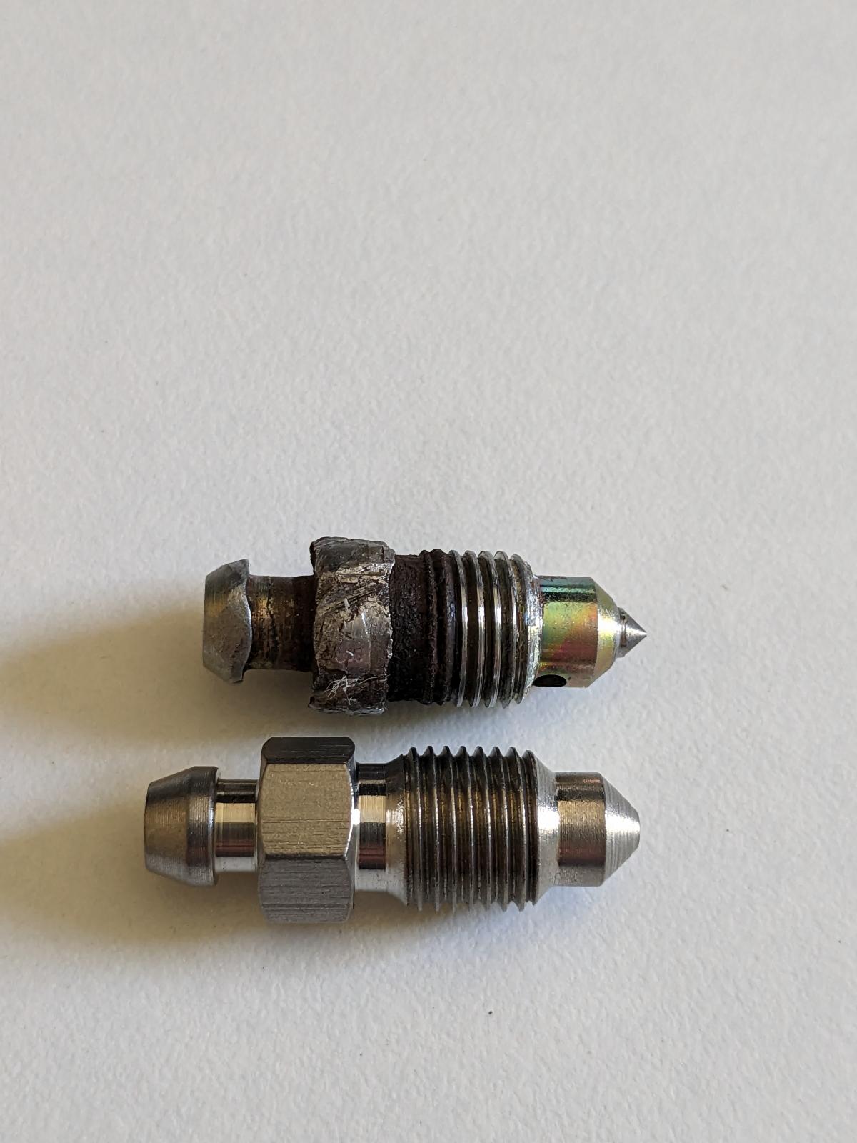

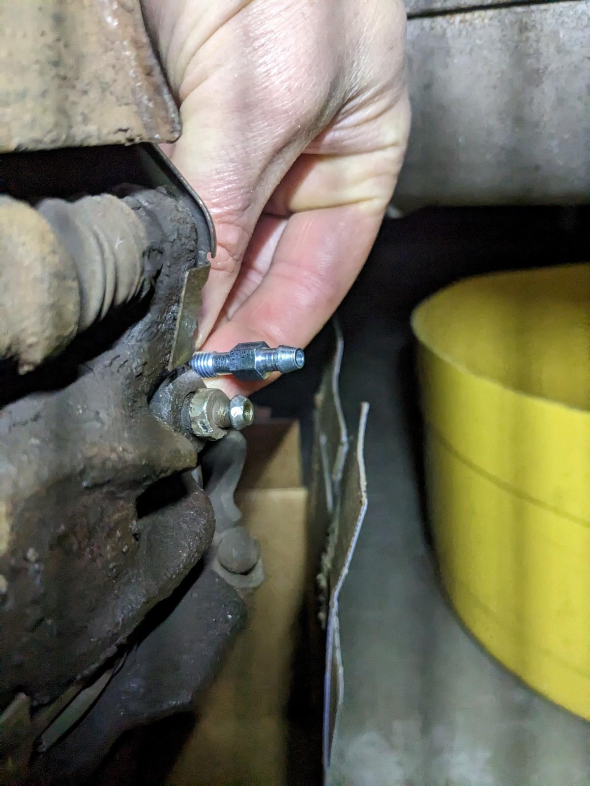

PostPosted: Fri Mar 31, 2023 2:08 pm    Post subject: Re: Bleeder screw size? Reply with quote
MYSTERY SOLVED.....
Using the Dorman accessory kit, the M10 x 1.0 threaded bleeder screw fits and is workable, but it's over 5mm longer than the OEM screw. It opens and seals the bleeder opening and seems to work fine -- but I'd prefer a screw that doesn't stick-out so far.
The Dorman screw is spec'd at 35mm from tip to tail. My measurements suggest it's closer to 34mm.
The 10mm OEM screw measures 28mm from tip to tail. I searched online and found a lot of 35mm+ length screws. A few more at 30mm.
This one is just over 29mm and it available and economical. It's also stainless (some are steel or aluminum but ours seem to be steel) -- I'm going to use it... https://www.amazon.com/4LIFETIMELINES-Stainless-Bleeder-M10x1-0-Millimeter/dp/B08Q68H6HH
This one also looks good. Says 30mm but has a pointy tip like the original and an 11mm nut on the end. Ships from Latvia and I don't want to wait a month for it but worth considering if you need one and can wait: https://www.ebay.com/itm/303739137740

PostPosted: Mon Apr 10, 2023 3:26 pm    Post subject: Re: Bleeder screw size? Reply with quote
The amazon bleeder screws arrived today. They're not perfect -- slightly taller and have 10mm instead of 11mm head. But the fit is acceptable. See comparison to mangled original below and the new screw (driver side) compared to the original style (passenger side)

That looks like that will work!

PostPosted: Wed Apr 12, 2023 2:42 pm    Post subject: Re: Bleeder screw size? Reply with quote
A taller one is better than one that is too short. Now you can move on.
