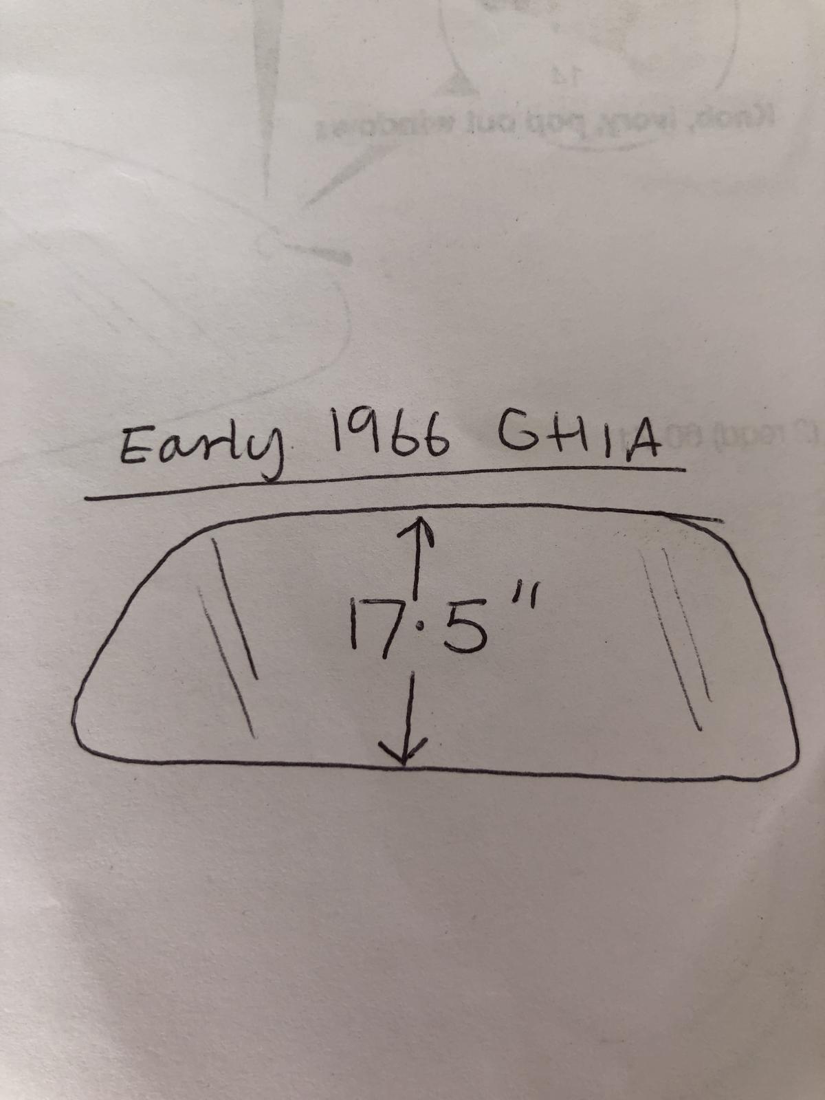

Hi guys , I wonder if you can help me with something?
I need a new windshield trim for my 1966 KG.
The problem is the windshield is 17.5 deep and takes the C-channel moulding.
From what I can see on the internet, nobody is making it, only the T-profile channel which is for a 17 deep windshield.😞
Does anyone gave a contact for C-channel trim or have any suggestions as to how I can insert new trim ?
Thanks
RT

The C-channel trim molding is not reproduced by anyone. The only option you have if you definitely want to use it and it wasn't on your car, is to find it for sale in the classifieds like I did. I'm also restoring an early 66, before the trim change that came halfway through that year.
The only way to use the later T-trim is to buy the later, smaller windshield. The opening for the windshield stayed the same, it was only the windshield that changed size to accommodate the different trim style. You can't use the T-trim with the early, larger windshield. It won't fit.

Thanks Era, so If I understand you correctly , if I buy a 17 windshield and use T-seals and T-profile trim all of them should fit properly inside my early 66 Ghia windshield frame ?
Also could the rear window use either C or T profile trims and seals because the glass size DID NOT change from 66 to 67?
Confusing stuff, but great to have people like yourself sharing your knowledge on The Samba!
That is correct.
However, it would be less expensive to simply seek out the pieces from the classifieds, and you would keep your original VW-branded windshield. There's several sellers with some of the C-trim pieces for sale right now. But I guess it depends how much of a hurry you're in, if you're willing to wait for all the pieces to pop up for sale.
That is correct.

New windshields are expensive and the commonly found Fuyao ones fit like garbage, they are too small (16 7/8 vs 17). Plus you have to buy the trim, all of which is going to cost together over $400!
West Coast Metric, KGPR, and EVWParts all sell early windshields that are 17.25" and I actually did buy one of these for my car. The height, width, and corner radius dimensions were spot on to the original. The problem was it was only 3/16" thick, whereas the OEM is 1/4". 1/16" thinner doesn't sound like much, but when fit into the seal designed for a 1/4" thick piece of glass, the fit wasn't snug enough that I trusted it to keep out water. I decided not to use it. I'll run my OEM windshield with the slight delamination until I can find a clean OEM to replace it.
So that's another aspect to watch out for that NO ONE in any thread mentioned, was the glass thickness.
Also, $400 buys you just the windshield with shipping due to the extra special packaging that all the sellers charge for the glass. Add the VEWIB (German seal) at ~ $125 and new trim at ~$150 and you're looking at close to $700 to replace the whole enchilada.

So glad I found out about thickness when looking into new windshields.
I also made enquires in Australia and found a supplier that has glass that is 17.3" deep which may or may not be too deep, but it has ....a green tint to it, so that is another curve ball to consider?
Your idea of Re-chroming might be worth considering? I thought it was Anodized Aluminium but if it is brass it might be possible
