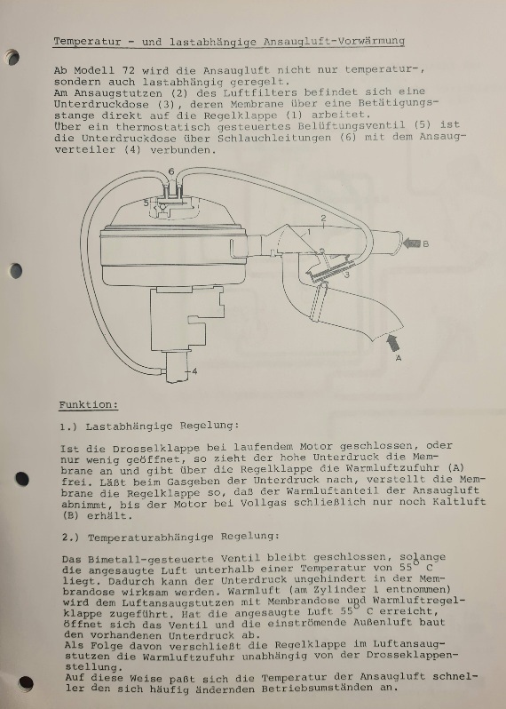

Yes I also thought so at first...but looking at two of my other Bosch multi point injected cars (Golf 2003 1.4 16v and Passat 1995 2.0) they both have warm air arrangement very much the same as the 1972 411.
As a side note only, this is how the new air cleaner was explained when introduced for the -72 model:

I would bet that its there to help out the TS-1 air intake sensor which enriches....you know...I'm not sure whether it gets richer as the air gets colder or warmer. Have to check on that.
But the early injection systems were barely under their own control at cold weather warmup situations. The AAR (air bypass) was crudely controlled. The cold start valve was decently controlled as per when it turned on but not per how much fuel it injected. The TS-2 (cylinder head sensor) drops in ~ 10-15% enrichment in cold weather......so as I found many years ago, unless you are in a perfect state of tune...sometimes you ran pretty rich for a while until fully warmed up. Ray
