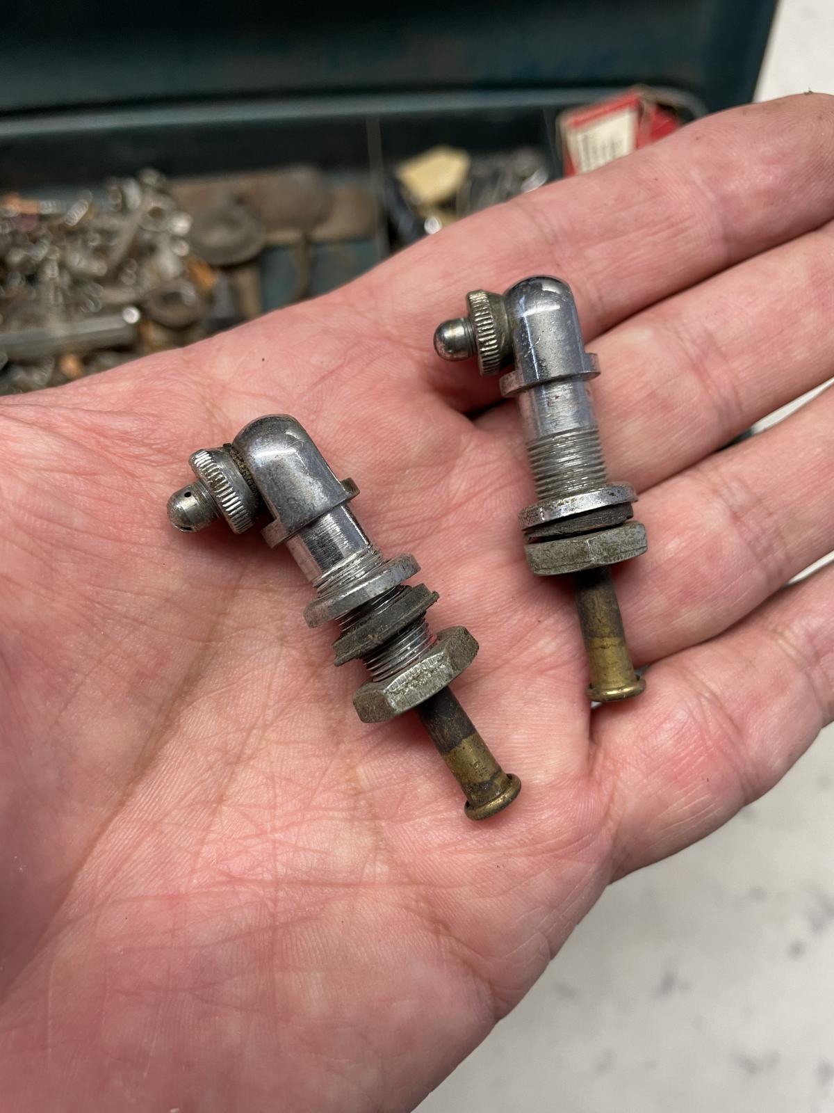

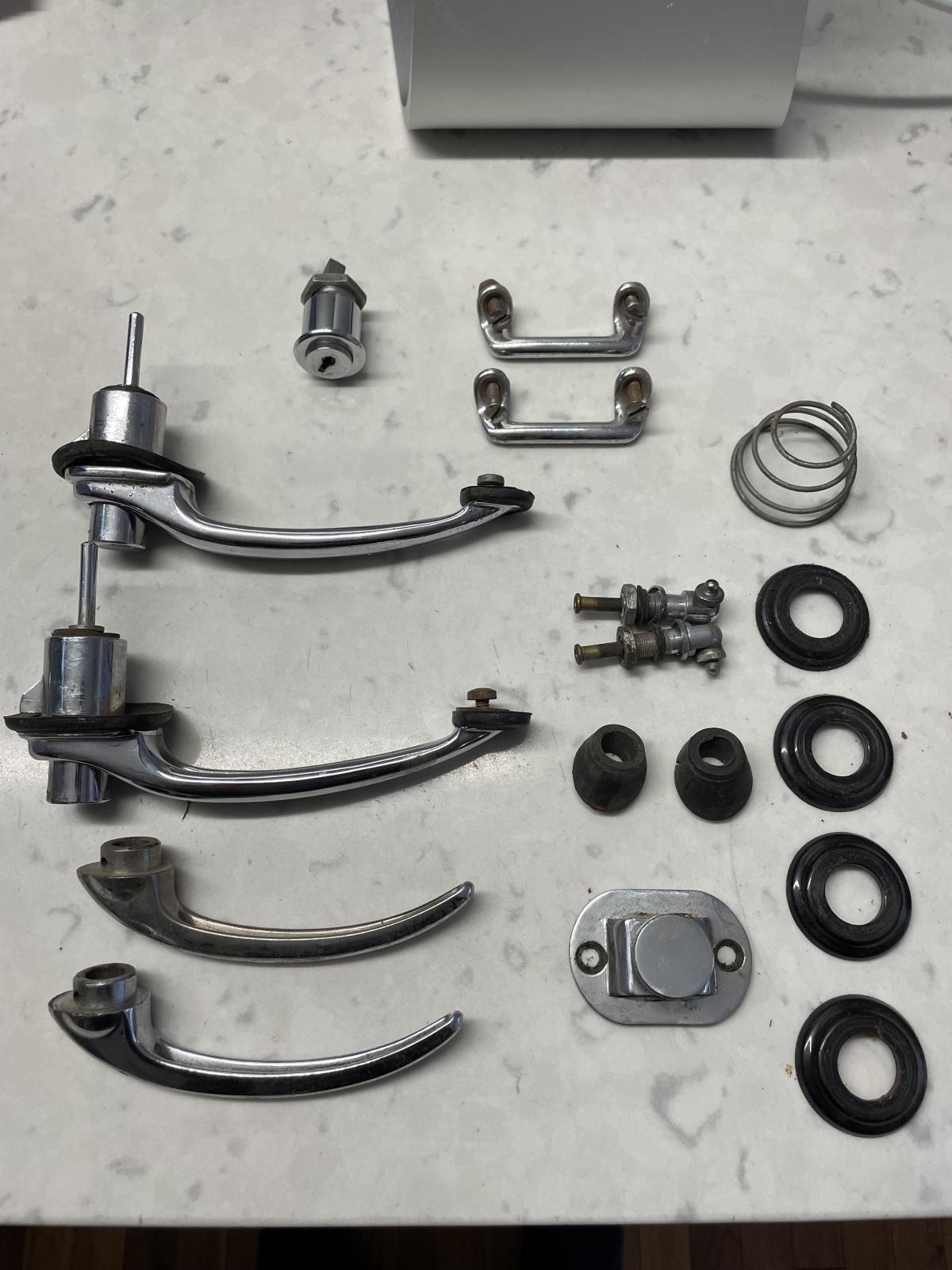

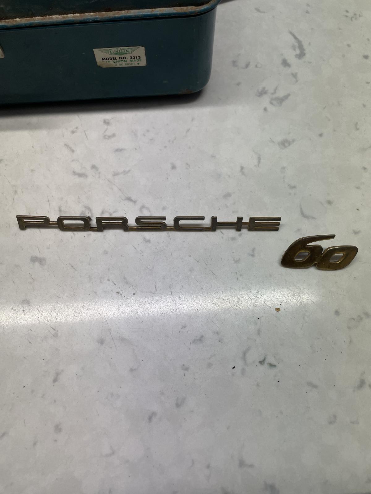

Going through another little box of parts that came with the car, I found some more good stuff and also some unknown little bits. The exterior door handles (still work with the original ignition key Cool ) and interior door handles, what looks like the glove box lock (no key Crying or Very sad ), some other unidentified chrome bits and black plastic trim rings, and the PORSCHE script, which I'm presuming is for the rear. There was also a "60" script - was that factory on a '63? I thought I read somewhere that that had been phased out at some point.

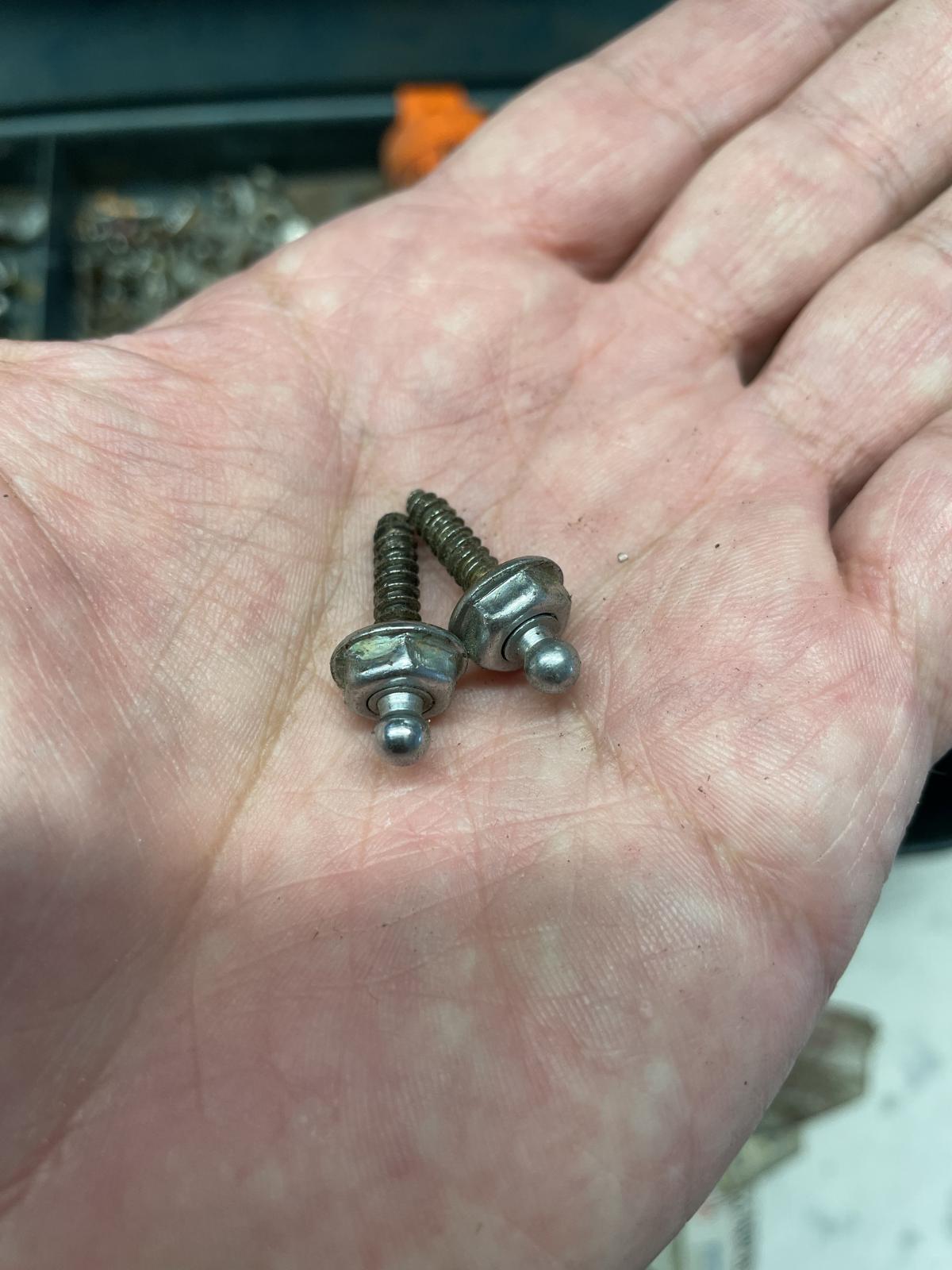

There were also about a dozen of these little screws with a ball end. Anyone know what they're for?

Picture #1
top middle luggage strap brackets for the back seat
below those are the windshield washer squirters
below those are the wiper arm bases over the pivots
below those is a headrest bracket for the rear of the seat, two are needed per seat
top right window winder spring
below that are the window winder and interior door handle escutcheons
Picture #2
Yes, rear scripts. You car is a 60 "normal" or Damen and they were very much available in '63. Not to worry, they are great engines with lots of low end and are great in town drivers.
Picture #3
Those are the male end of the Tenax fasteners for your top boot around the rear cowl.
Picture #4 washer squirters

No worries, correct glovebox lock key blanks are available and a good locksmith can get you hooked up.
