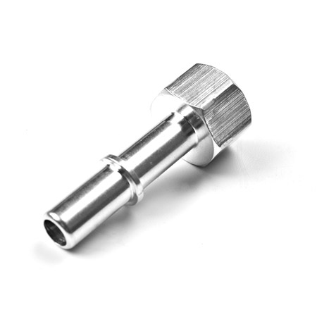

The brass inlet fitting that screws into the pump will not work with any female quick connect 5/16" hose fitting that I can find. I contacted the seller but they are no help.

Sodo wrote:
Donnie strickland wrote:
This is what I used, except it was brass; it came with the pump:
I cut off the tip, so that the ring was left at the very tip of the barb. Been on there two years this November, with no problems.
FYI.... this Bundy connector ($6.99)
......clips onto that brass fitting that you cut. Just FYI.
Fuel Line Quick Connector Ford 5/16" Barb to 5/16" Bundy Female
by Dynapex
Link: http://a.co/d/bTmGS2Y
Sodo, Did the pump inlet fitting click into this Bundy connector like they were meant to? Is it still working without leaks?
Thanks, Ventura Richard

Success. I installed a replacement fuel pump in my '71 FI T3 Automatic! It took 10 cycles of the on switch to get pressure to build to 5 psi in the drained lines. That was enough pressure to get it to start. No leaks and it holds 26psi, right where I had it set before. I had to modify a quick connect nylon clip to get the inlet fitting to push in far enough so it would click and hold. I am so happy and feel a great sense of accomplishment.
