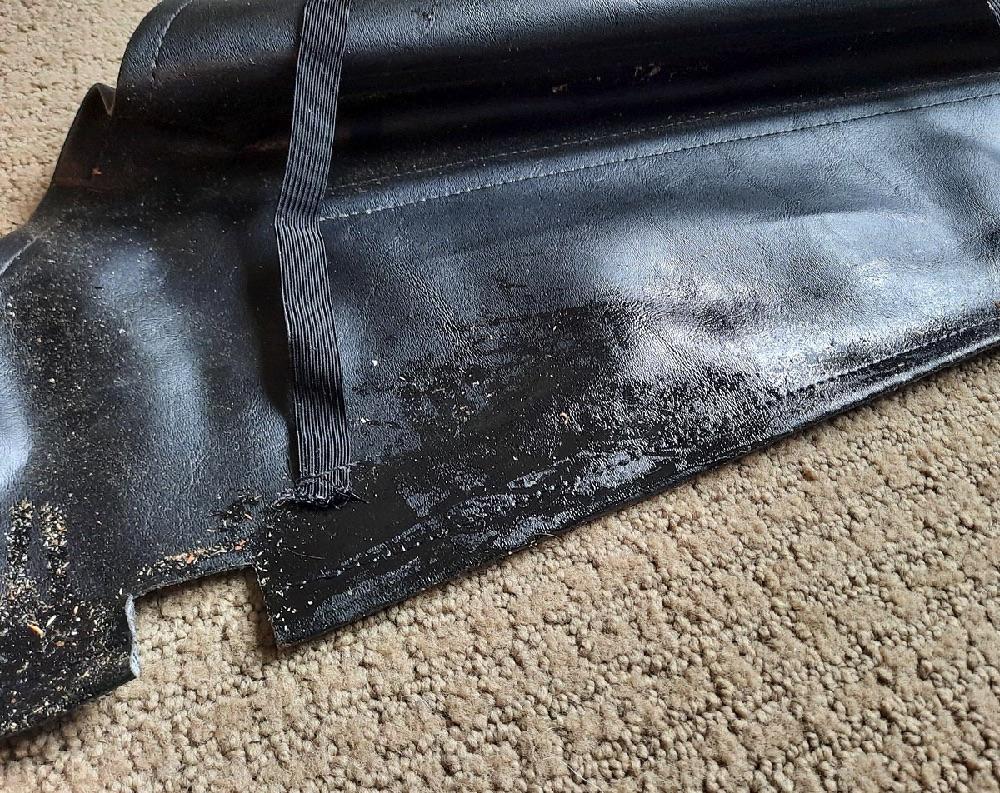

It seemed like the adhesive just wore out. At the time, I tried pushing the protector back on, but it wouldn't stick. When I took the protector out, there was sticky residue on the top and bottom of the protector where it attached to the top and bottom hinge mounts. It's still sticky today.

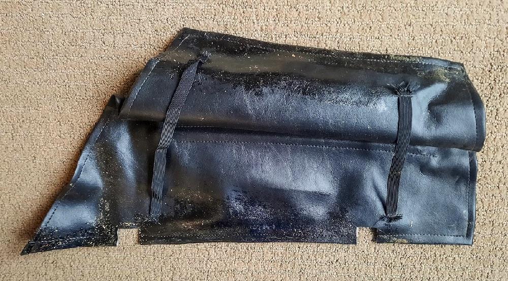

The protector I need to reattach:
I'm looking for recommendations for how to reattach the protector. I want it to really stick and not fall off again.
* Do you know how they were originally attached?
* What liquid or tape adhesives would work well to attach the vinyl to metal?
* What methods would you suggest for fixing this?
Note: When the pop top is open, the two elastic straps on the protector pull tight so there's tension where the protector is mounted to the hinge brackets. The adhesive needs to be strong enough to handle that.
