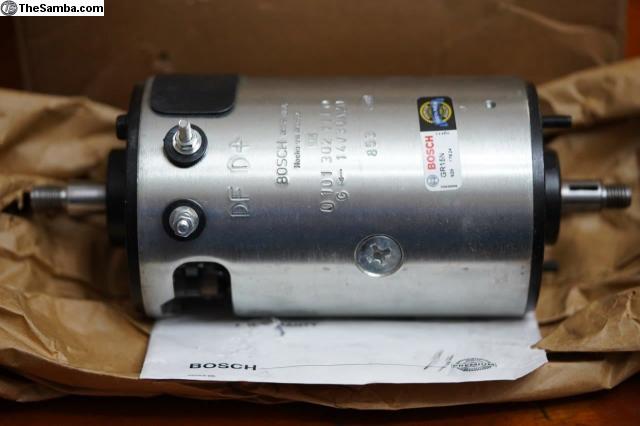

Amazon sells Bosch 12v 0101302111 compatible? Generators. The armature on my old Bosch is toast — it’s arching. Would love to hear some opinions on the new Bosch 12v generators.

I found a new/ rebuilt generator at NAPA — an exact replacement.
Installed it but the red light stayed on. Took the generator to a respected shop — his testing led him to say it should work. Reinstalled it but the red light is still as bright as ever.

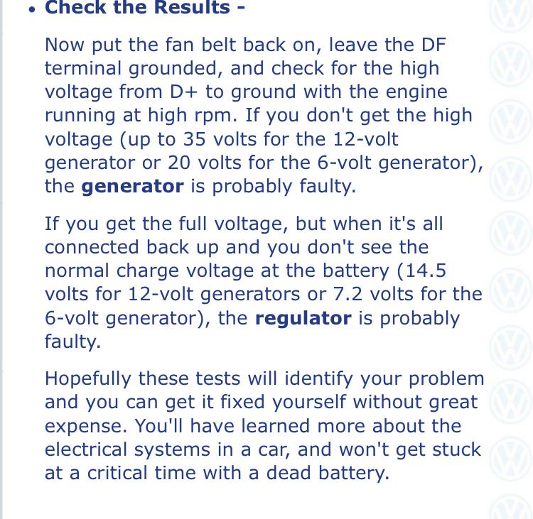

I hooked a wire between the DF contact and the generator ground screw, started the car, then hooked my battery voltage tester leads to the D+ and the generator ground screw. The voltage needle didn’t budge. No voltage at all.

You need to first polarize the genereTor. Please look up that procedure. Easy.
https://www.thesamba.com/vw/forum/viewtopic.php?t=337164&highlight=polarize+gen

Thanks bnam.
Got generator to spin as described in your attachment and retested for output. It’s putting out some pretty good voltage and I’m convinced it’s working fine. Will go to next step and check regulator. Thanks!

Did some more testing later. Voltage across the battery was 12.3 before cranking. At idle it was 12.1. Never got over 12.2 when racing the engine. A post that I saw suggested testing for system voltage but did not tell how. Prior testing showed that the generator is capable of producing 35 volts plus (unregulated) so I think it’s working fine.

PostPosted: Sat Apr 01, 2023 11:31 am    Post subject: Re: 12 volt generator Bosch Reply with quote
Per instructions below, I tested the “new” generator installed and it more than exceeded the 35 volt requirement when I raced the engine.

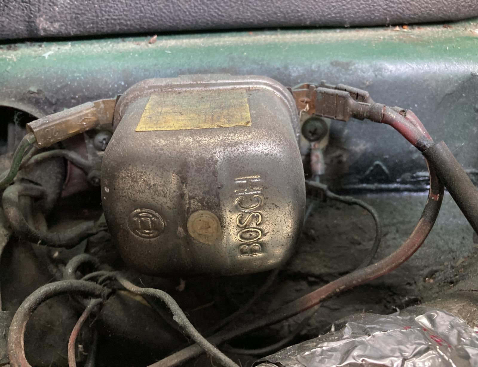

See photo of old voltage regulator. The information above suggests it’s probably no longer working. The red light continues. Thanks all.

Happy ending (maybe). Hate just throwing parts at a problem and I noticed that my battery cables fit loosely over the posts but were not tight. I tightened them with the result that the red light went out and the battery is being charged when the car is running.
The old generator was arching but it appears the old regulator is working fine. Thanks for the info you provided — it helped a lot!
