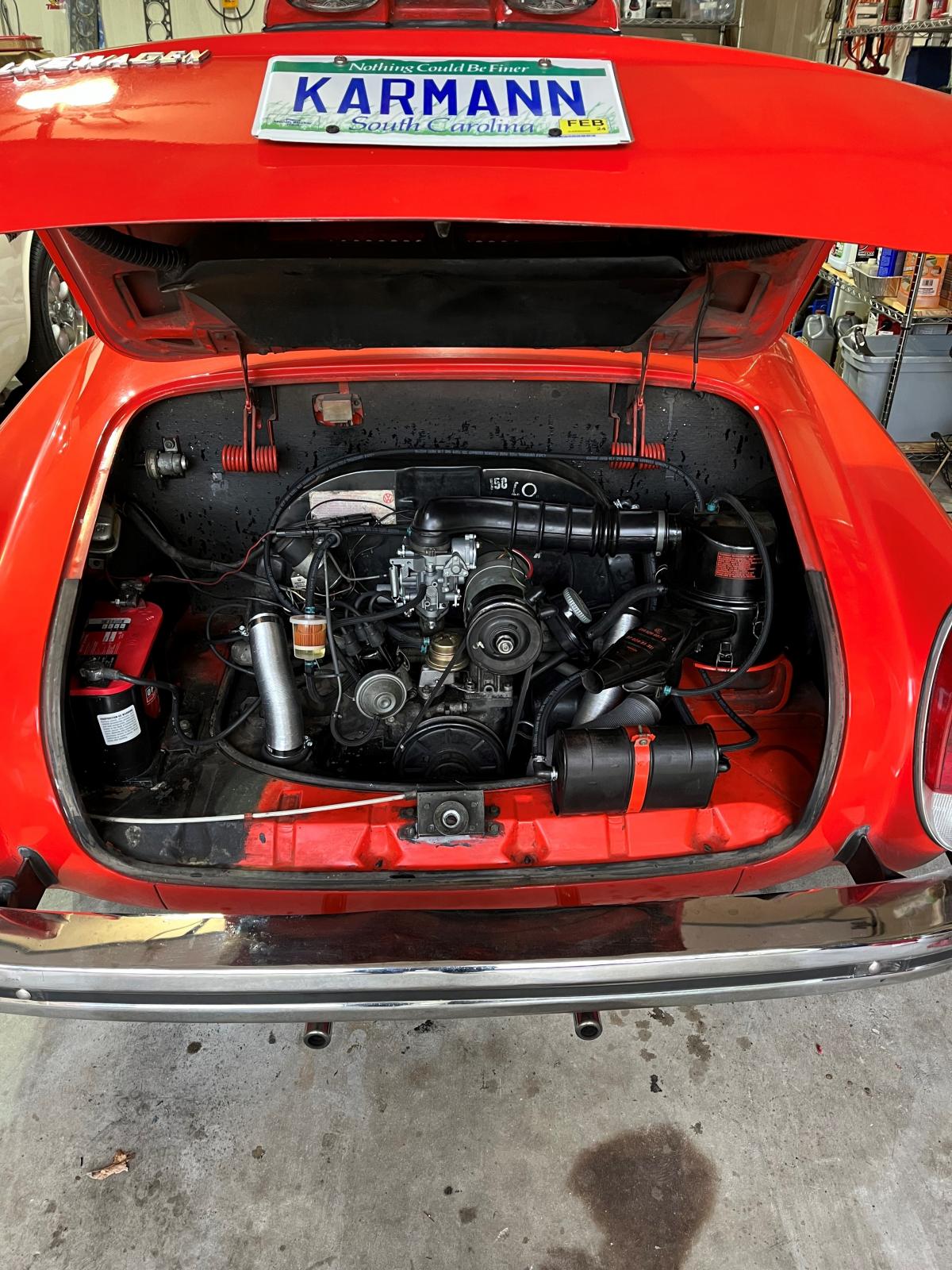

Help! Smile I'm having trouble with starting the '72 Ghia when hot. I have to turn the key and floor the accelerator, and it takes 5-7 seconds to fire off.
When I received the car about 6 weeks ago it was down on power, difficult to start when hot, and had flat spots in acceleration. So I adjusted valve clearance, ignition gap, and timing. Power and flat spots improved noticeably, but it still wasn't quite right and continued to be difficult to start when hot. Next I installed a rebuilt German 34PICT-3 Solex from Volkzbitz, which was a huge improvement and eliminated all issues - except for the problem with hot starting.
I've also adjusted the electric choke. Per the instructions, it's closed when the engine is cold and gradually opens as the engine warms up. So I've confirmed that is working properly, and it fires right off when cold. Is there another adjustment to the choke for warm/hot starting? Interested in feedback on hot starting issues.
P.S. - Yes, I know - Relocate that fuel filter! It's going to happen, I just haven't gotten around to it. I've replaced all the fuel lines with new braided hose and I've also used clamps. The plastic temporary filter has hose barbs as well. I'm not sure why all the vendors sell those filters that are flat and have no barbs. Anyway, I have a metal fuel filter I plan to install in the fuel line under the car.
