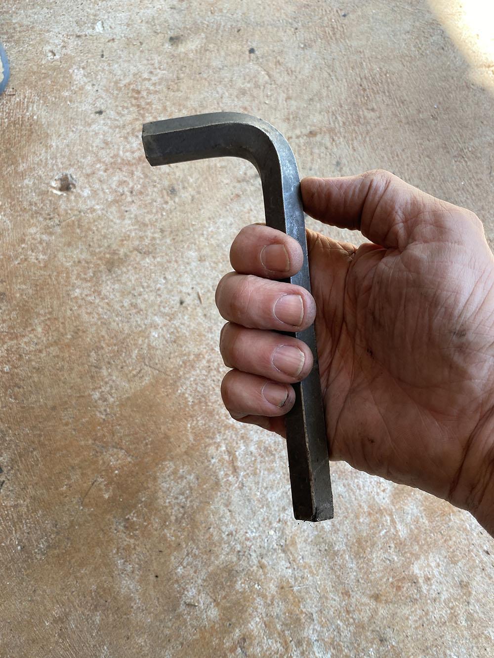

I'm going to change the transmission 90 fluid. I can't believe I still have this tool from my old bus days. But it's tight around there and hard to get a good angle to turn with force. Got a small bit of loosening with a 3 ft helper pipe out the engine compartment but may need to cut a 1 ft. pipe to go further. A big hex head driver on a flexible head would come in handy.
I can see why people always say to first check that you can open that before you drain out your fluid.
I picked up a 17mm Drain Plug Socket. Most VW parts Suppliers have them for around $6.
I have BOTH tools. But I find I use the big old-fashioned L-shaped 17mm allen wrench much more often.
For fill plug: stick the LONG end of the allen wrench into the fill plug. Then use your 17mm combination wrench for leverage, about 1 inch from the transmission. Hold the allen wrench parallel to the fill plug with your other hand.

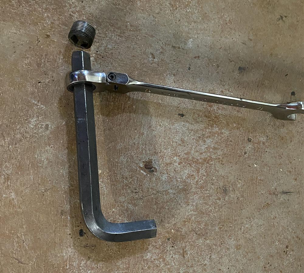

Put the box end of the wrench on the Allen wrench, you will need all the bite you can get and the open end will just slip. Plus you will have the open end available to use for the "mechanics extension". A second big wrench with the box end over the open end of the one on the Allen.
I can see Cusser smiling now, been there done that. Hey Cusser, ever used TWO helpers in a row?
MG, You can use one helper but I strongly suggest you don't try two in a row. It can be done but it is really sketchy and usually ends up with wrenches flying and a lot of four letter words used. It is something us pro mechanics tell you not do but then we do it anyway because we are in a hurry and to tired or lazy to go to the tool box for the right tool when you have a ton of wrenches right there next to you.

The 17mm allen wrench and the box end of the combination wrench was all I ever needed. Remember though that I'm in Arizona, if that matters.

Well that's why this forum is valuable beyond the service manual. The manual will say remove a bolt but doesn't give tips on how. Have to rely on you guys who have already busted your knuckles figuring this stuff out.
I put the box end of a wrench on the big hex wrench just as recommended. Took a strong two hand pull but out it came. The fluid didn't look too bad but might as well be getting a fresh start when I don't know the car's history.

Great idea there - I do have a 17mm gear box wrench, will try to remember that for next time. Mine's not a swivel head one though.
I don't think the swivel head was required, pulling pretty much straight

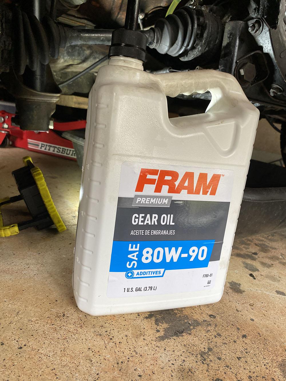

Is this fluid ok for the transmission? (he asked as he pumped it in)

That will work fine. As long as it does not say it is GL-5. Even GL-5 is supposed to bee ok if it contains the mt-1 additives but I prefer to stay at the GL-4 or lower grades to be sure I don't have issues with the oil attacking the syncros.
Looking at that again I do not see the oil institute certification star on there, is it on the back? You definitely want to use a brand name oil that is certified.
https://motoroilmatters.org/protect-your-car/learn-about-standards

i’ll take a look later at label. after pouring the old oil from pan to jug it did have a fair amount of gunk left in the pan bottom. not metal but clumps of gunk. the drain plug has a magnet and there was just a few small metal grains stuck there. comparing the clarity to new oil, it looks pretty dark so i guess it was time to replace.

Oil looks fine, there was so many different types of gearbox and transmission oils from the expensive brand names that I sort of gave up and chose a cheaper Gulf brand that's clearly stated what it was doing on the box. (I'm not kidding, Castrol has like 10 different gbox/transmission/axle oils all slightly differently marketed)
I had an old bottle with a tube coming out the lid that I'd used previously, but for some reason this time it was such a pain in the ass I also bought the pumper that I see you have in your oil container. Haven't used it yet though, how did it work for you?

The problem with using oils without the API seal is you do not know what is in them, or not in them. As oils are upgraded older oils are dropped from the list and it is these oils that the refineries then sell to the cheapy stores, minus a lot of the additives they used to have in them to save on the cost. So the oil that you bought ten years ago that was certified is now no longer certified and you figure that it is the same oil and MUCH cheaper. Well, if it sounds to good to be true it usually is. It is cheaper because they no longer put the additives in it and since it is not tested anymore nobody knows any better.
I use Tractor Supply 90 weight in my tractor but I certainly would not use it in something I depend on going 60 MPH down the road.
High pressure and anti shear additives don't matter in slow speed applications but in a vehicle on the road they certainly do matter.

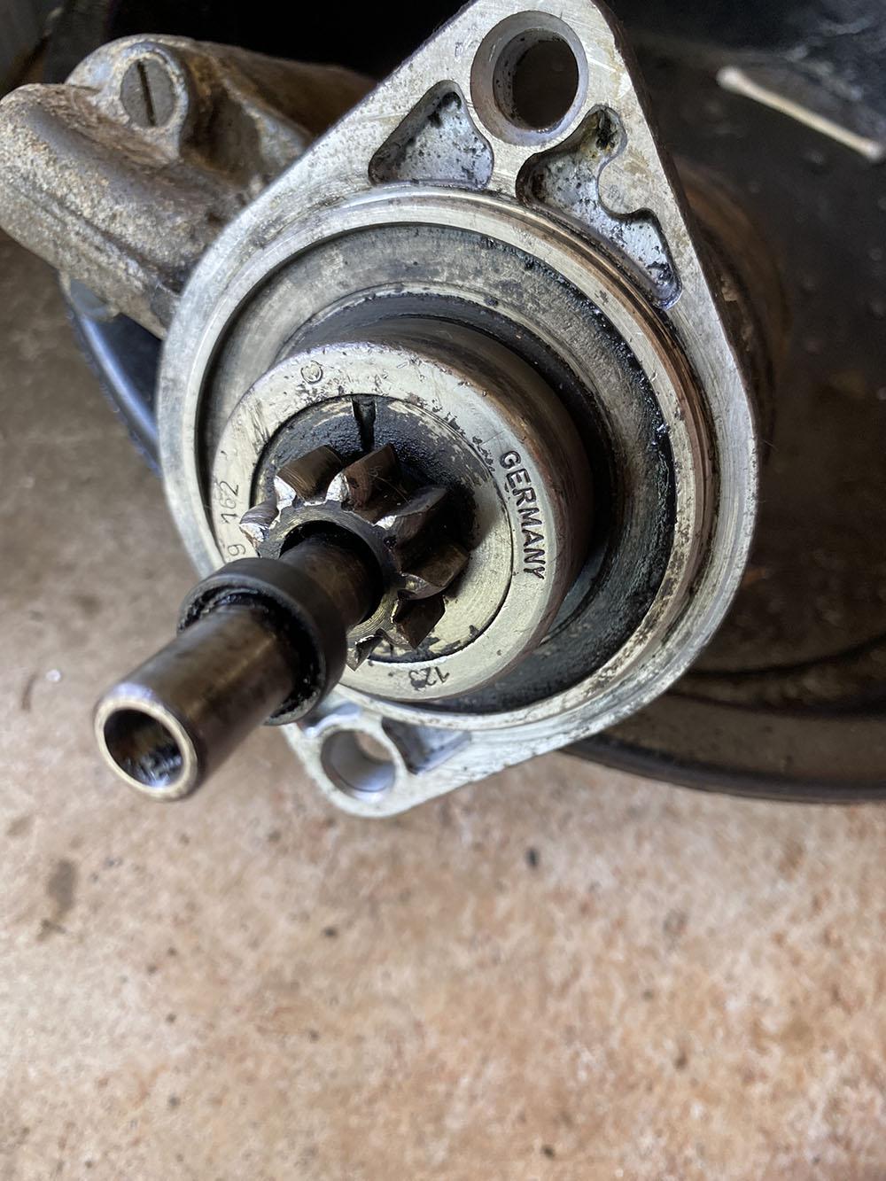

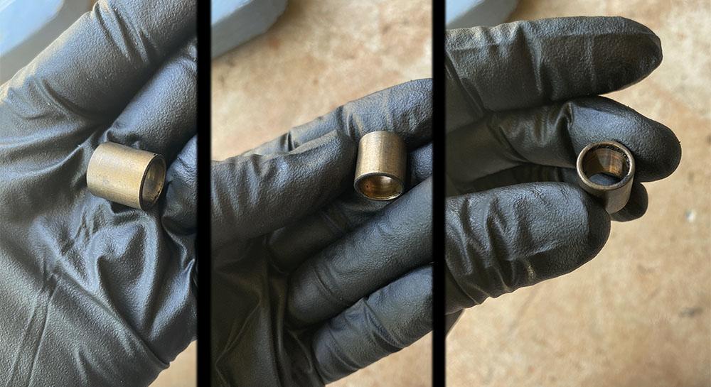

Pulled the starter to replace the bushing. But bushing looks very good so may put it back in. Interesting to see original starter still cranking away. Took a shot of bushing before I pulled it to see how far it sits in the hole, engine side (5mm).

Visually the bushing looks fine. Put it on the starter shaft, and just make sure it's not loosy-goosy. It was probably replaced at some point.
