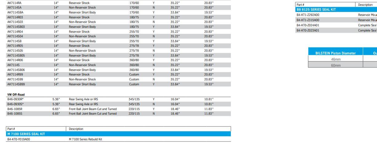

Don't bother with the more expensive kit Your paying 154$ for two KYB 40$ shocks the whole (Valved correctly) is a load of bull.
The 644$ kit is a solid buy. I would do that plus do the bottom shock mount Mod you gain clearance then you can measure for a real shocks like Bilstein's.
I've run every stock rear shock rock auto sells and can say KYBs are good for the Budget minded but would not pay a penny over 40$. Now the Bilstein's are pure heaven ill never go back. I would look up the class 11 valving and get that in the correct length you end up needing.

Bilstein VW shocks at the bottom and yes not sure about the 10.5 travel seems a little Liar Those KYB shocks in the kit are soft you will bottom out the first woop and 100% guarantee they will leak after one season if not by the end of the day. The KYB gas adjust mono tubes are better will last two seasons and you can hit woops in second gear. Bilstein's well you get it...
