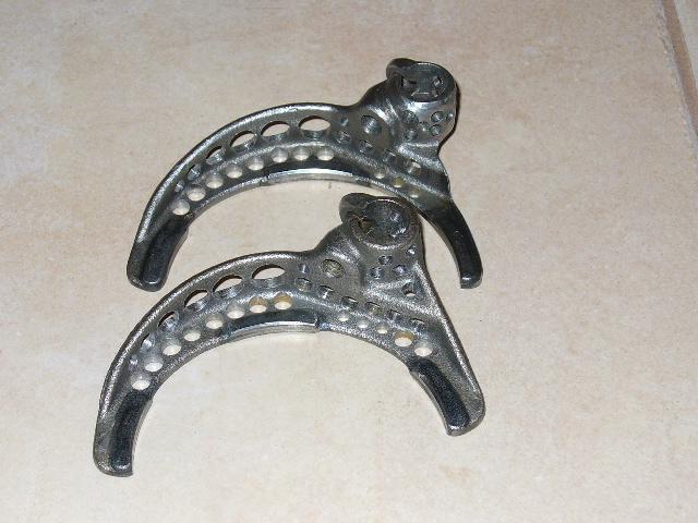

Carbide bits will drill holes in hardened trans parts. Be aware that they aren't cheap, and are somewhat fragile.
A lot of trans parts are surface hardened to a depth of .030"- .040". The gears are softer, inside, but if you're drilling all the way through be careful when hitting the hardened material on the other side. When you break through the surface, if you're too aggressive you'll break the bit. Up here carbide bits are expensive. I've broken 2 1/8" ($20 each) and 1 1/4" bit (over $50- guess how loud I yelled when I broke that 1!). The shift forks weren't especially hard, but thought I'd post that pic to show what's possible...

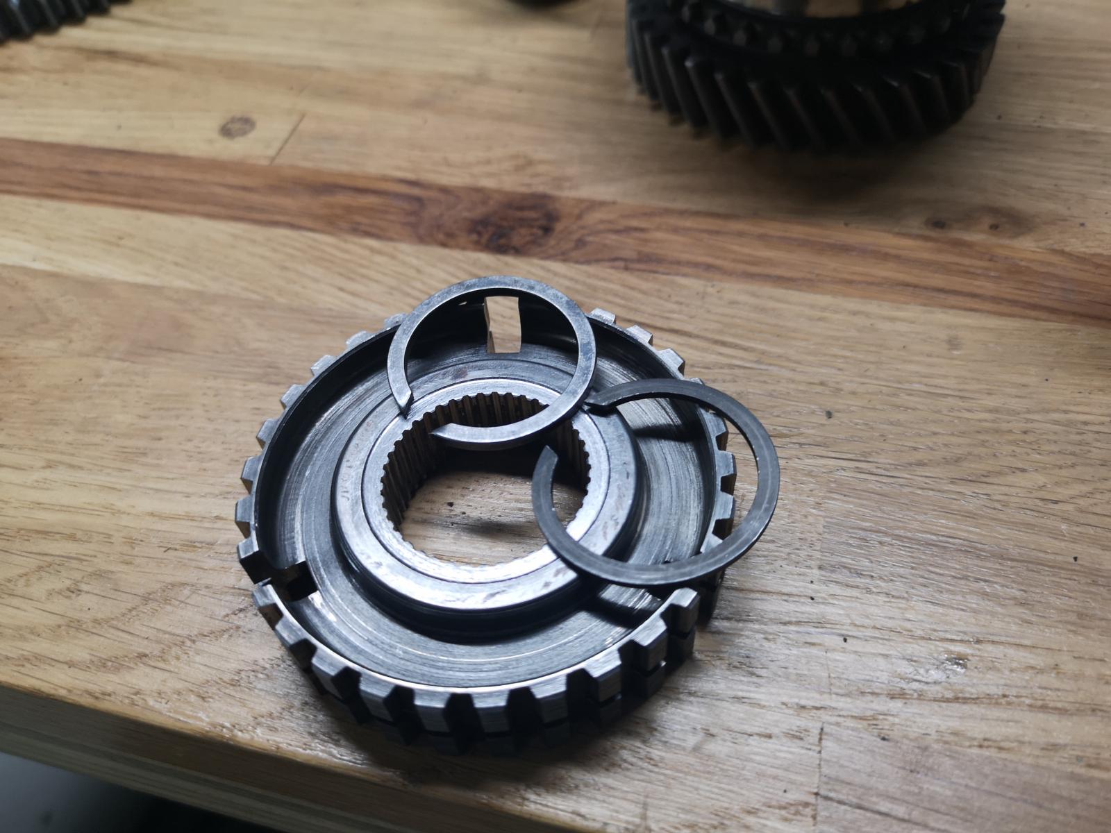

Let's move to end play....
The dark circlip is the 002 version, thinner than the 091. On this picture, you can see that the hub was machined to position it correctly.
The next picture is after removing the circlip, when the hub is push against the front 091 circlip (top). When machining the hub, measure the difference of thickness of the circlip (usually 002 is 1.49mm, 091 is 2.47mm). 4th gear will have around 0.25mm play and 3rd 0.50mm play (see...). You will then machine around 0.80mm off the hub (MEASURE YOURSELF ON YOUR PARTS) to split the endplay between the 2 gears, and both gears will end with 0.37mm.
Now all your idler gears are well oiled and have sufficient endplay.
Don't do the handpacking of the needle bearing as suggested by Berg. It brings too much heat in the gear. Look for the early caged needle bearing, there is more room for oil.
