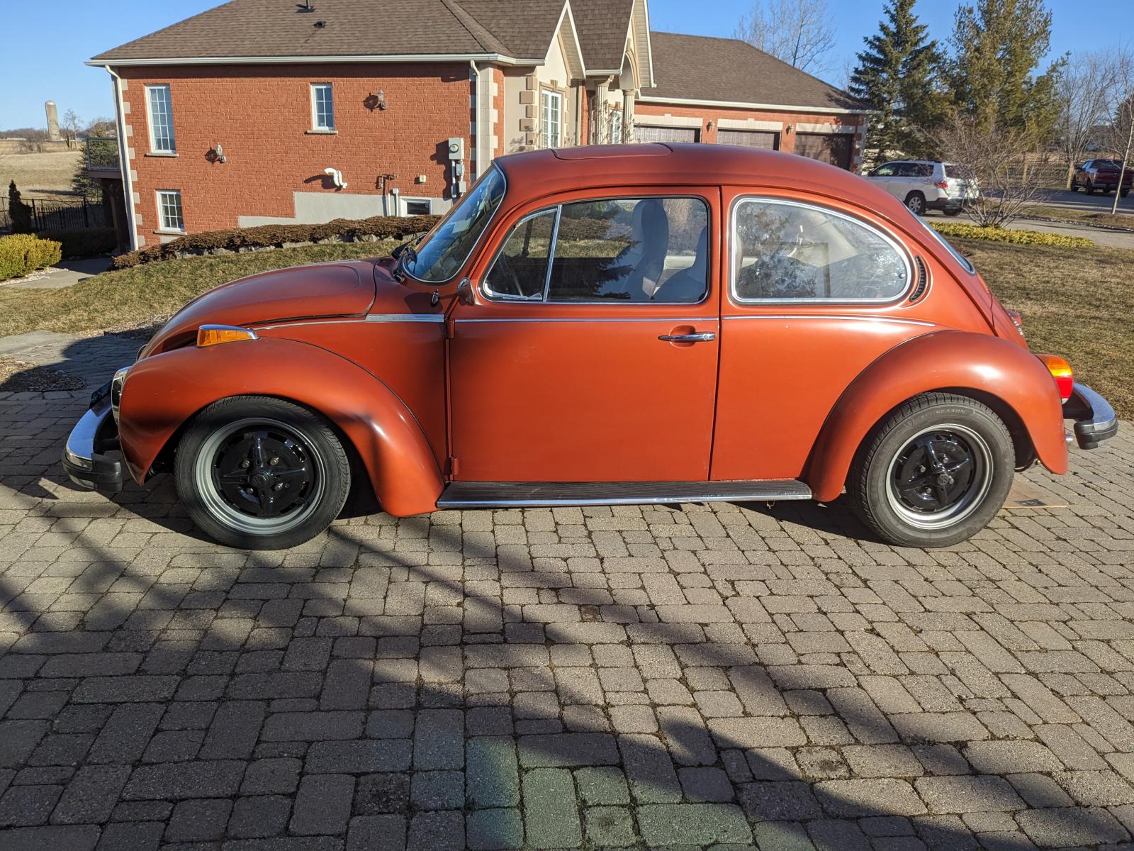

PostPosted: Tue Apr 04, 2023 7:29 am    Post subject: Re: Official "Super Beetle" lowering topic Reply with quote
Here's a pic of my 74 super with 155/60/15's on 4.5" ET41 sport wheels on the front and 185/65/15's on 5.5" ET40 sport wheels on the rear.
The front was lowered for this pic using EMPI adjustable struts on highest setting along with CIP1 red tapered sport springs. Unfortunately the strut inserts, which I believe are oil filled are shot. When pressed in, they can't be easily pulled out. I believe this causes the car to drop way lower than 3" (which I understand is the safe max lowering amount for 74+ supers). On bumps, I found the control arm contacts the steering drop arm.
For now, while I consider other options, I went back to stock struts with the tapered springs. This setup with the small tires does still lower the front end about 2"-2.5" but has a fairly large fender gap which I'd like to eliminate.
I have ordered some KYB excel-G front strut inserts and plan to use these with the adjustable struts on the highest setting along with sport springs.
Expected lowering math as follows:
Struts at max: 2" drop
155/60/15 tires vs stock 165/80/15: 3.1" less diameter divide by 2 = 1.55" drop
Sport springs: 0.75" to 1" drop, but with gas inserts, probably 0.75"
Total drop: 2" + 1.55" + 0.75" = 4.3" drop
This exceeds the safe max of 3" which has me thinking I need to put stock size tires back on, which would have the added benefit of returning accuracy to my speedometer.
But I do like the look of these small smart car tires and they are brand new...
Wondering what the samba folks have to say about this dilemma.

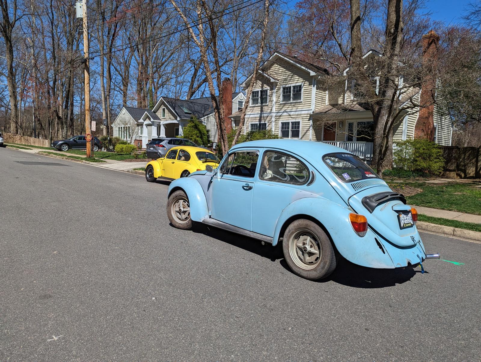

PostPosted: Wed Apr 12, 2023 12:29 pm    Post subject: Re: Official "Super Beetle" lowering topic Reply with quote
illcomm33 wrote:
I'm ultimately shooting for the same. About to set my adjustable struts up on highest setting with tapered springs and 165/65/15 tires. Will post pic when done and comment on ride quality.
Thanks for the reply and looking forward to seeing the pics/hearing about the outcome. I should have also noted I am using the STOCK springs.
On my '74 Super I have 5.5" rims in back with stockish Nexen SB802 tires. They fill in the wheel well nicely. Car is messy because I'm in the process of refurbishing it.

PostPosted: Thu Apr 13, 2023 4:56 am    Post subject: Re: Official "Super Beetle" lowering topic Reply with quote
Front has the same tires on 4.5" rims. It's lowered like 1-1.5" using lowering springs I bought from CIP1.COM.

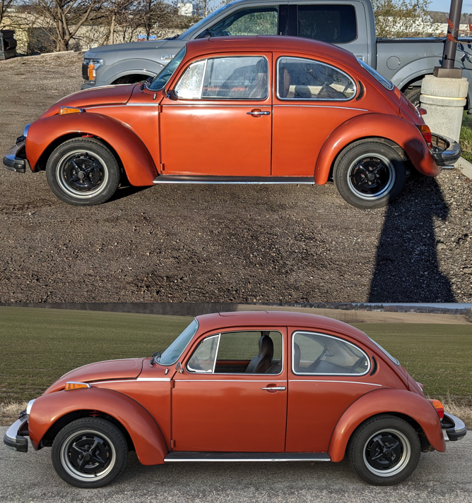

PostPosted: Wed Apr 26, 2023 5:03 am    Post subject: Re: Official "Super Beetle" lowering topic Reply with quote
Here's a before and after shot of some slight lowering on my 74.
Before (bottom):
Tapered sport springs in stock housings with stock oil-filled inserts and 155/60/15 front tires
After (top):
Tapered sport springs in adjustable housings on top setting with bilstein B4 gas inserts and 165/65/15 front tires
The change is subtle, but I like the slightly bigger tires and the fender gaps are roughly even front and back. The front end sits approx 2.5 inches lower than stock (before I used the tapered springs at all).
The springs may settle a bit, but I need to get an alignment soon. Thoughts? Should I keep it here, or go one notch lower on the adjustable struts?

PostPosted: Wed Apr 26, 2023 5:19 am    Post subject: Re: Official "Super Beetle" lowering topic Reply with quote
I'd go a notch lower...

PostPosted: Wed Apr 26, 2023 5:21 am    Post subject: Re: Official "Super Beetle" lowering topic Reply with quote
Nice Super btw!
That's kinda what I'm thinking. My wife won't be happy! Been messing with this too much. Gotta find some different spring compressors since these tapered springs are a pain with the set I've got.
Before (bottom):
After (top):
Looks good and thanks for posting.
What size are the rear tires?
Is it a common practice to mismatch front and rear tire sizes on a Super Beetle (after lowering just the front) so it sits level? (VS re indexing the rear torsion bar?)
