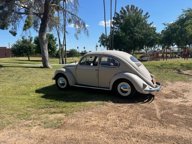

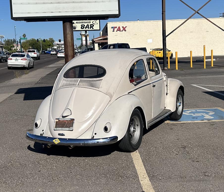

So on my way home from work a week ago, I saw this oval parked out on the road with a for sale sign on it.

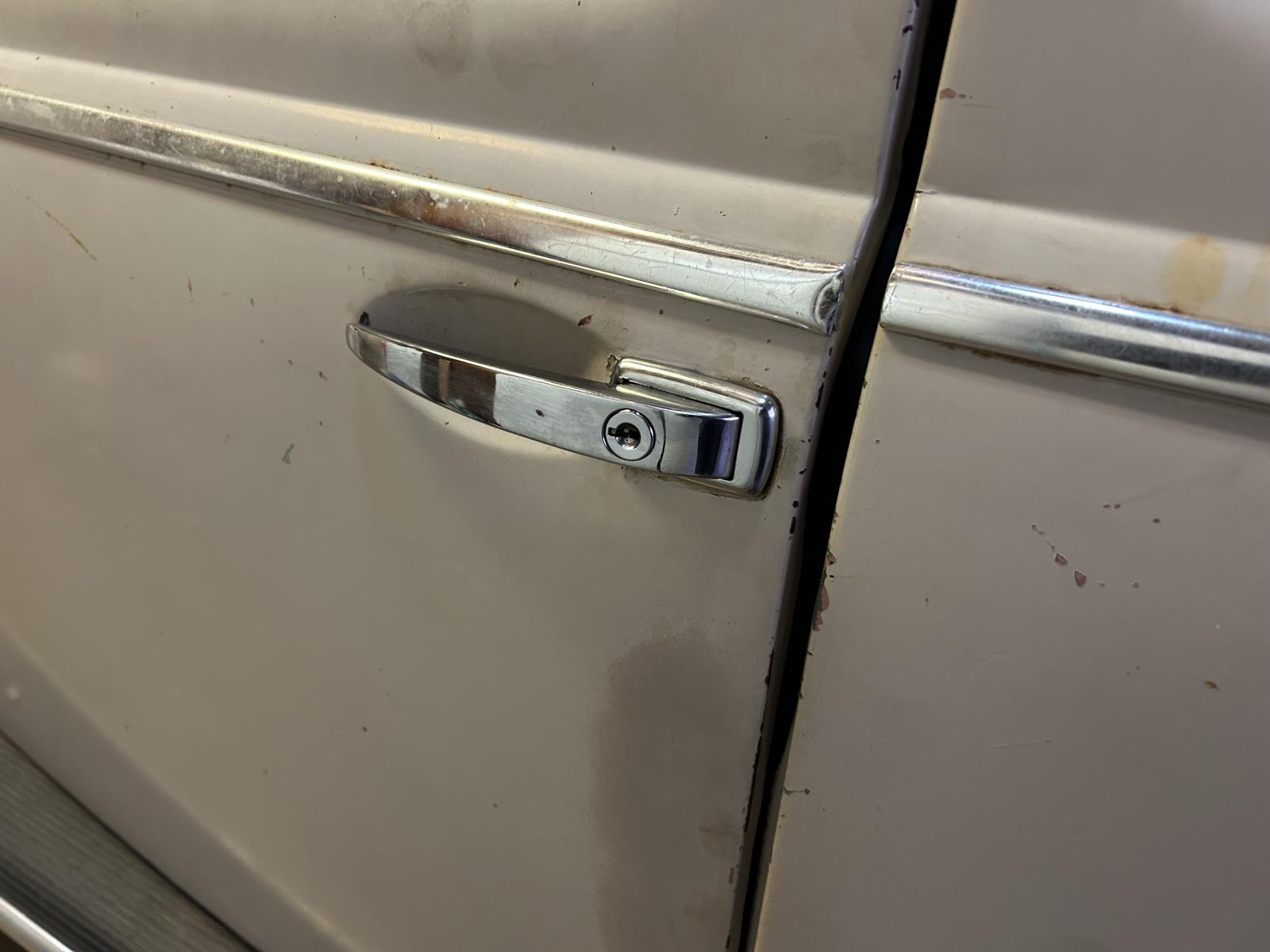

I thought it was a 56-57 but was super surprised when I got up to it and it was a ribbed door euro car. My Dad has been looking for a 3 Fold ribbed door car for a while, but a hardtop is a great start! and it drove home.

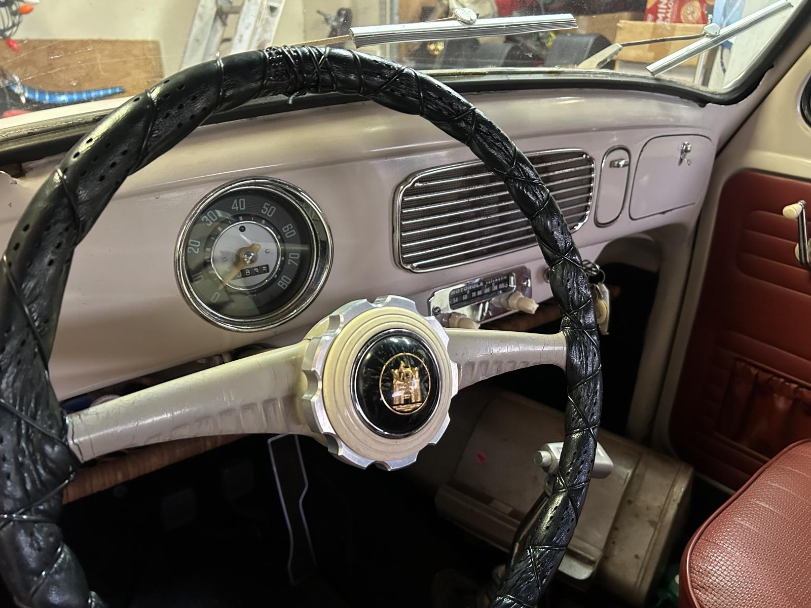

Dash is perfect, might even be the original Nile Beige paint still. added a 356 Blaupunkt radio and a camping quick release I made.

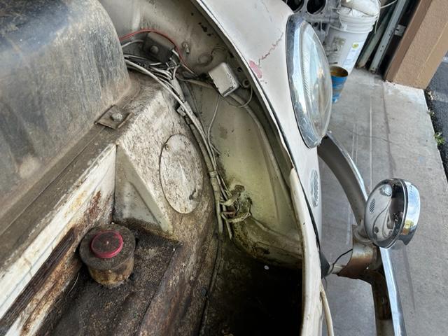

Front clip is about perfect to, apron is kinda banged up but the whole car is super straight.
Only real issues with it is the drivers heater channel is kinda rough and it needs rear bumper mounts and some wheelhouse/firewall rust repair. but the package tray and pans are all super solid.
Bonus that it is already 12v, non splitcase and came with a solid 1600DP motor. brakes are still all 2 bolt and actually all work. needed some wiring love because none of the lights worked. And more of a bonus, it has all the original seats! interior has what looks like a red TMI kit.
my dad wanted my BBT sprints, so ditched the AE 5 spokes. and added the correct big spring decklid. has a 64ish hood on it, but I have a solid 4 tab for it. Front fenders are rough but are original and actually still have the wire tubes.
pretty stoked on this car for him, also exited to see what we build it into, I'm pretty sure it has a 3 fold from grumpys in its future.

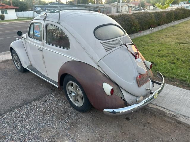

Today I got some repop egg taillights from Koch's, installed them on it. Luckily there was great info and pictures on here on correct mounting locations. The rear fenders aren't OG but they will work fine.
measured everything out, and welded up the old taillight holes.
pretty solid looking! ran all new wires for the rear lights as well.

Nice driver. I like the rear view. The taillights came looking great and I like the red decklid.. does it have a later rear apron with the pea shooter cutouts?

Thanks! I think it might get painted Strato silver. It actually is the original rear apron with the cut outs on it.

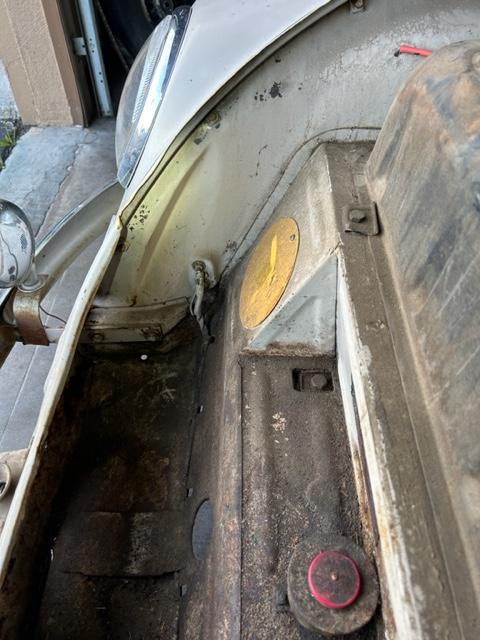

added a really close to correct hood for it, its a early 56 hood, with no folded edge on the cowl. fits great. removed the peanut turn signals as well, holes will be welded up soon.
also added the correct 55 tank.

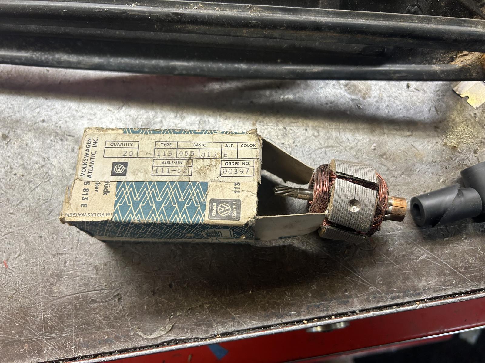

today I converted the wiper motor to 12v, unfortunately I had to swap out the motor to a 58+ style, my dad had an NOS 12V armature, that didn't fit in the oval motor. he also had a good used 58+ motor, cleaned everything up and got it installed and running. new blades and body grommets..
also got the drivers hinge pin out, super easy with the correct tool!

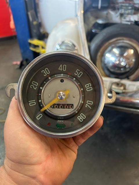

Had the speedo rebuilt, minus a new needle.

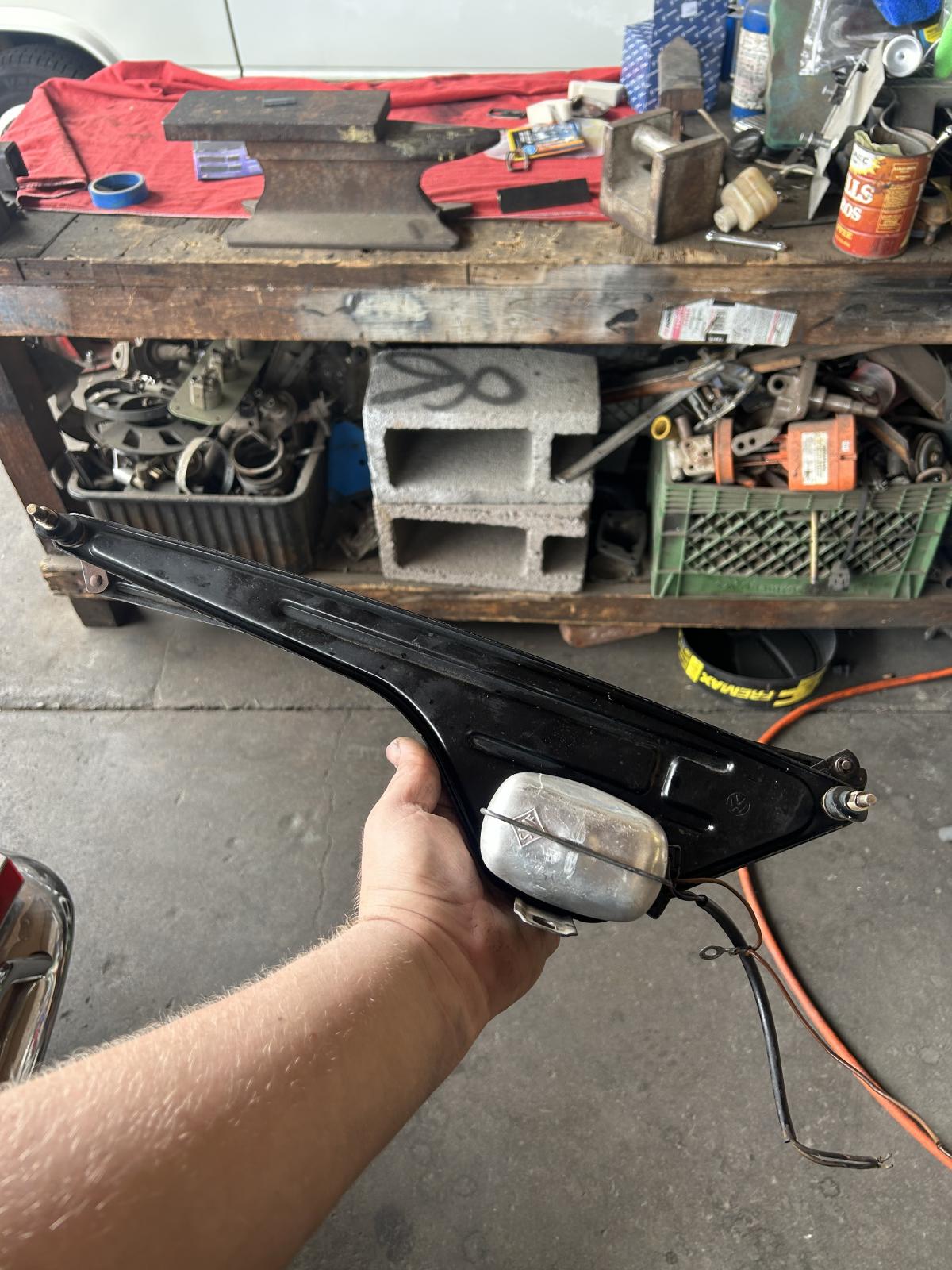

Got some 12V ribbed semaphores, and got them all working. Also picked up some 12V flashing bulbs. Also had to run a new harness for the passenger side semaphore as the original one was missing.

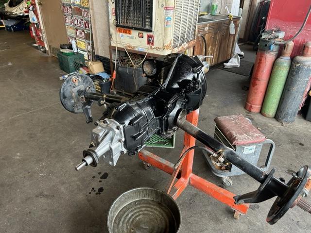

Also pulled a rebuilt freeway flyer trans from one of my dads other projects that has been sitting since 2015. the current trans in the 55 is loud and shifts bad. so this one is going in, had to convert the nosecone to a bus one, fix the hockey stick so it would work and go thru all the brakes, swap the clutch arm and replace the mounts.
pulled trans
super clean, ready for the bus nose cone
also have all new 1 bolt front brakes, new soft lines, dual master cylinder and drums for it, that'll hopefully be on and done this week.
had to weld and redrill/countersink hockey stick to work with the bus nose cone.
and done, swapped the clutch arm, drained and refilled with new gear oil, and installed the nosecone. have to install the new throw out bearing and rear mount. and pull the other trans from the 55. also have to put the new axle boots on, and flip the backing plates upside down.
