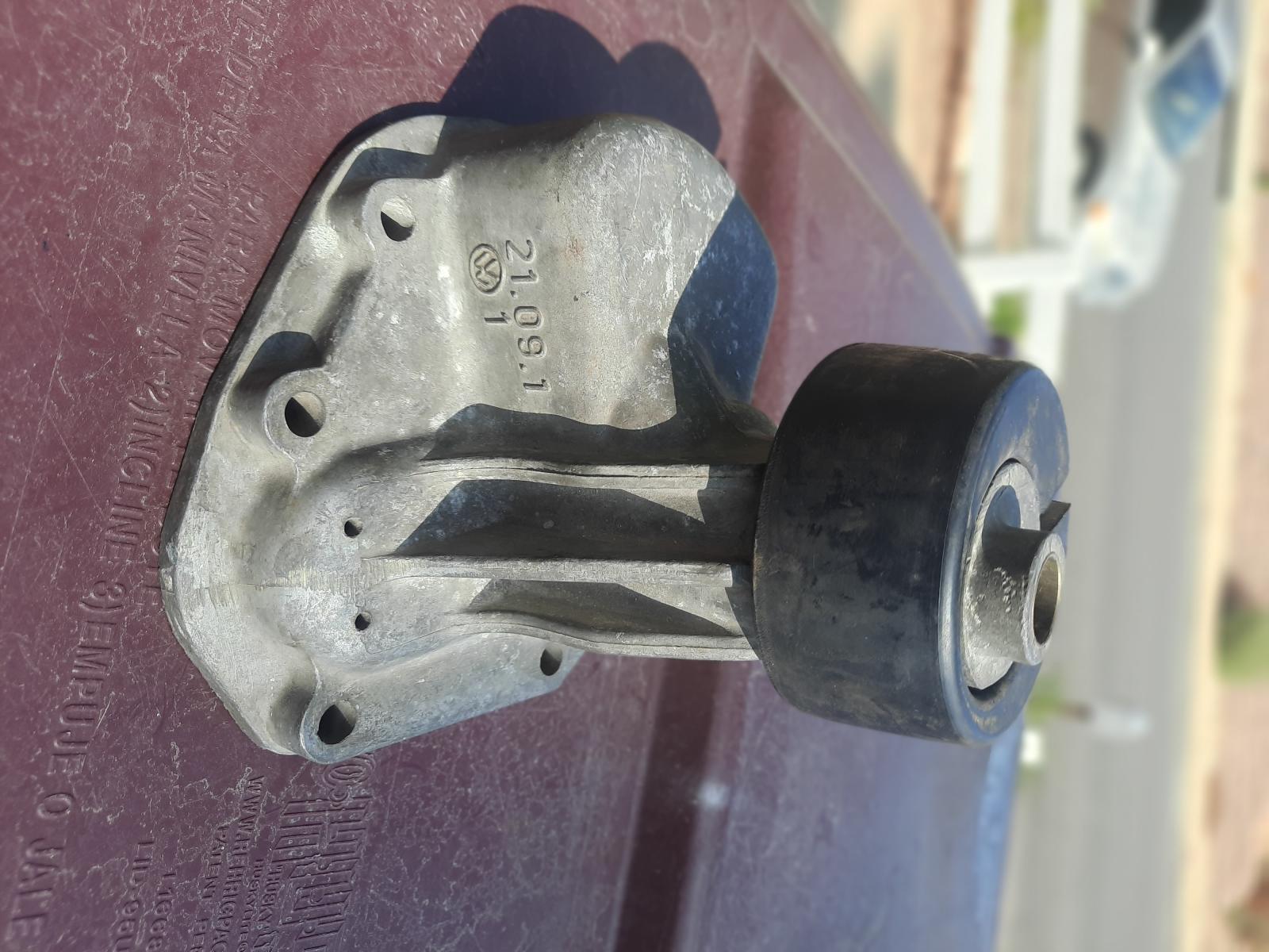

its for a 51 split case bug trans nose cone #21 09 1. i have a NOS nose cone , im looking for the matching hockey stick to go with it . any help here is appreciated .

PostPosted: Wed Oct 16, 2024 1:53 am    Post subject: Re: can someone help with hockey stick part # Reply with quote
my3bugs wrote:
well i kept searching and think i found the answer in another samba thread here .
111 307 541 Shift lever, thru 1952
111 307 541A Shift lever, 1953 thru 1959
111 307 541B Shift lever, 1960
113 311 541A Shift lever, 1961 - 1971
if anyone has the early hockey stick/lever for sale let me know . im not seeing one for sale here .
Attention: there are many different versions of original nose cones till 9´52 and till 59 (Bus) in the field!
Your nose cone is the reinforced version with 3 ribs (instead of only 1), also for Bus (but also fitting Beetle)
For this nose cone you need the newer shift lever 111 307 541 A
This lever is the same as for Export Beetles till 7´59. So not that rare.
To clarify what version your nose cone exactly is, please post pics from the inside.

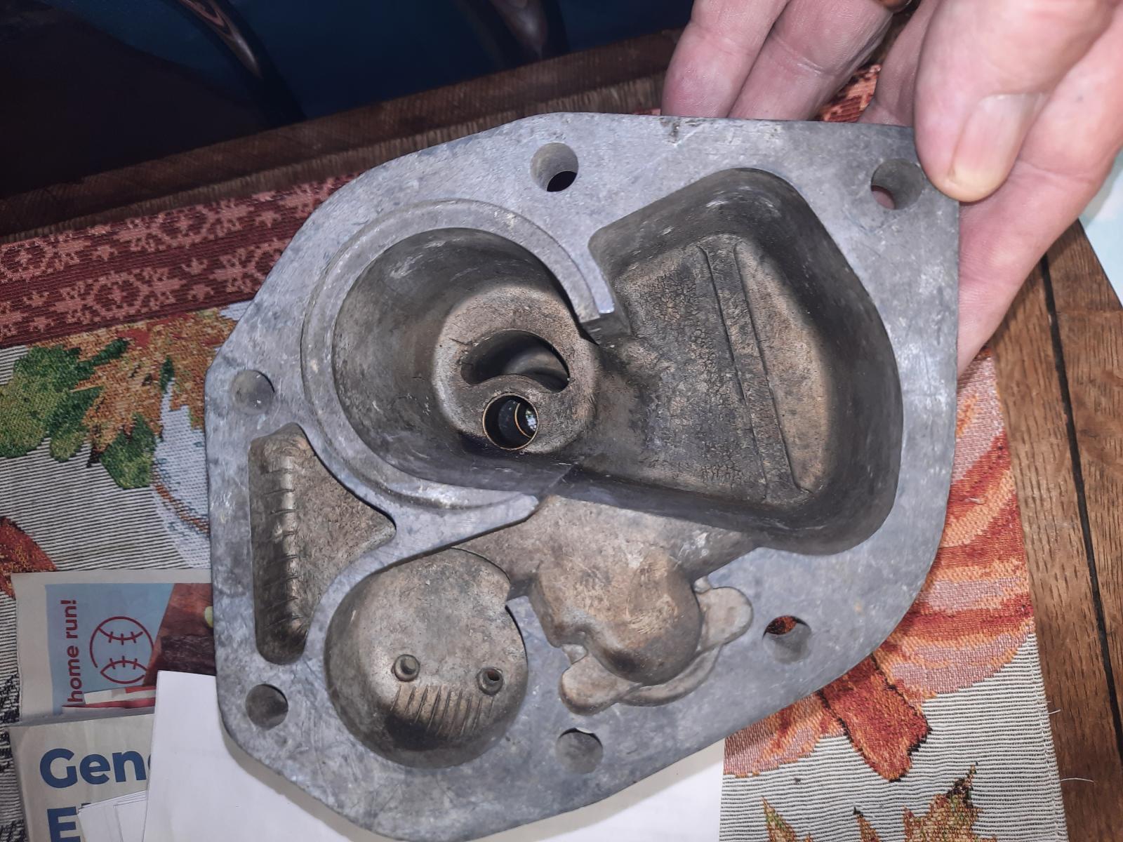

PostPosted: Wed Oct 16, 2024 8:31 am    Post subject: Re: Can someone help with hockey stick part # Reply with quote
Much appreciated info Wagon19 , thanks for informing me . i do have a rough looking well used 111 307 541 A stick here . but too rough to use .
just checked , i was not aware of the differences in early versus late nose cones here . the one in my 51 bug only has the 1 rib .
snapped a pic if the inside here .

PostPosted: Tue Oct 29, 2024 1:10 am    Post subject: Re: Can someone help with hockey stick part # Reply with quote
For me, your pic says, your nose cone is a spare part after 1´53 for beetle till 9´52 with chrash box trans and for bus with crash box till 12´52.
The cast numbers are a bit confusing, for ex, I have a old nose cone with exact the same numbers, 21.09.1.1
But this part has only one rib and the old hockey stick 111 307 541 placed inside.
So it´s not so clear to see the difference.
Look page 5 - 2 : >
https://www.thesamba.com/vw/archives/manuals/1952-...nsaxle.pdf
It seems, it depends on the version of nose cone, which hockey stick can be used. The wall of the newer nose cones is thicker than on the early ones.
Try your old hockey stick in your new nose cone for test shifting.
If you can properly shift the reverse gear, this version is OK, otherwise you need the newer version "541 A".
