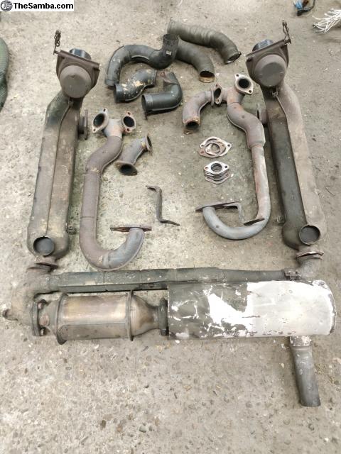

https://www.jbugs.com/product/113255165.html
https://www.jbugs.com/product/98-1004.html
Those don't fit anything made after 1974.
The fresh air tubes have intermediate pipes between the rear tin and the heat exchangers on FI cars. There's usually a few in the classifieds, except for right now...., there is one pair included in this complete system pictured below, they are at 11:00 in the pic, one is super squiggly and the one below is shaped like ~.
https://www.thesamba.com/vw/classifieds/detail.php?id=2722398
If you don't need a full system try asking some of the wreckers like Avery's, or the others listed here: https://www.thesamba.com/vw/shops/cat.php?id=12

PostPosted: Thu Jul 17, 2025 1:37 pm    Post subject: Re: Official Fuel injection questions thread Reply with quote
Thanks. I had no idea those existed. Are they made of metal? I'm guessing so.
I can see how that would make the connection easier than stuffing a long hose through the tin like it is currently.

PostPosted: Thu Jul 17, 2025 3:34 pm    Post subject: Re: Official Fuel injection questions thread Reply with quote
The pipes are made of metal, like I said it's odd there's none in the classifieds right now, maybe try Awesomepowdercoat? If you can't find anything maybe some of that bendy flexible exhaust pipe might work.
As for the tube the 113721551 should fit, super and standard are only different ahead of the front door posts after 75.
