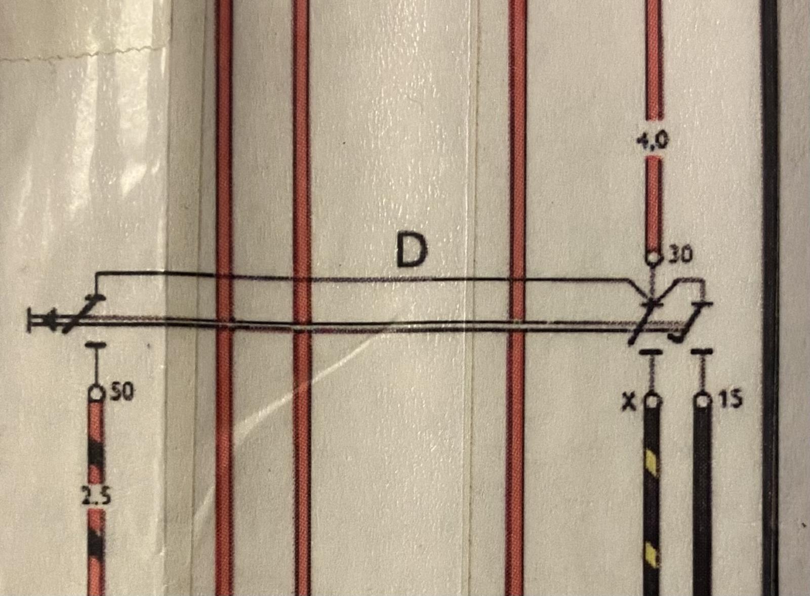

SGK, I’ve pulled the battery out to charge it..
Once it’s back to 12.5 I will put it back and recheck those fuses. I had put the leads on metal either side of the fuse. Maybe battery was too low (11.2) or .. user error.
Double checked the Diagram… I think maybe the ignition switch (15) as you suggested.
I found Ratwell’s guide to Alternator and VCM ..
Thank you Wagen that helps clarify.
Hoping it’s just a dead Black 15 from the Ignition Switch.
Will have a fresh look tomorrow w full battery.
I’d like to meet the guy who placed the fuse box where it is.. and the battery… Shocked Laughing

Look at the wiring schematic and see which fuses are fed by the #15 circuit and with the switch on test one or more of them to see if it/they have power.

PostPosted: Mon Jun 16, 2025 7:25 pm    Post subject: Re: Dead alternator - Type 4 bay, cant find a new one. Reply with quote
Yes.. rechecked with strong battery and have plenty of V on S9.
No lights on the dash….
Not feeling a click in the switch from OFF to ON…
But there’s 12.5 at S9 today… dark Inst Panel.
Next to check is Black 15 at ‘top’ of S11 … eh?

yes. If you do not have voltage there, the ignition switch is bad. Normally it is the electrical portion but there have been a thread, maybe 2, where the blade that goes into it from the key portion was worn out. Switch failures are common. The plastic cracks and then the back does not make good contact. Lots of folks here used to carry a spare with them it can be so common. I don't know what brands are the best these days. It is a simple job on a later bay to swap the electrical portion.

Is the electrical system, wiring still original?
When were the control lights still OK, last time?
As I can understand the situation here, the engine starts, is running properly. (if I got it right)
If so, there must be voltage on terminal 15 at ignition switch, going to coil and complete ignition-fuel system.
If so, the switch can´t be dead.
Suggest to remove the instrument panel and inspect all ends of wires and all bulbs.

Studying the diagram, I suspect the D+ might be cold and failing to supply the Blue wire. But based on Davy B's comment.. maybe the Blue wire is supposed to be powered by the instrument panel?

no. Nothing like that at all that the early bays go thru. On a 75 and later bay it is removed quite easy. If I have time I will look it up.
Here are the instructions. You can unplug the harness from it, and plug it into the new one to test everything before replacing it. On my 1977 there is a plug near the base of the column that can get bumped and cause the same symptoms. If 1975 has that be sure to push it together in case that is the issue.
Mark the steering before you begin. Put some blue tape on the steering wheel so you don't put it back 180 degrees off.
Maybe 30 minute job as I recall.
https://www.ratwell.com/mirror/bclausen/How_to_files/IgnSw/

Looks like theres a small plastic retaining tang under it.. but I plan to try.
I see a white/black wire on wire plug thats not on the schematic.
Wonder what that is ..
Speaking of .. i know 30 is hot, 15 is switched, and 50is start… what’s this ‘X’ near the black/yellow? I suppose it's just to match the mark on the plug.
jlrftype7
Joined: July 24, 2018
Posts: 4514
Location: Chicago
jlrftype7 is offline
PostPosted: Tue Jun 17, 2025 1:49 pm    Post subject: Re: Dead alternator - Type 4 bay, cant find a new one. Reply with quote
I believe it's another Ignition Load Circuit, splitting the load out of the Switch instead of all on one wire.
