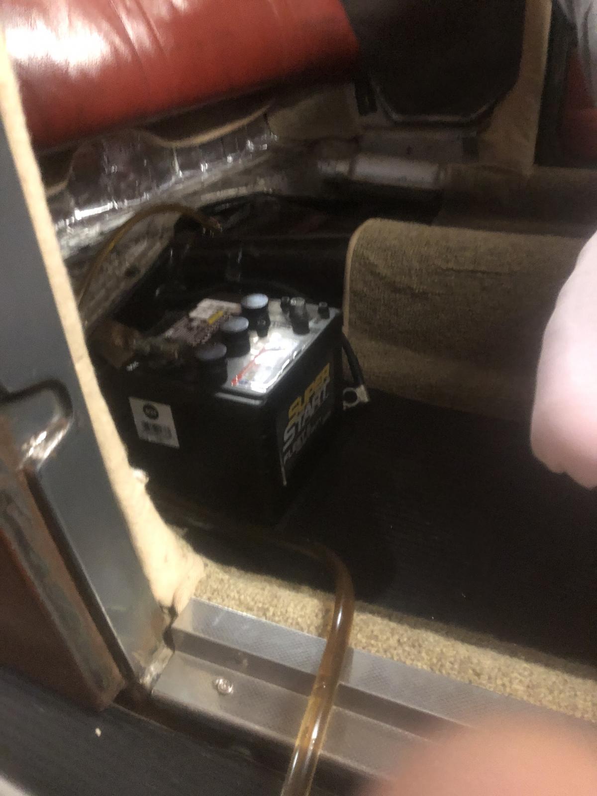

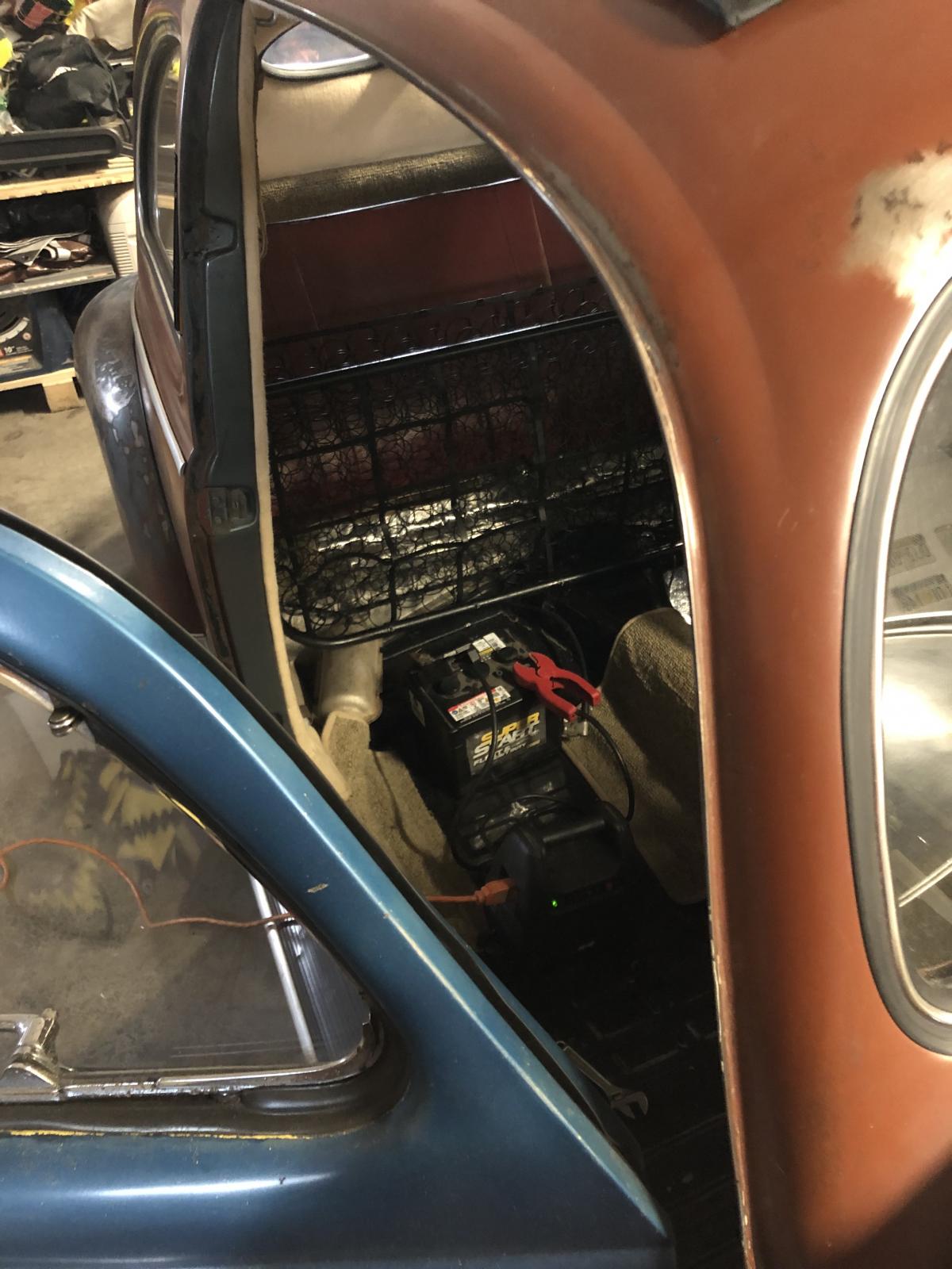

this spring i finally bought a decent battery. got the electrical (mostly) sorted.

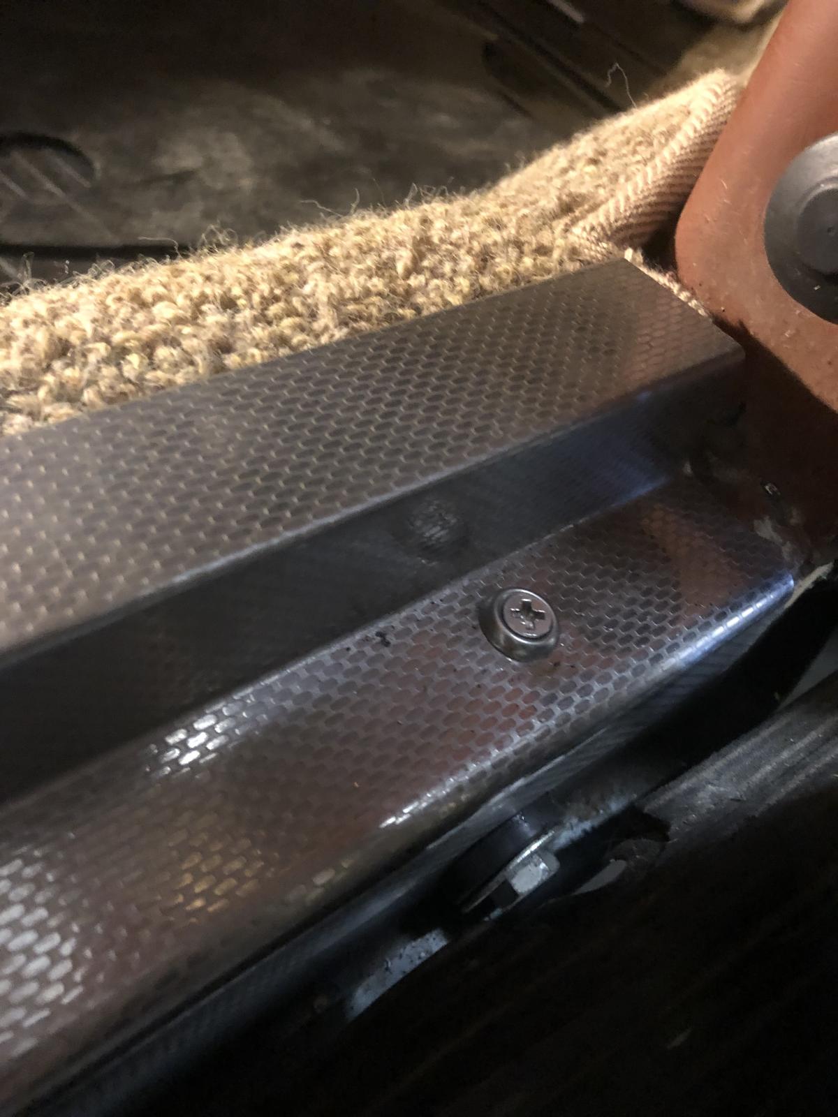

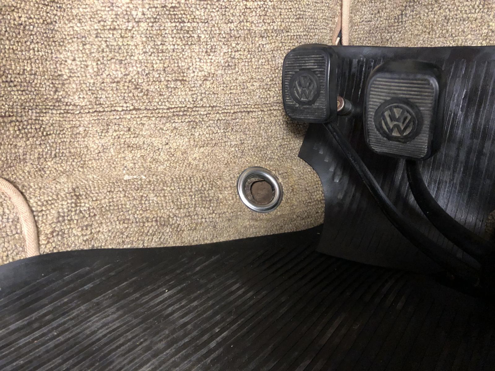

did some trim bits. it would have been better to do the carpet trim rings with the carpet off. it was rather challenging doing it in place.

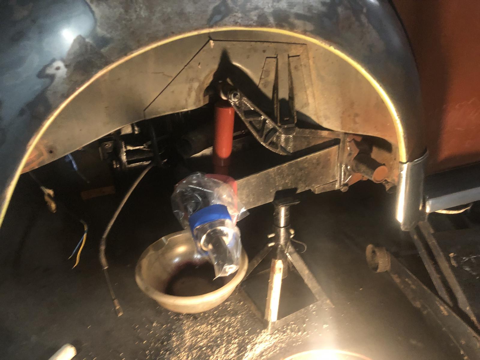

heres some rear brake photos. i went with the 54 style brakes rather than the original ones. the originals are hard to source parts for and i plan to drive the car. i put all my original parts in a box and put them on a shelf to deal with later.
i havent found anything about the number on that brake line bracket. if anyone has any info on that id love to her what it might represent.

That is the Chassis number. They all have one!

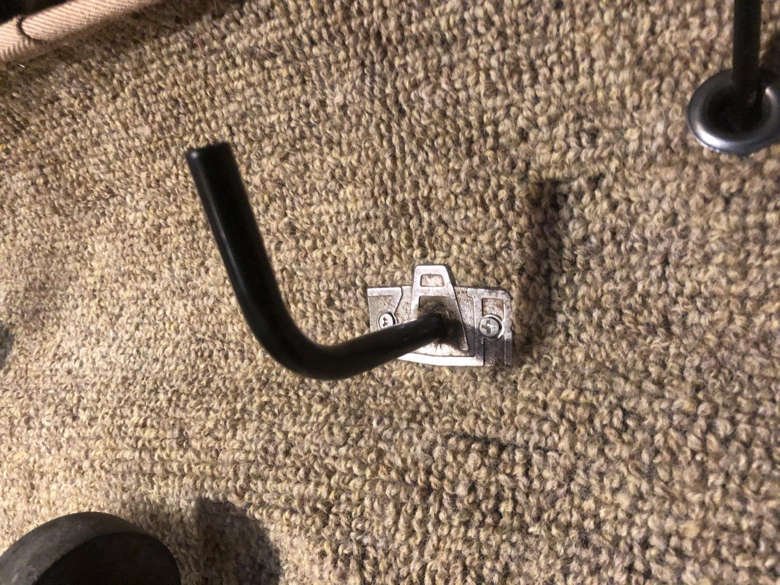

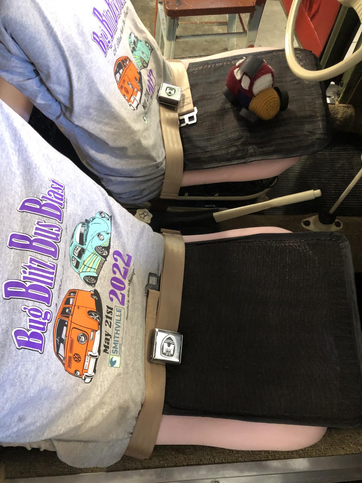

i added some seatbelts. there were already holes drilled on the the drivers side so i only had to poke holes on the passenger side.

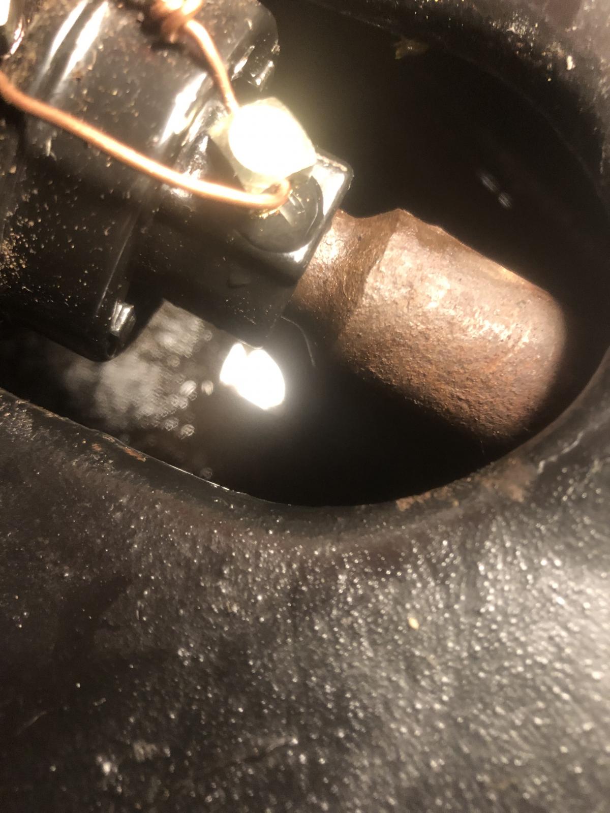

this circlip on the starter was one of the most frustrating things on the whole project. what. a. pain.

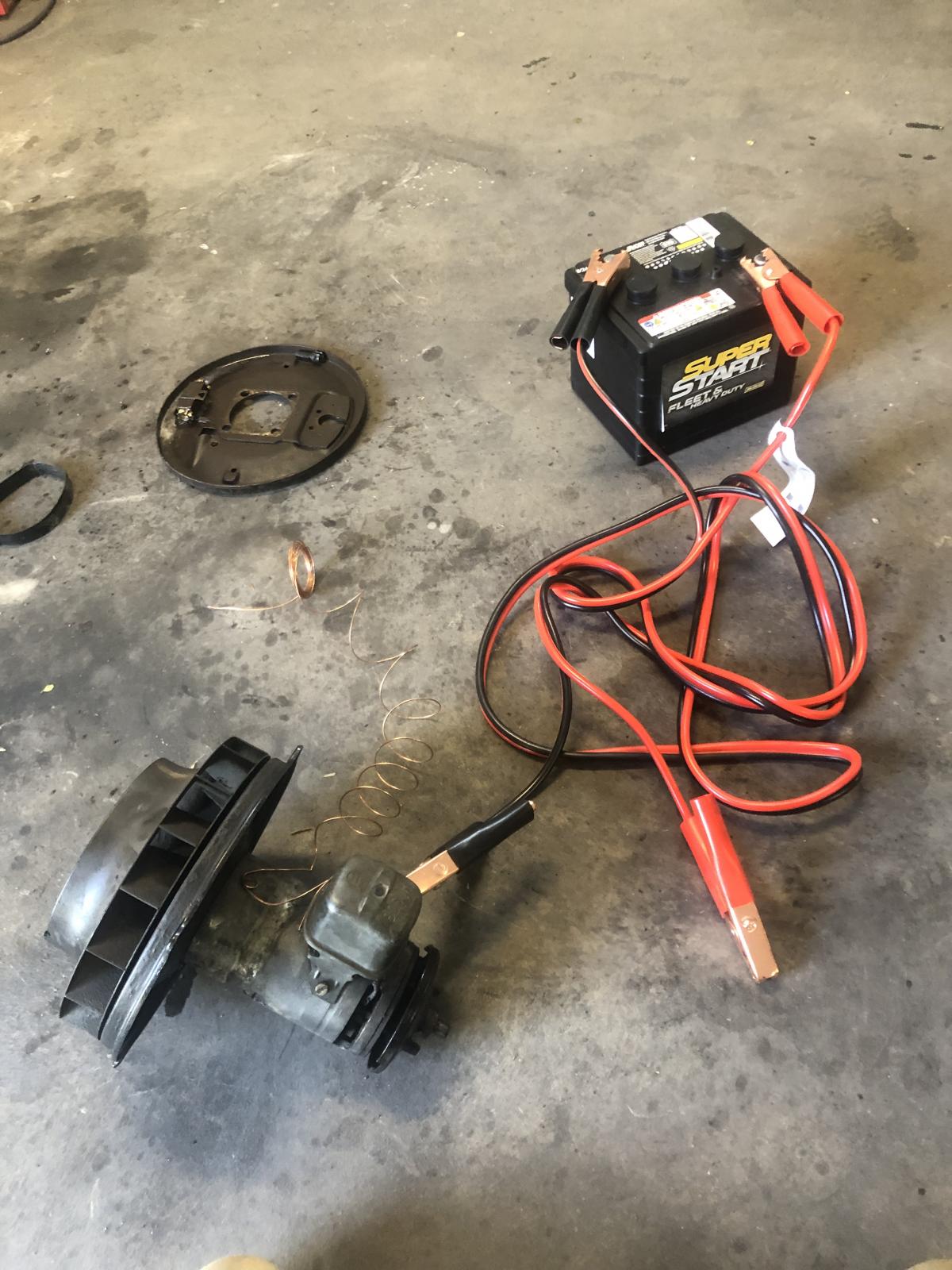

hooked a generator up to the battery to test. work fine. i dont have the one tht would be correct for the car. ill pick one up eventually. this one is from a 1960 i think.

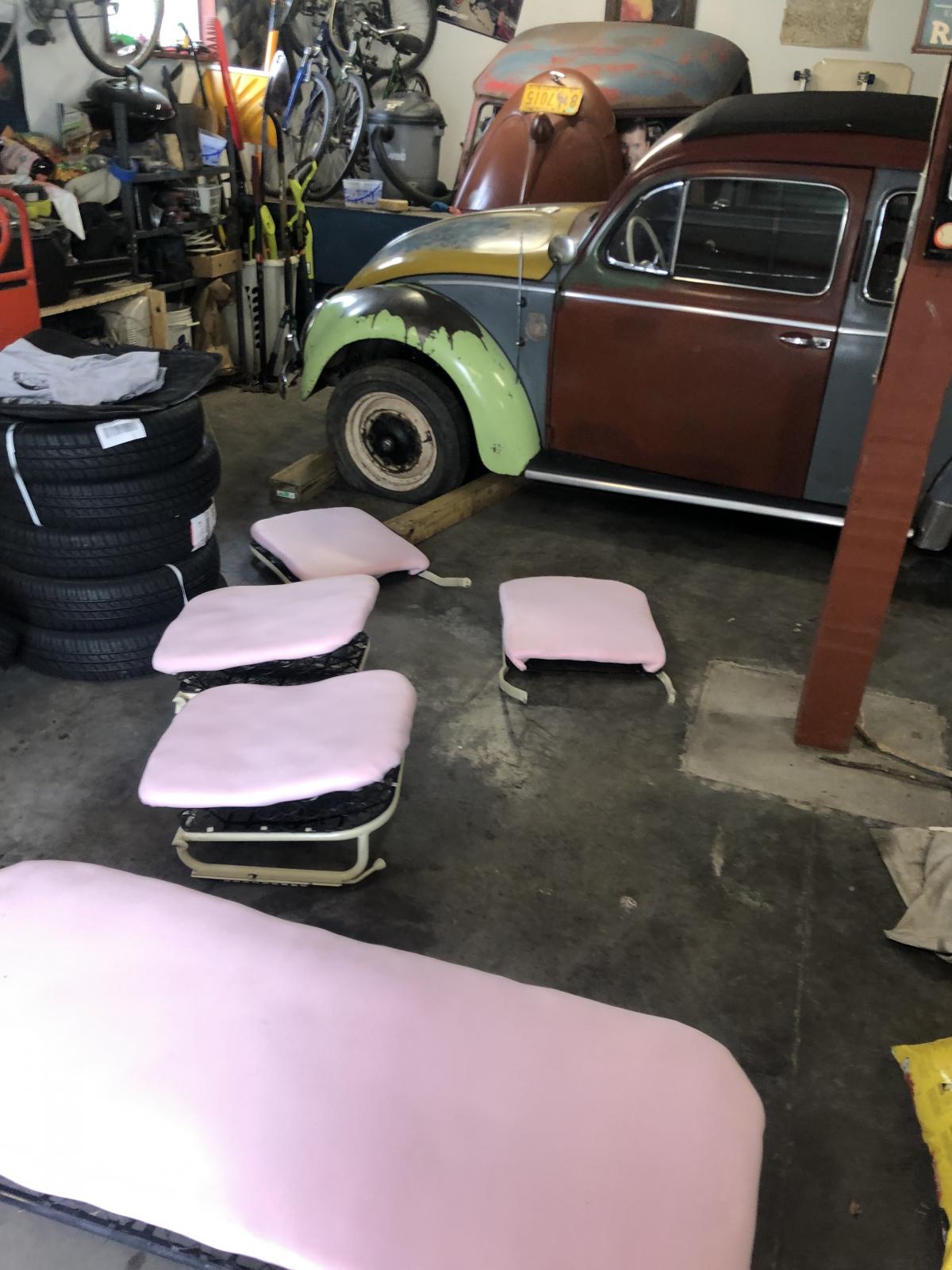

got some high density foam for the seats. ill probably cover this in wool to get the og feel and smell. comfy is nice though. they still feel like camping chairs. i dont think any amount of padding will change that. also...a butt. im a child.

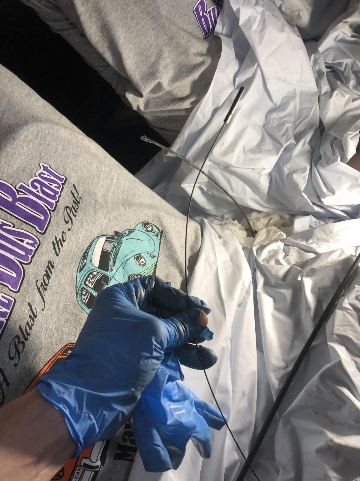

heater controls. these tubes were gross. hooked a clutch cable to a drill and reamed them out.

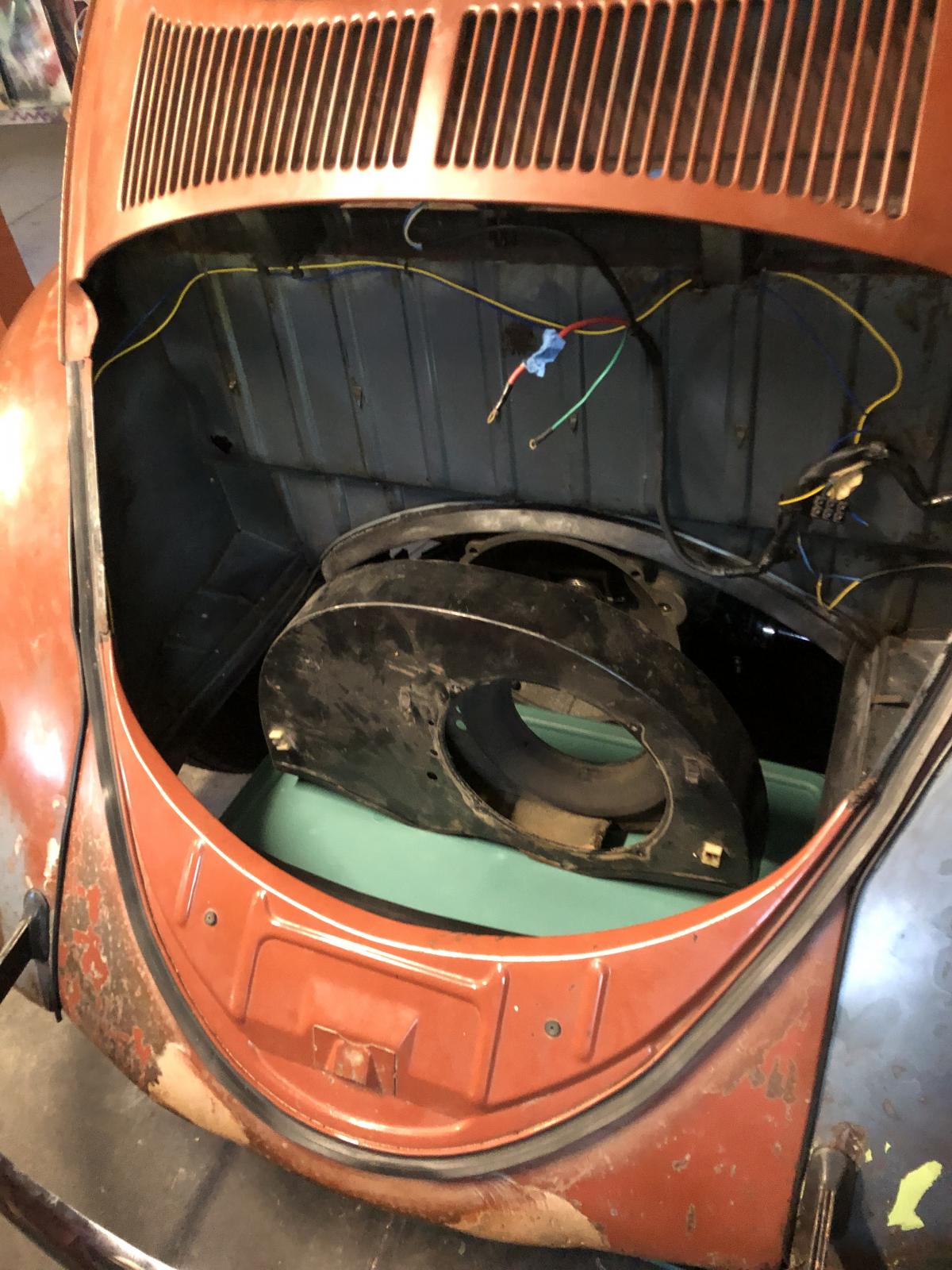

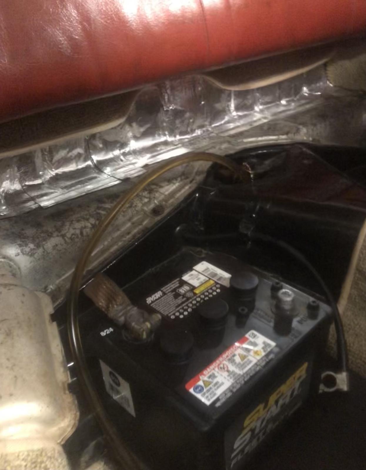

installed the fuel tank (i have the motor in at this point but ill talk about motor install in its own post). put some gas in it and had a flood. ran new fuel line.

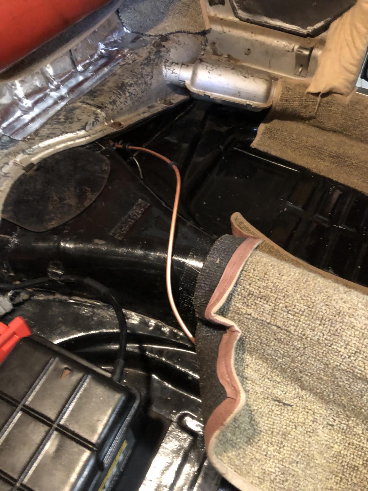

It all looks great! One thing that I did a double take on was the fuel line. Going over the tunnel. I would have reservations about that. To eliminate the possibility of damaging it with the seat, you could cross over the top of the transmission and enter the cabin next to the battery cable. Drill a hole that allows for a rubber grommet and the line. Be sure to paint the edge of the exposed steel after drilling it out.
thanks for looking out! i should have mentioned that that was a progress pic. i do have that line tucked in and away from where objects or the seat can hit it. i added rubber bumpers and tied it in place similar to the brake lines. i also padded the top and ran it under the carpet so it should be pretty cushioned. i followed the method and locations in the workshop manual.
ill take some pics of it and post them. extra eyes on something like that is invaluable. i do have a fire extinguisher in the car. the look on my passengers faces when i tell them where the fire extinguisher is is priceless.
building trust in my workmanship is a bit of a process. im an amateur and started this pretty ignorant. someone on some internet forum wrote something i think about a lot. - you have to be somewhat competent otherwise the thing would not go -

So cool to have your father's car running again, what a great feeling that must be. I've been following since you first posted.
Here is a bulletin from Volkswagen (fitting an additional fuel line)
I like Jimbo's idea better though, crossing over the transmission.

yeah. thats what i did. it crosses under the back seat to the rear of where the seat makes contact with the column.

...heres some rear brake photos. i went with the 54 style brakes rather than the original ones. the originals are hard to source parts for and i plan to drive the car. i put all my original parts in a box and put them on a shelf to deal with later.
i havent found anything about the number on that brake line bracket. if anyone has any info on that id love to her what it might represent...
The number on the bracket is the serial number for the frame head, which dates from May 1955 per Progressive Refinements.
neat. for anyone keeping track the car is confirmed to have parts from a 1952 (many), 53 (engine block), 54 (body number), 55 (frame head and also the drivers window crank mechanism), and a 1960 (generator and regulator). the split window graft is from a pre zwitter spit of unknown year. i wonder how many other years i have in here.

I seriously urge you or anyone who uses or has the "clamshell" style seat belts to upgrade them to some sort of positive locking belt mechanism. While they are period correct(sort of), your life and possibly your future mobility might depend on them. I understand no VW is "safe", but you can make them safer if you use the right stuff.
I had those types in my '62 DC, you see in my sig. '06, my wife was driving it and was hit in an intersection in the passenger side A pillar. The impact dislodged her belt clasp, and she was thrown from the bus, suffering a severe spinal cord injury. Sorry to be Debbie Downer, but this is a real, albeit remote possibility when using those belts. We have lived for 20 years with the result of my choosing not to upgrade to a better 3 point positive locking belt, and I regret it every second I am alive. Learn from my mistake. I sincerly believe had I had positive locking belts or better yet a 3 point in the truck she would have stayed in the truck and be walking today. Sadly that is not the case. I love these things, but will never forgive myself for my lack of preperation and
deference to how dangerous they are.
Living with an SCI is to be avoided at all costs. And yes, I would choose death over SCI.

i appreciate your concerns. safety matters to me. i am also very sorry that you were involved in such a traumatic auto collision. forgive me if im out of line here but i think that after 20 years its time to work on forgiving yourself and letting go of that hurt. you dont need to carry that pain every day dude.

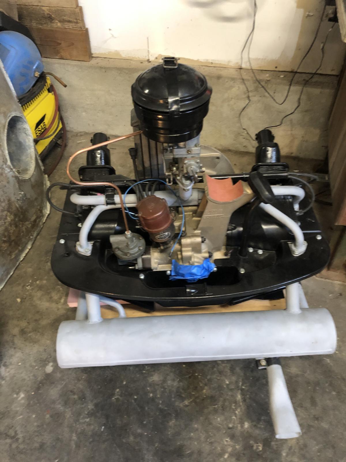

now... onto motor install.

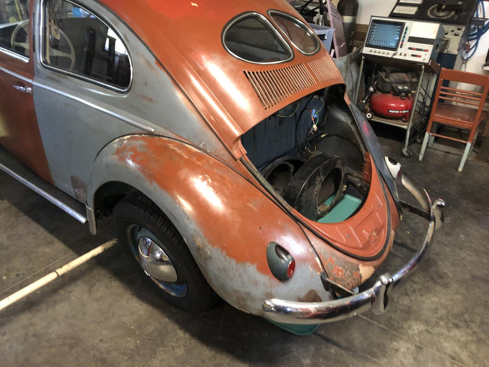

in the spring of this year we were somewhere like this:
i had to backtrack a bit because i neglected to install the thermostat
my jack stands arent tall enough for the motor install so we got a bit precarious. jack it up and drop it. mocked up a motor and tested till we felt "cool". it never felt cool.
but it worked...
