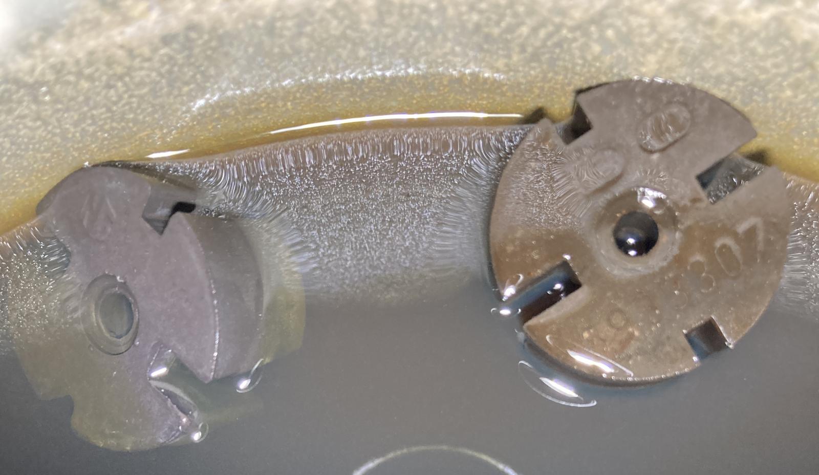

I had a new sender (may have been ISP) and found the float started absorbing fuel and was sinking/ not fully floating, it’s 2 pages back on my thread but here’s what it looked like. The OG vw one is fully floating. It may be worth checking
I haven't run into a new one doing that, but I have had a sticking float before. You'd be surprised what you run into over the years of working on cars. I've had a float stick toward the bottom of the tube, and only barely allowed a gallon into the tank. That's when I started keeping track of my mileage as a back up to the gauge.
