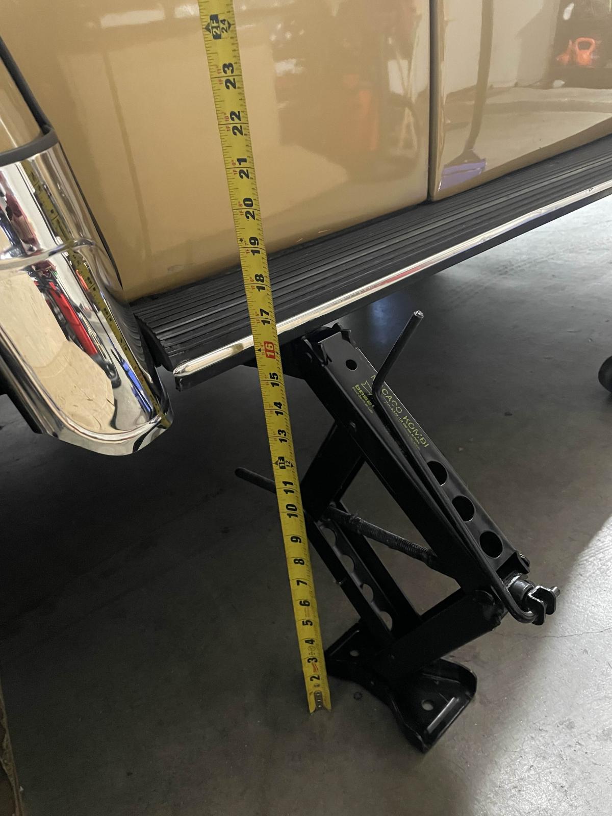

I carry this Scissor Jack for my super beetle.
and it can extended enough to change the tires
and low profile it was able to put into the jack point to change the tire.
