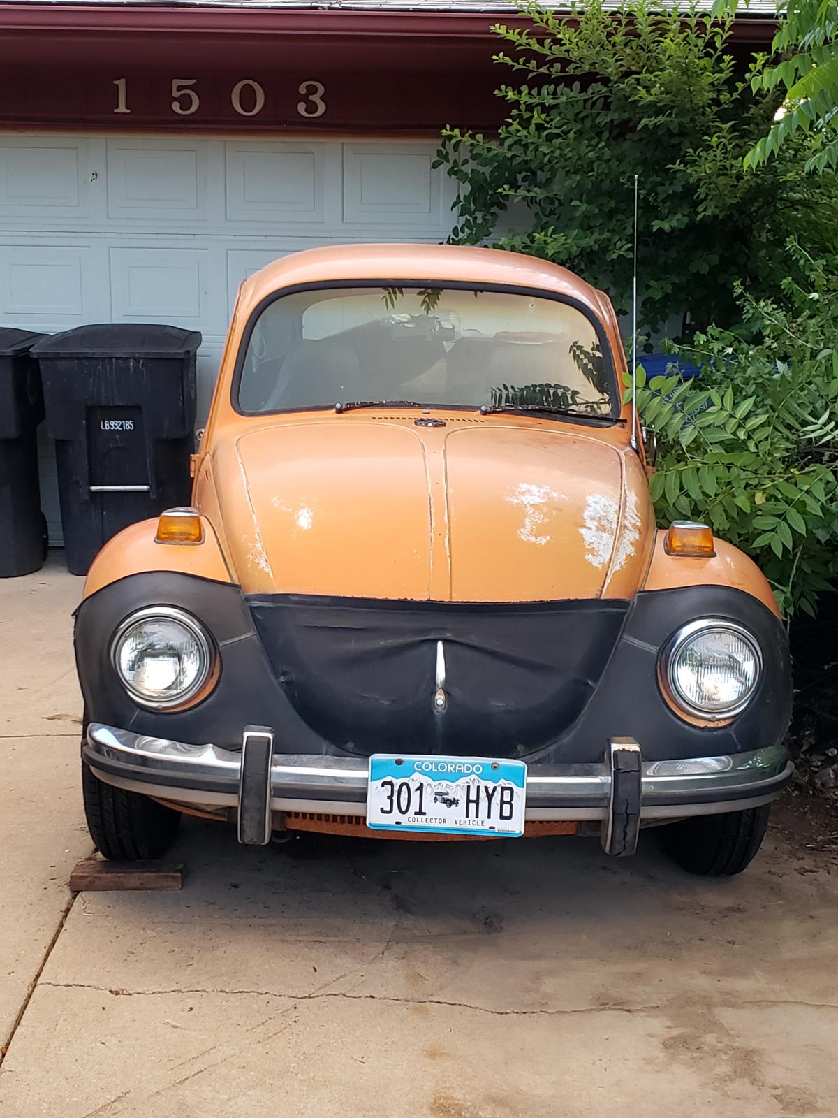

My twin sister and I always dreamed that our first car would be a beetle. Life happened, and that dream didn't...
Then, when I first met my husband, his grandmother had an orange beetle parked in the way back corner of the yard. I thought they knew I wanted it, but it disappeared from the yard one day, never to return.
When I met our best friend, his mom had a beetle, an orange one, parked in the driveway and I begged her to let me buy it. She refused, she was planning to fix it up herself. Okay. Six years later, in 2019, she calls us up. I can have the beetle, if I come get it from the driveway. We hopped in my 2007 green beetle Sagra and went!

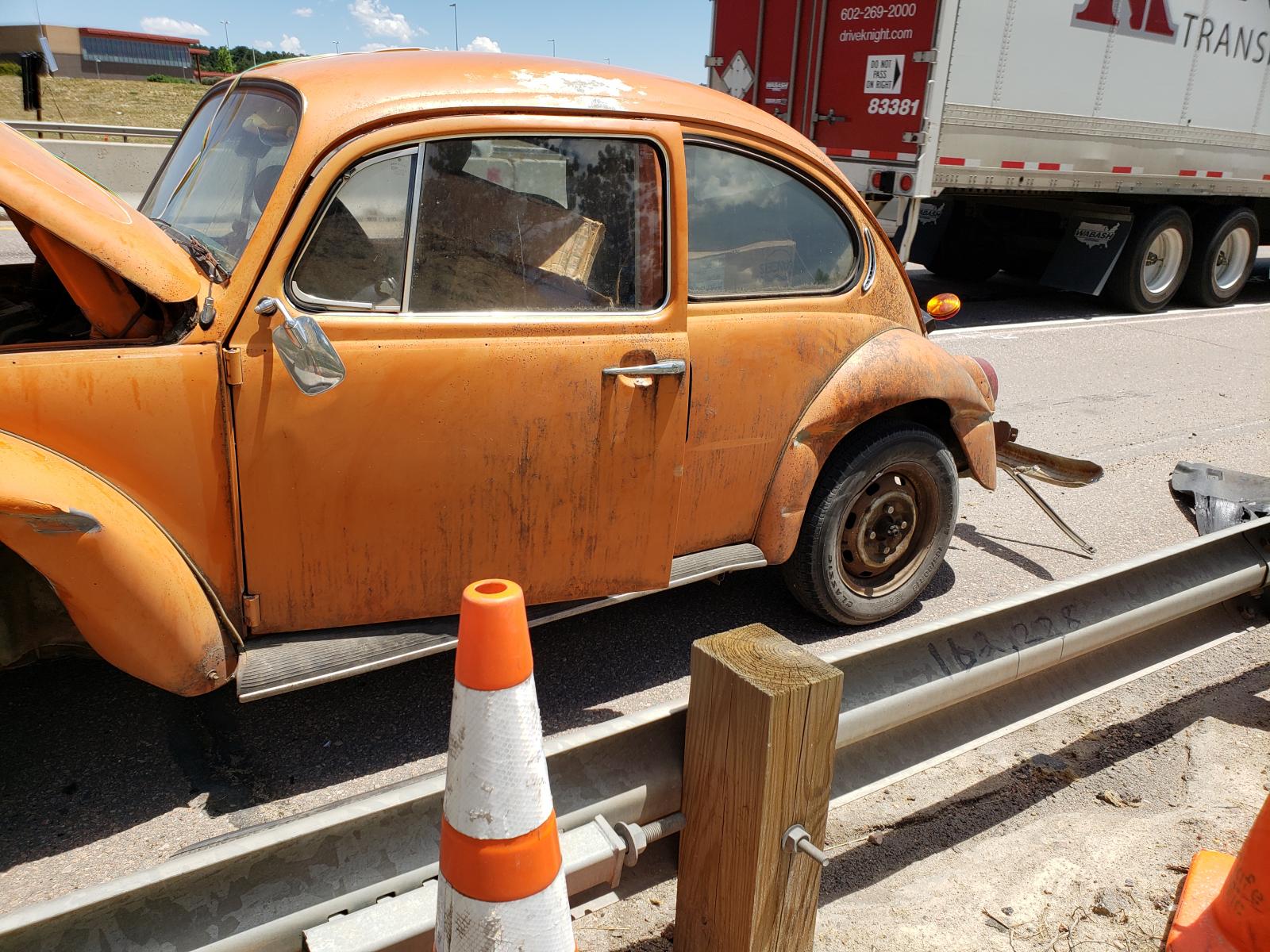

Pretty much everything went wrong on that trip. Then we crashed. Both beetles were damaged. Ultimately that ended up being the start of hospice for my poor Sagra. The classic orange beetle Marmalade got loaded up on a car dolly to get dragged home.
Orange Bug "Marmalade" a 1972 Super Beetle, autostick

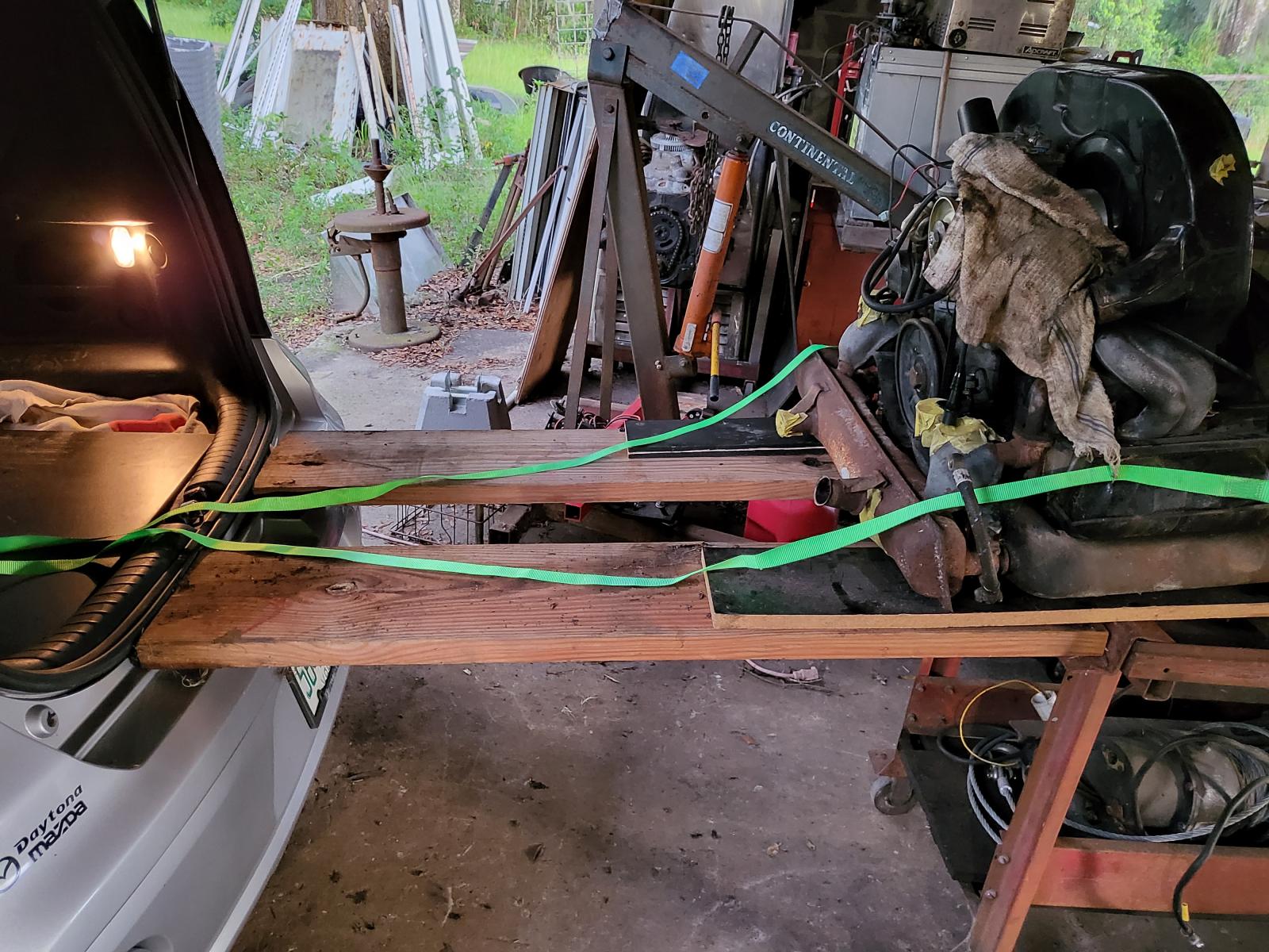

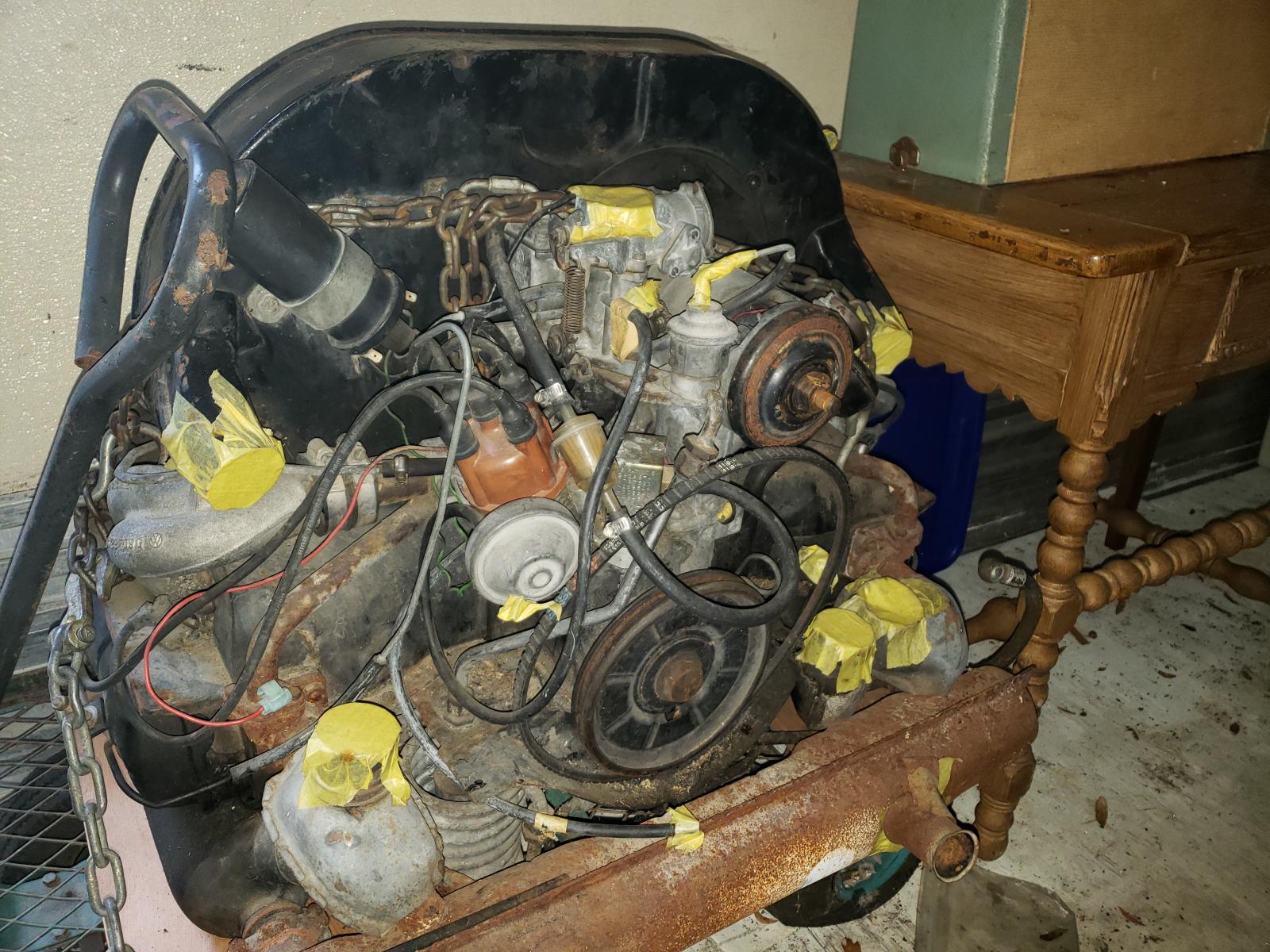

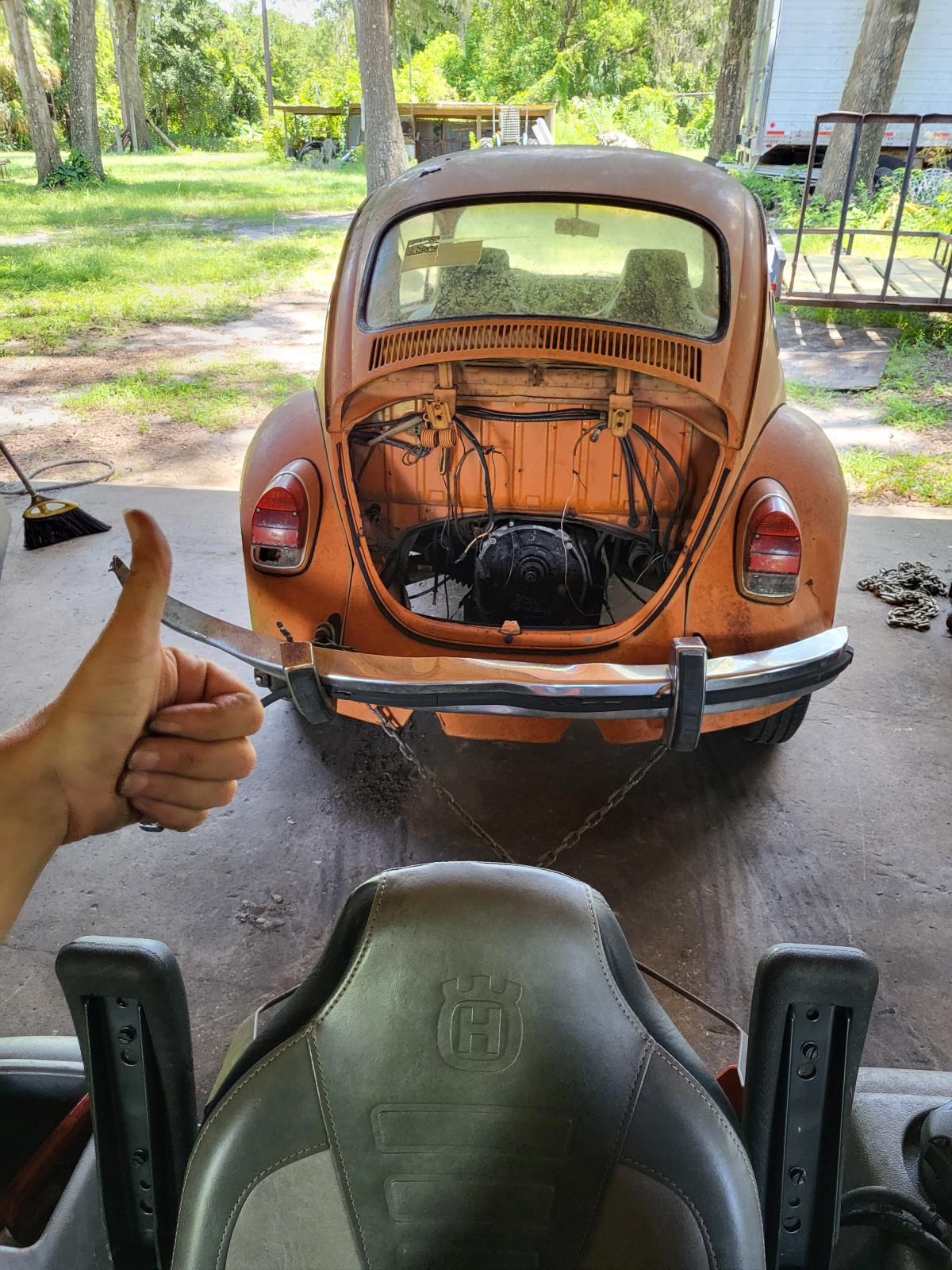

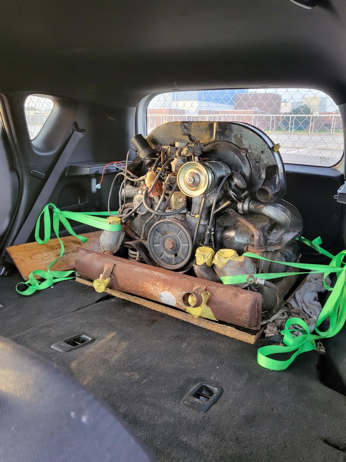

The car has sat a long while in the yard, getting attention in bits and spurts. In 2020 I had a hysterectomy surgery. In 2022 I had cervical spine surgery to cure myelopathy from herniated disks in my neck.
It took a fun bit of figuring to do things despite a 40lb lifting restriction!
I had a lot of moral support, as you can see, and I managed to put the engine in all by myself!

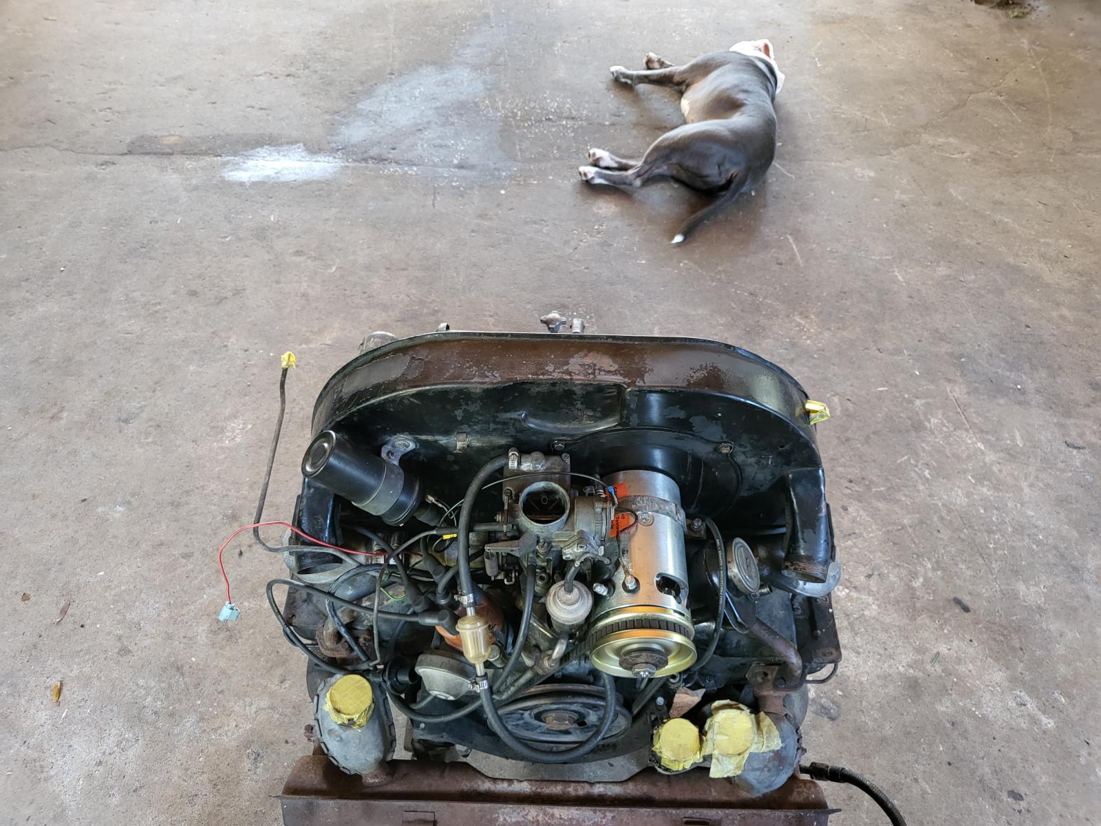

Marmalade sat again for a year this time while jobs and doggy needs took our time...

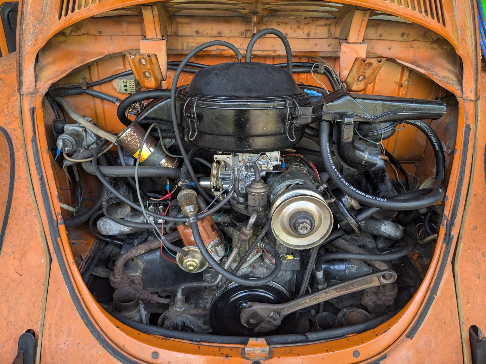

Recently a local was able to stop by and, with apparent ease, switched the distributor around and fired the car right up! I made some mistakes putting it all together, but it seems I did a pretty good job, all things considered! A couple more days of devotion and I was able to get the car into the shop under it's own power (but couldn't stop).

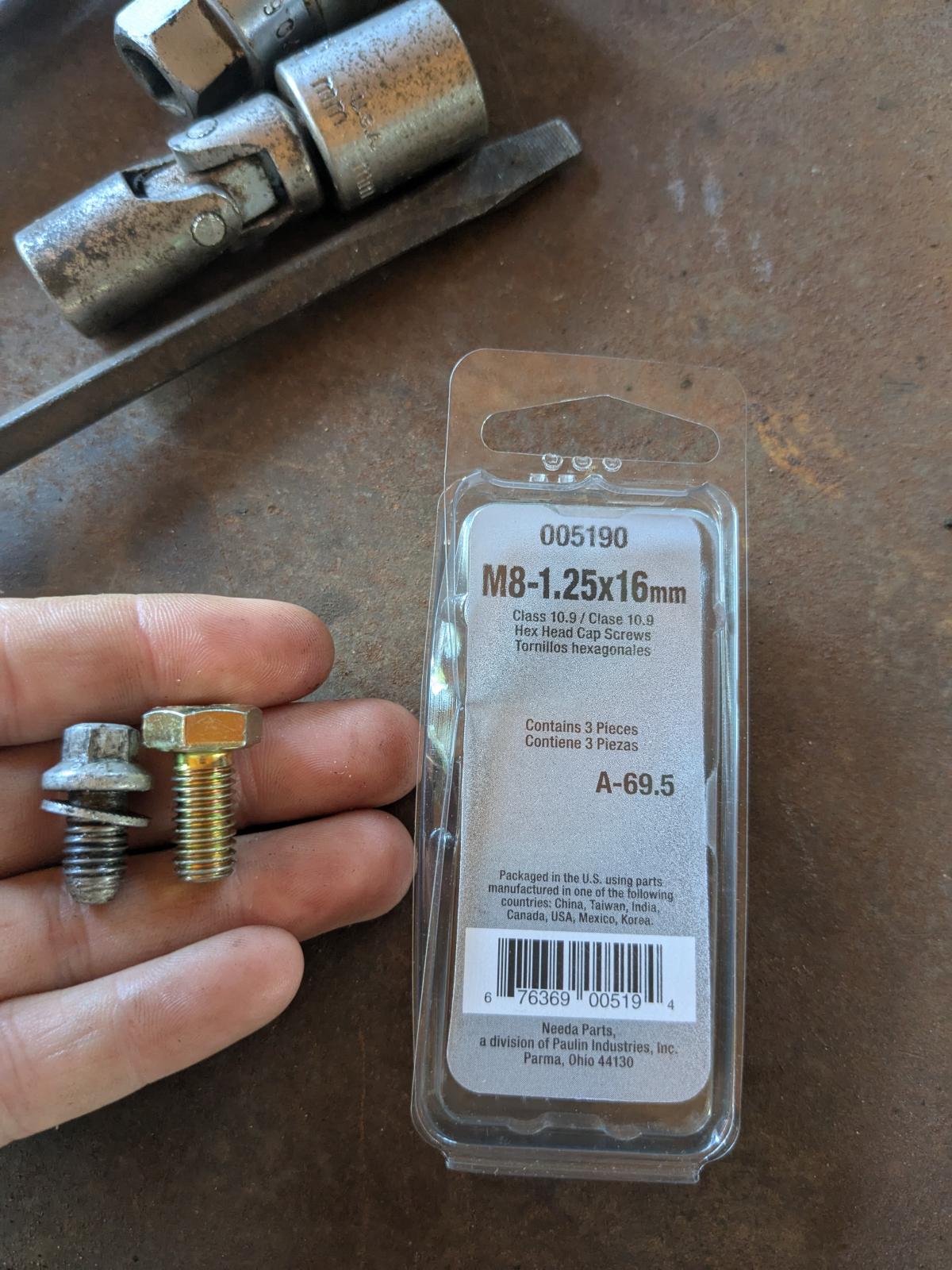

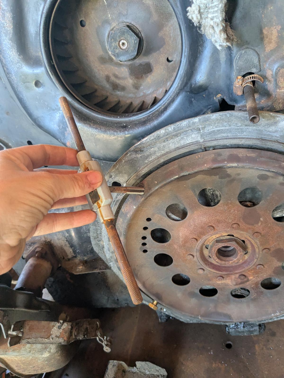

We fixed a separation of the drive plate from shucking all the torque converter bolts away, then fixed stuck wheel cylinders and adjusted and bled brakes...
A few days later, I DROVE MY CAR FOR THE FIRST TIME in some circles in the yard!

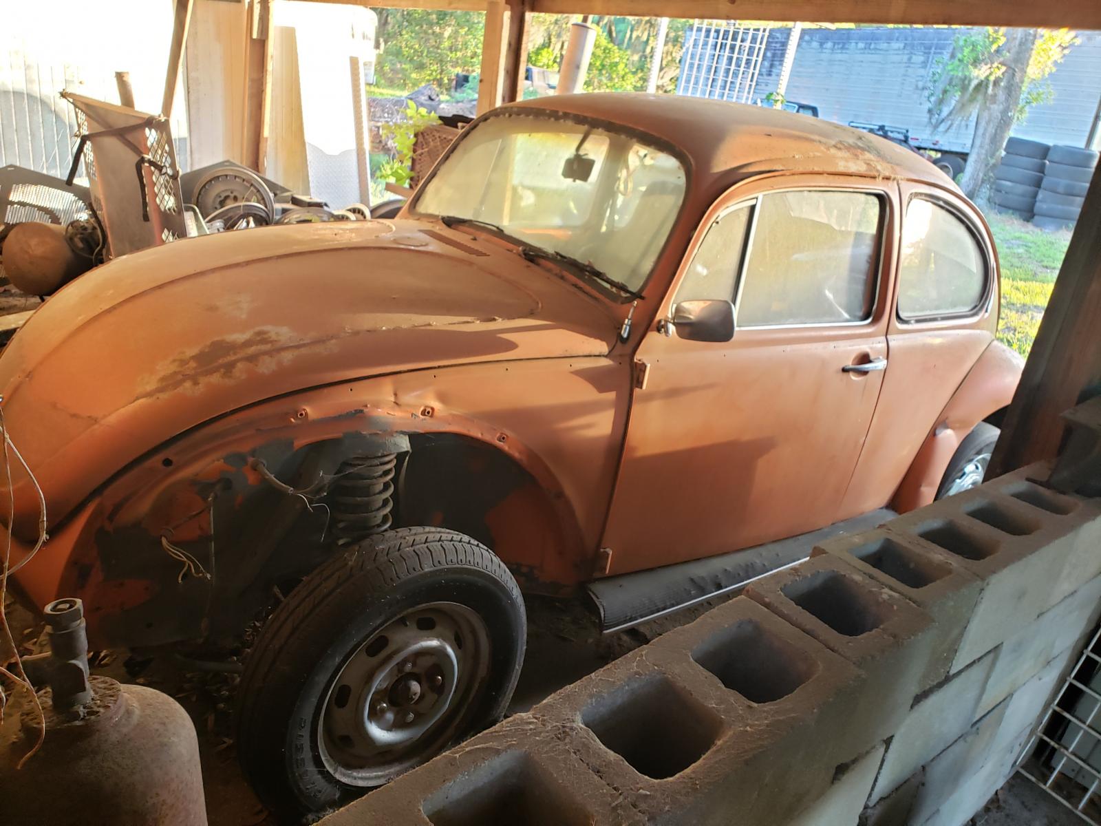

Next steps for Marmalade (I think):
Adjustments for smooth shifting (fix shifter plates, doublecheck vaccuum. We figured out the wiring to the control valve finally.)
Test drive!
What sort of front end damage is there from the crash? We know the front left tire doesn't have enough clearance from the strut spring/coil.
Fix front end?
Paint replacement front fenders yellow and put them on!
Replace broken/missing driver side headlight assembly.
Replace broken driver side taillight lens.
Replace broken rearview mirror.
Add the 3 heater and air ducts.
Fix the broken heater cable with a cable extender?

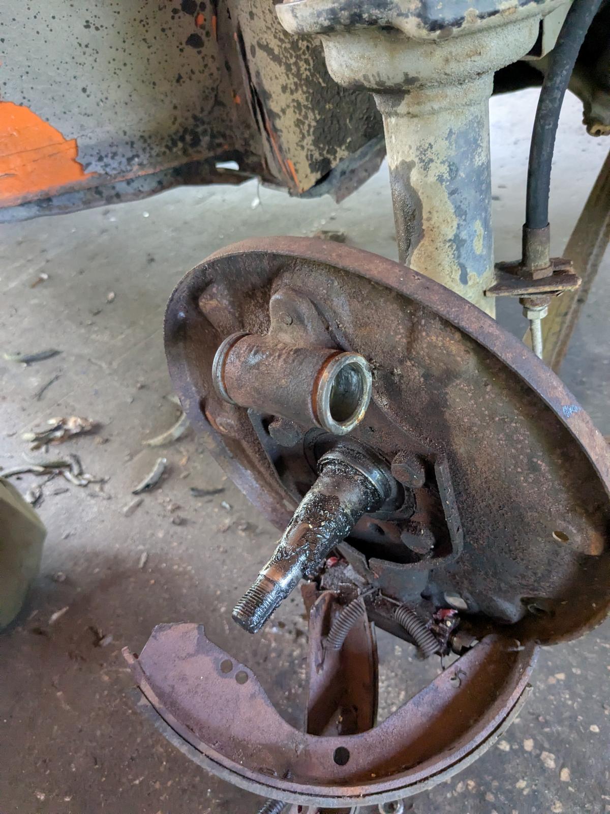

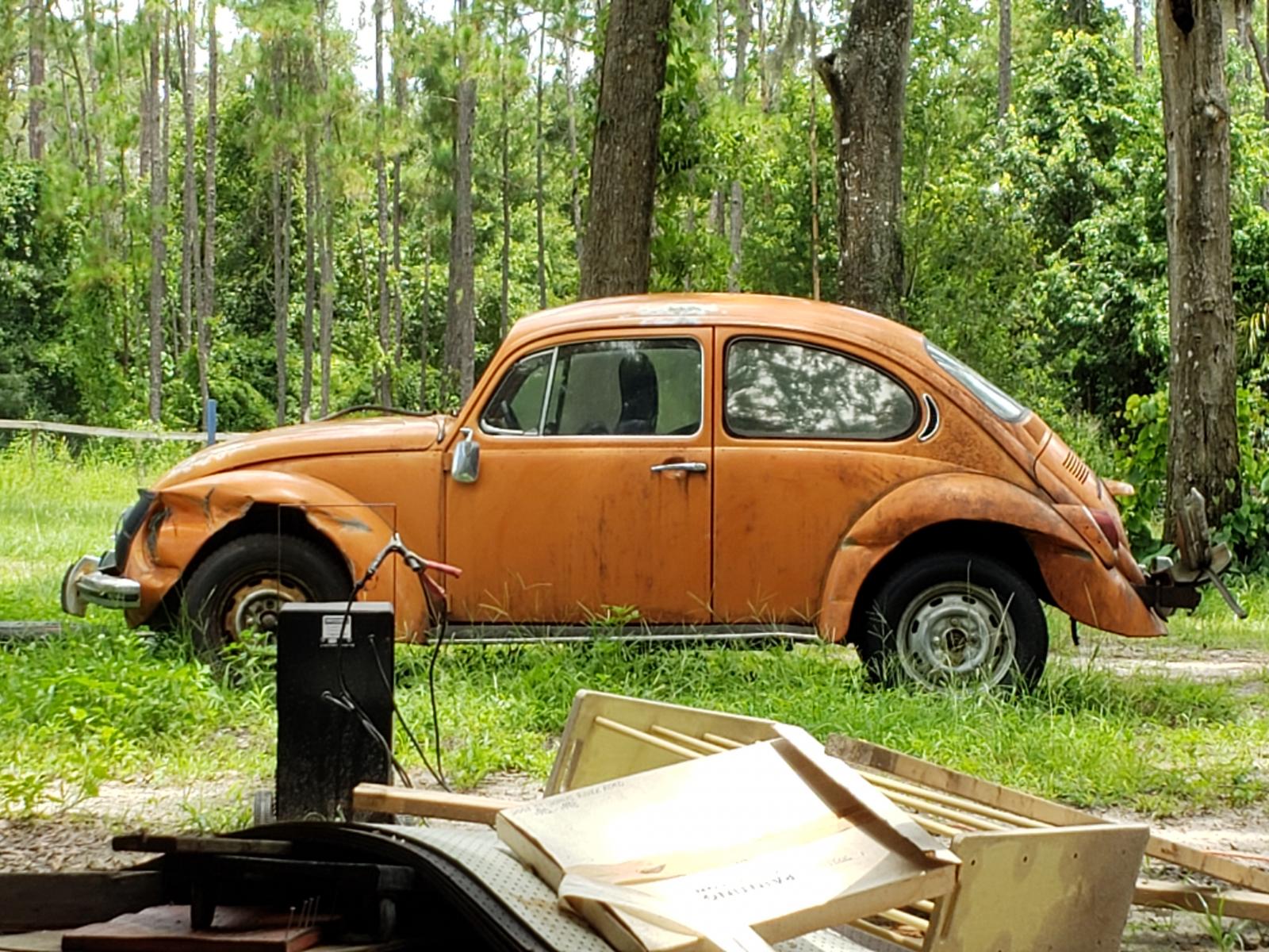

We got some donor cars from a local shop. Today we spent getting suspension parts from maybe a 73(?) and taking it apart. We think we identified the major reasons why the spring is so close to the tire after the crash: the bracket welded on to the frame kinked from the force transferred through the track control arm. It also looks like the strut may not be entirely straight. It seems as if the strut may come out at a different angle than the lower housing shell portion of it ( which I haven't looked up the proper name for).
In other news, the donor fenders are yellow now, and Marmalade is going to look awesome!
I've donor car has a headlight we can use. The other has a crunchy, but carefully serviceable rearview mirror.

Learning more about cars thanks to my brat beetle, Marmalade.
I thought I got the shifter right, but I forgot to test it after getting the carpet all vacuumed and put back, and APPARENTLY NOT... so that silly stick came back apart. The old crunchy wire has had it and I discovered it was constantly grounding so the car couldn't go in gear.
Also the engine wouldn't crank because it just WON'T do that without a fully charged battery.
We fixed the battery charger and figured out where neutral is with vice grips on the shift rod finally...
And then we found dirty fuel and also decided it's because we got to the bottom of the tank. Had to go get gas. (Looks like my gas gauge doesn't work.) We changed the fuel filter. Marmalade still didn't want to crank up and run! We poked around some more and decided after fixing the fuel issue that we also had no FIRE...
I have now learned a little more about the mysterious working of distributors and why I have been confused about them this entire time: what everyone calls POINTS is actually just a single "point" of contact on a "breaker point assembly" where a flappy arm rides in and out against the rounded square column of the distributor. The arm claps a contact like you'd clap your hands, opening to a specific gap amount at the high corners of the square column and closing at the low straight sides of the square column. My breaker arm wasn't moving open at all! So now I know how to turn the motor so the arm is against the high corner where the contact should be fully open, and set the gap.
Now the motor cranks strongly and starts almost immediately. Then it doesn't want to stay running...
There was still something funky going on with fuel based on the sightglass of the fuel filter, so we took the electric fuel pump off and bench tested it. It did not have a good seal for the check valve so we took it apart, cleaned it and dunked all the bits in marvel mystery oil, put it back together, tested it pumping oil. Whatever grit was in there is gone now and it doesn't allow backflow seepage anymore. We'll mount it in a better place, since there is no reason to keep an electric fuel pump mounted where the mechanical one used to go.
Thoroughly irritated now, we got The Winch.
Marmalade got coerced backward and then slowly coerced forward into the shop.
We're done for today. Take that, brat!
A new shifter contact wire is ordered... Also a strut tower support bar, I saw that's a thing and one of my cavaliers had one so it seems like a good idea, especially since we aren't sure what kind of buckling damage might exist due to the crash.
Tomorrow we'll start replacing the struts.
Electric fuel pumps tend to work best when located close to the fuel tank, as the pump pushes fuel to the engine instead of 'sucking" fuel from the fuel line like the original mechanical pump does. So if you want to relocate it, a good location is in the right front wheelwell. My '77 Beetle had a high-pressure electric fuel pump originally to feed the stock fuel injection. The PO removed the FI and installed a generic low-pressure pump at the same location, on the vertical surface of the front bulkhead/firewall using the original bracket. You can do the same, or place it on the chassis itself on the flat surface between the bulkhead.
You need to use rubber washers between the pump and the chassis because the pump tends to pulsate during normal operation. This pulsing will be felt and heard if you hard-mount the pump to the chassis directly.
And this is an ideal opportunity to replace the fuel hoses up front, making a new one from the tank outlet down to the pump inlet, and another new one from the pump outlet into the tunnel pipe.
You can make a simple cover for the original fuel pump location using a piece of sheet metal that has 2 holes for the 2 mounting studs. Smear a bit of RTV silicone along the edges of that cover and let dry before installing. The 2 fastening nuts are M8 x 1.25 mm, used at many locations on the engine. Here's a shot of my '77's engine and the fuel pump hole cover.

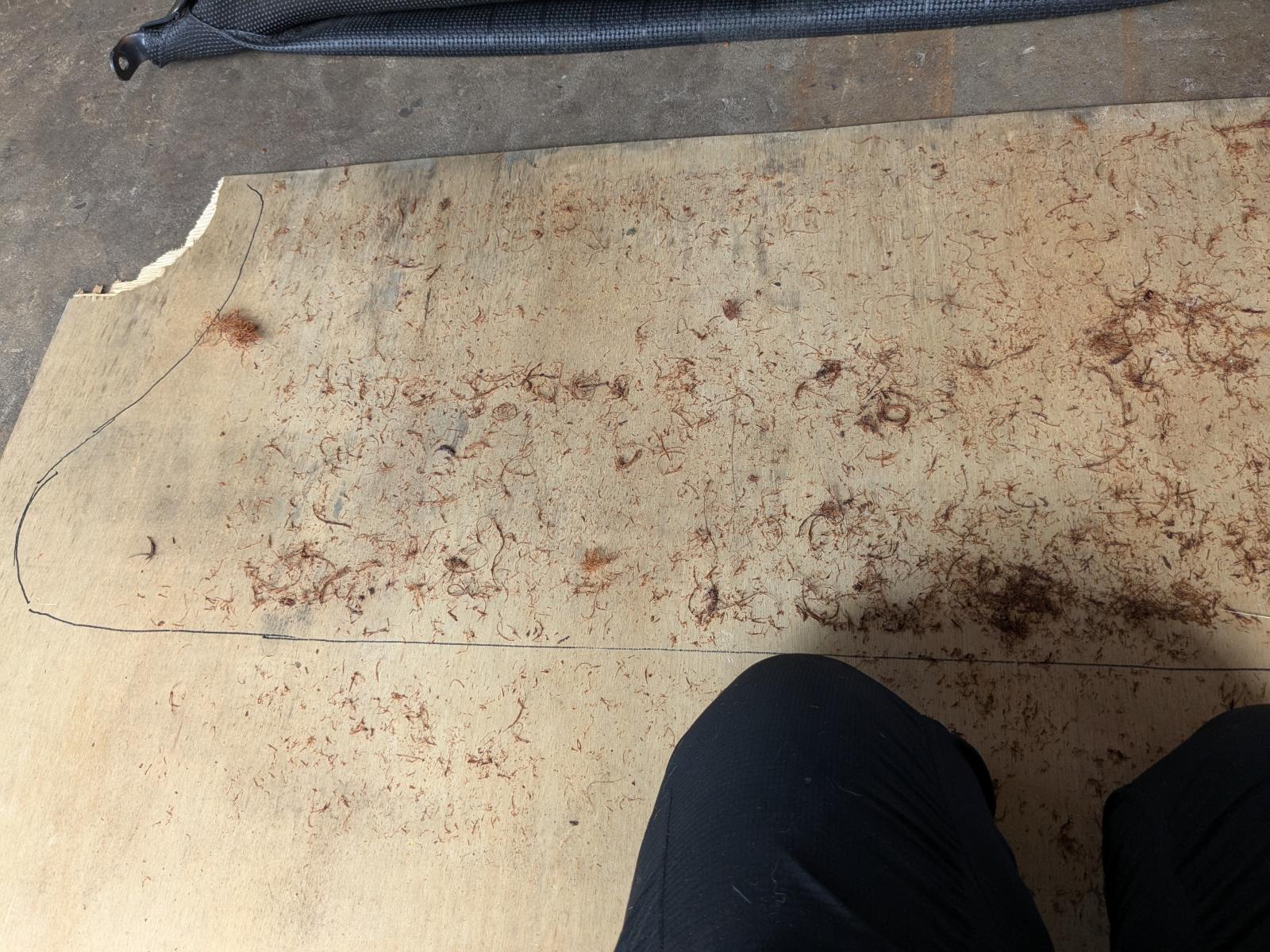

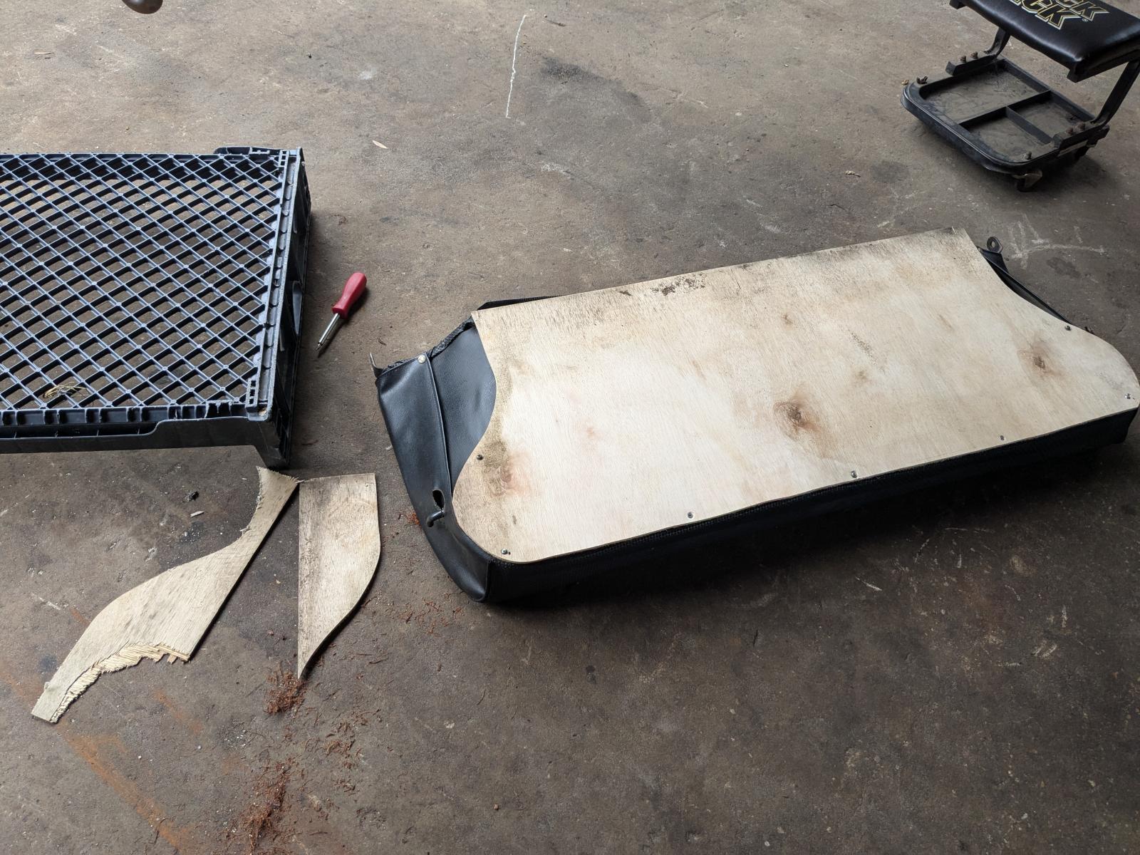

Today I installed the rear seat backrest! I had to do it dodging yellow flies and black widows, which is just ridiculous. Folks, be careful around those yard cars!
I couldn't find anything resembling a seat pivot bolt... Luckily both donor cars had posts on the passenger side. I snapped the red one off. The white one came out whole, and I decided to use both. The rear seat I stitched a liner to the bottom to contain upholstery debris. The backrest got some thin plywood backer.
Not putting the bench back in until I'm sure we can reliably start and drive the car, since battery strength seems to be an issue, or something.

Oh and the mail arrived. I'm so mad. The shifter contact was a piece of junk and the wire was already halfway fallen out of the contact disk. It failed a little bit of further investigation, and came apart entirely (also why is it blue?).
So I went and found some wire, did some calculating and some electrical surgery. I spliced the old wire into new wire just under the contact so the weak section is wrapped and kind of protected inside the shifter. Only new and fully insulated wire now comes out. I was careful not to twist the wire itself when putting the stick back together.
The book says to tighten all the way down and then back off half a turn. Doing that didn't seem to allow any movement to the top of the shifter stick so I gave it one more half, making sure to keep the top slot lined up with the bottom dowel pin so the stick can only tip front-to-back. I'll get to see how well it works later, and if it doesn't I now know exactly how to adjust it for contact.
My reverse lockout plate did not survive my husband. The tall narrow tab was completely flattened and cracked on the fold. I gingerly stood it up again... I don't know how long it might last. The stick is installed and bolted onto the tunnel...
I've got no idea what, if any adjustment needs to happen there. Its just bolted down. I'll have to get the car running, then the contact known working, to see if the stick itself shifts properly. It feels fine with the car off, but then again it did before too. I guess we'll find out!
