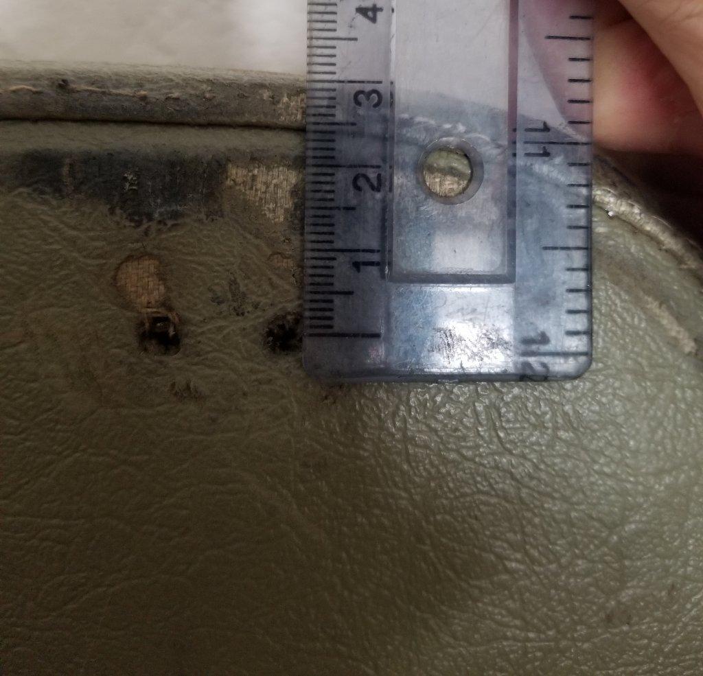

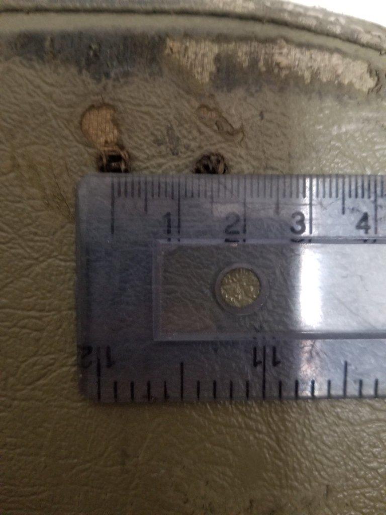

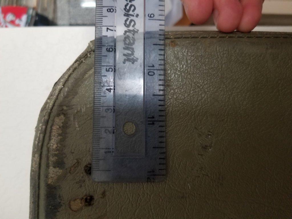

[Top hole to side of seat - 35mm
That’s 30mm, EB 😉

Highbody wrote:
flemcadiddlehopper wrote:
Anyone have an idea of the distance the screws for the rear seat mounting brackets are from the top and side? I don’t want to cut a million holes
Top hole to top of seat - 65mm
Top hole to side of seat - 30mm
Distance between 2 holes - 15mm

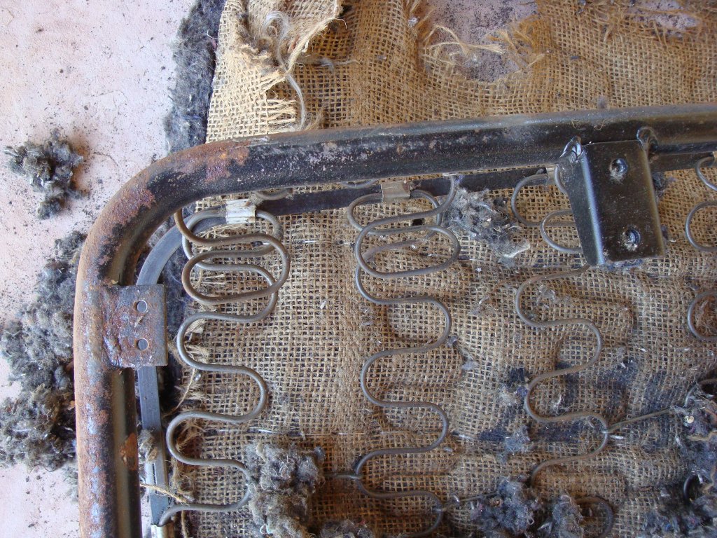

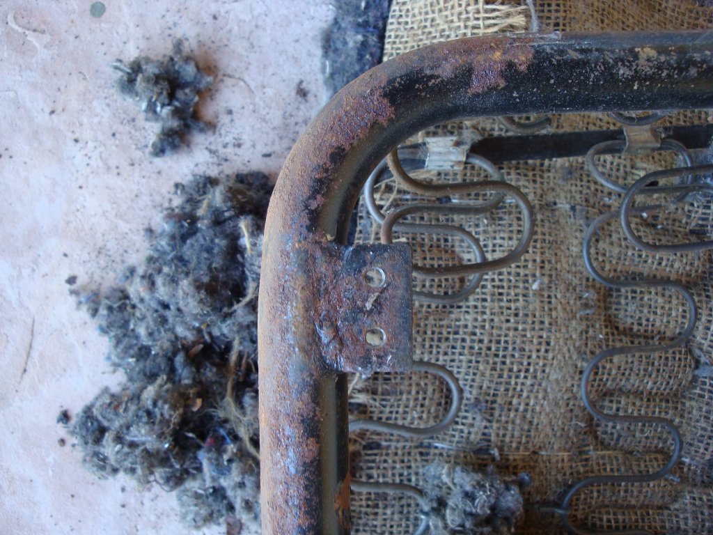

Hi all and thank you for this tread.
Is there a kind of plate behind these holes to screw the bracket in?
I have a 69 model but a late Bay rear bench i'm guseeing if i can't fix it to the original bracket.
Thanks,
Will
Posts: 71478
PostPosted: Tue Oct 04, 2022 8:25 am    Post subject: Re: Bus Rear / Back Seat information thread Reply with quote
Yes, there are plates welded to the seat frame

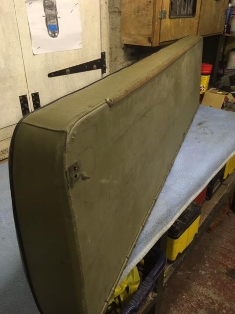

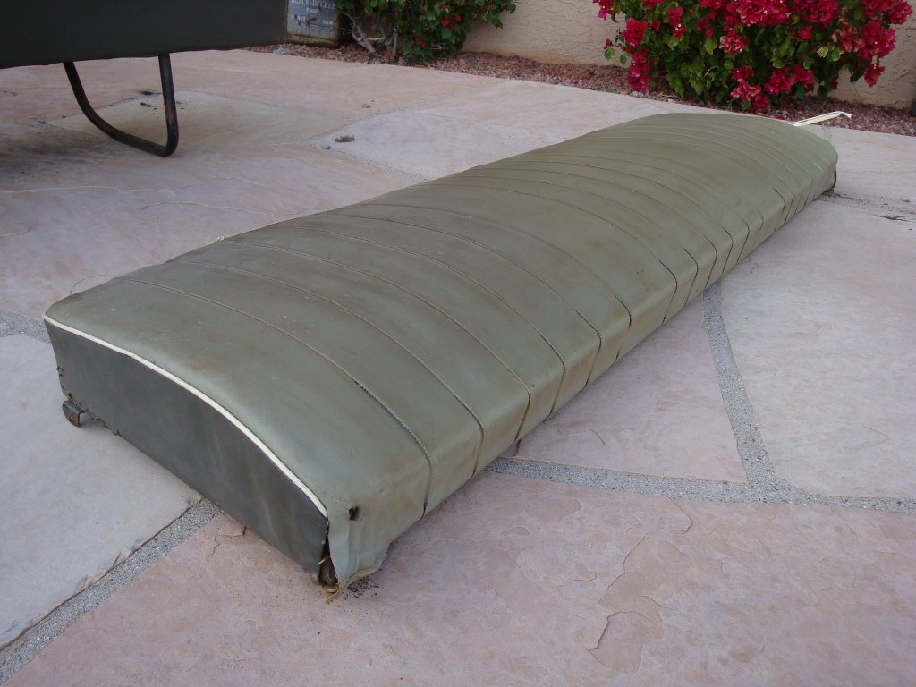

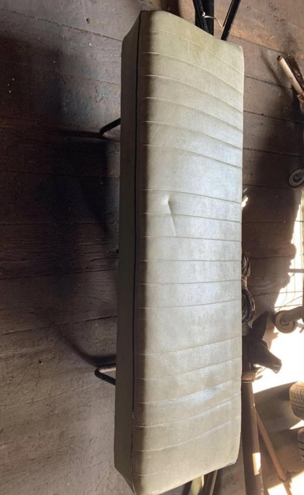

What do I have here? Was told this seat is pre 63 but I am not sure..
Posts: 71478
PostPosted: Tue Sep 05, 2023 2:23 pm    Post subject: Re: Bus Rear / Back Seat information thread Reply with quote
It looks like a 56-57 Standard (Green/Green Bus) middle seat.
This color was used from 55-58 but 55 has a slightly different seat base and a '58 seat back would be curved instead of "flat"
I can't tell for sure in your photo so:
Is the seat back rest flat vs a '58 only curved seat, which would have a little bow in it.
1959-61 upholstery example that is NOT flat:
(Same seat design, just different color)

PostPosted: Tue Sep 05, 2023 6:26 pm    Post subject: Re: Bus Rear / Back Seat information thread Reply with quote
If you're interested in selling I need a backrest for my 56 pgsg project.

PostPosted: Wed Sep 06, 2023 6:16 pm    Post subject: Re: Bus Rear / Back Seat information thread Reply with quote
The back rest is flat. So this must be a 56-7 rear seat?
Posts: 71478
PostPosted: Wed Sep 06, 2023 9:53 pm    Post subject: Re: Bus Rear / Back Seat information thread Reply with quote
Yes, although it would work and generally look correct for 1955 too.
It's just that 1955 has a slightly different seat base design, the center leg is more "sharp".
I think your seat bottom has a couple pipes added? (one seen in red paint)
Guess: They were probably added so that it would sit upright for people to sit on at some point, I've seen that done with middle seats in the past.
