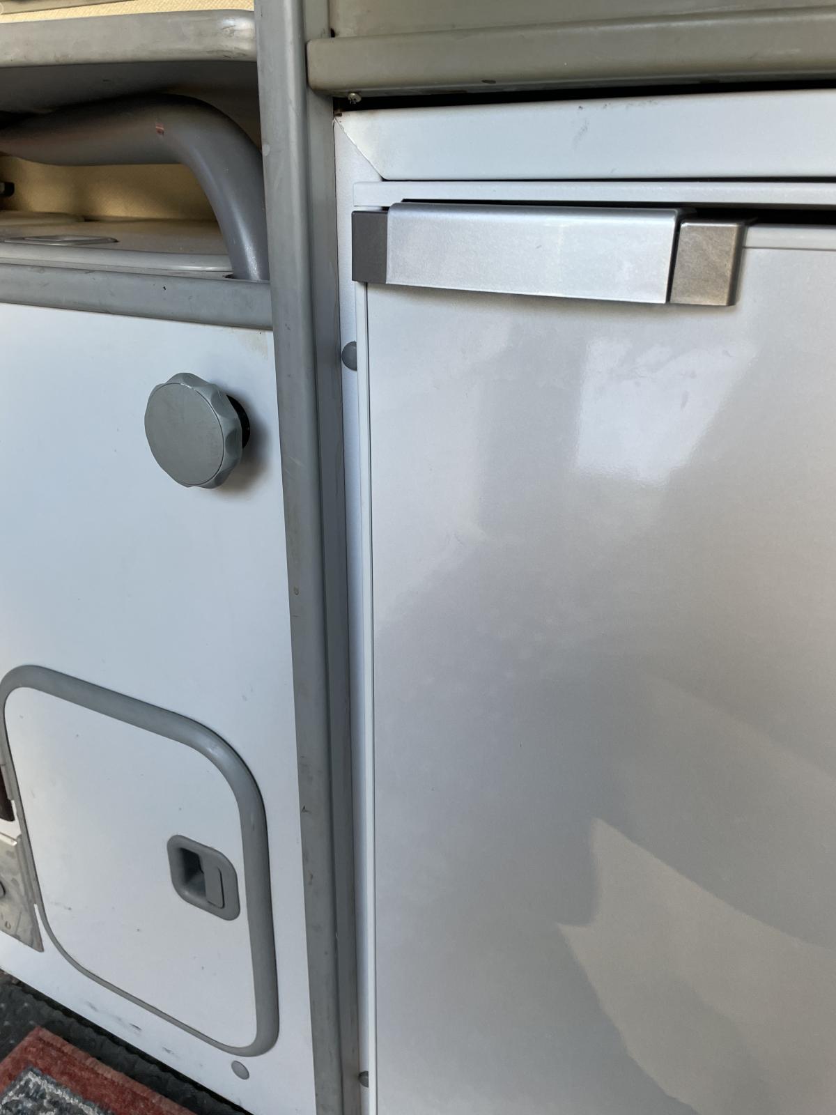

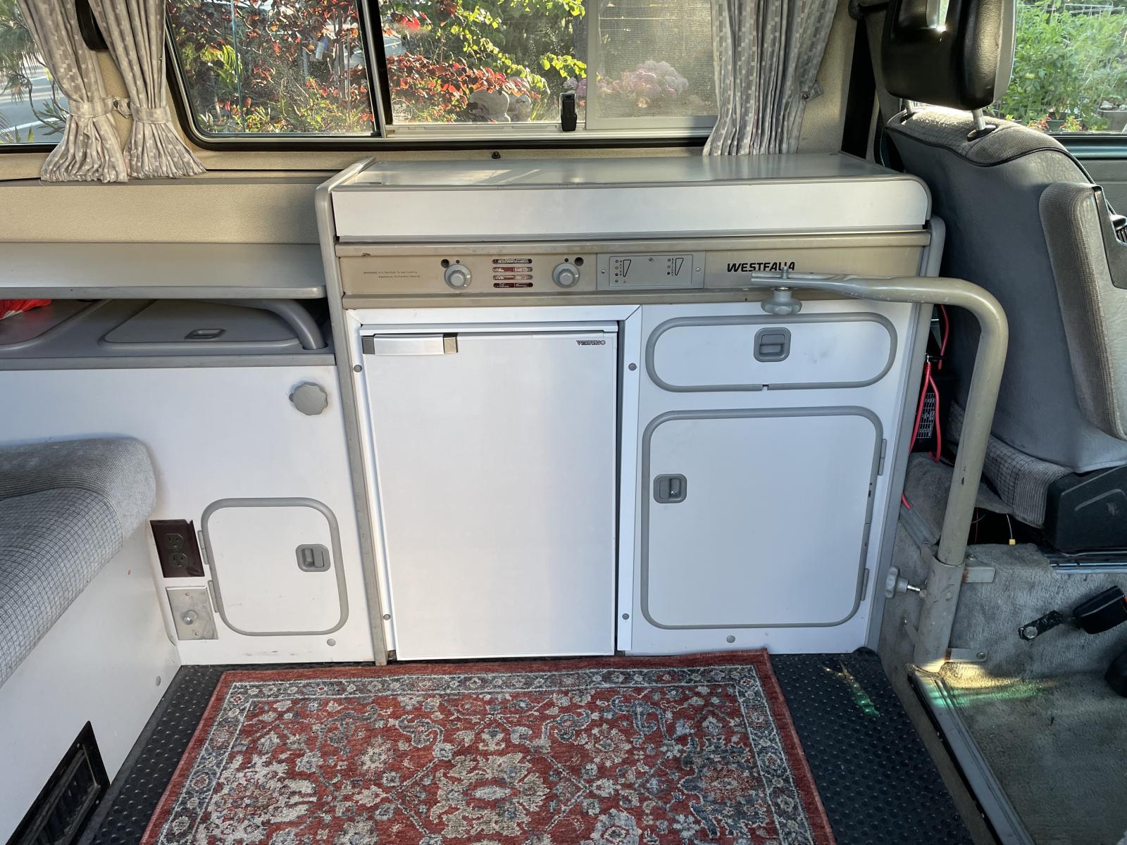

After much deliberation I decided to go with the Vitifrigio C50i and am very happy with it.
As others have said it fits right in the space with no alterations. It blends in nicely with the stock cabinets and with the frame makes for a clean, stock like looking install.
I purchased it from the only source I could find which is Camper Interiors in the UK. The cost of the fridge and frame with shipping was around $1200.
I took a while to get it and there was a bit of a communication hang up, but they did get back to me and once it was shipped it took just four days to get it.
I would have no problem recommending them.
Install was easy. The frame is a bit to large so I cut about 1/2 inch off the horizontal piece and then stuck the edge of the left side into the slot for the stock fridge door and screwed the other side it with t stock screws using the stock grey rubber trim pieces. Then it was just a matter of wiring, which I used a fused wire to the battery. The fridge slid right in with a slight gap. I used a few screws threw the existing stock holes to secure it.
I used the fridge this week and ran great. Quiet, made ice fast kept items in the freezer frozen and everything in the fridge cold even in low 80s temps.
I have it hooked up to a 100AH lithium battery through a DC to DC charger that also enables me to use my solar panel. Had no issues with power.
