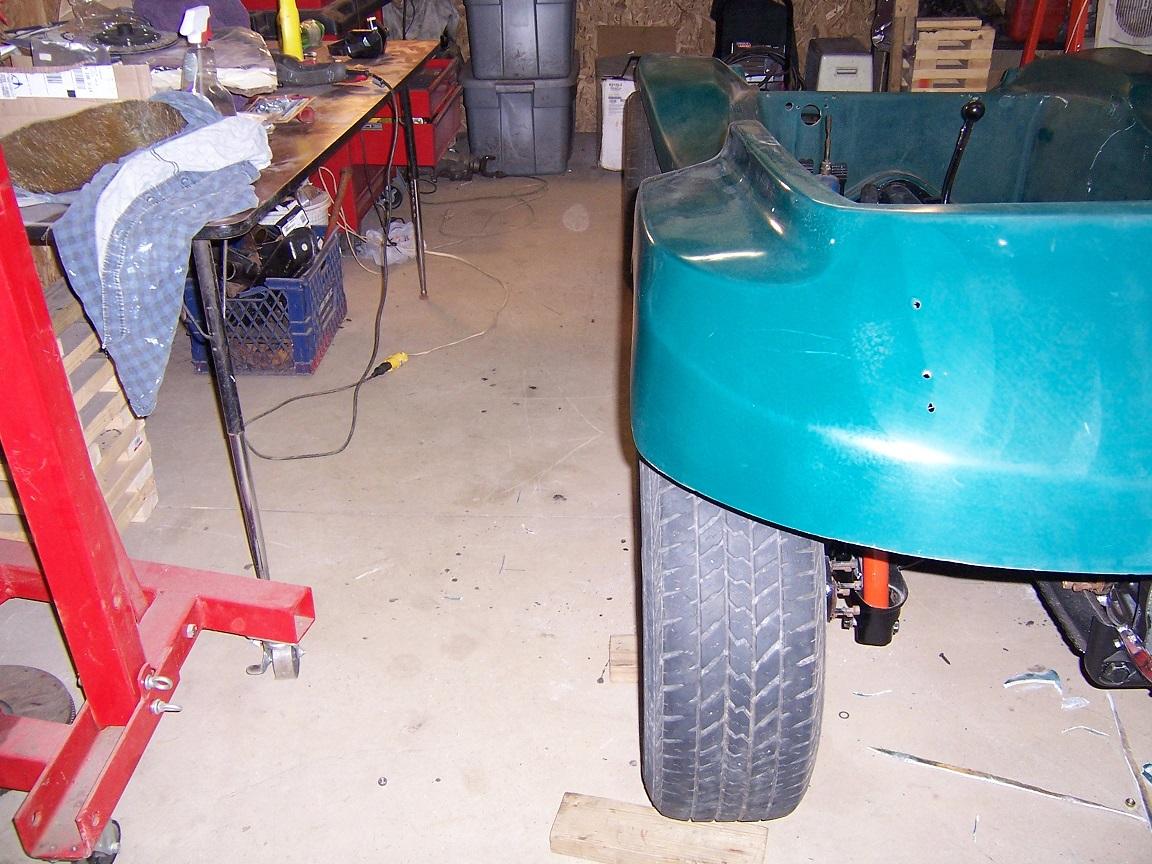

With the chassis now a roller I started fitting the body. As far as I know this buggy was an original build before the guy I bought it from disassembled it. It then sat for years until I got it. The body is actually pretty clean as far as hackery goes. There are holes to fill which is typical but don't seem to be any extras. It had a top at one time evidenced by the holes for the snaps. Little repair needs to be done except the unfortunate engine access "Hood" cut in the back. I will get to that later.
After sitting for decades not bolted to a chassis the body mount lips edges were twisted up some and curled inwards. Had to deal with that.
When I set the body on the chassis I saw it wanted to kick off to the left exposing too much tire sidewall on the right front and not enough on the left. Can't let that go.
I saw the body was hitting the right torsion bar cap. It was also pushing the body forwards and the area over the Napolean Hat would not line up. I opened up the body in front of the torsion cap to allow it to straighten out.
There was a sizable gap over the rear crossmember too. I used the stock holes in that area to draw the body down. It bolted down pretty evenly all around.
I had to "Persuade" the body at the napolean hat to take on the shape of the chassis in those areas using long bolts in the front and drawing it down gradually. There were a few crackles and pops but it settled in and it evened up nicely. Carefully applied heat fom a heat gun helped ease the body back into shape.
To get the body centered over the tires I put a shim between the body and the napolean hat to raise it up enough to move the body enough to make tire stickout even. There are 4 holes at the front of the pan, two on each side. I used 2 of those holes, one each side and drilled up through those holes and through Buggy body flange. I took two long 5/16" bolts and nuts with big washers to ease the body down a bit at a time.
I used some braces and clamps to get everything in place.
The exsisting holes in this previously mounted body mostly lined up with the holes in the new floor pans after I used levers and braces to get the body unwarped then bolted it down. I had to push the body outwards on the drivers side to get the body mounting flange to align with the pan rail.
Now all the tire stickout is uniform.

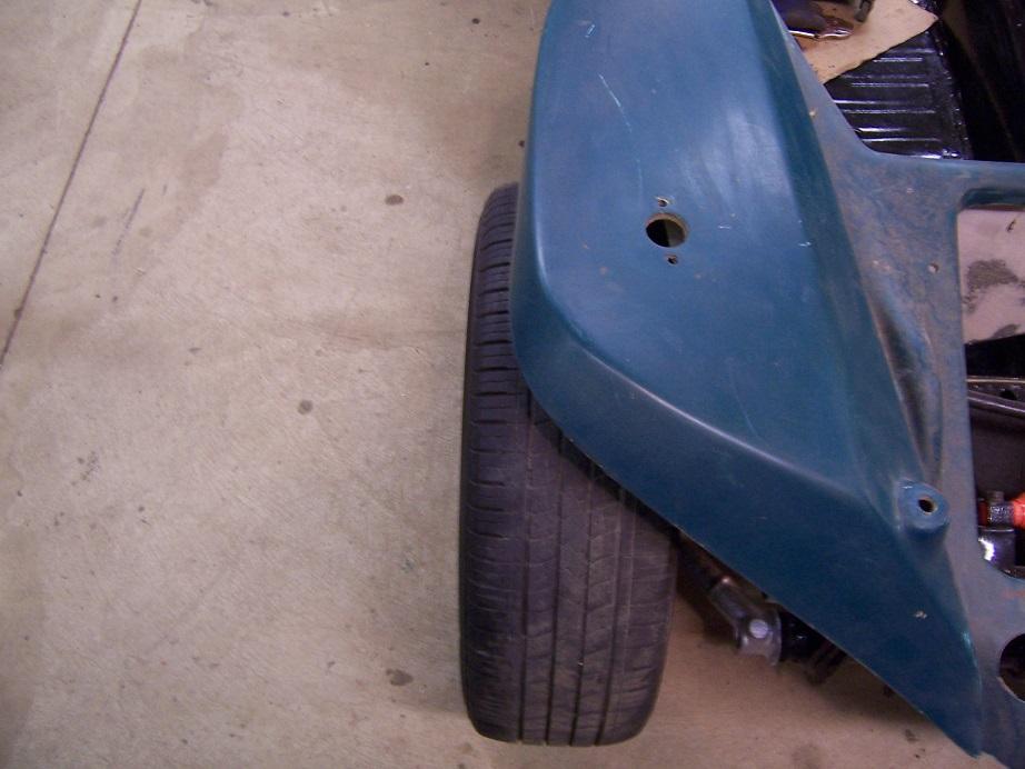

The right rear fender had warped and curled inwards from sitting for decades. i put these wood shims in and heat cycled it over the course of months to try to restore the proper shape.

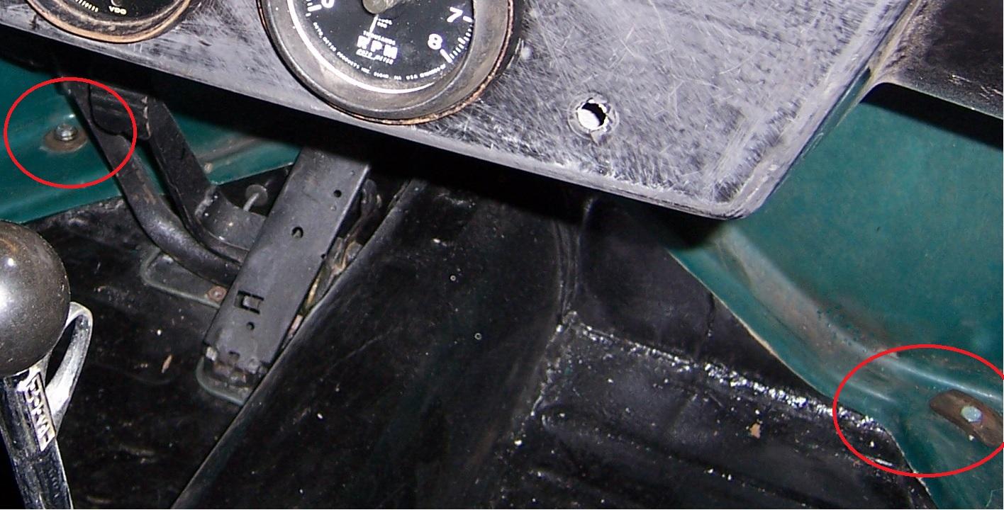

PostPosted: Sun Jan 14, 2024 11:15 am    Post subject: Re: Deserter Series 1 build Reply with quote
Except for the Western Bullet wheels, which I decided I didn't like, this is the current state of the Buggy. I am doing a mock assembly with all the parts that came with it. I can set the ride height and steering wheel position then.
The dash is bonded to the hood and is very rigid. I may not need a dash subframe.
Note the tall windshield. Works out well because otherwise my eyes would be looking over the top of it frame even with the Porsche 914 seats mounted as low as they will go. The extra 4" of wheelbase really helps with legroom too.

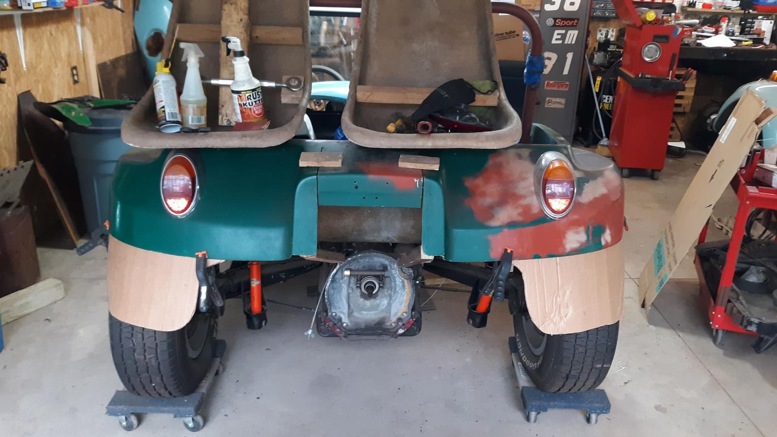

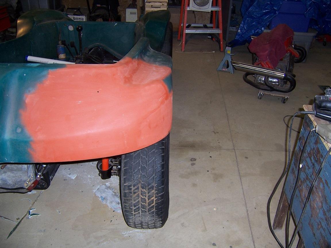

It has been a while but work is moving along on this project. A few things I have done are rear fender extensions. Required for PA Special Construction is tire coverage to the rear as well as engine covered by a "Hood".
Here are the fender extensions before paint. These are copies of the ones offered by Autodynamics as optional. These are made from ABS ceiling panels. about 3/16" thick, easy to form and cut and seem strudy enough to do the intended job.

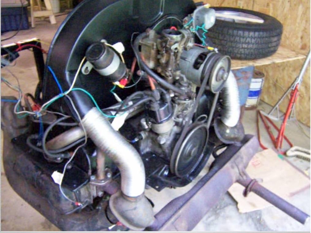

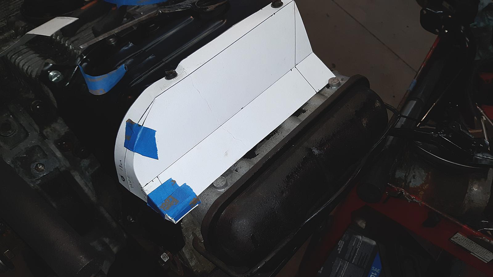

Also I have been working on the engine. Creating Industrial Shrouds for cooling air control. I made a template and bent some up using a Harbor Fright 18" metal Brake.
I couldn't find any examples in this forum of people using these. Does anyone else use them?

you know gene berg sells these for like 17$. these came on industrial motors back in the day just an fyi it could save you time down the road.

I just came across this thread for the first time. Very nice work with sectioning your rear pan sections. What tool did you use to make those cuts so straight?

Thank you. I did that pan 8 or 10 years ago but pretty sure I used a jig saw and an air powered body saw. I did grind and fit to scribe lines. Pretty happy with how it turned out. I was a Quality Assurance Tech my whole working career so measuring is sort of my thing.
Concerning the fender extensions I will leave them on most likely. I like how they look. Hoping to find and modify a set of side pods to match. Deserters are 4" longer than typical buggies.

Here are some pics of a couple shields I made from some roof flashing I picked up at the Local Lumber yard.
Easy to cut and bend.
