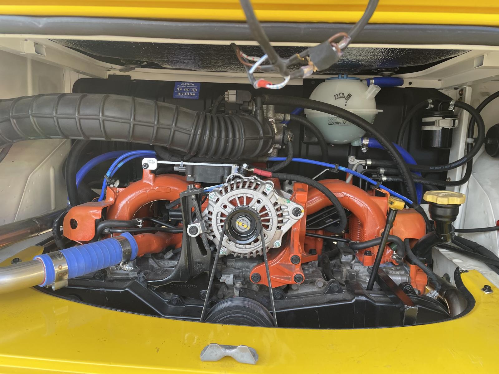

And that’s why this is so popular , stock modern engine EJ2.5 , 165hp , 165lb-ft torque
