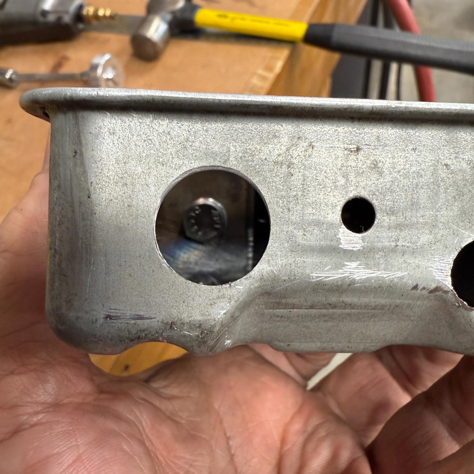

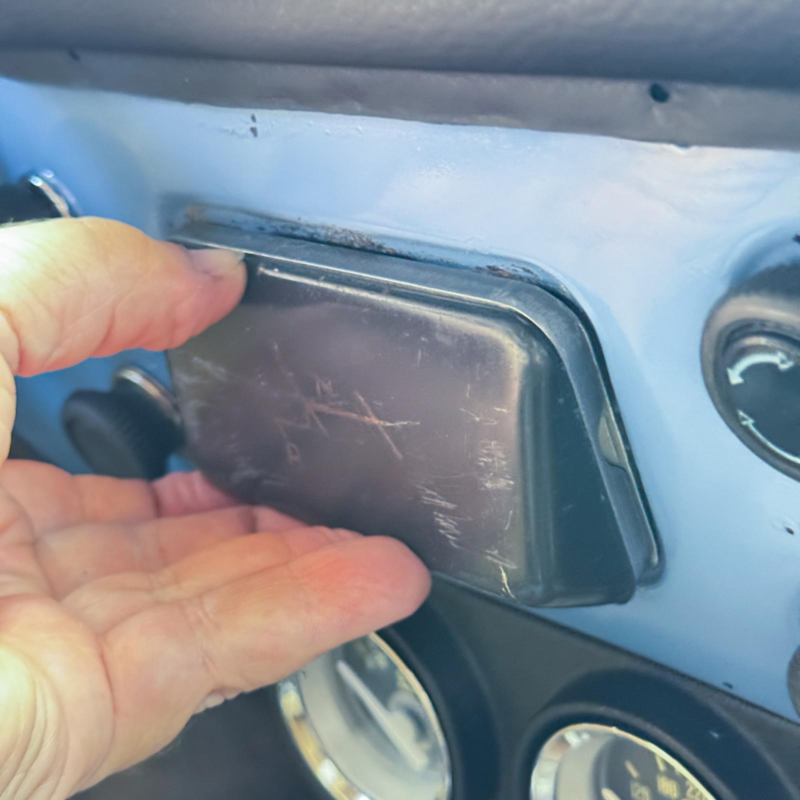

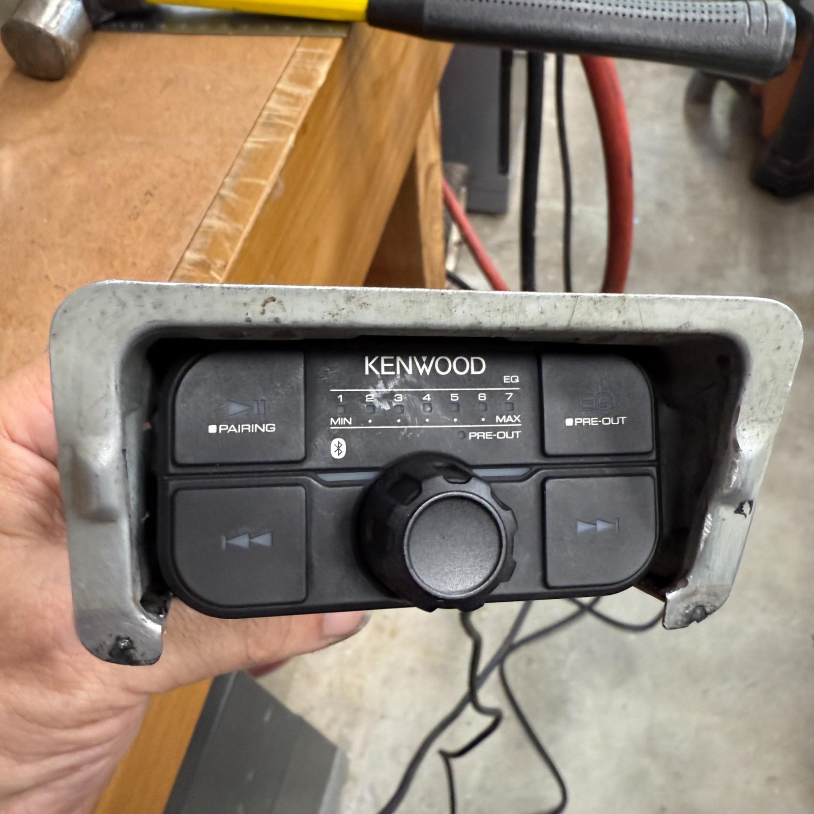

Today I got close to finishing the install of my Bluetooth stereo head unit. I don't want it to show when I'm parked, so I fabbed up a way to cover it. The four small holes in the metal frame attached to the ashtray door will get rare earth magnets, so all I have to do is pop it on and off as needed and throw it in the glovebox while on the road. The ashtray sleeve is just sitting in there wight now. Not bolted to the support band. A little more finish work and paint, then I can install for real and finish the rest of the stereo setup.

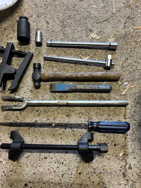

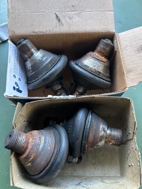

Replaced the upper and lower ball joints. The old ones were crusty.
The tools I'd recommend are;
17mm & 30mm sockets for the ball joint nuts and pinch bolts
Spring compressor to pull the lower joint out of its socket
Large screwdriver, and/ or cold chisel and hammer, the pry the lower joints apart
Ball joint separator (like a very large fork)

KIRK! wrote:
Today I got close to finishing the install of my Bluetooth stereo head unit. I don't want it to show when I'm parked, so I dabbed up a way to cover it. The four small holes in the metal frame attached to the ashtray door will get rare earth magnets, so all I have to do is pop it on and off as needed and throw it in the glovebox while on the road. The ashtray sleeve is just sitting in there wight now. Not bolted to the support band. A little more finish work and paint, then I can install for real and finish the rest of the stereo setup.

Scotty D wrote:
Really digging this idea! Cool
Thanks. A few chips and several cuss words later I'm calling it done. It will all get touched up when/if the dash gets repainted. I wish there was more room for bigger magnets. It holds just fine while stationary, but may come loose on big jolts/bumps. No worries because, if I'm driving, I'm listening to music and this cover will be in the glovebox.
