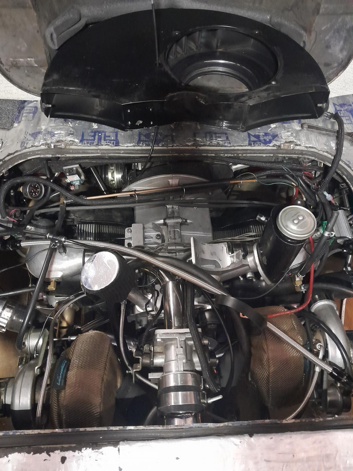

Perhaps it's about time I expand my knowledge and ability on my obviously cookie cutter engine.
Rob Combs
Joined: December 30, 2020
Posts: 476
Location: South Bay LA, California
Rob Combs is offline
PostPosted: Sun Jul 06, 2025 4:19 pm    Post subject: Re: Pertronix 90amp alternator Reply with quote
Twin turbos on a type 3? Awesome!
And in all sincerity I do hope your replacement alternator gives you no more grief. Changing the alternator on any of these is one of the shittiest jobs one can do under the lid.
sidemarkers
Joined: January 26, 2014
Posts: 104
Location: AZ
sidemarkers is offline
PostPosted: Sun Jul 06, 2025 4:43 pm    Post subject: Re: Pertronix 90amp alternator Reply with quote
Turbos? What, where?
Type 1 cooling tin, huh? What?
No that suitcase isn't covering anything, just going on little vacay.

sidemarkers wrote:
Just wondering how you are getting away with recycling hot air into the type 1 cooling fan. It must get smoking hot in that engine compartment especially with twin turbos and all the related piping. What am I missing here?
sidemarkers
Posts: 104
Location: AZ
PostPosted: Mon Jul 07, 2025 11:38 am    Post subject: Re: Pertronix 90amp alternator Reply with quote
There isn't really a short answer for it. Placement is important.
I use the frontal high pressure area for a RX-7 oil cooler and removed the doghouse cooler from the engine bay.
Twin intercoolers with fans pulling air from the rear fender louvers, most of the time the fans aren't on. Charge pipes are dense foam insulated.
Turbo blankets, header wrap on downpipes.
Gauges for the vitals. Oil, intake air temp, cylinder temp etc.
Air filters outside engine bay.
Mid 9's compression, .040 quench.
The intake air temp is usually about 15 degrees above ambient and that's taken BEFORE the water injection nozzles placed in the endcastings.
Under boost the water injection lowers the intake charge further and the cylinder head temps drop from 300ish to about 270. Highest oil temps I've seen with the front mount are less than 200.
